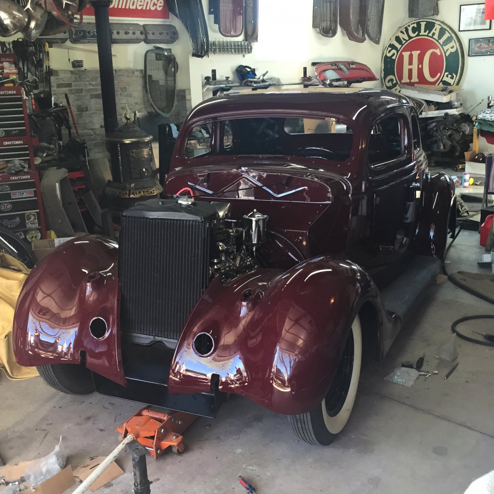

  5. With the body smooth I could install the running boards. Then move on to the front fenders. I installed the front fender/headlight braces I could fit the fenders. I was hoping to have room to modify the radiator and fenders a little to get the radiator forward an inch or two. There is just no way to get even half an inch with out having the radiator cut completely apart and narrowing the core and the top tank. I will wait until next winter and take the front clip off and modify the radiator at that time. So the fenders, inner fenders, and supports are installed and ready for the grill shell.

  11. Thanks KB. The fan issue sucks but for now I will move forward instead of back. I can pull the radiator next winter and have the core and tanks narrowed a little while she hibernates. The front clip is complete except the hood and the grill that is still at the chrome shop.

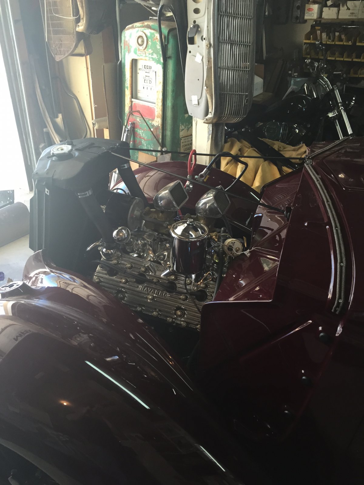

  12. Unfortunately I dident think there would be any issues with the fan so I dident worry when I dident have one at mock up. With only 1 3/8's " at the water pumps and 1" at the generator I need mare room than I can get. The motor has about 3/4" fire wall clearance so no go there. if you look at ryans pics the radiator is slightly touching the fender extension so to move forward I need to narrow the core a little but the top tank needs a little also so I think I will wait to send the radiator back to the shop to have it modify'ed.
  13. This morning I went out and installed the grill shell and got it lined up then I installed the headlights.
    While The tires were still off I finished installing the cotter pins in the front end then I reinstalled the tires and dropped her back on the ground. I assembled the headlights and then installed the bumper brackets and then the bumper. I rolled her out to get a good look. I wanted to be sure that the radiator was in the proper place so I installed the hood hinge and bull nose.

    Kipp, I've been conjuring with the demons all day as to what is causing your fan interference problem. I believe it started when you needed to raise you motor mounts and trans support that 2 inches to allow the front pulley to clear the raised front crossmember. Then since the radiator tilts rearward, the elevated engine caused a convergence into the fan's space. Who would have known that establishing the perfect ride stance such as you have would have such far reaching consequences like you have now. For those who have followed your outstanding build thread, we have learned much from your work and effort, what to do and what not to do. I also raised my engine up for two reasons, first to get the oil pan above the scrub line of the entire chassis if I wanted a slammed stance and secondly, as tall as 36 engine bay is I wanted the engine up where it would be better showcased. You have accomplished that as well, albeit, sometimes 2 inches can be a little and sometimes it can be a lot. The 2 inches helped the headers clear the steering box and makes your engine sit like jewel in a perfect setting. To me it's just as it should be. Have you considered going without hood sides to better display your engine? To all the builders who read your thread, watch out, if you change one thing you may well have to change Everything, I did. I'm attaching a thumbnail to show how high my engine sits and it caused a ton of problems.

  16. KB moving the engibut i willne up surely dosent help the clearance issue and it prevents me from running the fan off of the generator like a stock 21 stud would. As far as as moving the entire drivetrane up in the car goes you are right I am still finding things that are affected by this some good and some bad. but that is just all part of the game we play.
