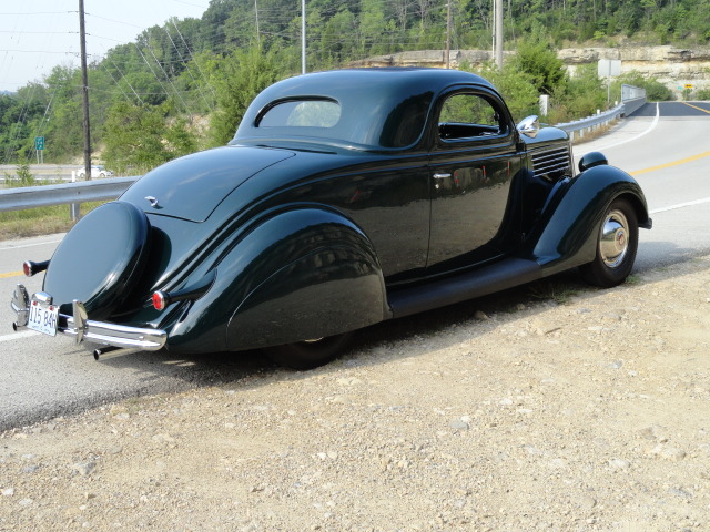

  3. Love what you've done with your '36. Just beautiful!!! Early style customs are cool. \'36 all done 006.JPG Here's mine.
    SuperFleye and daddio211 like this.

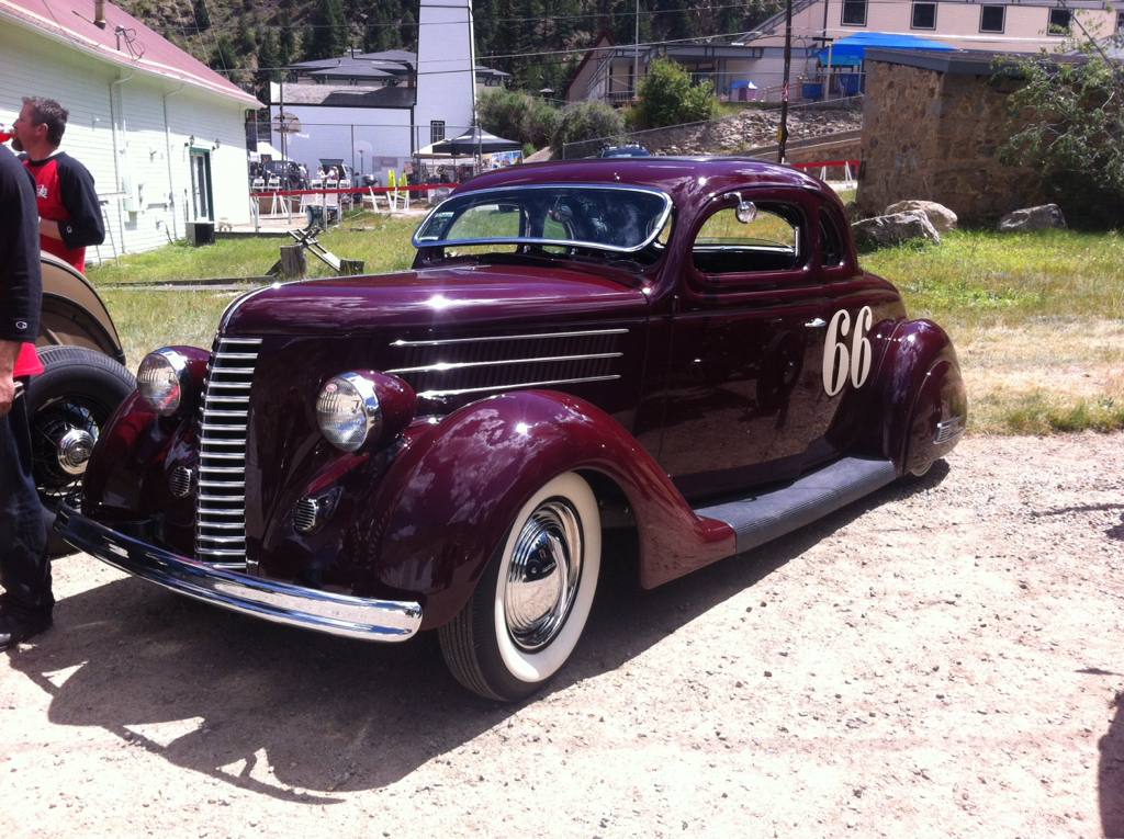

  12. I love this pic Kip. How the surroundings are reflected in the body shows the stunning finish of the bodywork and paint job.

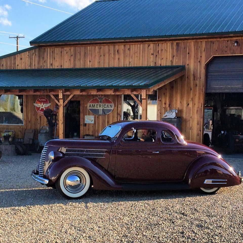

    I just HAVE to post this pic that @hotrodpackard posted in front of his shop. Hope you don't mind Kipp.

  20. Don't mind at all Eric.
