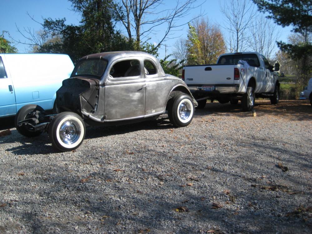

    THE CHOP BEGINS! The goal of the chop is to not lose the roundness of the roof. I think that on a 35 to 40 5 window when the roof is split and lengthened it becomes to flat and looses its character. So the plan is to bring the roof forward and fill the added material between the roof and deck lid. To start everything I marked the rear window to take 1.5" out so as not to make it too small. .[​IMG]

    I then cut the bottom of the window out. Then I cut 1.5" from the side's of the removed piece. .[​IMG]

    Then the roof was cut front and rear and lifted from the car. Past the point of no return now. .[​IMG]
