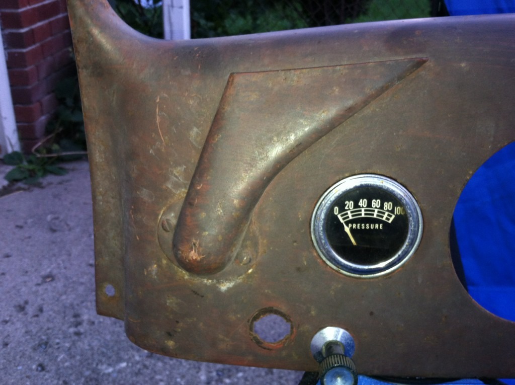

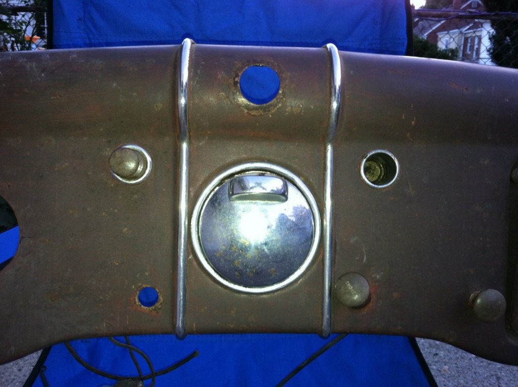

    Thanks Andy. I was going to pitch the vent, maybe someone can use it. I've got a Stewart Warner indicator light that might fit the hole. Other than the window crank I don't know what I could put in it. Maybe just fill it.

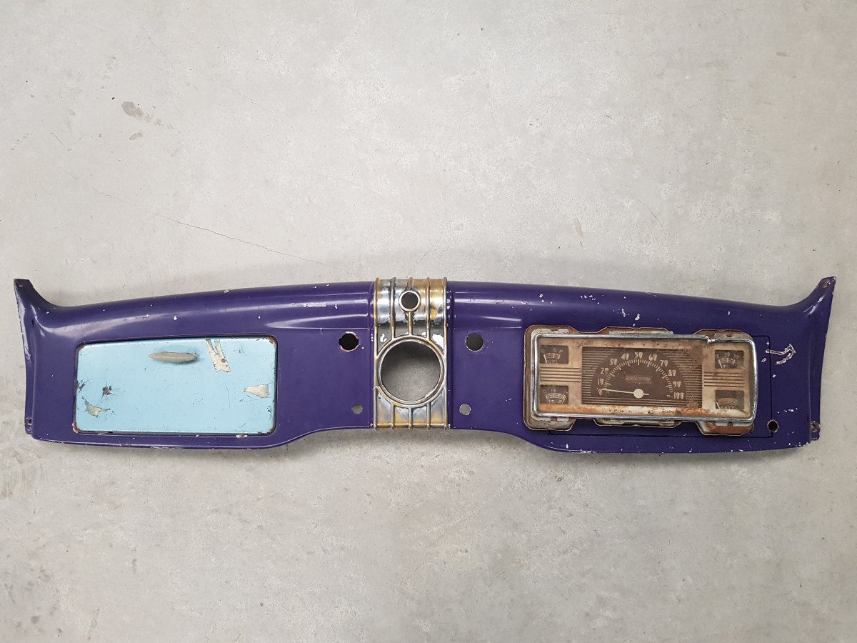

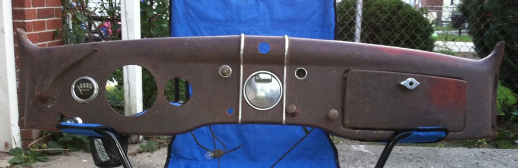

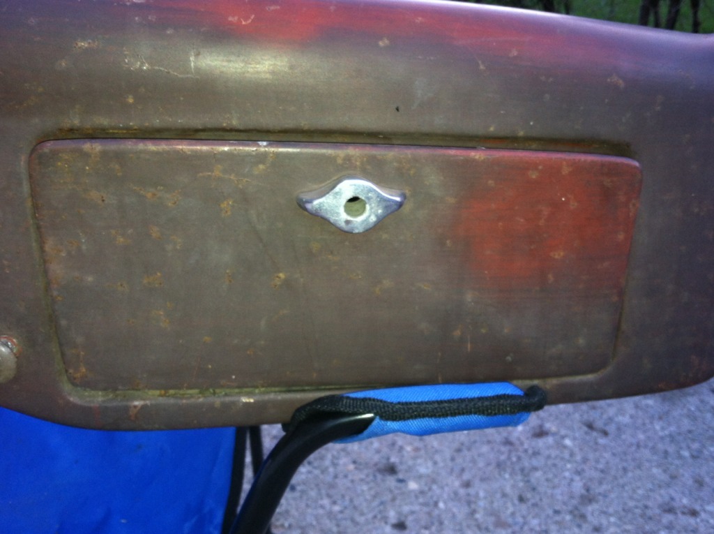

    Hello , your glove box has the " glove box lock" rather than the pull handle . It is missing the lock cyl . They are cool to have so you can lock it . Nice accessory . The vent at the left of the dash is a dealer installed defrost. The left of the the glove box door has the knob that would control the register .They are not highly desirable but A restorer would be happy to get those parts if you do not use them. Your dash is missing the escutheon ring in the center top hole where the window crank would be that would match the narrow stainless strips . A good but kinda pricey solution is to find a waterfall from a Cabriolet or Convertible sedan that does not have the hole for the windshield crank because there windshields are fixed . They are a pretty cool looking waterfall.

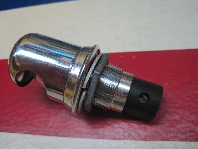

    I'm planning to put a dash light kinda like this one in the crank hole of my '36 dash.

    I've got a flatter rounded one with a red light I test fit last night. Not sure I like the look though.

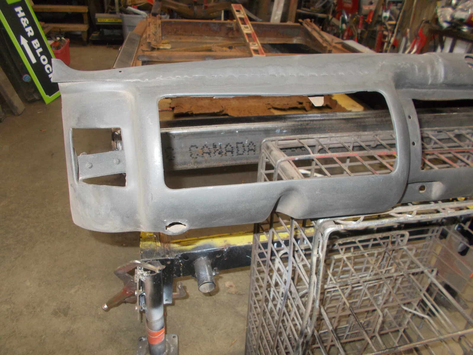

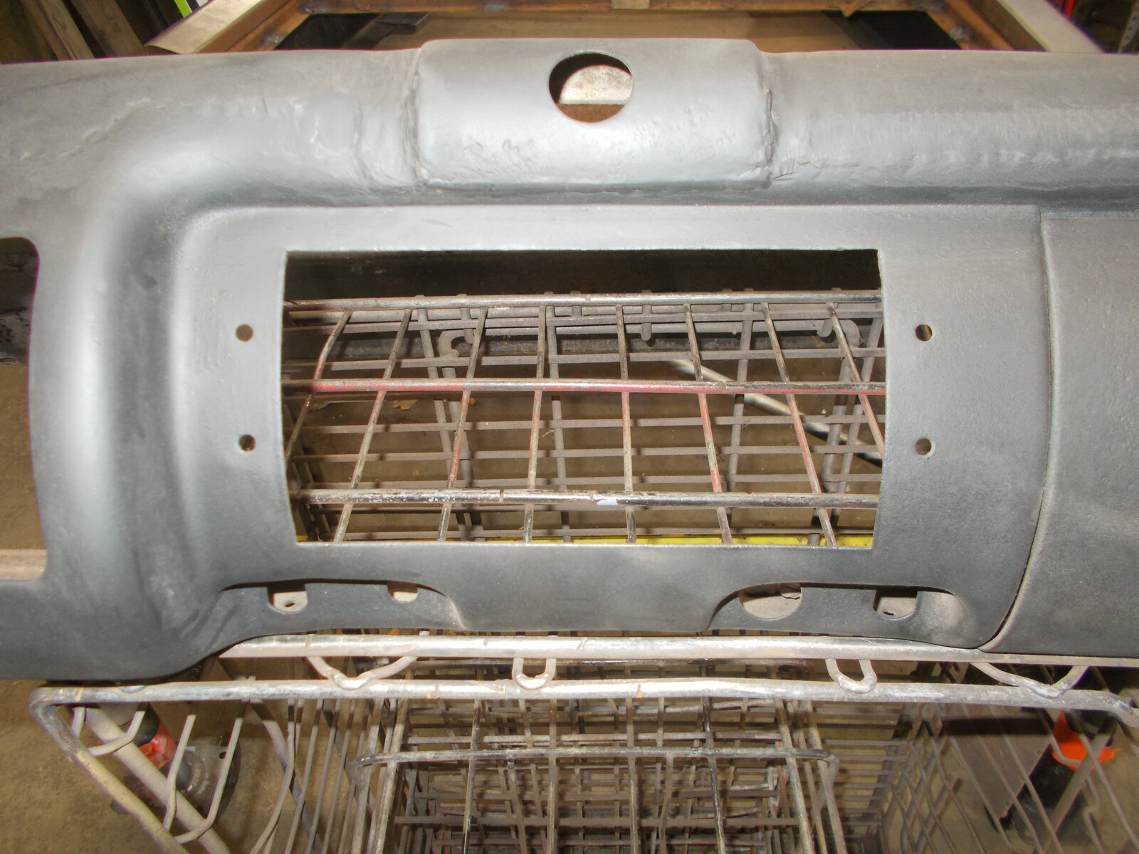

    get a used / trashed '30 - '31 cowl... cut the dash support rail out of it... hammer the bosses flat and cut off the horizontal strip along the base... enlarge the bolt holes... now it will set flush against the stock cross rail...
    bolt the 2 together... now tack your [any] dash to the added rail... remove and finish welding them together... a couple 3 bolts and the new dash can only bolt in in one place... i welded the bolts to the now inside of the crossrail then was able to tighten the nuts from under the swung out windshield frame...
    a couple tabs and bolts on the lower corners to the A pillars and you are in...
    '40 commercial dash shown in my '30 coupster

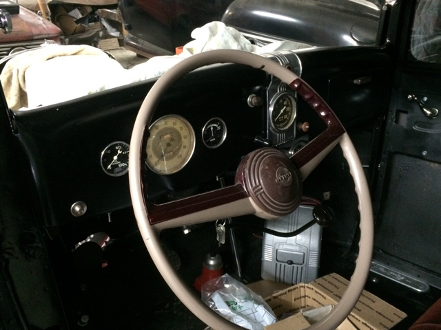

    Here's mine, 35 dash in a 31 coupe. narrowed it abit, and welded end caps on. Bolts in on the original dash rail. Used the waterfall center for an old SW tach. ImageUploadedByH.A.M.B.1470116176.237860.jpg ImageUploadedByH.A.M.B.1470116253.375482.jpg

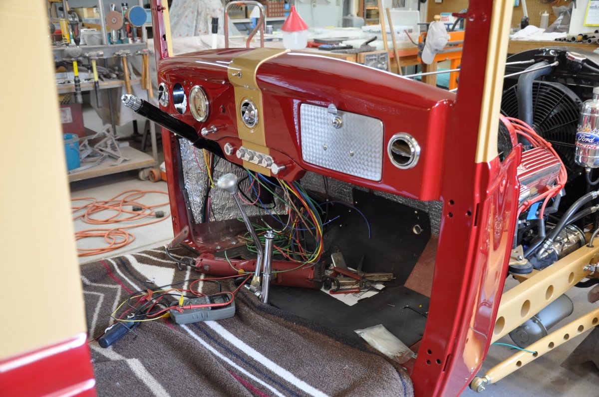

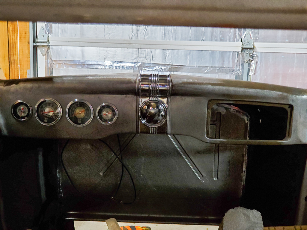

    I'm going to bump this up with my dash pic since I'm pretty happy with how it came out.
    36 Dash waterfall in model a coupe.jpg 36 Dash with Greenlines.jpg 20190607_102634.jpg 20190607_102658.jpg Dash with waterfall.jpg
    It bolts into the stock space. It's a tight fit but it looks like it belongs. The sides were trimmed and flattened and the holes filled. On the front side a piece of trim was made to hide the gap. I haven't seen it done this way but it made sense to me. Fab work was done by Matt Seret.

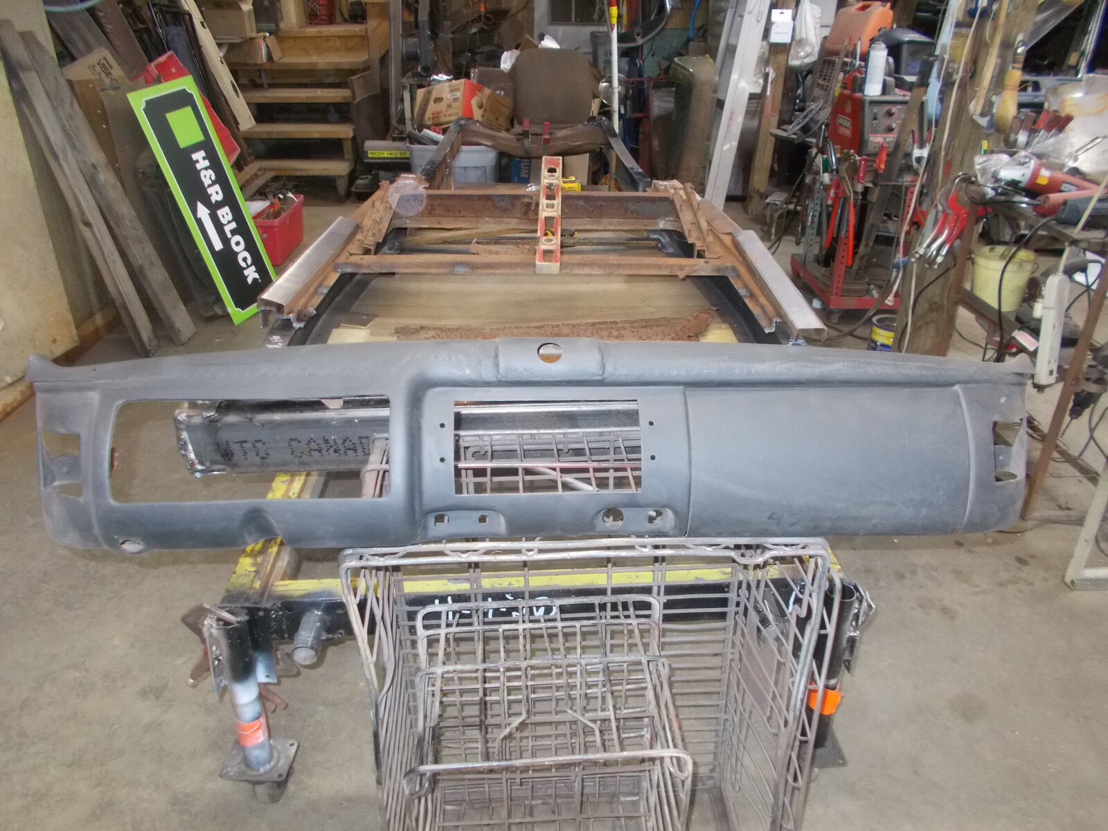

    i have a top half '35 and bottom half '40 dash narrowed for a '30 closed car cowl... have some clusters,
    speaker grills, top half of a waterfall, no ashtray doors...
    the installed dash is one i stuffed into my '30 coupe...

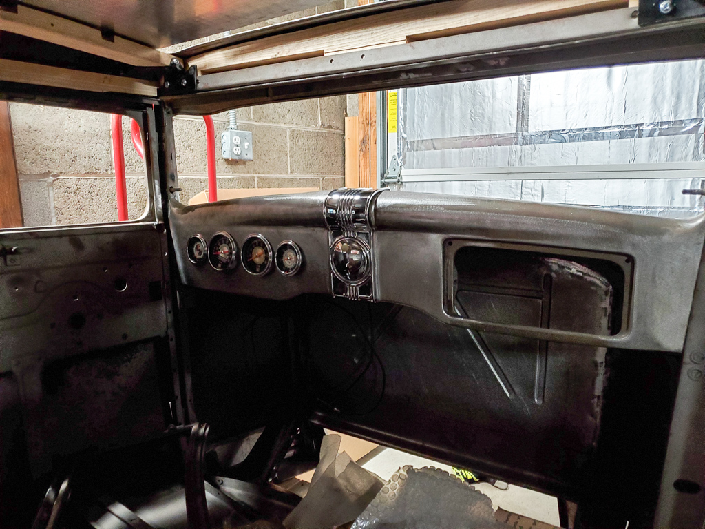

    Installing one in my current project. '30 Coupe.
