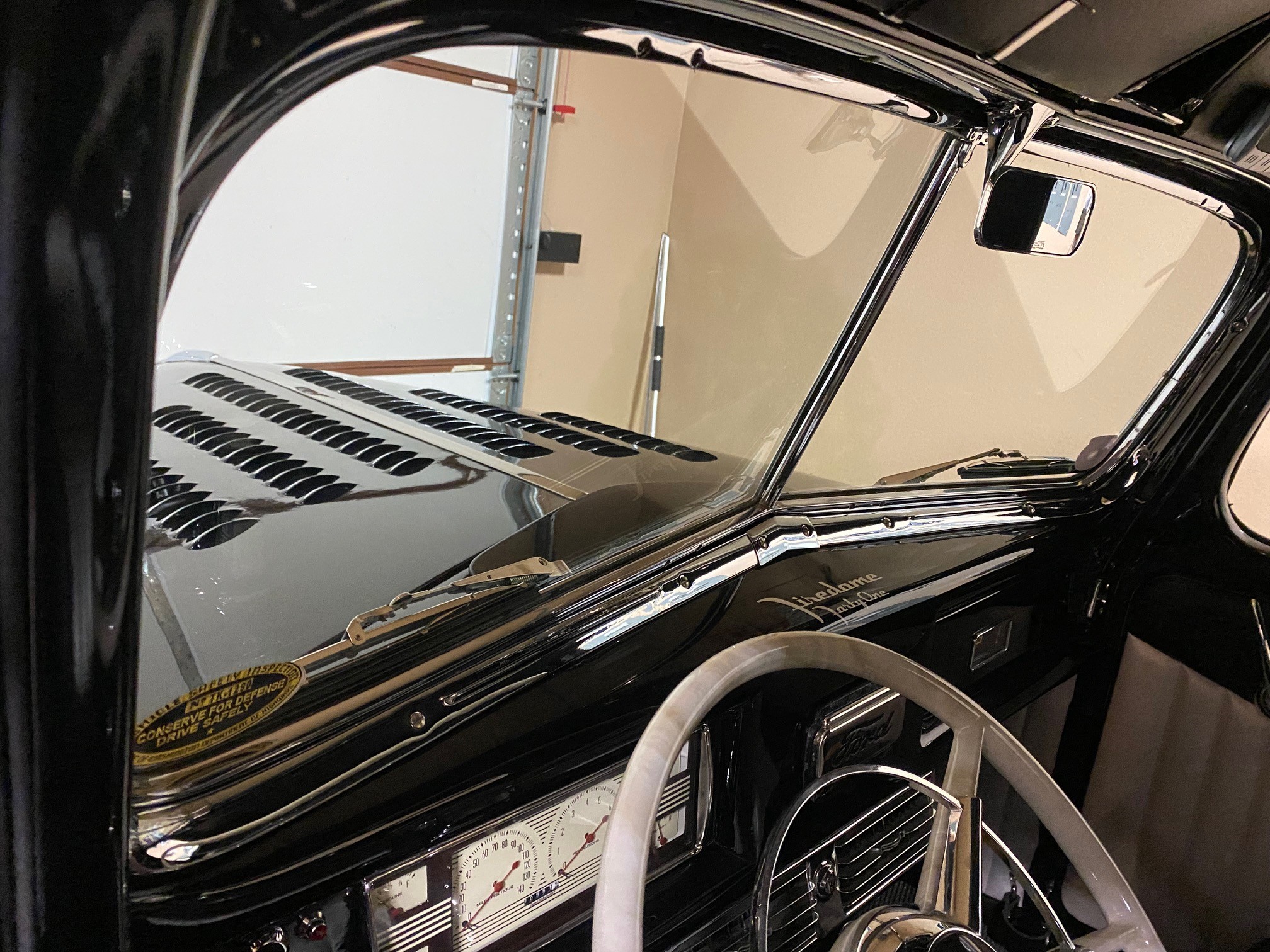

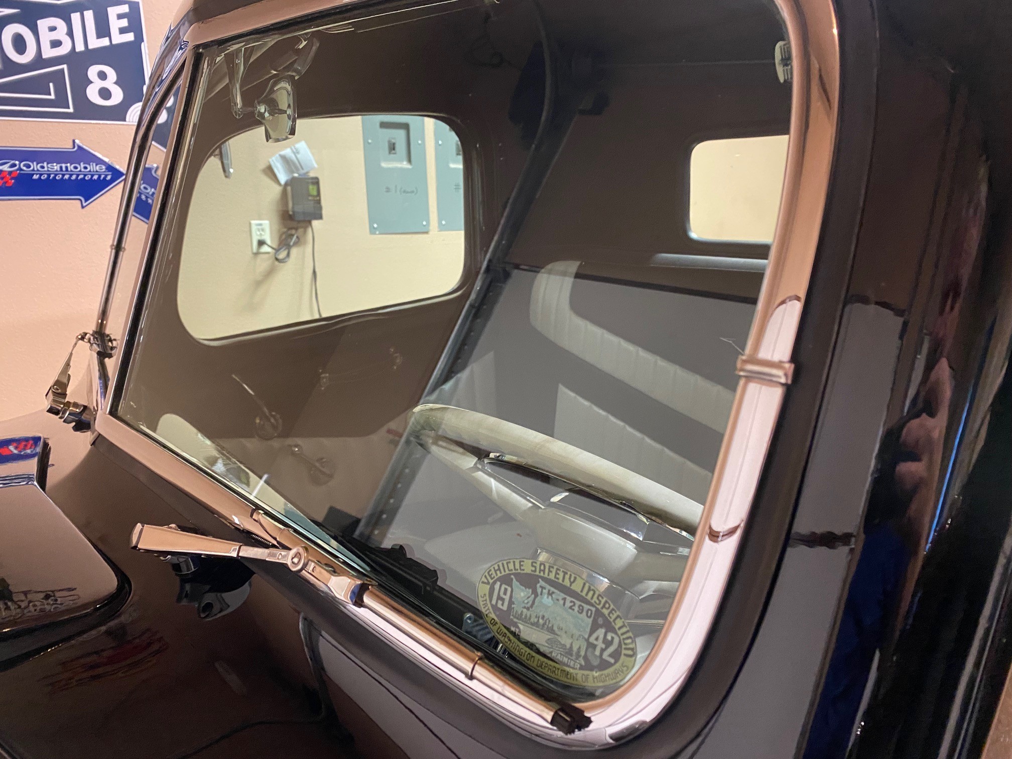

    Sounds like a better idea to me. I wanted a chrome frame around my windshield on my 41 PU because...why wouldn't you? o_O So, I bought a 39 PU frame and chromed it. Had my gl*** guy mount the gl*** using a 39 rubber and I adapted a pair of 36 frame joint covers so you can't see the seams. Jason (gl***guy extraordinaire) had some weatherstrip laying around from a vintage firetruck that he put a windscreen in and glued that to my frame and let it cure overnight. He then used his windshield urethane (or whatever that black goo they use to glue in gl***) and glued the frame into the cab after "painting it" in a 3M primer he uses.
    Looks tight, sealed tight. He said it will be a ***** to take out but nothing he can't handle with his piano wire tool and a lot of masking tape.
    And the 41stock interior trim, that I had chromed as well, fits like a charm still in the factory holes. You can still see the 39 hinge holes in the frame. I need to put some chrome trim screws in those. Anyone know that thread pitch?
    Cool kids have to think outside the box. You are on the right track now IMO.

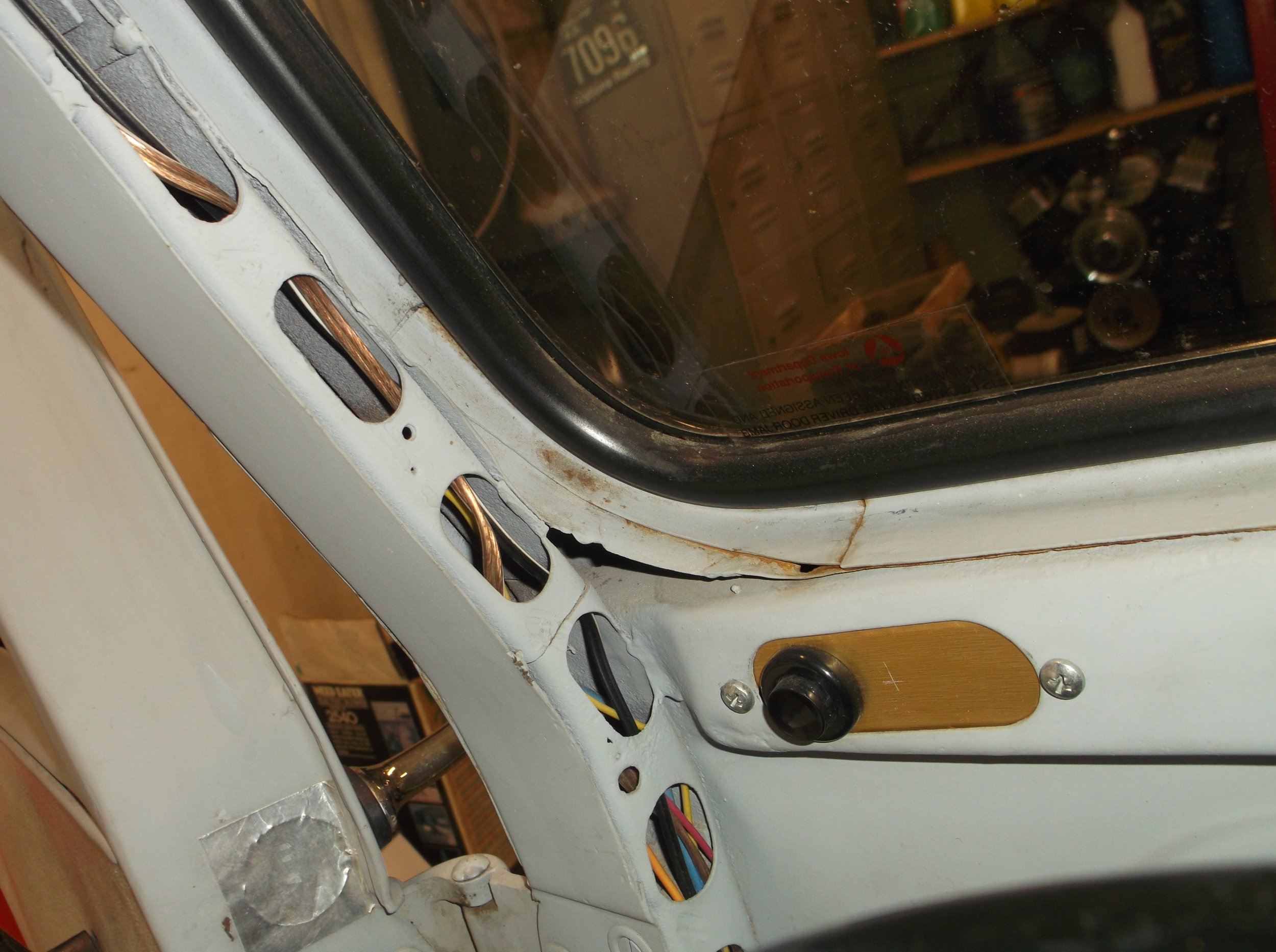

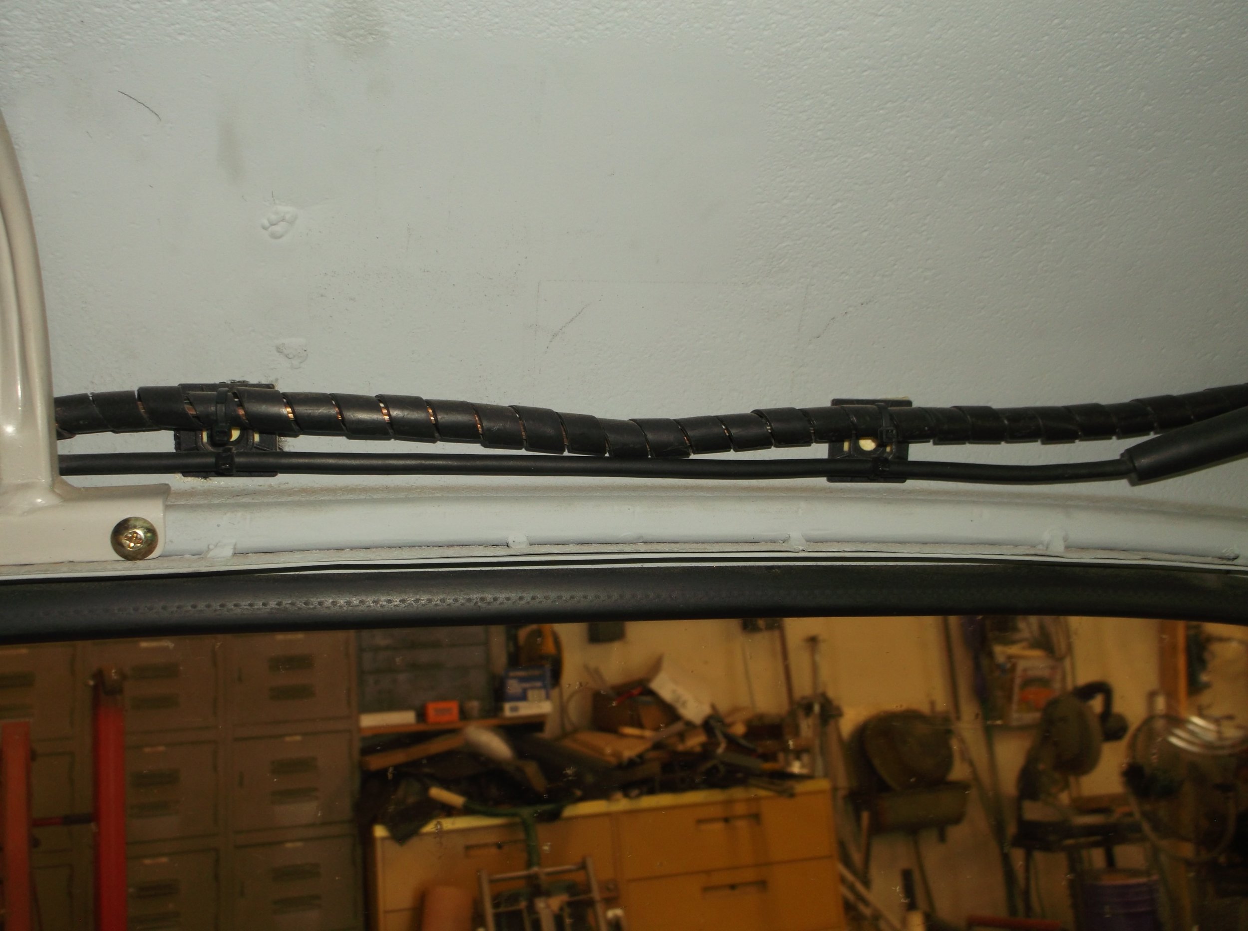

    I didn't have any build pics so I took some new ones. It was always intended to be a bare bones hot rod so I've never finished it off inside. I started buy welding in a bowed 1/2" square tube across the top of the opening to strengthen it. I made forms from particle board of the segments I needed to go around the existing flange of the body sheet metal and hammer formed the pieces. Welded them in, ground my welds and trimmed the inside of the opening to match what the body has and it was ready to paint.
    Gary
