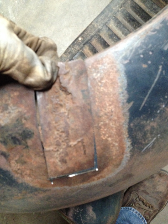

    Lucky for me ... they can withstand a lot of shaping, so I got the torch out and forced it back into submission 005.JPG 006.JPG 007.JPG 008.JPG

    Looks awesome mate, got a five window squirreled away for a future project. Love the stance and the fact you used ifs to make it something a little better to drive. Just a tip, when your replacing patches in any bodywork if you radius the cut lines instead of cutting out a square section the heat signature will not warp the panel as bad. Keep at it man.
