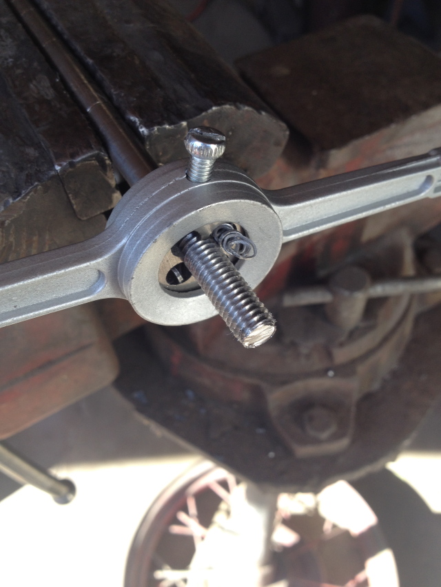

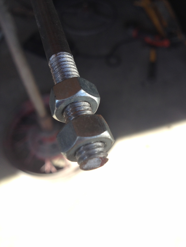

    Also made some fire wall to radiator supports from 1/4 rolled steel.
    Just had to thread both ends: 005.JPG 004.JPG

    What's the length on the rods? I'm fixing to make some rods myself for my test fitting.
  26. Caddy-O
    Joined: Aug 8, 2006
    Posts: 1,664
    Caddy-O
    The rods are 32 3/4" ... with the aftermarket radiator I'm running.
    I just set the radiator and measured out from the firewall to get the length.
