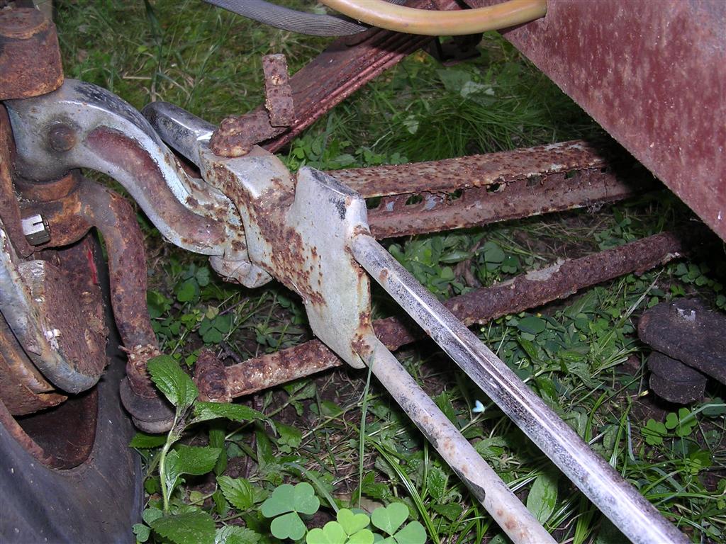

    here is my 1959 built car.
    You can see the angled splice. You can do the same angle splice with your bones, or do the heat/bend up front.
    Mine is a 37-41 axle that has a wider perch distance/wider spring, that was also a Mordrop axle and drilled, which is a bit unusual for a east coast build. Most were not dropped axles, most not chromed either

    Thanks for the pics F&J. I am going the heat and bend route as I like the look of the bones better than hairpins, at least for this project.

    The bones are traditional, and those hairpins are not a normal thing to see on a spring ahead. I can't recall seeing another one like mine.
