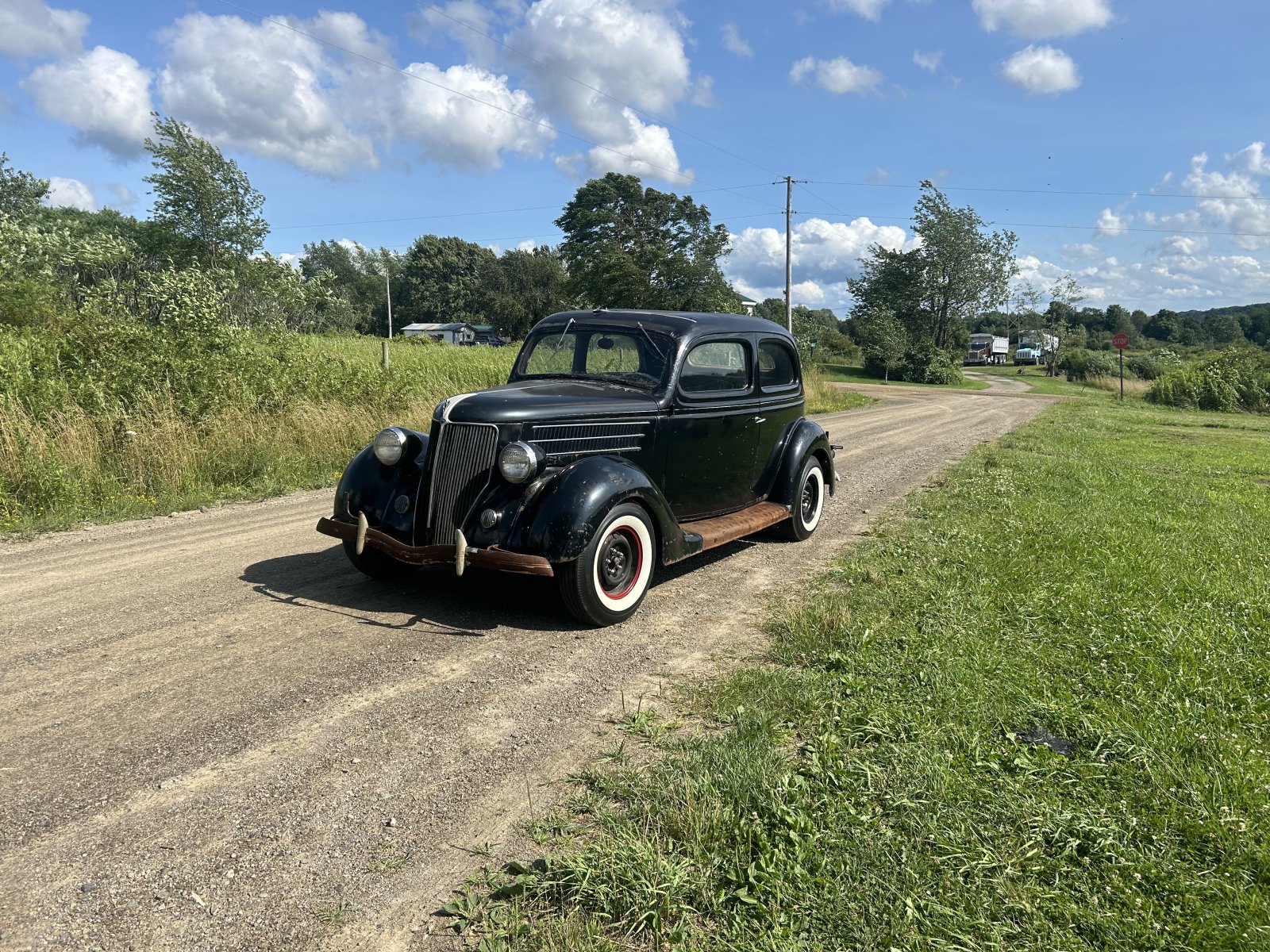

  1. I just picked up this 36 ford. Very excited about it. I want to keep it as original as I can I’m going to be getting an aluminum radiator. I want to change it to 12 volt but would like to keep the generator just convert it to 12 volt
