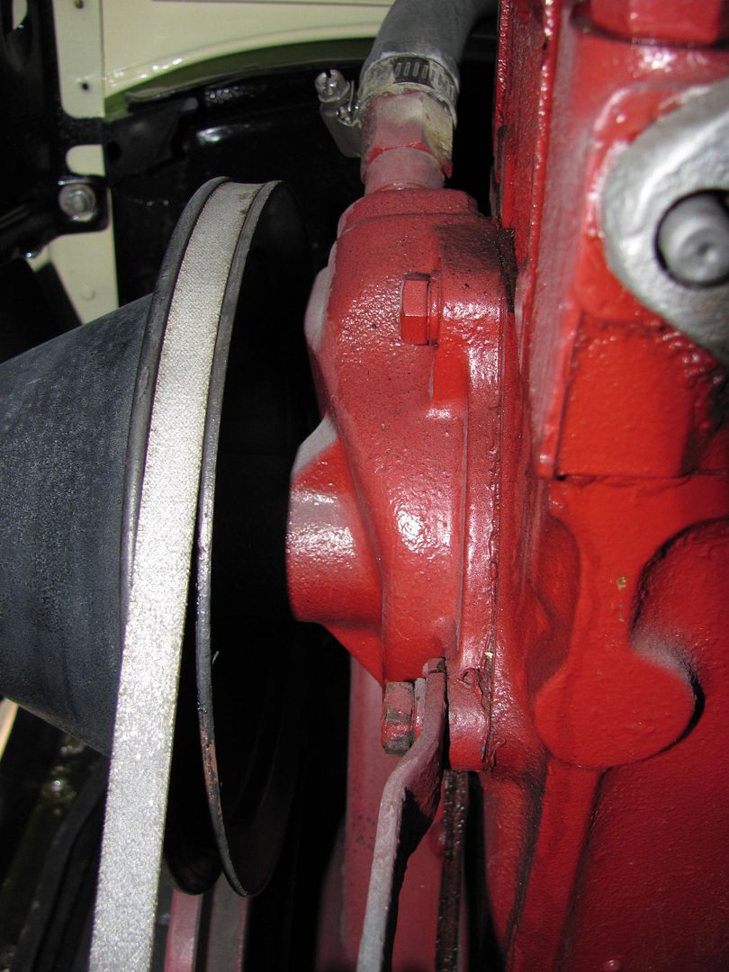

    Well the truck made it home:
    As I've come to discover, these trucks and the 6 cylinder "conversion" are prone to overheating issues. The engine is a 55-57 GM, as per the casting number..
    When the front end (core support) was shimmed to correct the hood gaps, the fan interfered with the lower neck. After t*******, it left this....
    And as you can guess, it overheated on the way home. Supposedly there is a relocation kit to raise the water pump up higher on the front of the block, but I need to know if this is the correct water pump and pulley to use with that kit, or do they need to be replaced. We are going to pull out the radiator for a pressure test and likely recore. The fan will be swapped out for a 15" model (providing that fits ok...)
    So can any of the 6 cylinder guru's familiar with this kit tell me if I need a new pump/pulley or is what we have compatible?
    Oh.....and something else needing some buffing touch-up when that is done...

    Thanks for the link, yes I've seen that kit. But I needed to know if the pump and pulley presently on the truck will work or do I need to get something different?

    You buy a new "old" pump for a 216/235 from 1941..1954 - and you put an older harmonic balancer with a smaller pulley on it so as to not overspeed the new pump (which has a much smaller pulley) . . .
    Typically you take these parts from the original 216/235 that you pulled from the truck - but in this case, your original motor was an Oldsmobile and obviously completely different.
    So in summary -
    Adapter Kit
    New pump from the auto parts store (comes with a pulley on it - pick the pulley width to match your generator)
    New Harmonic Balancer with a pulley width to match your generator
    New Belt
    New Fan
  14. MP&C

    We had planned to remove the front end during the water pump relocation, and given some slight leaks found in the radiator, it only made sense to go with a new one while apart. Although they did not have a direct replacement due to the air deflectors and mounts on the original, props go out to the guys at Walker Radiator. We sent them the old radiator to salvage the rare parts for the new radiator, and they sent a replacement in short order. Their price was just a few dollars cheaper than a recore from a local shop, and they used new tanks....so he should have years of driving ahead. It did take a couple trips to the local Napa store to get radiator hoses that match up to everything, so the owner did get a "treasure map" list of all the new parts that went in. He has been driving it with no further issue with overheating.
