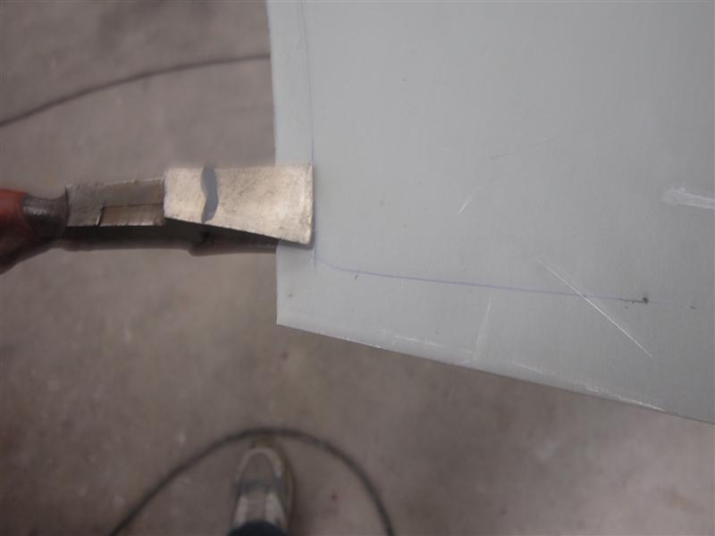

    I've noticed you using a large adjustable wrench for bending some of the flanges,I do a similar method using Glaziers pliers.
    I really like the stance you've achieved and the chop is niiiiice !!
    Keep up the great work :)
  23. Kenneth31coupe
    Joined: Feb 24, 2010
    Posts: 670
    Kenneth31coupe
    from Sweden
    Thanks Kipp.I think this was a little bit easier than yours.Didn´t have to cut her up like a jig saw puzzle like you did.
    Thanks.
    Thanks a lot. About that door it´s not finnished yet but the gap is smaller further down.. There was so much job with it so I just freaked out and left it for a while,will go back at it when I´ve got some new inspiration. That is a really nice plier you have there, looking for similar ones over here but they´re not easy to find. A friend have two of them but he will not part from any one.I have one that´s wider and when folding long straight edges it works but when the fold curves it´s too wide.Think I will have to keep looking.Thanks for the input.
