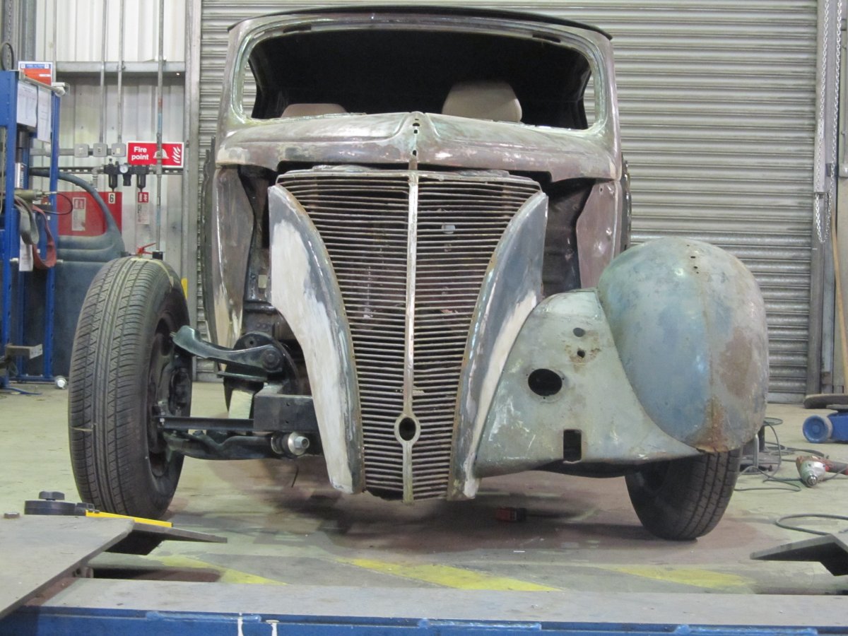

    image.jpeg image.jpeg image.jpeg Hi Kenneth....really like what you are doing with your 36. Here's a pic of aluminium rear fender I'm using on my car. I bought the pair of rear fenders on eBay uk. The middle pic is my car which started life as a uk 1937 ford v8 model 62 four door sedan.....I think the front fender is very similar to your fender in third pic where you welded up the seam. Bob in Scotland
