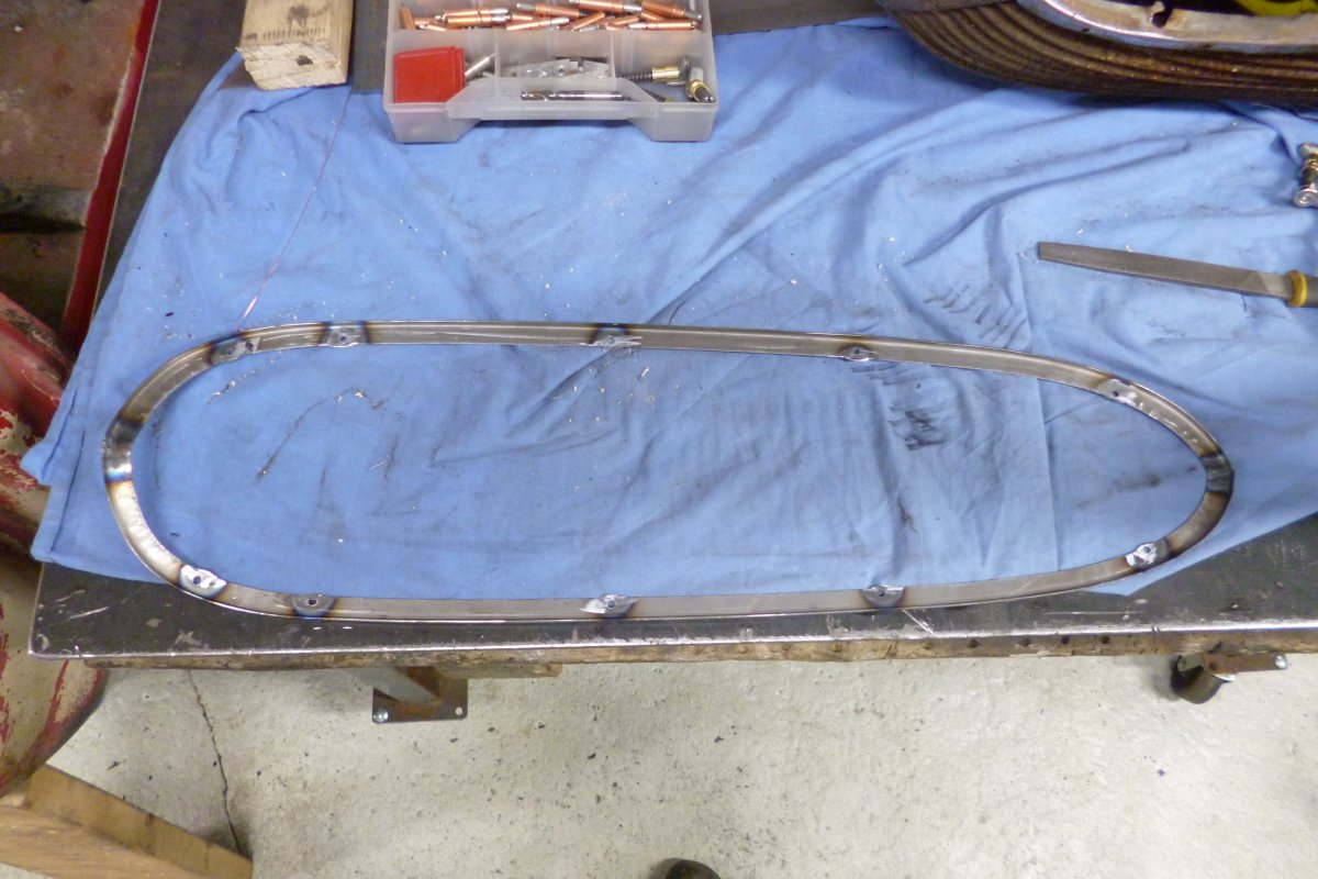

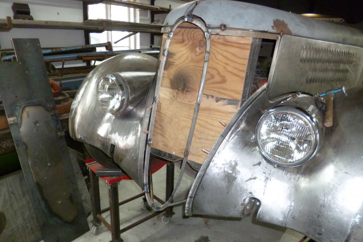

    Some more progress. Have done some work on the grill surround. Made a frame for the grill and mocked it up in the right location holding it in place with some round bars. Rolled a plate to cover the gap . P1030705.JPG P1030737.JPG P1030740.JPG

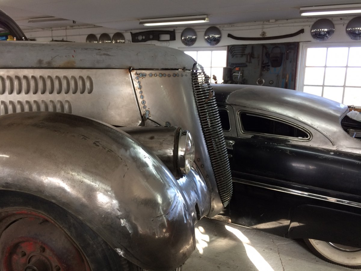

    Appriciate the kind words. Thanks.Got the other side done and working on the bottom part.

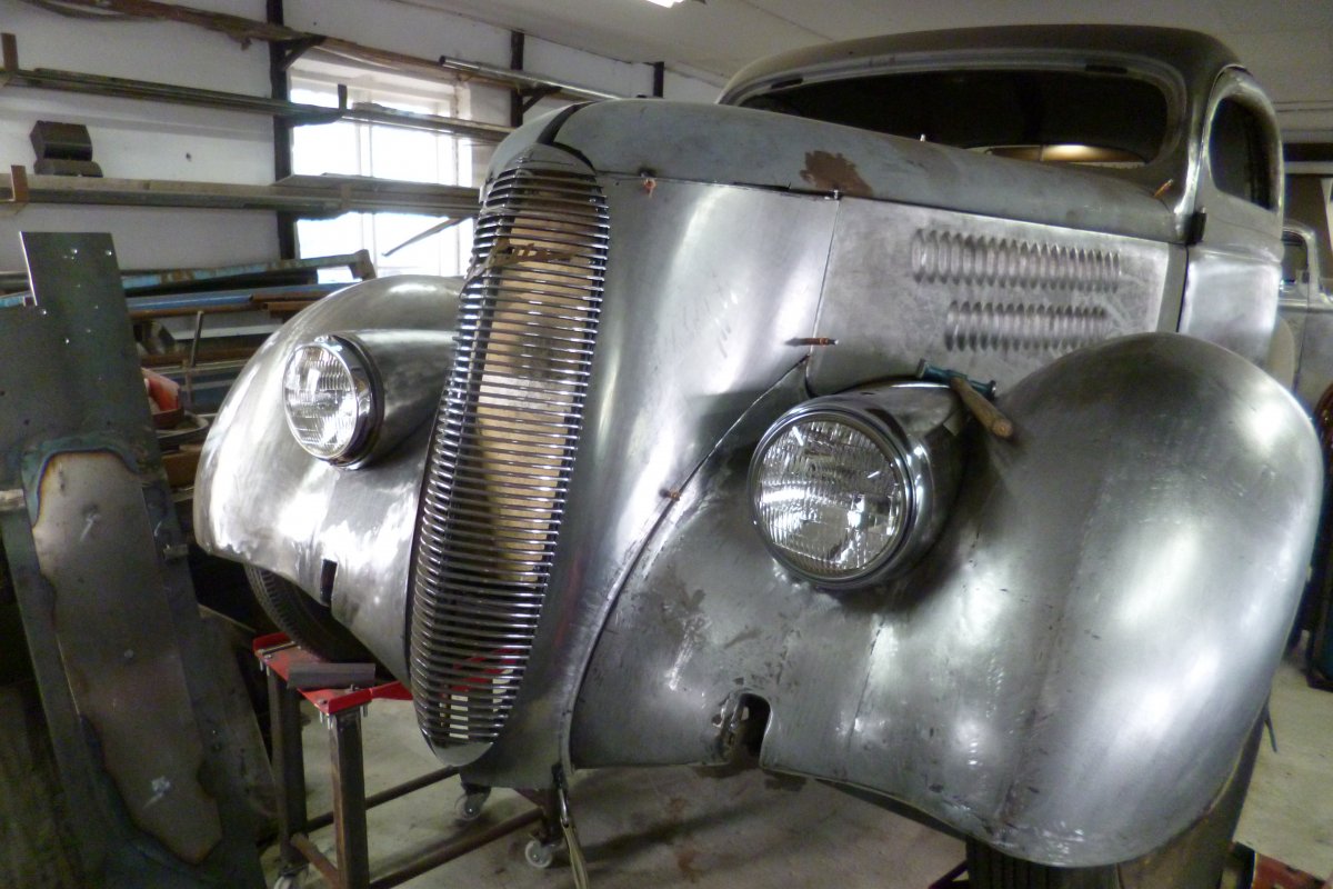

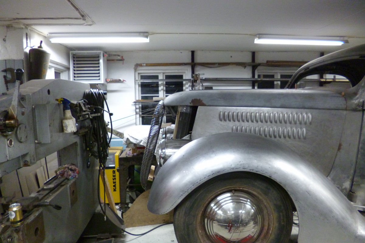

    Just to let you know that I´m still alive I post some progress. Not very much but still progress. Got the bottom part of the grill surround done and got the car back on the floor to see how it all looks from different angles and distance. Think I´m quite pleased with it.Now it´s time to do the front part of the hood to make it blend in and flow with the grill.
