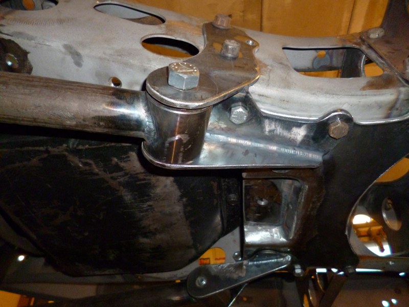

    Started with the front wishbone today. I´d split it and gonna attache the ends to the x-member. Made a fixture to mimic the spring and center of the car so I could bend the springmounts and bring out the rear end of the bones. Welded on same sort of ends and using same bushings as for the rear. Gonna make some brackets that will be bolted to the x-member .Made the outer one and testfitted but will round of the top a little more. For the inside I gonna make a bracket that will bolt to the plate I made for transmission mount.

    Finnished up the mountings for the front wishbones today.
