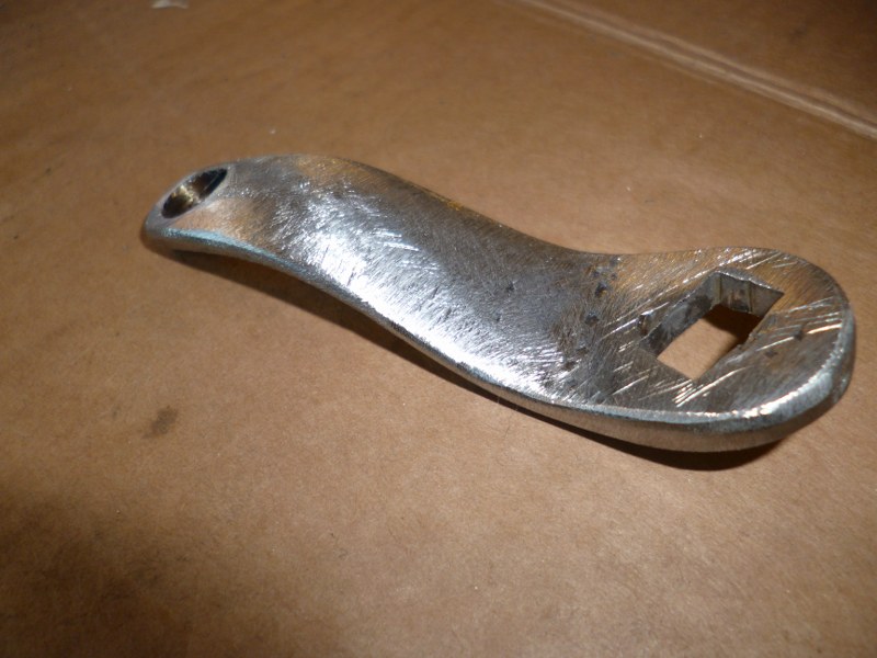

    Made some small parts for the shifter today.Running a 1940 column whith column shifter and coupled it up to the 350 ******.Had to shortend the shifter bar to clear the engine. Cut of about 1-5/16" and also removed one of the arms. Made a new arm to put on the ****** and one rod to fit between column and transmision

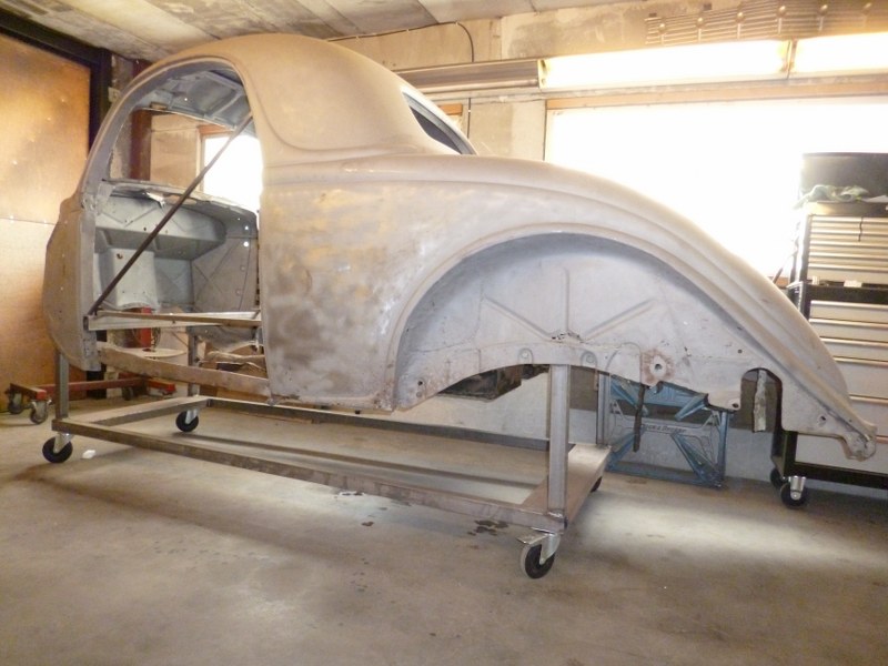

    Posting some pic´s of the body I have to deal with.Needs a lot of TLC but absolutly not hopeless.Cut out what was left of the floor so I can set it on the frame.Need to built new rockers and subrails.The roof have been filld some time in the past but the channel for the insert is still intact and sitting under the filling piece.The guy who did it must have cut out the channel, fill the roof and then put it back for reinforcement.Have´nt decided yet if I will keep the filld roof or open it up and install an cloth insert.Any way I have to split the roof when choping it.

    Got the body on the frame today. Had to cut some in the firewall but when I´m filling it again it will look like stock only some wider recess to clear the distributor and heads.Think it got a nice tail dragging look only it´s too high in front.Gonna replace the front spring with a lower one.

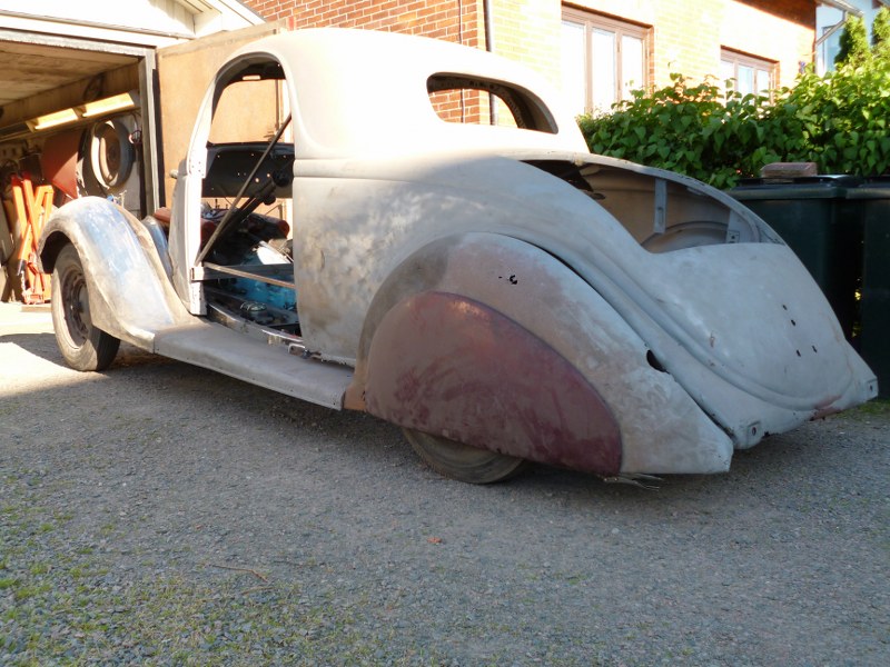

    Just could´nt resist.Had to mock up with fenders and skirts to get a glimpse. 2 inches lower in front will be great but the *** sits just right I think.

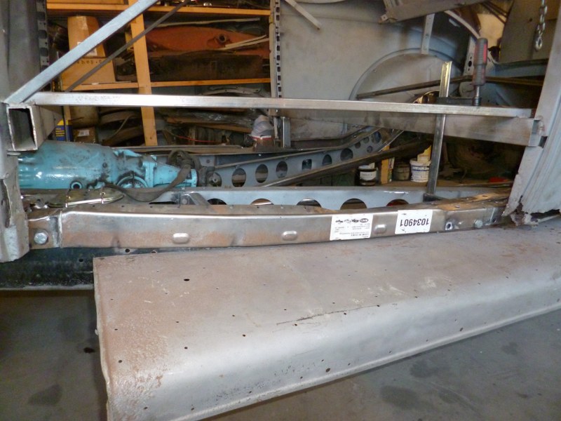

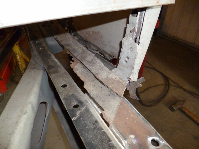

    Started today and try to clean this mess up.Both A and B posts looks like **** where they are supposed to attache to the frame.The rockers was totaly distroyed and replaced by some totaly wrong pieces.Have some new rockers from Bob Drake to start with and then I´ll try to build some new mountings for A and B posts. Have absolutly no clue of how it´s supposed to look like. If there´s anyone having some good shots of off these parts I´ll be very pleaced if they were posted here.Spend half of the day me***uring and trying to get the body sit right before fixing it up to the frame.Had to mount the running boards to have as reference.

    Damn, those pillar footings are fugly. Will try to get some pics of mine up later today...
