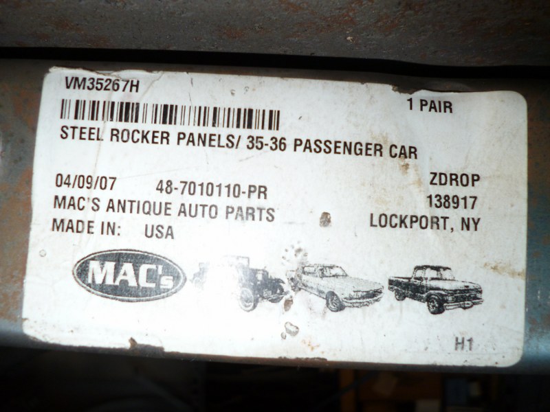

    Thanks Aaron.The rockers came with the car when I bought so I ´m not sure of the part number and they comes from Mac´s not Bob Drake as I said before.Took a picture of the lable that´s sticked to one of them if that can be to some help.....Kenneth

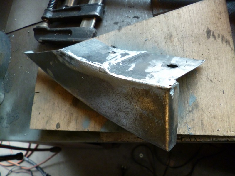

    Did some work today on the driverside a-pillar.What I can read out of the fragments I´ve got there is four different pieces joining at the foot of the a-pillar.First there is a reinforcement and then there´s the subrail.Next is a support for the a-pillar and least comes the foot of the pillar.Did the reinforcement and the subrail pieces today and conected to the rocker.
    Here is the reinforcement piece
    This is the subrail piece
