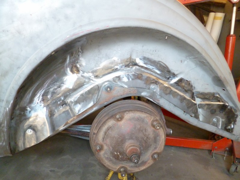

    YES!!! The wanted add paid off. Thanks to two Hambers I now have a 38´Lincoln dash on its way. I´m really thrilled over this. Now when I have the real deal I don´t have to build one my self.Also have made some progress on the rear subrail. Made an L shaped sub structure to extend the subrail all the way back to rear pan.Now I have this to attache bouth rearfloor and wheel well too.Also made a new piece for the lower outer part of the b-pillar

    Got the driverside b -pillar foot done today.Took me some time to figure it out how it was done originaly and not sure it´s all authentic but I think it´s good enough for me.

    Little more progress from today.Got the patch for the quarterpanel welded in and smoothed out with hammer and dolly and some work with the body file

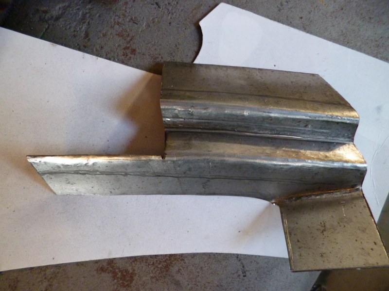

    Have started on passenger side subrails and piller foots.Thought that I could show you the process of making these parts since I only showed you the finnished pieces before.Started with the subrail piece.
    Used an adjustable wrench to brake the flange.There´s to much material so I have to shrink it back.I´m doing that by hammer and dolly untill it have the right shape
    Here it is fitting against the radius of the cowl side patch panel

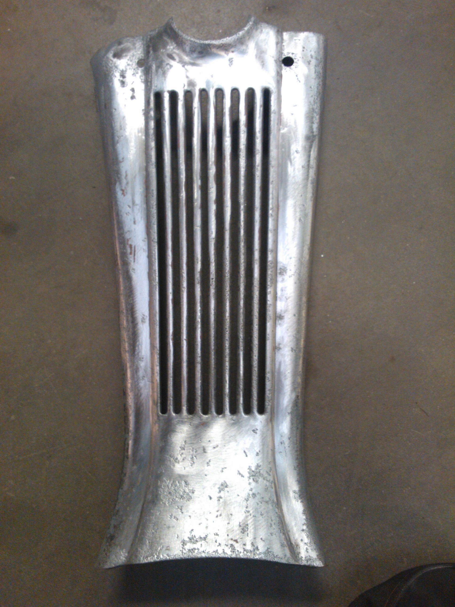

    Here I´m doing one of the pieces for the A-pillar.This is the part with the pocket for the door hinge.Using a 3/8" flat bar and holding a hammer as pictured and another one to hit the first one to create the step in the plate.
    Here´s the opposite part with some reinforcement for the door hinges bolts.
    Welded together.
    Grinded and drilled for the hinge bolts.This is the outer part of the pillar.
    Here it is welded in and primered with weld thru zink spray.

    Cut out a plate and braked it like this for the iner part of the pillar foot.
    Then I run it in the pullmax to create the bead.
    This is how it looks after the pullmax.Needs some hammering.
    Again I´m using two hammers to form the bead.One for shaping and another one to bang on the first one.
    After a while it looks like this.
    Drilled some holes for each corner of the square holes and cut with the anglegrinder between the holes.
    Here it is finnished.
    And here it is welded in the car.
