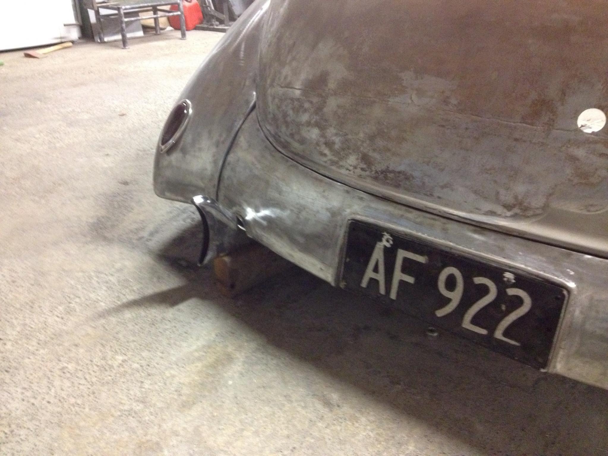

    Here's a pic of the back pan scoloped out for exhaust and resestd for number plate. Have some fishtails I might use. Hindging back guards is a good idea never thot of that. Was thinking having some sort of quick release on the airbag and shocks. So diff drops down enough to get wheels off. Thanks for comments guys.

    Front suspension is ht hk Holden with comodore steering rack and hq brakes. witch will be airbagd. Rear end is 8 inch ford with disc brakes triangulated four bar and bags. Most ch***is work is done. That guy had a lot of really good parts. I got a sedan with this coupe was going to use it for parts but was a bit to good to strip down so swapped it for sbc and th350. Mite have to make trip up to drop off head lights and have a look at your Tudor.
