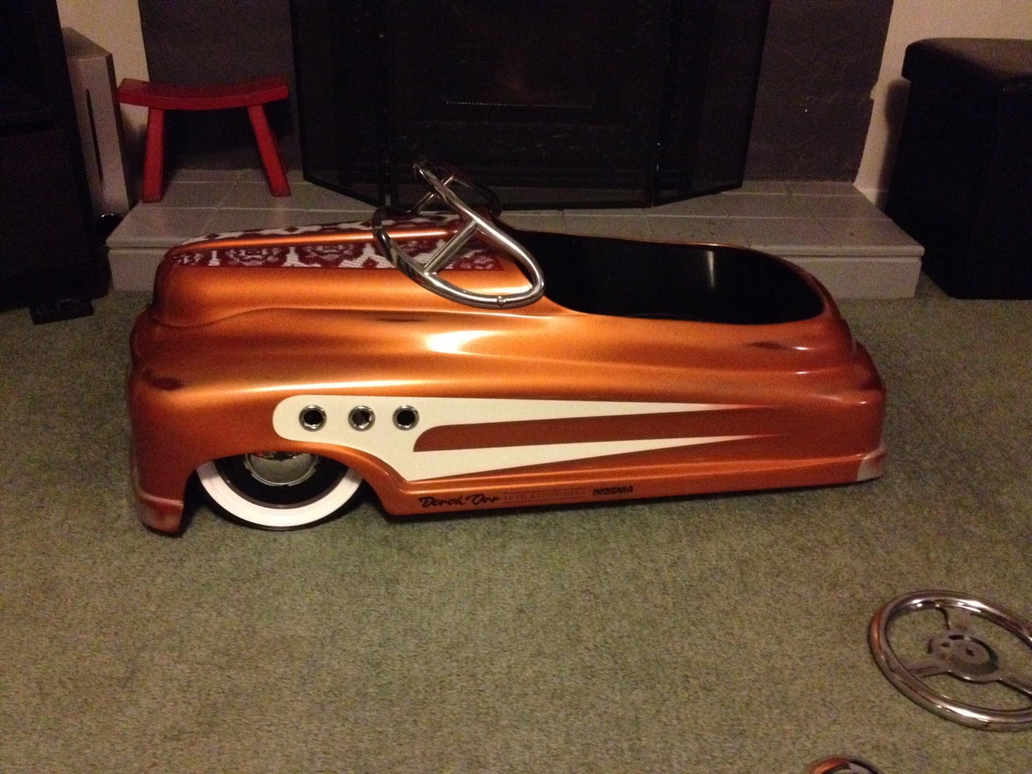

    Haven't done much on the hudson lately been busy doing a pedal car for my boy hope to get back into it next week so will have some more up dates then

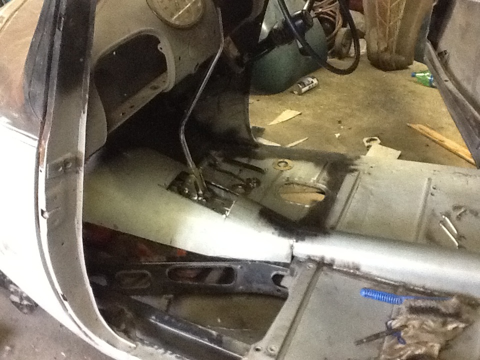

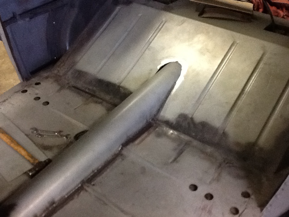

    Finally got so time to do work on my own car. Been working on the floors then body off to get blasted and epoxyd.

    New Lokar shifter

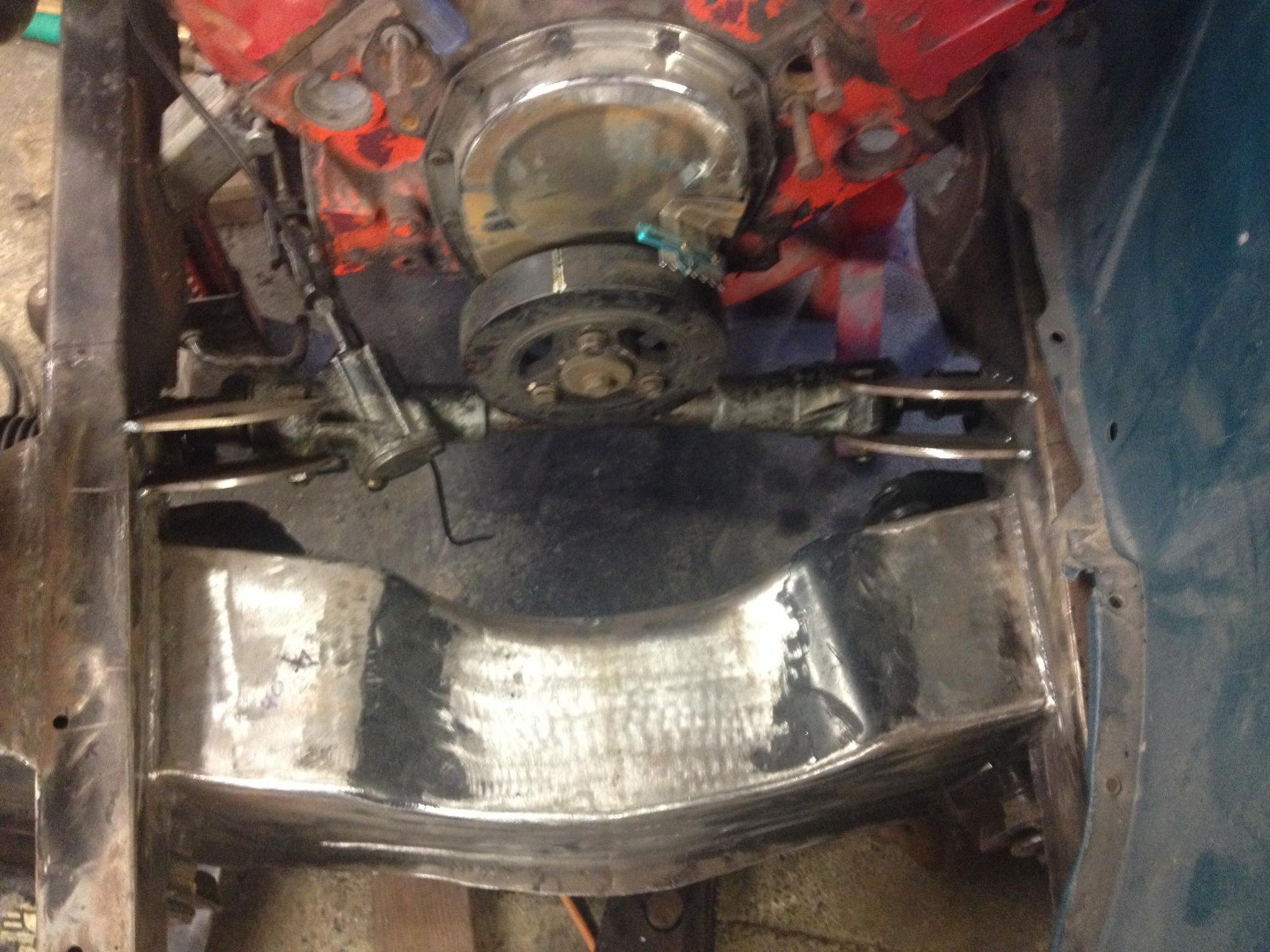

    I hate doing things twice but I've had to cut the front end out and narrow it 3 1/2 inches to get good steering lock it didn't have much before also remounted the steering rack as was not set up rite when I got it and had bump steer.
    Been busy working on headers and re made the drivers side to poke out threw the guard and run under runningboard to clear steering and breake booster ect it's all a tight fit under there. That's for all the comments. Will get some more photos up soon keep for getting to take them while works on it.

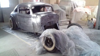

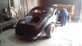

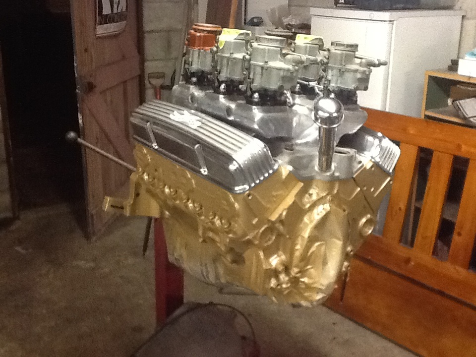

    image.jpg image.jpg image.jpg Sorry guys it been so long since last posted. Haven't really done a lot on it in awhile doing a bit of a labour swap my cars been stripped and primed while I'm doing a bit of steel work on a chevy coupe. Here's some photos. Also got motor all painted up.
