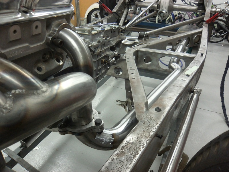

    However I have managed to fabricate an exhaust system that I'm reasonably happy with (version #3:rolleyes:)
    I started off by making up some 'traditionally' shaped flanges, in a similar style to my header plates.
    I've always liked the sound of a big single system running through a 'turbo' style muffler (never been a fan of the split twin pipe 'rasp') so I bought the longest stainless oval muffler I could find and set about feeding two pipes back to a common inlet.
    Another pet hate of mine is an exhaust that is visible in side profile, and with this frame sitting so low, the only place to go was thru' the frame rails.

    Got a similar layout in my '63 Nova with a built 327, and it sounds just plain nasty!:D
    So I figured if I followed the same theme, but quietened it down a bit with a longer muffler, I should have a nice compromise between bad*** hot rod and smooth custom.;)
    I originally planned to run a 2 1/2" pipe down the left side, and bring the right hand pipe across under the oil pan (version 1), but when I put a finned pan on there was no room to move, then I started bringing another primary down the right side, but it was too big to snake around the pedals (#2), so I ended up redoing it all in 2 1/4".:rolleyes:
    Everything is 'cut and pasted' from u-bends and straight pipe.
    Then I brought the right side pipe across behind the trans.
    This required ovalling a couple x-member holes for clearance, and to be able to thread the flanged sections through the frame for final ***embly.
    In order to join the two pipes together, I made up a y-pipe, stepping up to 2 1/2" to handle the combined volume.
    I used stainless from the y-pipe back, mainly 'cos I already had some in that size, and the muffler is stainless too. Everything is gonna' get coated eventually anyways.
    The tailpipe is going to have to come later, once I receive and test fit my gas tank that I ordered from Drake around 12 months ago:(.
    Meanwhile, I made sure that the cross pipe sat exactly level from behind, 'cos that's the only piece of the whole system anybody is ever gonna' be able to see when its finished, and even then they will have to be laying flat on the ground under the rear end to get a glimpse!:rolleyes:
