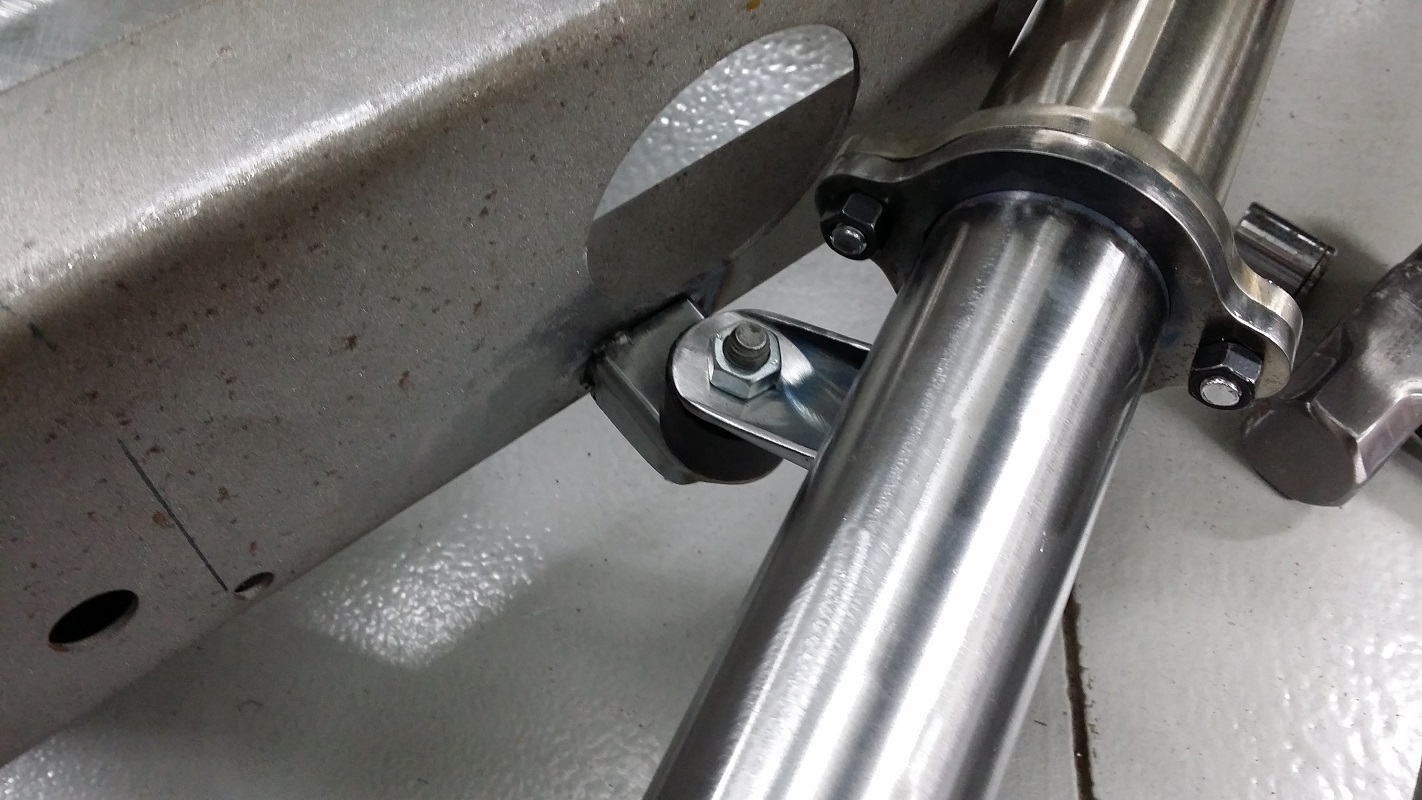

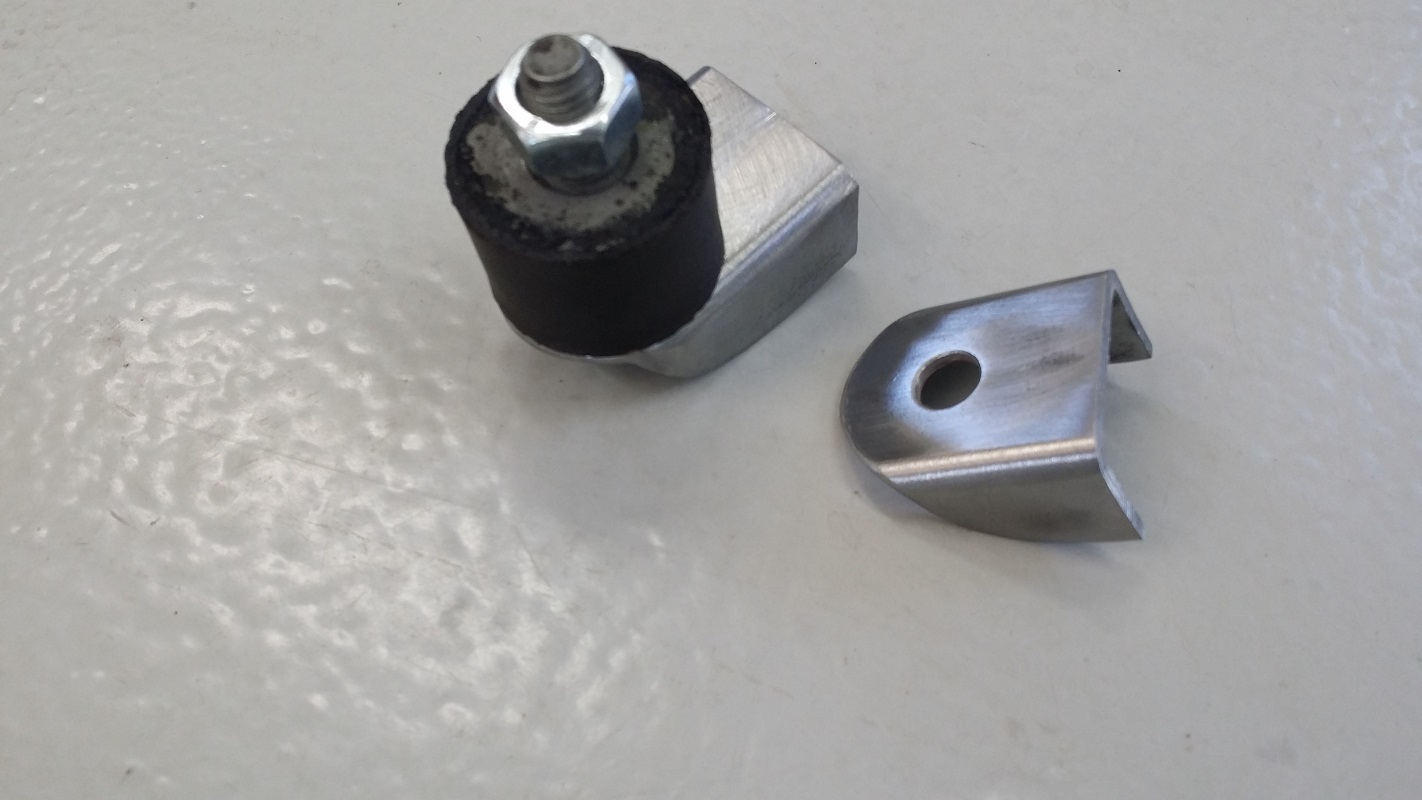

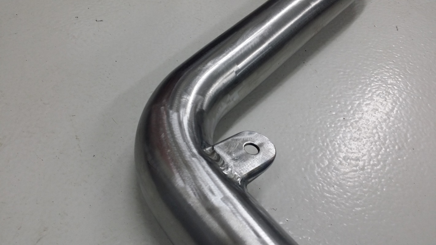

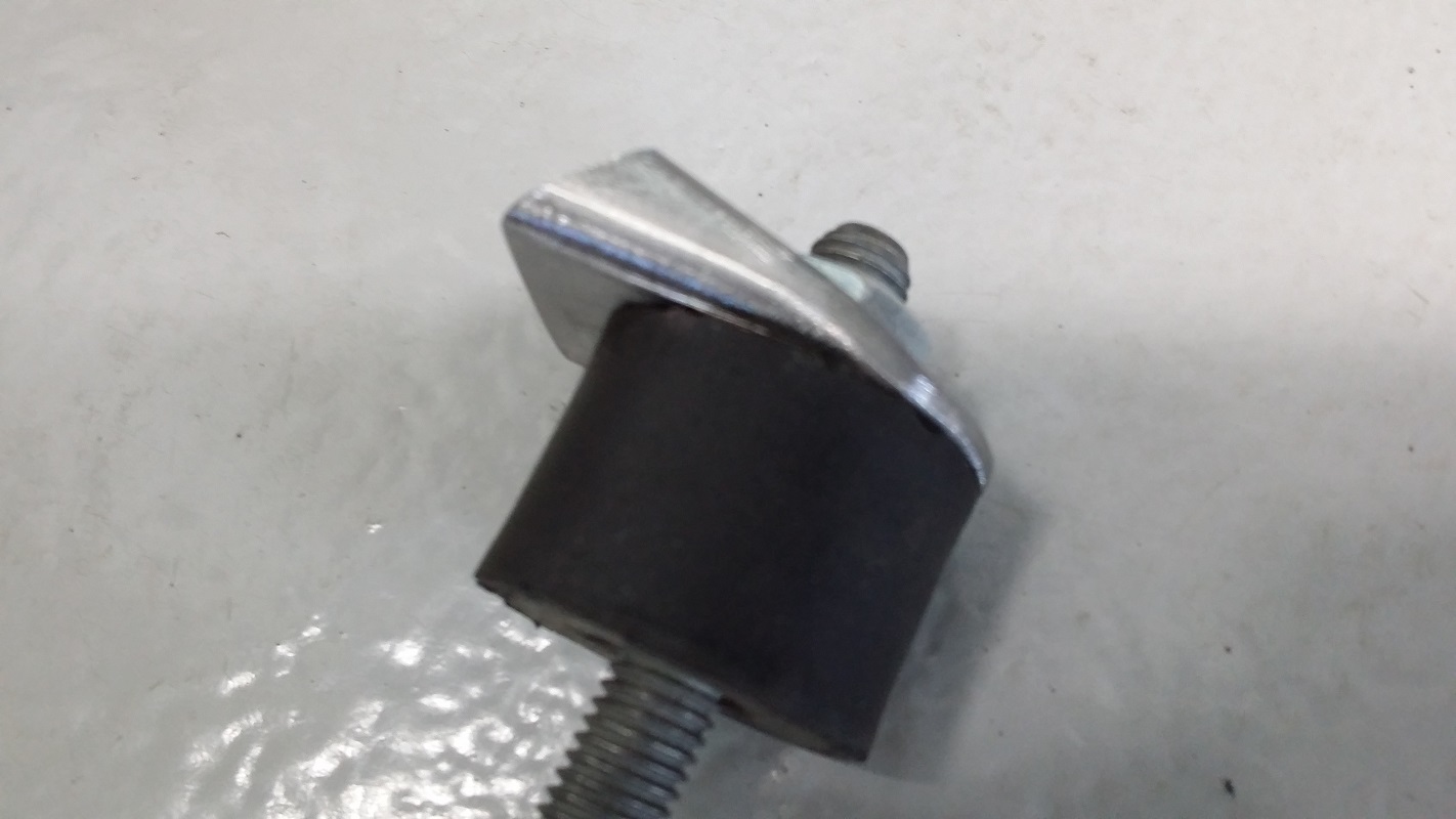

    I had been stalled for a bit on the exhaust, trying to figure out a tidy way of mounting the exhaust without going too high tech. In the past I have often used Morry 1100 type 'cotton reel' mounts, but they seem to come apart under load. I looked around at other options, but couldn't find anything else that was neat and compact. The other problem I've got is that everything fits pretty tight under there, so I couldn't have anything that allows too much movement.
    I did find a slightly beefed up version, and after a bit of experimentation, I figured out a way where I could mount them in compression, rather than tension or shear, so hopefully I have got the delamination problem beat.
    I made up some compact brackets to mount to the frame
    along with some tabs to weld to the pipe. I figured the side gussets will help spread the load across the pipe, to resist the tab tearing the thinner wall of the exhaust tube.
    This way, all the load goes down on to the mount, pushing it together, rather than trying to tear it apart.
    Now I guess only time will tell if I got it sorted....

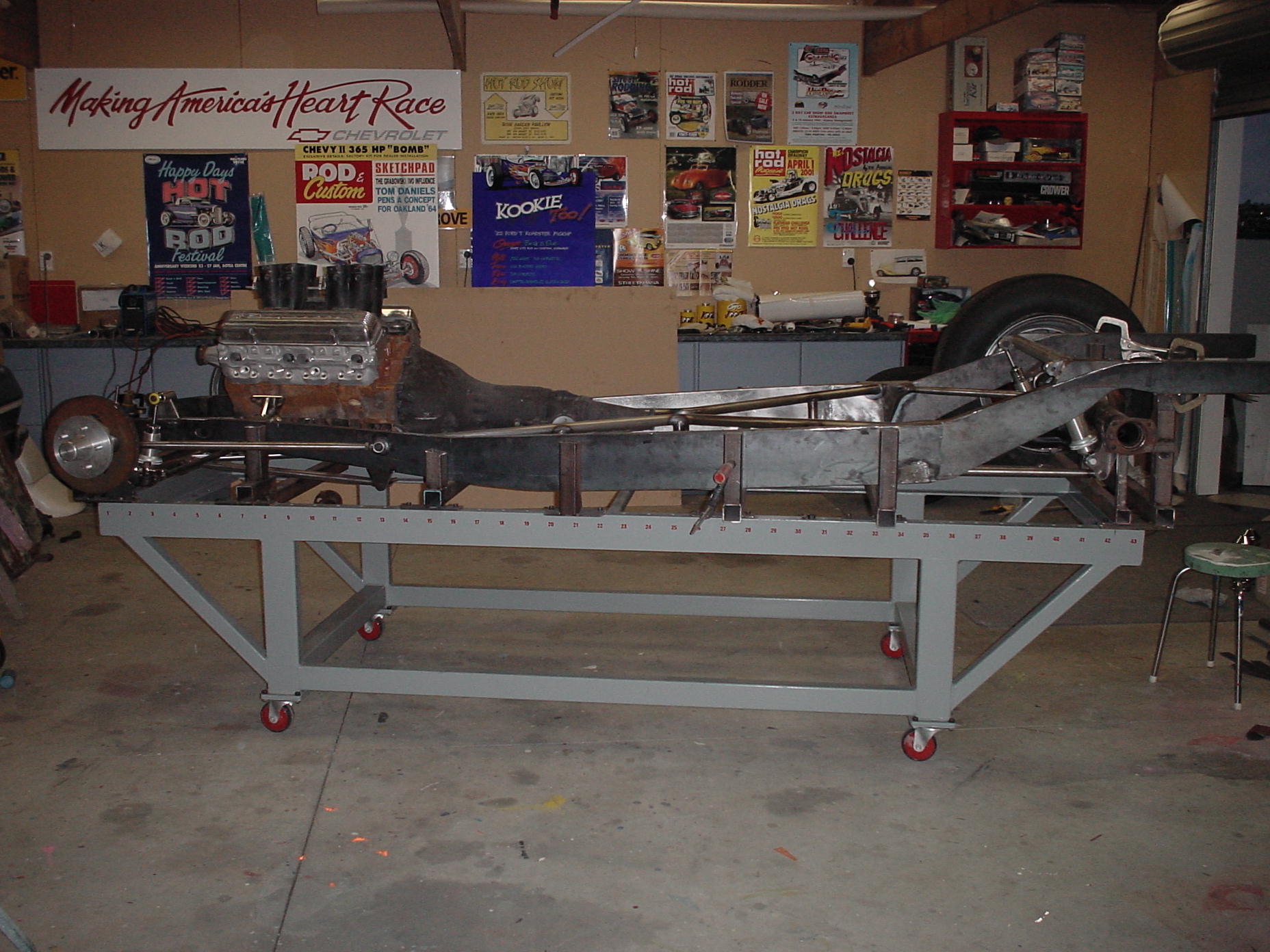

    I've been in tear down mode lately, getting the frame stripped down bare so I can complete all the welding on it. Once I had the body off, I took the opportunity to test fit my new Drake gas tank to make sure it was gonna' clear all my modifications. The fit looks good - I just need to trim the flange slightly at the front corners where the frame is kicked up over the rear end.
    The tank was a helluva' deal. I got the '37 tank that was on special for 99 bucks, figuring I was gonna' be modifying the filler neck anyways.
    While the body was out of the way, I did a bit more work on running the muffler and tailpipe. I'll finish it off when it's back up on the jig with the gas tank in place. Things are getting real tight for space about now....
    I kinda' new that the quick change was gonna' be lost under the back, but the gas tank really makes it disappear altogether.:(
    I'm hoping its gonna' be real noisy, otherwise I may as well have just slid a 9 inch under there...:rolleyes:
