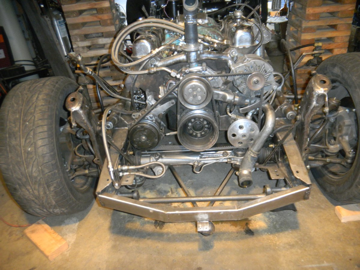

    I know this has been an embarrasingly long absence, but there has been a small amount of progress in the last couple of months. I finally got the frame stripped down bare, and pretty much got all the welding sorted. It's not as pretty as I would have liked, but then I'm only very much a 'hobby' welder. 2015-06-16 01.33.56.jpg
    I skipped around a fair bit to try and control any distortion, and checked everything for straightness when it was all done ...
    I've also had 3 weeks in the States since I last posted, so there's a bunch more parts coming back on a boat in the next month or so. We checked out a heap of '36s while we were over - they seem to be everywhere right now - so I've picked up a couple more ideas on some of the detail stuff for mine.
    Now I've got no excuses.....:rolleyes:

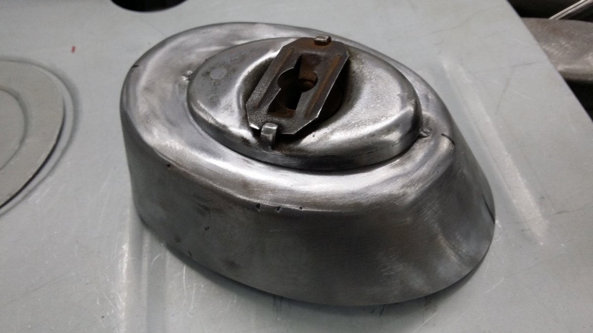

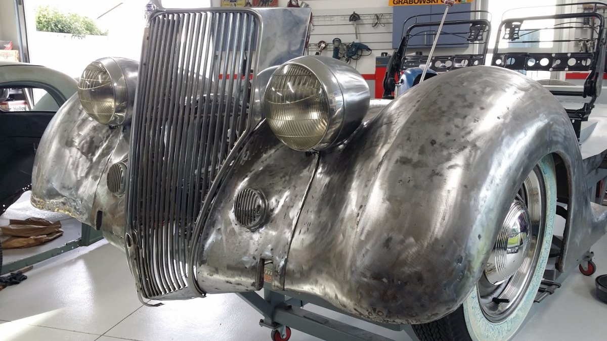

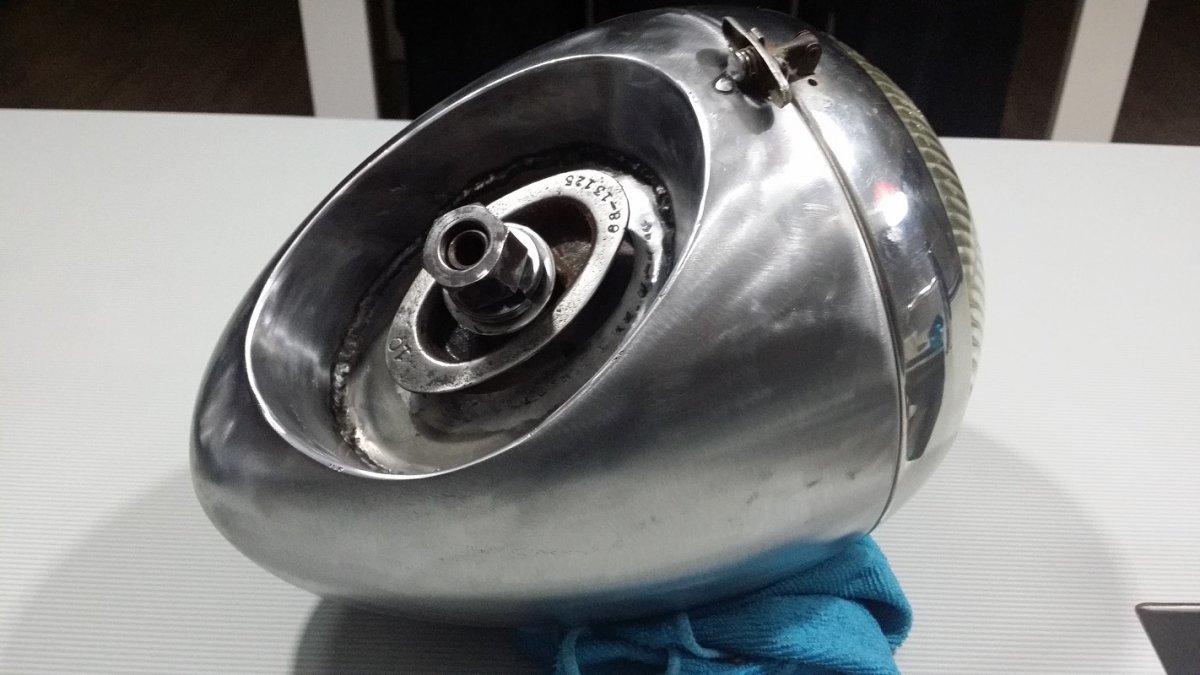

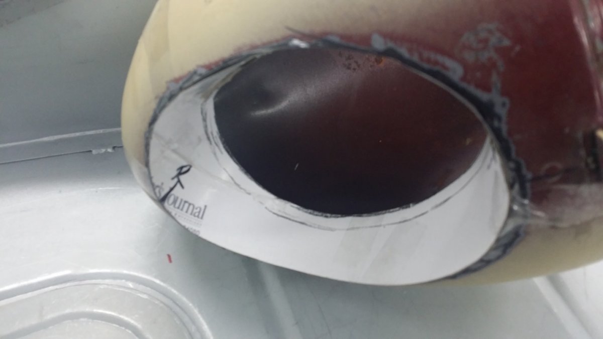

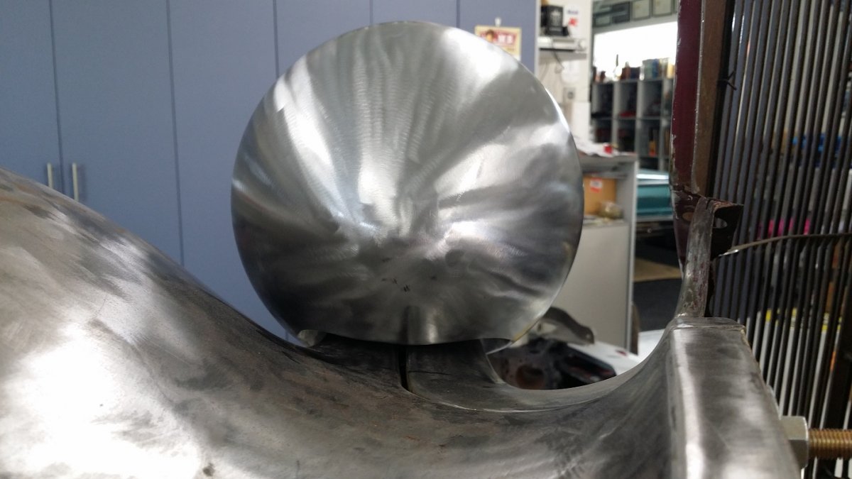

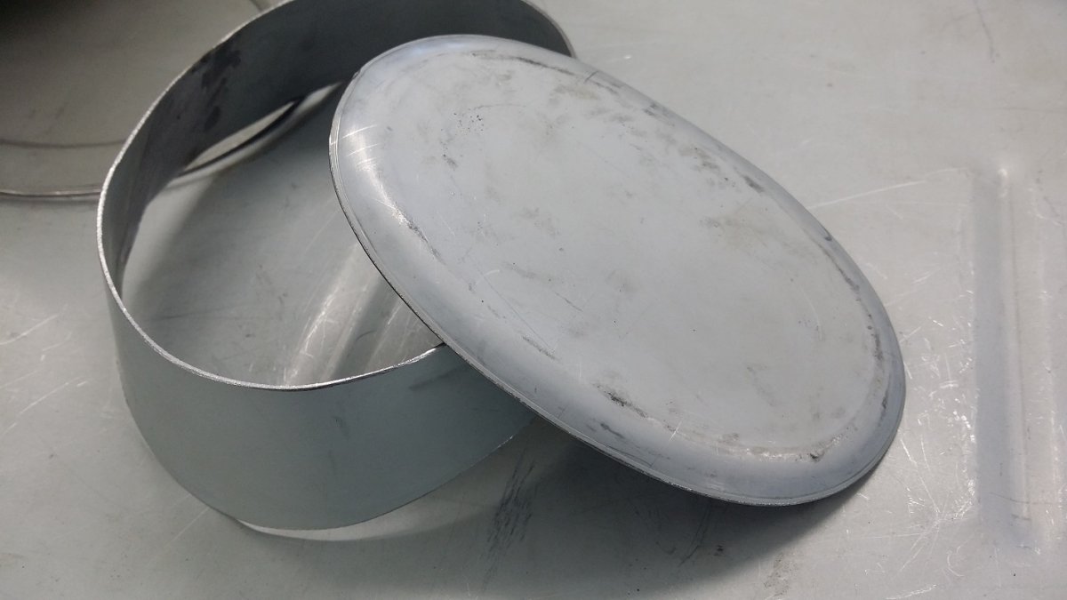

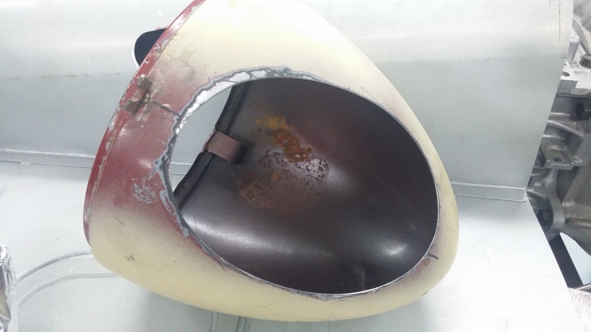

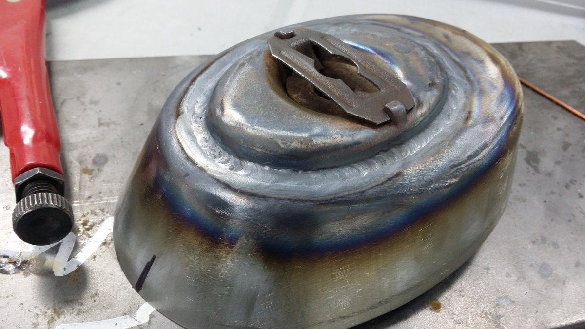

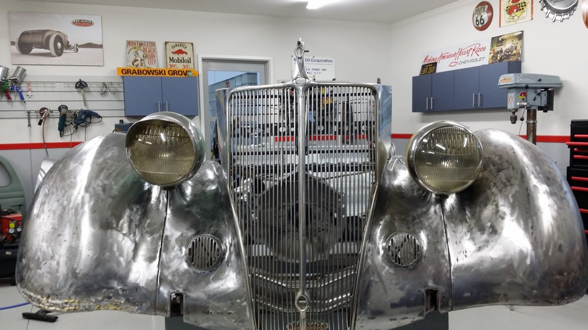

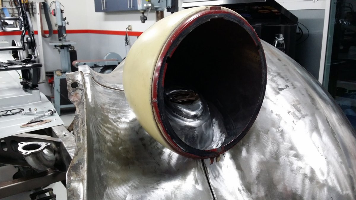

    One of the jobs I have completed is the lowering of my headlights. Never been a fan of the LaSalle grille / 40s Chevy headlight deal - I've always thought the stock '36 front is just about perfect, just needing a little clean up and fine tuning.
    I wanted a substantial drop on the lights, so I cut out the base a little at a time until I got the light setting down where I wanted it.
    Then I formed up a paper pattern for a tapered 'cone' section to provide a raised mounting point for the adjuster.
    I rolled up a piece of sheetmetal to suit, and formed a top 'cap' with a rolled over edge.
    Once that was welded together, I trimmed the original adjuster/mount down to as small as I could get it, cut an appropriate sized hole in the top of the new riser, and tacked the adjuster into place before test fitting it inside the bucket.
    Everything still seems to work fine, with plenty of adjustability, and enough clearance between the light and fender. So I carried on and welded it all together...
    This pic shows the difference in height between stock, on the left when viewed, and lowered on the right. I managed a full 2 1/8" drop over stock!:cool:
    And here it is with them both dropped and cleaned up...
    Along with a view from the rear to show how the light sits down over the stand.
    Bear:)

    I don't have anything against the 'Calori' look, and appreciate that it is a very traditional modification, but I'm just not into change for the sake of change.
    I figure snugging the original headlights down on to the fenders (and retaining the beautiful curved lenses), cleaning up the grille with a smooth bullnose, and fitting smoothed hood sides will get you pretty darn close to perfection. I don't even see the point in welding up the seams below the headlights - the line gives the front some character, and without it, the fenders appear too wide. Once again, just my own opinion... :D
    Bear:)

    Bear, I like the way you have dropped your headlight buckets. As you can see from my avatar I did mine as well but I was afraid to do as much of a recess into the bucket, thinking it would cause interference with the reflector. You proved that a large detent can be used to get the light down close to the fender. My solution was a lot more work as I also took about an 1 3/8" from the pedestals and reshaped the fender tin to match it's new height. I my case I can just get a cleaning cloth between the fender and its bucket. My drop is approaching 3".
    As good as yours looks I question if my extra effort was worth it.
    Time after time as we have followed your build you have shown us the better way to do things and are establishing a new build standard for all of us. Thanks for all you're doing here.
    Best Regards and good luck with all your endeavors, KB.

    By doing the tapered 'cone' shaped recess I managed to clear the reflector with heaps to spare. I had thought about cutting the top of the pedestal off completely and making up a concave section in the fender to set the light down into, but was worried about opening up a can of worms with the front panel alignment.
    I'm pretty happy with where they ended up, and there is still heaps of room for headlight adjustment. I actually had made enough clearance to get them sitting half an inch lower, before I discovered there was a cast plate that went between the fender and the headlight swivel - that's what happens when you buy a project already pulled apart!
    Love the front end of your coupe, it's very much the look I'm going after. That front screen height looks dead-on too, How much of a chop did you do?
