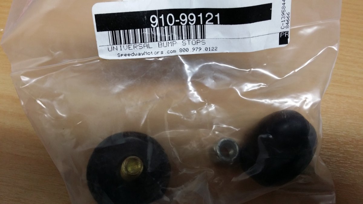

    Looking good! Where did you find the short bump stops?

    I bought a bunch of these from a local rod shop that was closing down. Just had a look at another bag and it looks like they came from Speedway. They have a nice long 3/8-16 threaded stud which is great for if I need to fine tune the bump stop height I can just machine up a spacer to go between the stop and the frame.
    Bear:)
    neilswheels likes this.
  8. gimpyshotrods
    Joined: May 20, 2009
    Posts: 24,522
    gimpyshotrods
    Those are also available from Energy Suspension.
