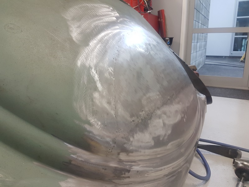

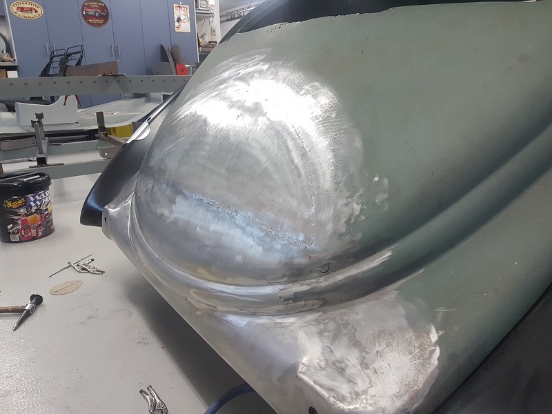

    By the way, unless it's my eyes or distortion from the pictures it looks to me like you need some work on the weld seam that crosses the crown from side to side.
    It has a really nice outward curve to it both side to side and from the back window down in that direction before welding, after it appears that there is a "pucker in the weld seam in both directions and the crown has been lost to some degree.
    Possibly popping it out and shrinking it back down with the shrinking disc could correct that.
    Correct me if I'm wrong.
    Larry.

    Thankfully it is just the picture making it look like that - the different color of the lower weld seam makes it appear '****ed in' at that point. The patch actually had a little bit too much crown in it and I managed to raise the weld seams slightly and hammer out the excess curve to a point where there is now a nice even curvature across the whole panel.
    That lower seam does still require a bit of work - I have bought myself a shrinking disc and once I get confident with using it I will come back to that area to refine things a bit more.
    Bear:)
