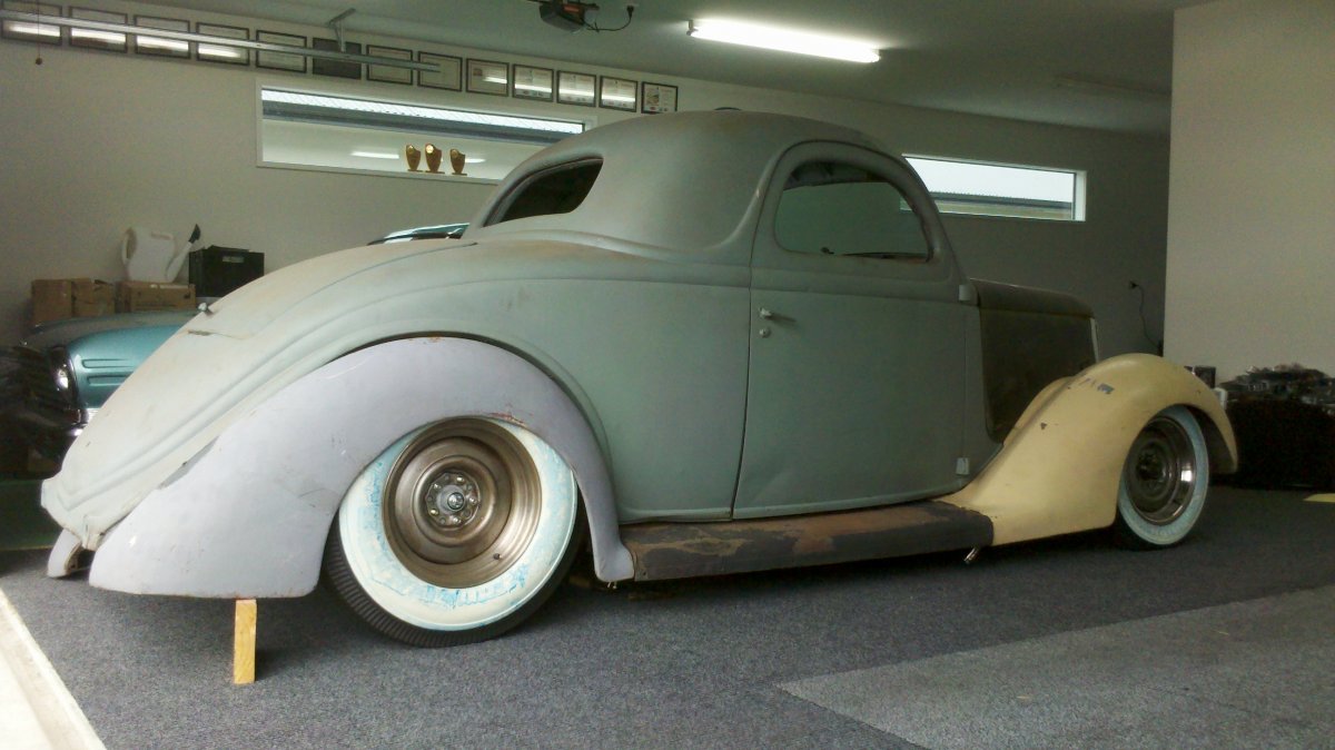

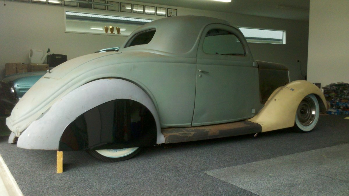

    Gave the shop a big tidy up on the weekend 'cos our local club, Surf City Rod and Custom, were having our annual 'round the sheds' visit. It's amazing how much mess that bodywork makes!
    While everything was clean I took the opportunity to click off a few pics to keep me inspired.:D
    Bear:)

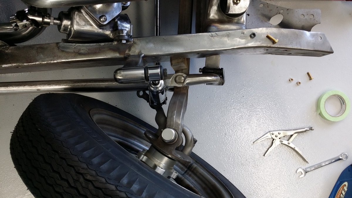

    I see you're running parallel bones in the front, I like the idea of this...don't see this often on 35-40 ch***is....is there any issues with the turning radius? how wide will your spring be?
  20. Surf City
    Joined: Mar 5, 2012
    Posts: 469
    Surf City
    The turning radius is probably going to be limited by the radius rod, but not before the tire rubs on the fender anyways. I just had a look and the wheel turns about 33 degrees from the straight a head position before it rubs the radius rod. (Don't know whether that's good, bad or otherwise!:D)
    All I do know, is it ain't easy getting that low using traditional suspension, and I wasn't gonna' run a collapsed looking independent front end to achieve the same ride height!:rolleyes: I also didn't want to end up with messed up geometry by trying to run the bones back under the frame.
    The monoleaf spring that I am using sits at 31 1/2" centres at rest. Hope that helps...

  24. Howdy Bear . Remember me ?
    First time on here in a , , , , too long a period !
    Love ya work mate . The build is looking stunning for sure.
    A quiet hint mate , , not a fan of rivenuts ! They have bad habits ! Wurth do a flanged weld on nut , been using them a lot with the race car Fabrication , strong in the thread , and don't rattle loose or spin in the hole if there's a bit of thread bind !
    What steering arms have you got there ? Looking for options with my roadster.

    Yeah, I think I remember you! Aren't you that shy, quiet guy with the mad metalworking skills?
    Was always a bit wary of the nutsert thing, but I've made sure they are crimped up REAL tight, and they are all accessible from behind if there is ever a problem. My only concern right now with them (prior to you raising the alarm) is that the amount of protrusion on the back side of the panel looks a bit 'modern'. I may even put a little tack on them later to avert your concerns.;)
    Regarding the steering arms, I'm pretty sure they are the So-Cal deep drop version, which gets the tie rod down below the wishbones. Mine are the unpolished stainless ones.
