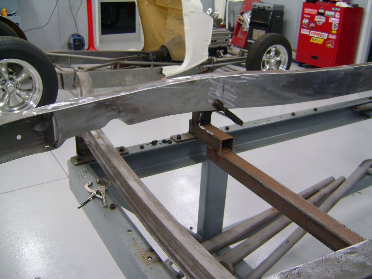

    Nobody is ever gonna' really see that rear notch once everything's done, but it's always bugged me seeing an abrupt, squared off notch in a nice flowing frame rail.
    I figure it's gotta' be stronger this way too.

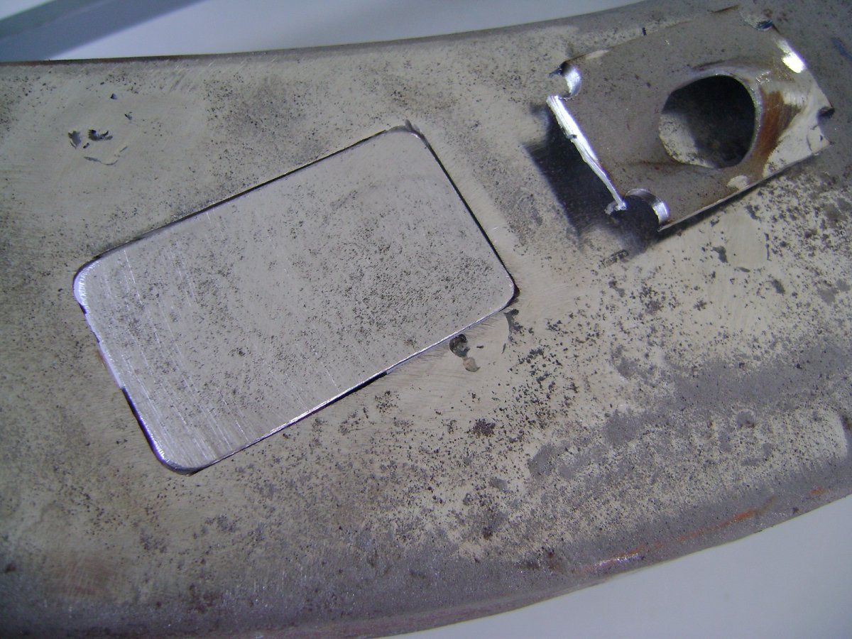

    Filled the last couple of holes in the rear rails. These larger ones are where the brake rods ran thru' (I think), and had a flared edge at each end.
    I had thought about pounding the edges flat, then filling the remainder, but figured it would be nicer to just cut out the surrounding area and put in a bigger patch.
    Welded, sanded and gone...:D

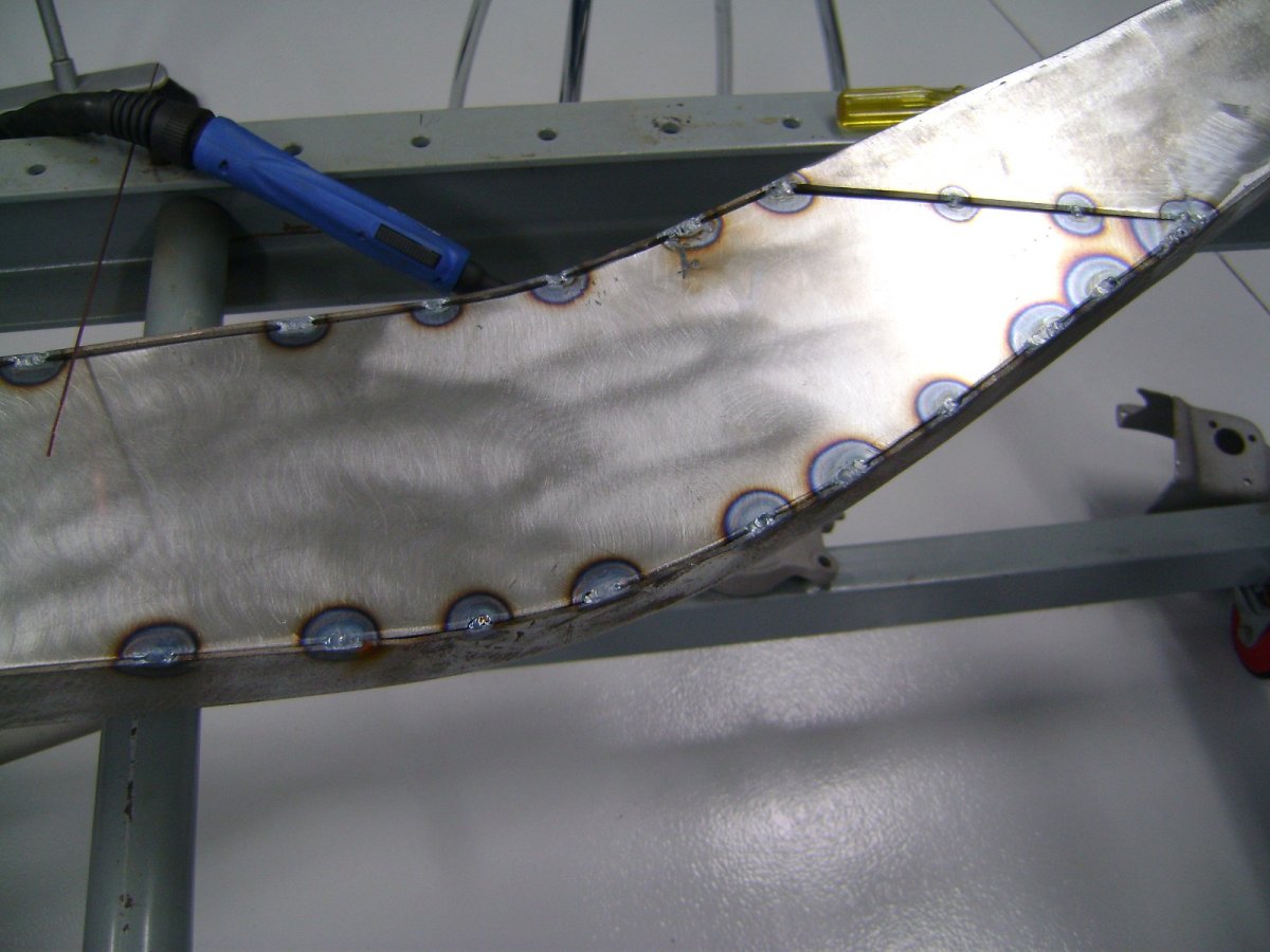

    Next step was to cut and fit the boxing plates.
    After I'd been thru' and straightened the flanges on the rails, I made some accurate templates from cardboard, then transferred the pattern to 1/8" plate.
    Cut these out with a thin cut off disc on a 4" grinder, then fine tuned the fit with a sander.
    Once I was totally happy with the fit, I sanded a nice chamfer on the edges of the plates to get good weld penetration, then tacked them into place.
    I put a 45 degree turn in at the front end of the plates too, so that the area forward of the front crossmember looks original, and will still accept the radiator and front bumper mounts.
    Bear:)

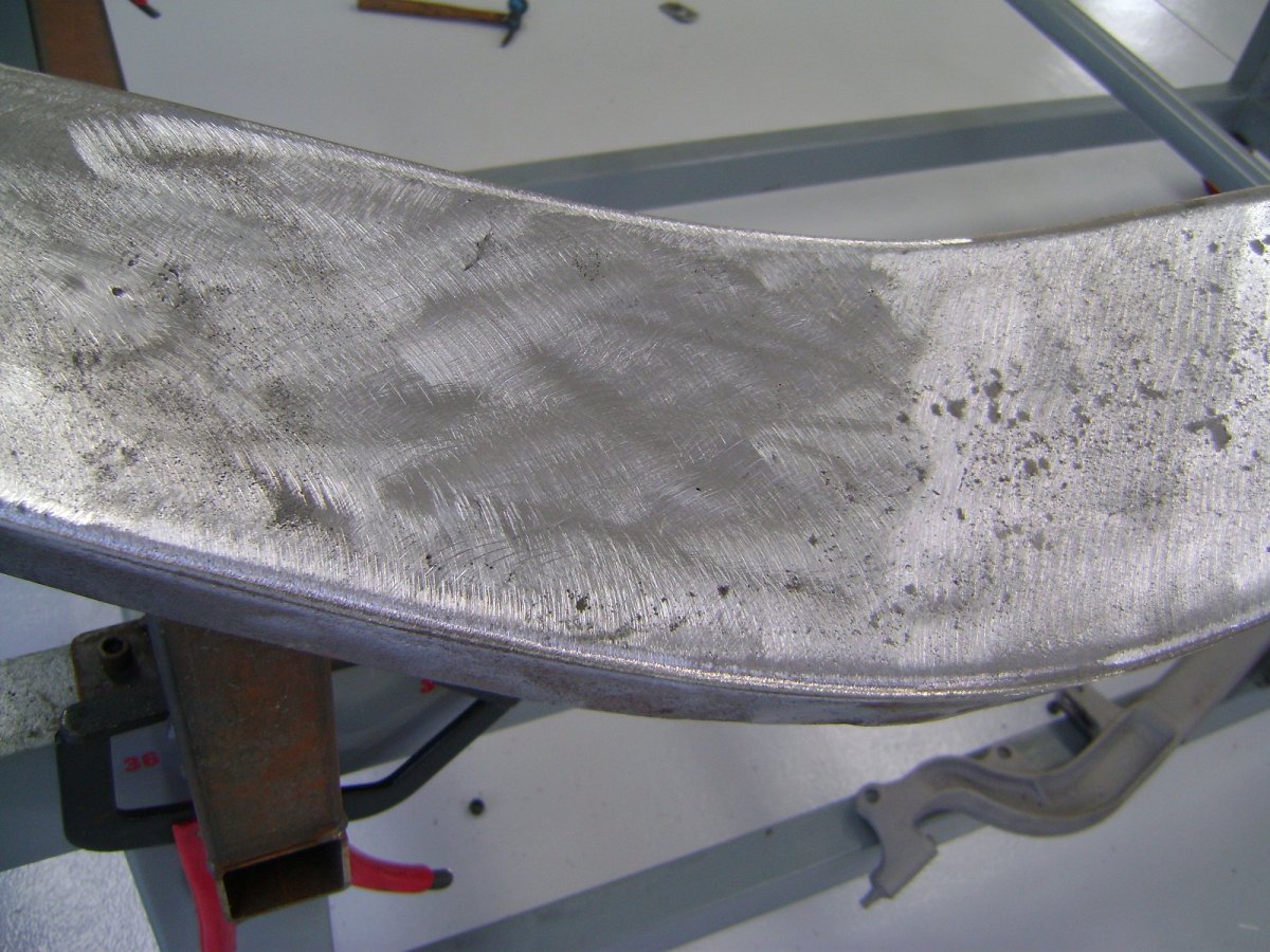

    This is one of those stages in a build where you've done a whole bunch of work, but it feels like you've just gone around in one big old circle and really gotten nowhere.
    I got done welding the boxing plates in, and got everything sanded up ready to start going forward,(at last).
    I built a whole '34 frame from flat sheet in less time than I've got in this!:eek:
    Don't ever let anyone tell ya' that aftermarket rails are expensive...:(
    Still, I figure ya' can't put an original body onto an aftermarket frame - it just wouldn't be right.;)
