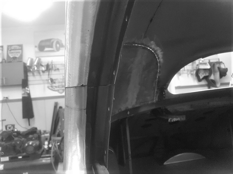

    Thanks! It probably doesn't involve any more work than the traditional pie cut method, but it certainly puts a bit more lean into the rear pillar which is the look I was after.
    I'll admit I was a bit (a whole lot!) worried about cutting such a big section out, but as soon as I moved it around and saw how well it was gonna' fit I knew I had made the right call.

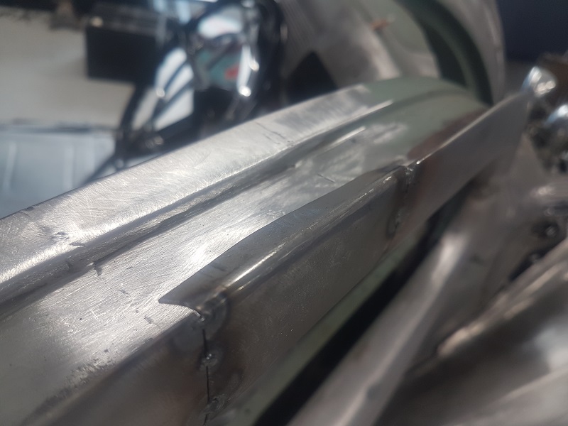

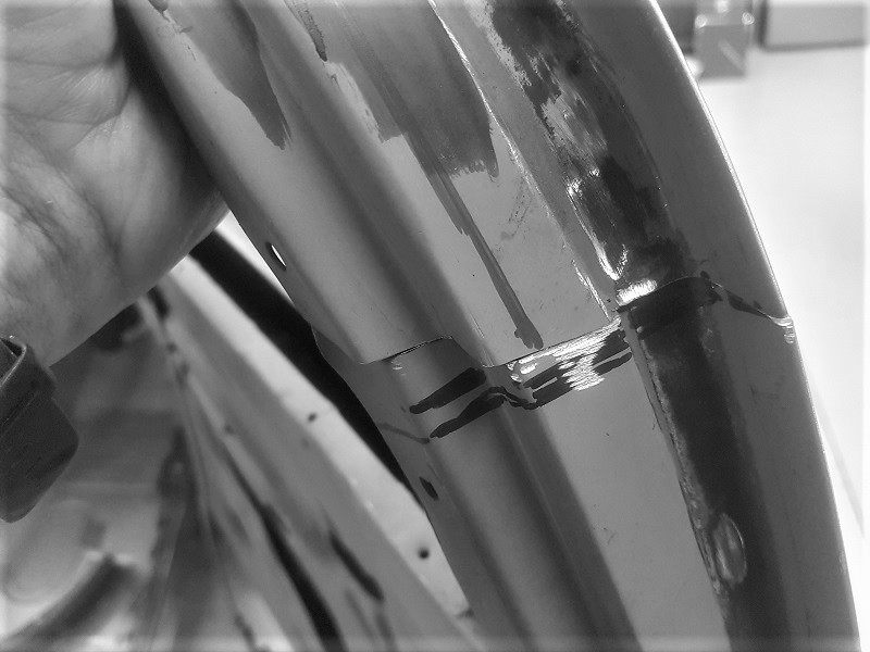

    Once the outer skin was all lined up and tacked, I turned my attention to the inner jamb area. There was so much slitting and splicing going on to line things up, combined with a fair lashing of factory lead in the join area, that I decided to cut some of that section out, and remake it as one piece.
    So I folded up replacement sections, and stretched the flanges slightly to match up with the curve through the upper jamb.
    Then welded them into place, still struggling a bit with some of the residue from the factory lead.
    But I got there in the end, and sanded the welds up to a reasonable finish. There's still a bit of finessing to do to the drip rail area which I will deal with when I come to the final welding stage.

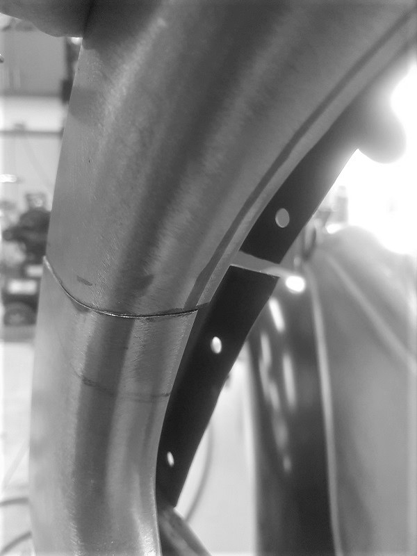

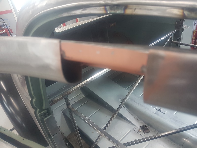

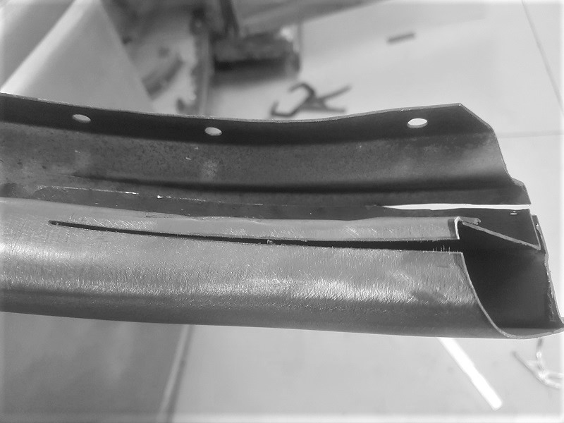

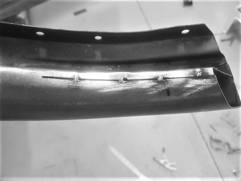

    Time for another update - I did manage to get the driver's (US p***enger) door cut down and tacked back together, then got sidetracked with a quick trip over to LA for the GNRS, to help get my buddy Bob Anderson's (RIP) Offy powered RPU set up for the 90 years of Model A exhibit.

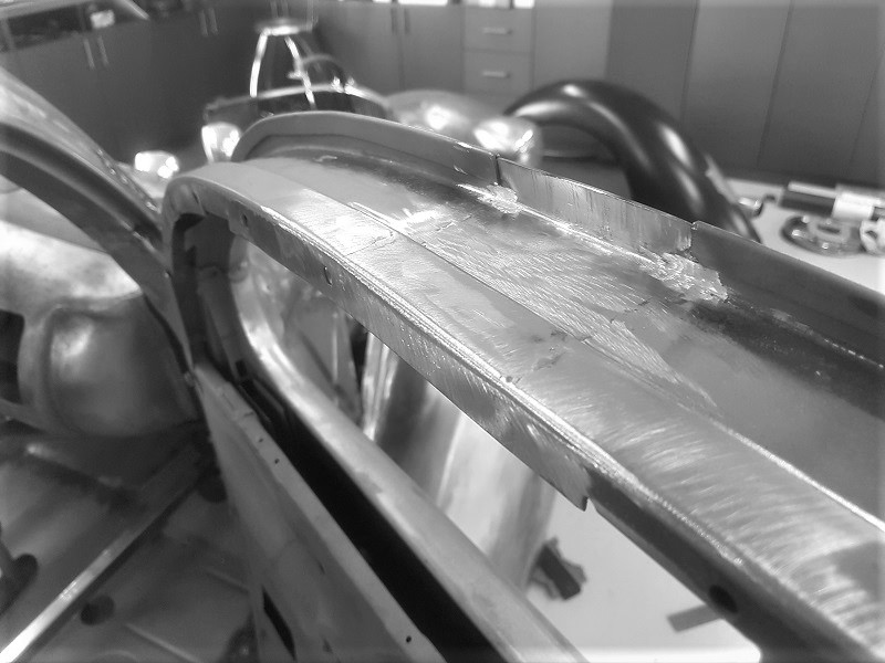

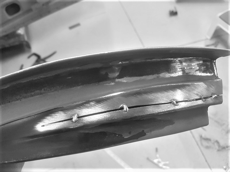

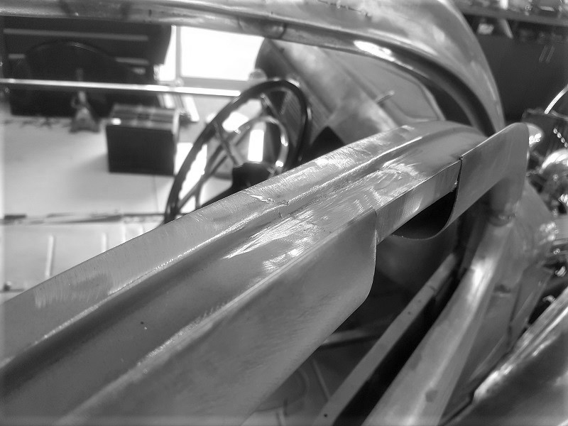

    Got started by carefully cutting the existing frame down to the correct height. I chose to make the cuts horizontally, rather than the usual procedure of cutting at right angles to the frames, because I wanted the cut to match up with the locations of the roof cuts on the outside perimeter, and went for the areas with the least amount of angular change on the inside (or window) edge. Got them close on the initial cut...

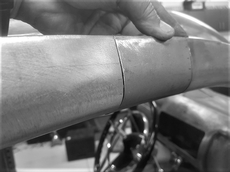

    Then separated the front and rear portions at the flattest part of the door top, and sanded them up to a nice tight fit.

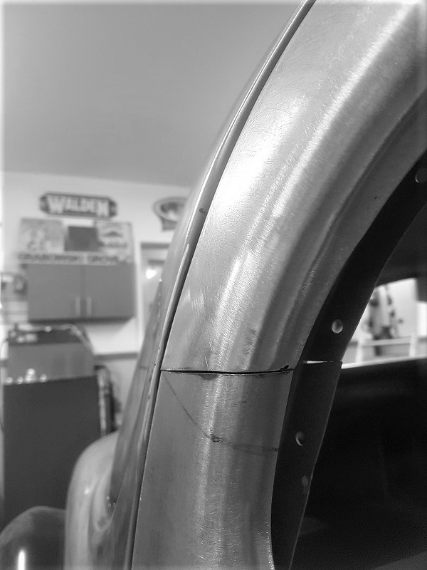

    It's surprising how much the profile of the door frame changes over a 3" or so distance.
    So once I figured out where the shapes began to change, I cut out some tapered sections to pull the wider pieces back into line.
    Then closed them up and tacked them together.
    And final welded the seams.

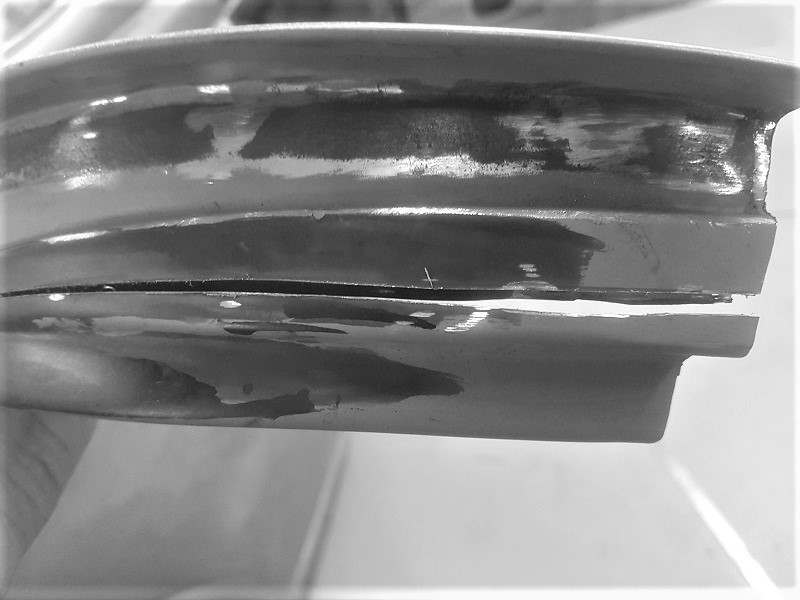

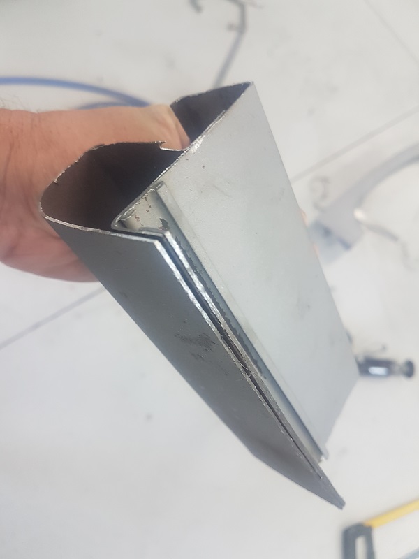

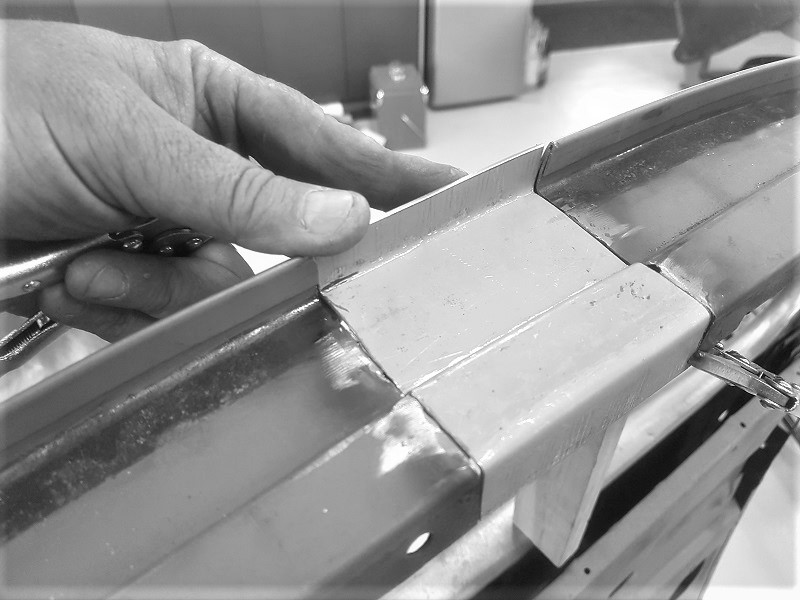

    Then I formed up the necessary pieces to fill the gap at the top of the door, second layer shown here...
    And welded into place...

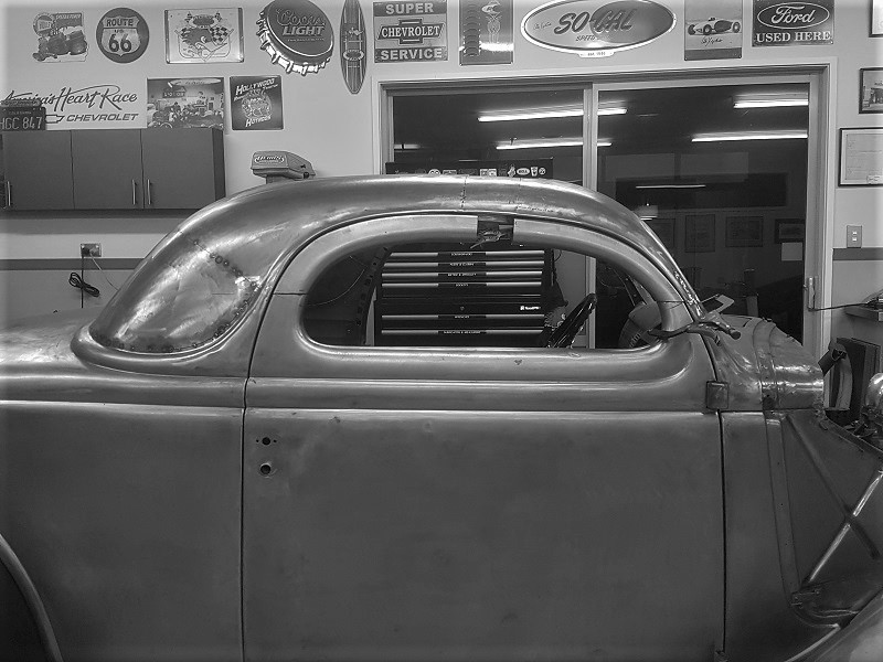

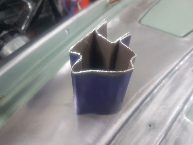

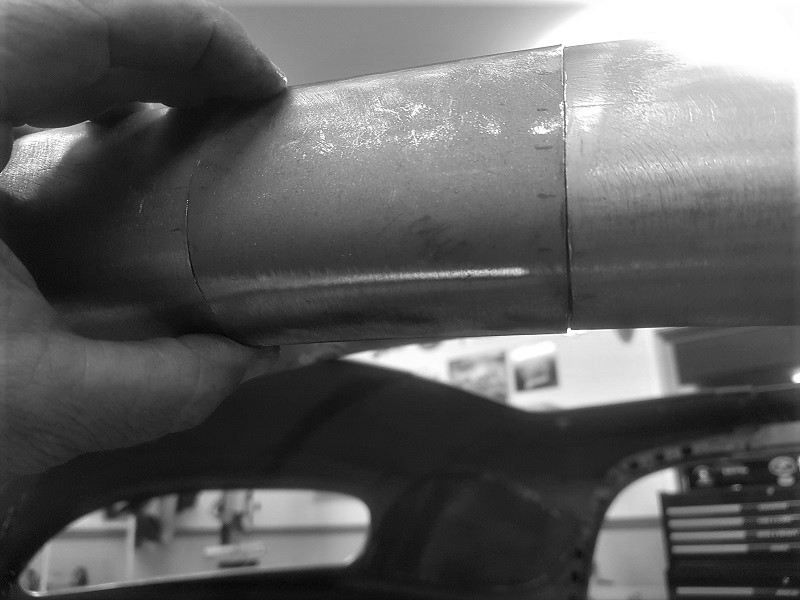

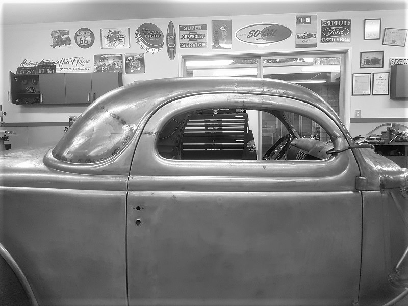

    I had a piece of the upright section of a 4-door window frame that I managed to salvage a portion of the outer skin from.
    Trimmed out the required section, then managed to coax a gentle curve into it with a hammer and dolly, to match the profile of the upper frame.
    And hammered a fold into the top section so it could be wrapped over the frame as per the original skin.

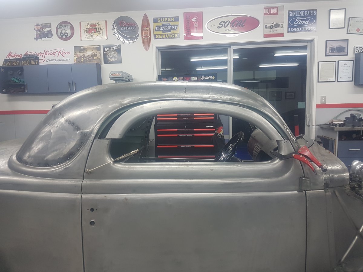

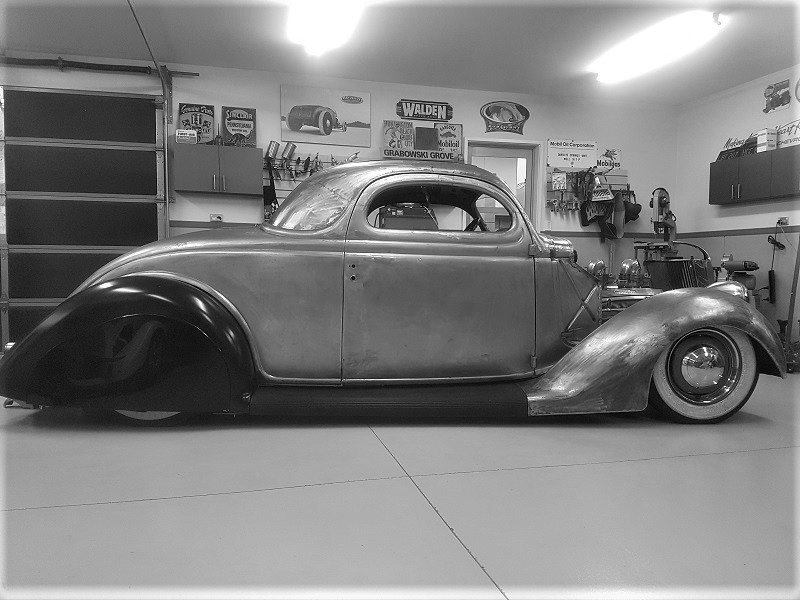

    Real happy with the window shape:D, taking the inch or so extra out of the rear pillar has taken the 'wedge' out of the side window and made the opening appear almost symmetrical.
    So good, after all this time, to see the final profile coming together...:cool:
    Bear:)
