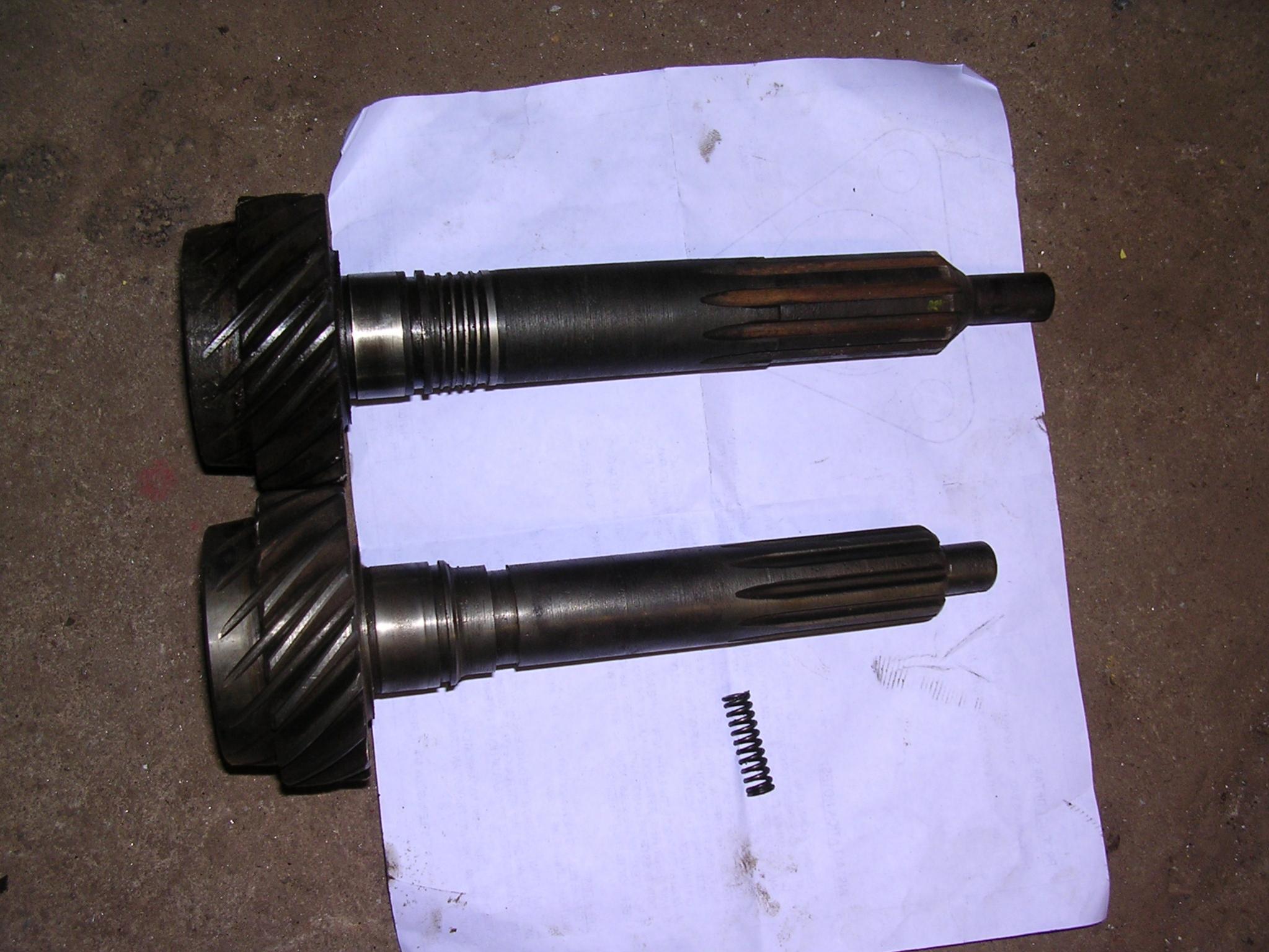

    Steel A Rod; here is a pic of the detent spring and 2 inputs. The long input is Olds selector 51-up, and the short one is definately 37 stock Buick. I put these up in case yours have been swapped.
    On the 37, it has a groove to hold a cork O-ring, to keep oil off of the clutch. I am pretty sure Buick later switched to a conventional spiral cut into the shaft, to grab the oil and send it back to the trans.
    37 measures from bearing face to tip of pilot: 6.5"
    Olds " " " " is 7-11/16"
    I believe all the brands of old-aftermarket adapters to do flathead motor to buick trans were based on the short size. I believe buick used short shafts for many years...but i can't verify that.
    I know the long shaft is needed for Olds/Cad engines. I think the 1956 HRM tech had a short input for their 55 chevy sbc car? They modded the stock tri-5 bell to fit the buick trans.
    The detent springs. you need 2 identical, and 2 balls. One rail sits lower in the trans, so when you put in both balls and both springs, one spring will be sticking up a lot more. Look at the top cover; there is a clearance hole drilled, for the one that sticks up too much. The other side of cover is not drilled.
    When you put the cover on for good; it is best to leave both springs out while you peek under the cover to align the shift lever tang. Then set the cover flat on the trans. Put one side middle bolt in by a couple threads. Then lift just the opposite side to sneak the spring into it's hole. Then make sure you come straight down with the cover and start that side middle bolt. Then go take the other middle bolt out to sneak that spring in. The problem you are avoiding is that if you try to squish the cover down on both springs while keeping the tang in place, the cover slides around and can bend the springs off to one side.
    Spring measures:
    1.200 long on a used original.
    .340 diameter (as long as it is under 3/8" by enough that it does not bind in the hole as you compress it, would be fine)
    The diameter of the spring steel wire that it's made of is .055. Like I said before you are setting the tension on the detents. Way too soft may let it fall out of gear on a bump. Way too stiff will shift hard as the ball tries to ramp.

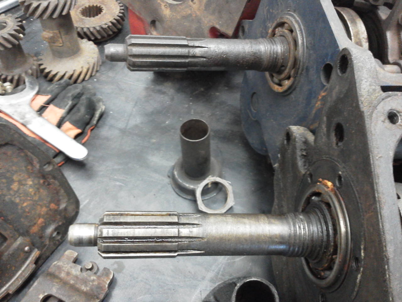

    Looking at the photos of the two shafts, I think the one in my complete trans may be the Olds shaft. I wasn't exactly sure where you measured from. But the shape sure looks like the Olds part. After looking through a Hollander book it looks like the #1289500 is a '36 Buick case. And with both of mine and least one of your shifter plates being numbered #1289505, I would ***ume the top plates were cast in '36?
    On the tail end of my complete trans(the blue one) you can see where the holes were drilled for the Ford mount, and the unused Buick holes have been plugged.
    The joint that came with my red trans fits the output shaft on the blue trans and the shaft that came with the red trans, although it seems like there is just a hair of play on both. Tried the same joint on two Ford trannies, and it seemed like it would go on but it was very tight. Not sure what all this means and still not sure the blue trans will work on my 248 ST8.

    This thread is full of new surprises for me; I have never seen that big hex nut on an input shaft before, and I see what looks like a slip-on TOB guide tube on the bench that looks like sheet steel? rather than cast? The Buick cases I have had, were a bolt on tube/bearing retainer, as they had threaded holes....but each one was missing. On the Olds/Cad swaps, the Olds tube is used anyways, so I did not care.
    I measured my input shafts to the face of the front case bearing location. I did not have bearings on either, so i measure to the rear edge of where the snap ring touches the face of the bearing.
    That input is not Olds. I wonder if it could be the "40-48 Buick" parts? or could it be a 36 input? I am positive it is not 37

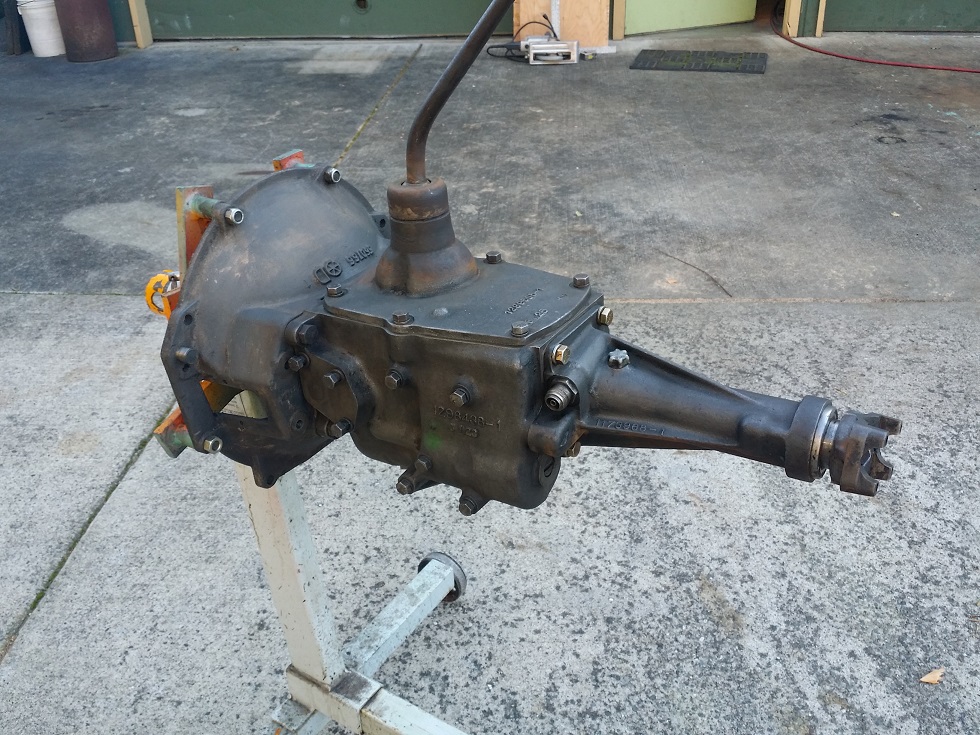

    Here is my 37/38 ******, 56 olds tailshaft. All Buick on the front side as I am mating this to a 322 nailhead
    My 32 originally had a 37 buick ****** with the closed drive buick ball Adapted to the ford torque tube by just whacking the ford parts off and welding the Buick stuff on!
