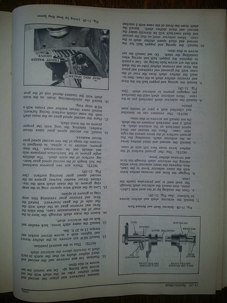

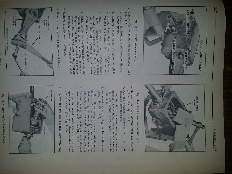

    a good investment for any project is a shop manual including the parts you are working on,
    but in a pinch here is a shortcut of sorts pertaining to this thread
    the 1958 Oldsmobile Selector Transmission
    1.jpg 2.jpg 3.jpg 4.jpg 5.jpg 6.jpg 7.jpg 8.jpg 9.jpg 10.jpg 11.jpg 12.jpg 13.jpg 14.jpg

    I have no idea why they are not all right side up... I will try to fix that...
    edit..
    aw ****it,
    the photo interface is a severe pain in the *** here
    if you can't read it all caddy wompus buy the book

    Interesting... I have the 56 manual. At first glance 58 seems to be more in depth.

    hmm, didn't notice that, there are three more pages in the '58 book than the '56
    and pages that are in the '56 that are not in the '58
    and vice verse

    all I have is: 55,57,58 parts books with very little for pic detail. This is great, I do see a reference to the thin wire ring, and I'll copy it all so I can read up on all of it.
    a guy in Ca really wanted a pic of the 57 column linkage, and I can now send him one tonight; Thanks
