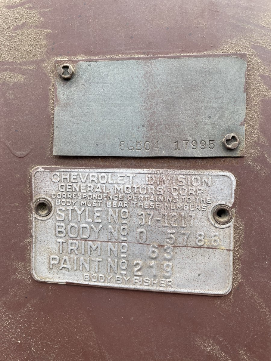

  6. Ok all you Sherlock Hambers, get out your magnifying gl*** and kick your bloodhound outta bed and tell me what I got!
    The Pink Slip says it’s a 37 but of course there is no VIN, they used the engine number for the Pink Slip. PO said he bought it as it sits with the 38 front end. I’ll post a picture of the Pink Slip in a minute, it’s gotta get to me thru a cloud storm!

    6-Oakland Plant.
    GB-Master 85 P***enger coupe
    C4-March 4th.
    Paint code 219 is Brookhaven Blue
    My 1939 coupe also has the old engine number on the ***le, so when it got ***led here it had nothing on the body that matched the ***le number. It was missing the tags also, so I had to purchase them new and stamp them to match the ***le to get it registered here.

  10. Does it confirm year?

    Is the engine number a block number for the 327??????

    Yes, the 37-1217 confirms it's a 1937 car.

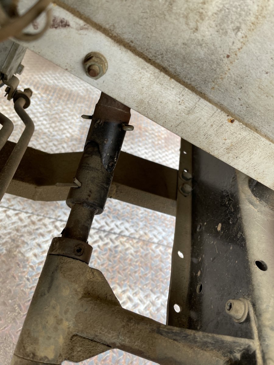

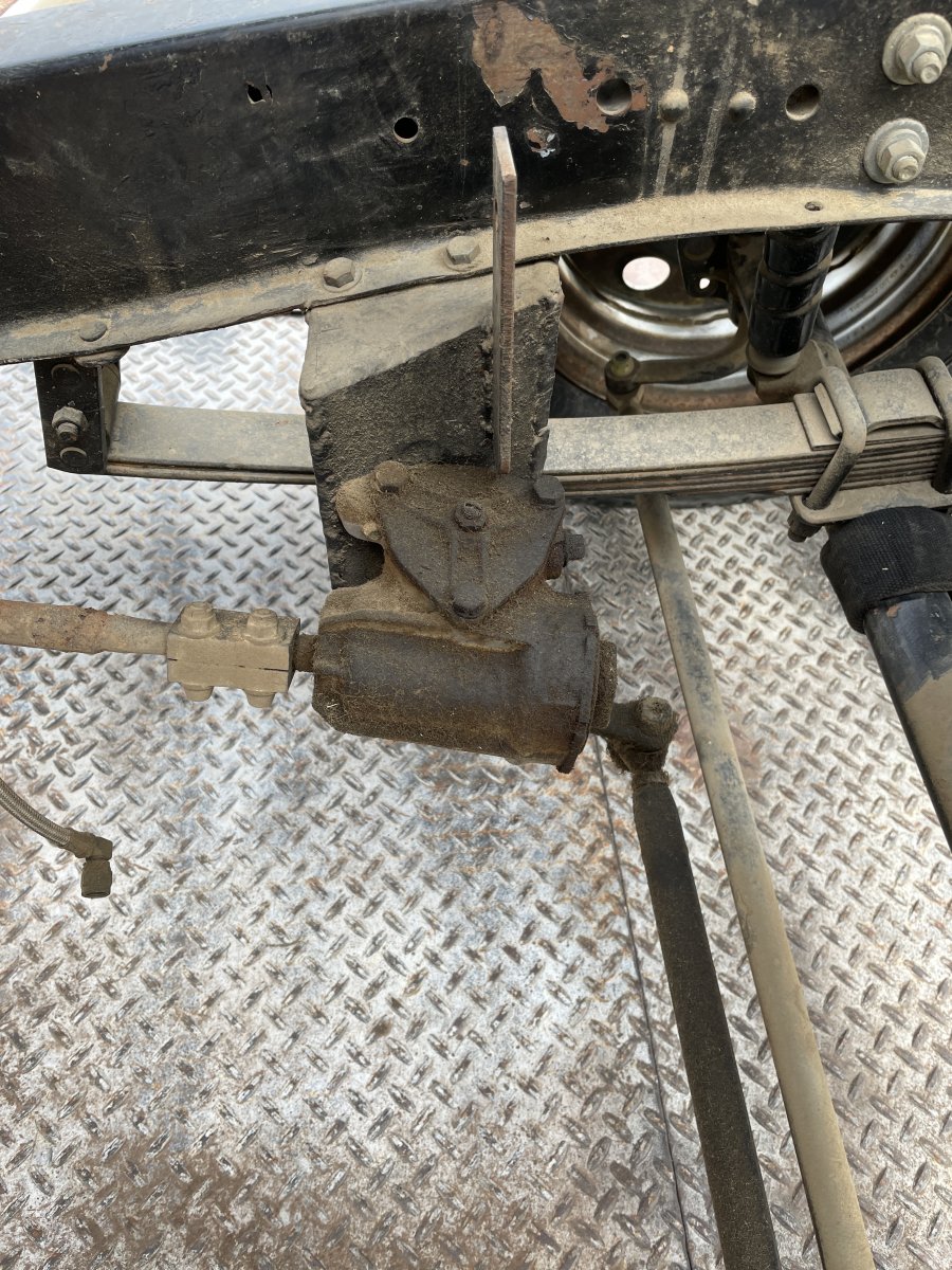

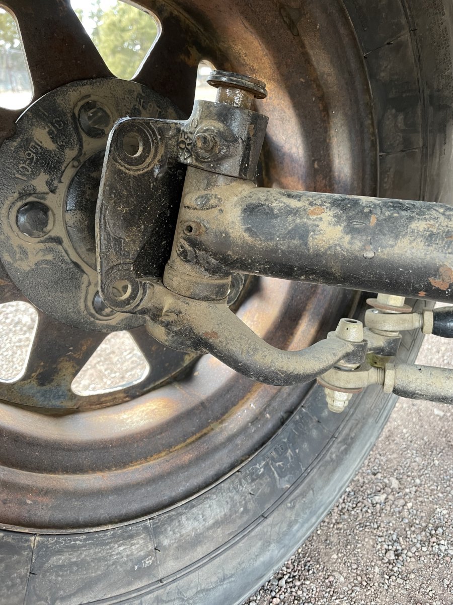

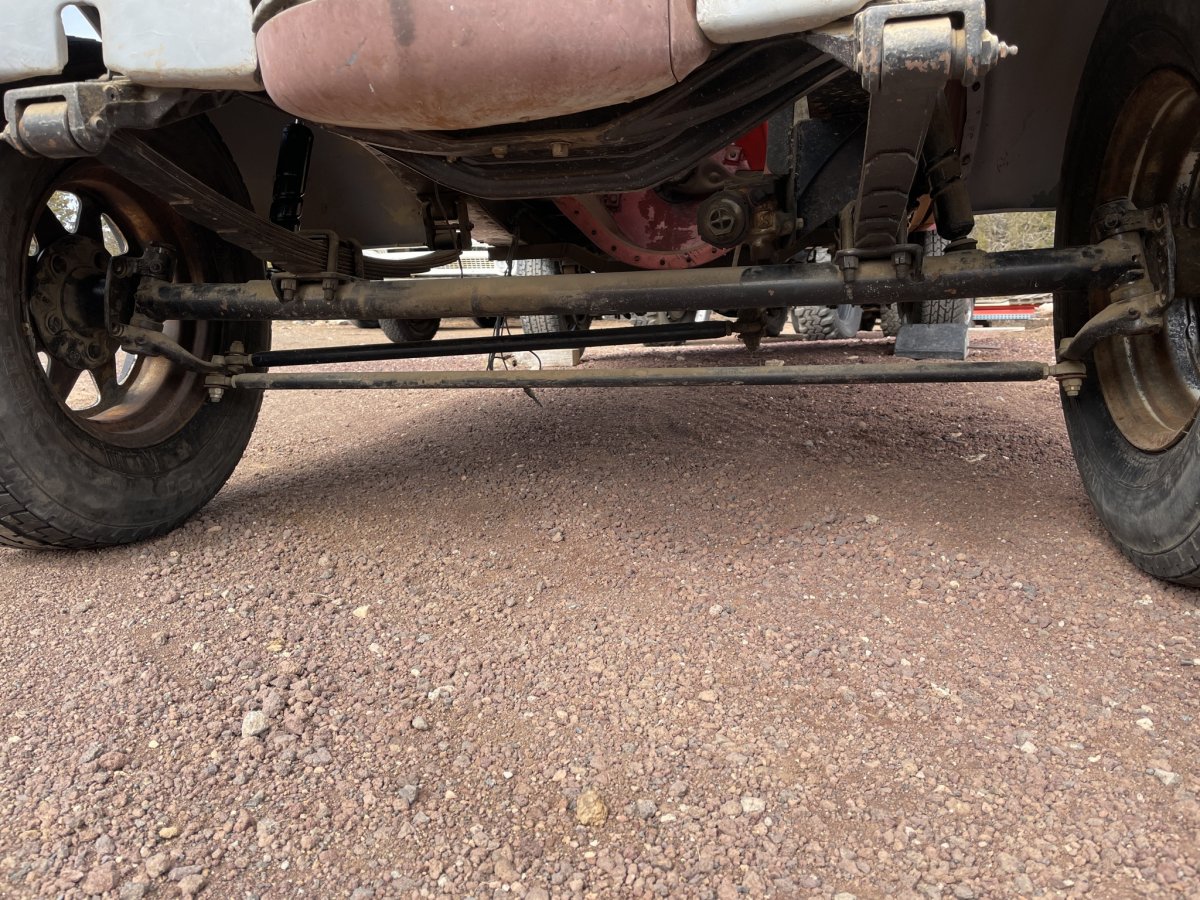

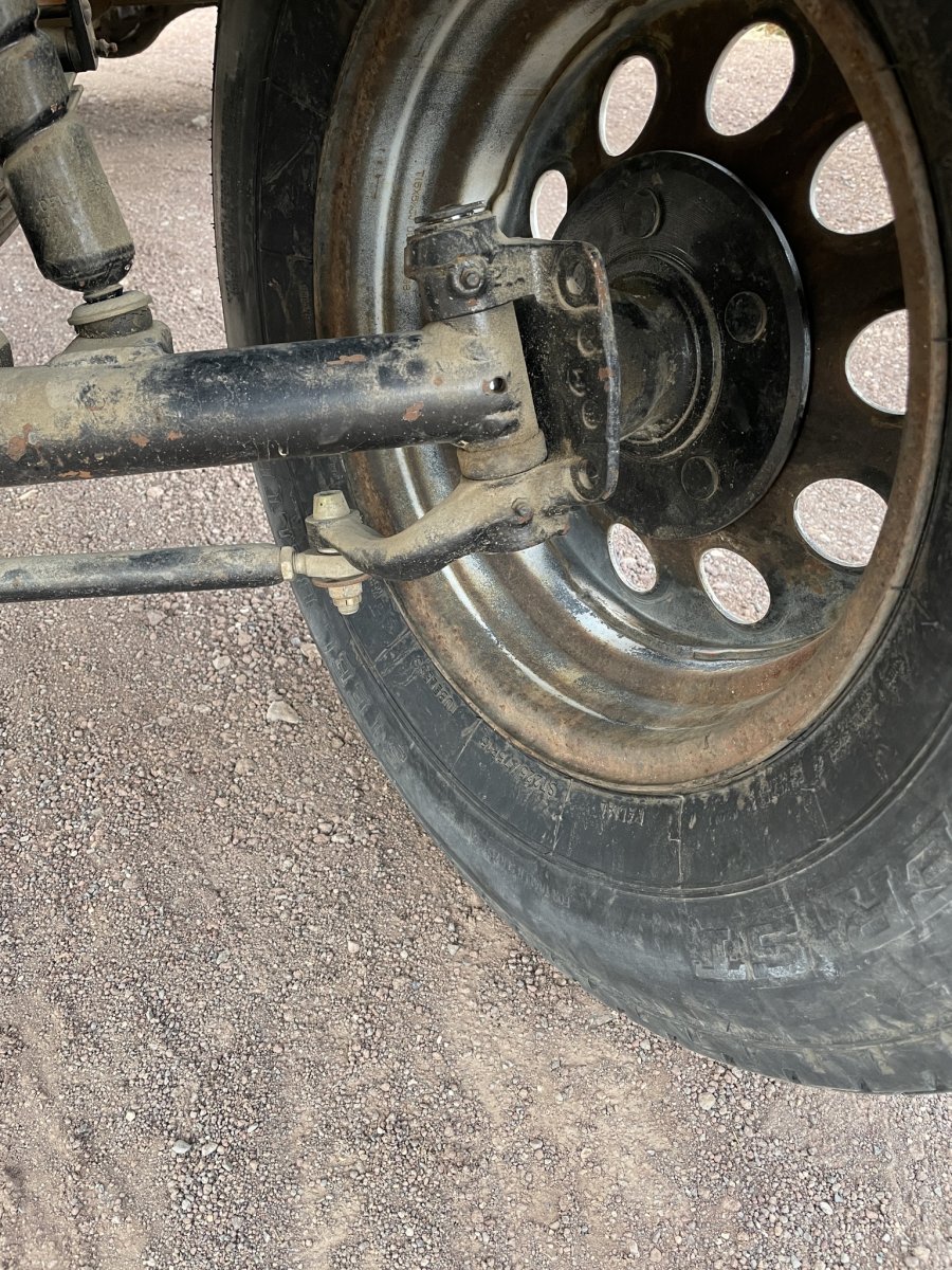

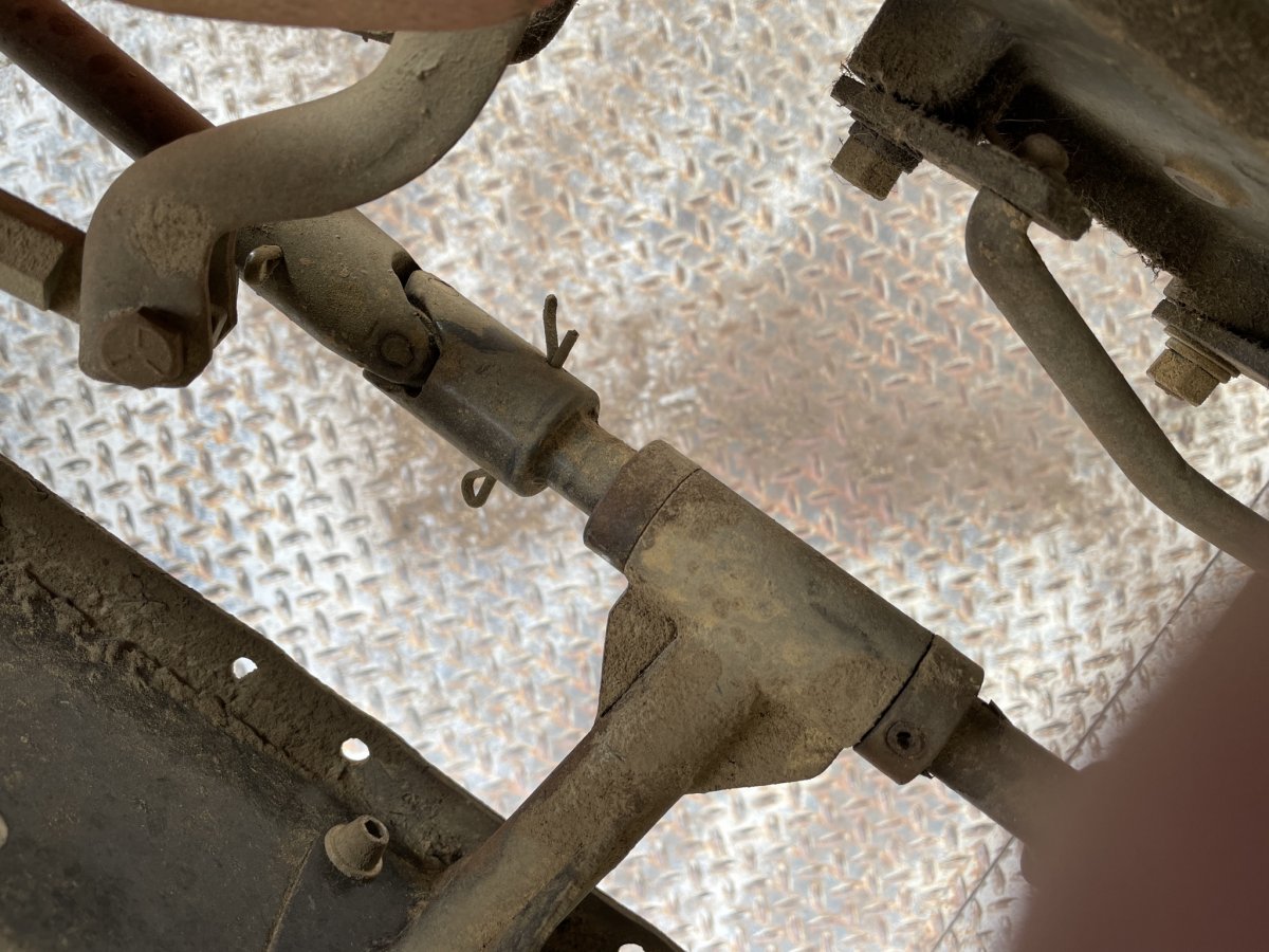

  14. Front end pictures, amazing how things were done “Back in the Day”!
    Has a Corvair steering box setup cross steer. Anybody able to ID the spindles? I’m pretty sure they are Ford cuz front hubs are 5 on 5.5 but would be nice to know for sure.
    Box is mounted kinda crudely but it is triangulated with the old left side motor mount.
    Now we’re talking SCARY! Sure, I’ll drive this 125 mph in the 1/4 mile!

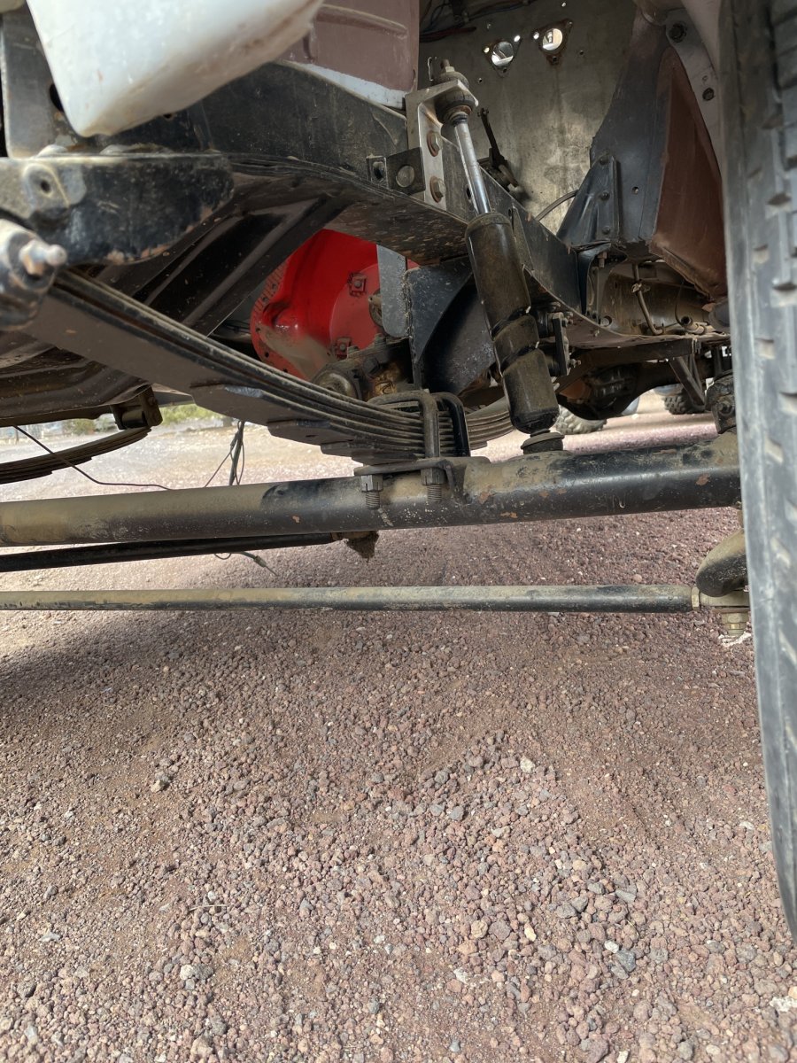

  18. Front axle looks pretty stout, would be nice to know who made it.
    Do these look like the factory front springs? And I really like these old spiral front shocks, too bad the right one is bleeding oil... AB80FF8F-BBD9-477A-A14A-7DD7448507E1.jpeg

    Looks like rear springs outa early 40s Pontiac. Thin and stacked... not sure.

    The stock Chevy front and rear leaf springs are thin, and quite a few leafs also. If I recall correctly my rears were 9 leaf, but very thin. Both are 1.75" wide stock. Those look like 7 leaf springs, and guessing they are stock also. Being a Master 85, vs. a Master Deluxe, your car came with front leaf, vs. the Master Deluxe that came with coils, and knee action shocks.

    The stamped numbers/letters on the top plate is your vin numbers. (6GBC4 17995)
    No numbers on the frame.
    Somewhere there is a sketch of there plates showing the info (maybe the Chevy manual site). I found it someplace.

    Mine sat up like a stink bug in the rear with the stock springs when I bought it! I thought somebody added leafs to it when I counted how many were there! I took all but the main leaf out, and redrilled the center hole 2" back. I had a set of leaf springs from a late 50's Chev pickup, and I used 3 of those to make up a 4 leaf set. The Chevy trucks have pretty flat springs, so lowered it a lot. But I still added 1" box rectangle tube to my perches on the 8.8" Ford axle to get it another inch lower in back.

    6GB04
    6 = Oakland CA
    GB = Master
    04 = April

    HIs is "C4" which I believe is C for March, and 4th day. Unless that's not an "C4"???

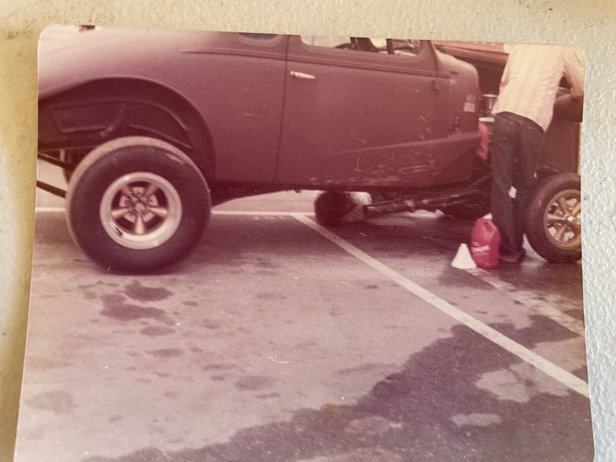

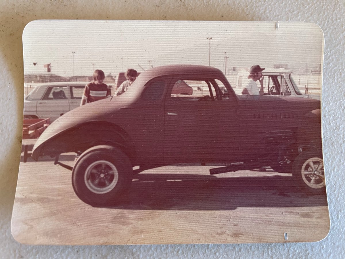

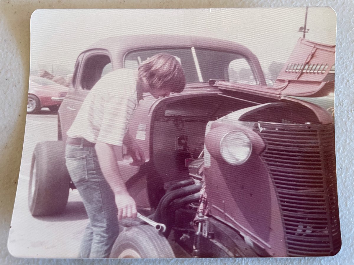

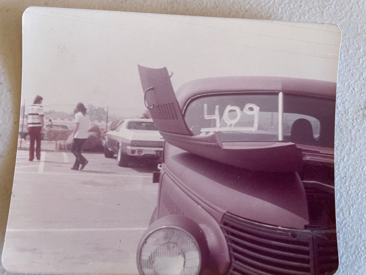

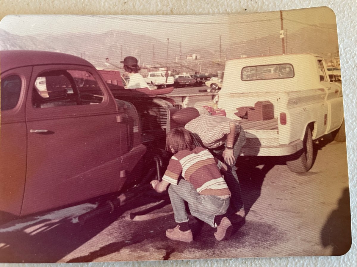

  27. These are from the last time it was raced, supposed to be either Riverside or Ontario...
    C2E58F0E-50DE-4CAF-8F7A-6215576C675B.jpeg BBE656CA-136E-4CB8-A9B3-0D16203B0133.jpeg A478507A-DD01-4E21-9067-4200B7B886F2.jpeg C7A22F72-C427-48F3-8309-FEB63C9D376A.jpeg EF3CB0EC-13DE-494E-B3A3-BF57F7862CAB.jpeg
    I’m thinking late 72 or early 73 cuz I see a 73 El Camino in this picture...

    The main leaf and a few of the lower leaves look stock . It looks as if some one added 2 , the second and third leaves are not stock . These old Chebbies had a strange bushing and pin arrangement . I can for sure see the front pin is stock . Once you get tinkering with the pins and bushings you will understand what I define as strange . These frames aren’t super strong , have and x members been added as the frame goes back to the rear ? Good Luck, I had one of these and a couple for parts at one time .
