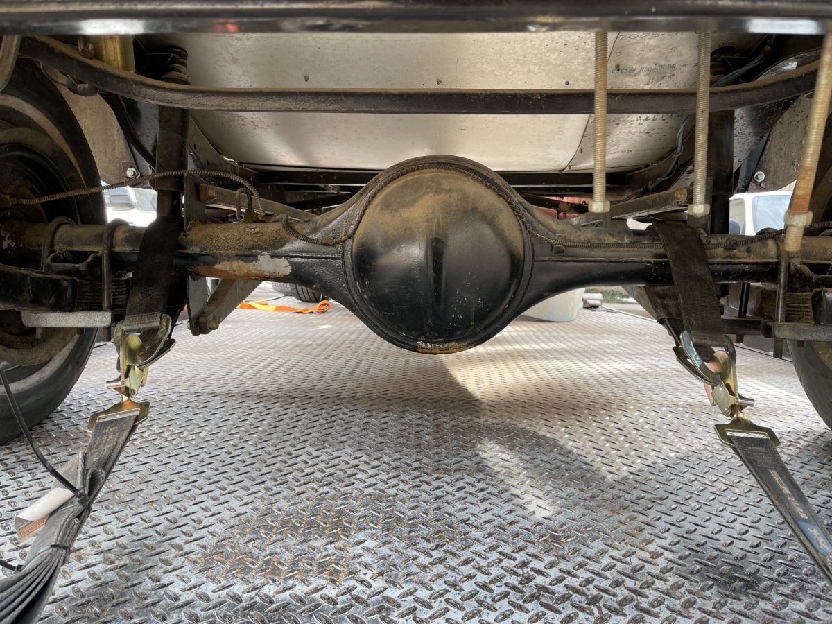

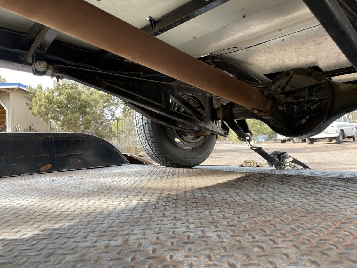

  10. On the business end of the car there is the requisite 57 Pontiac/Olds rearend with ladders bars! The install is done good and looks quite up to the task of 7000RPM clutch side steps!

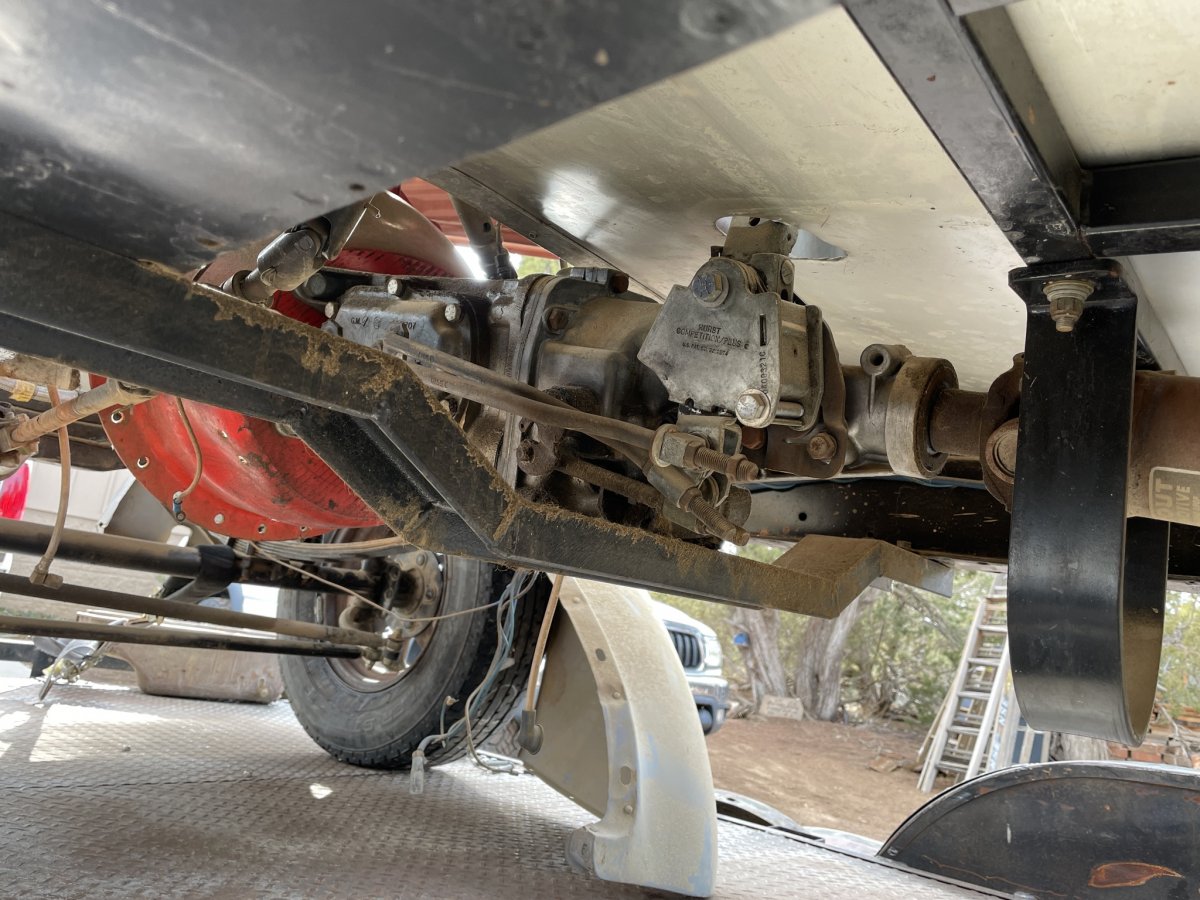

    Transferring all that Mouse Motor Mayhem is the only correct transmission, a Muncie M-20 out of a 1965 Corvette (aren’t they all outta Corvettes?!) LOL! Lakewood ****ter shield and a custom drive shaft. Hurst Compe***ion Plus shifter with a custom handle for that all important 1-2 power shift! 26A63420-CE0B-417A-88C3-3C9366220CBD.jpeg E44D9CFE-FDCF-4FC6-9C74-4115C082AD34.jpeg

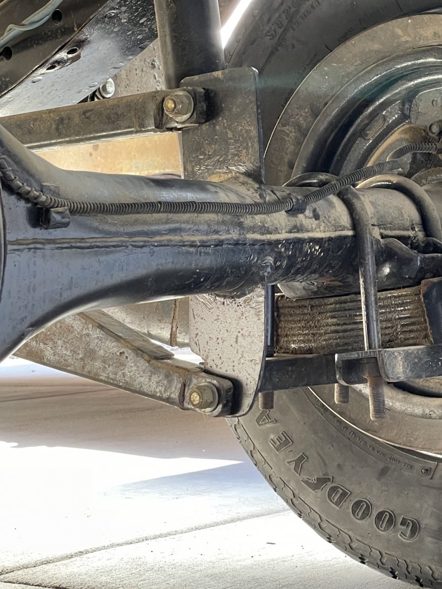

    A bit unusual to see rubber wrapped leaf springs on a drag car.

    ...those rear leaf springs look to be wrapped with the original tin from the factory,...not rubber.

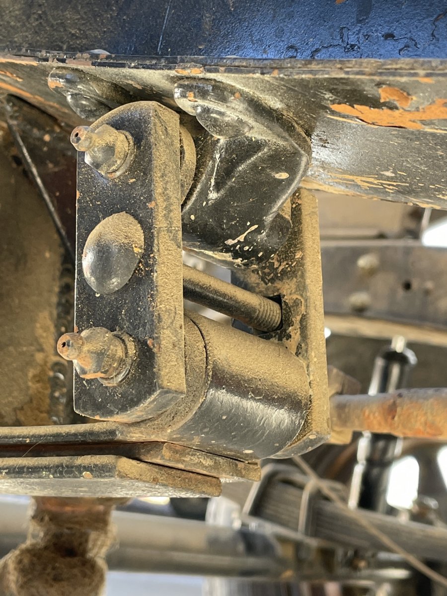

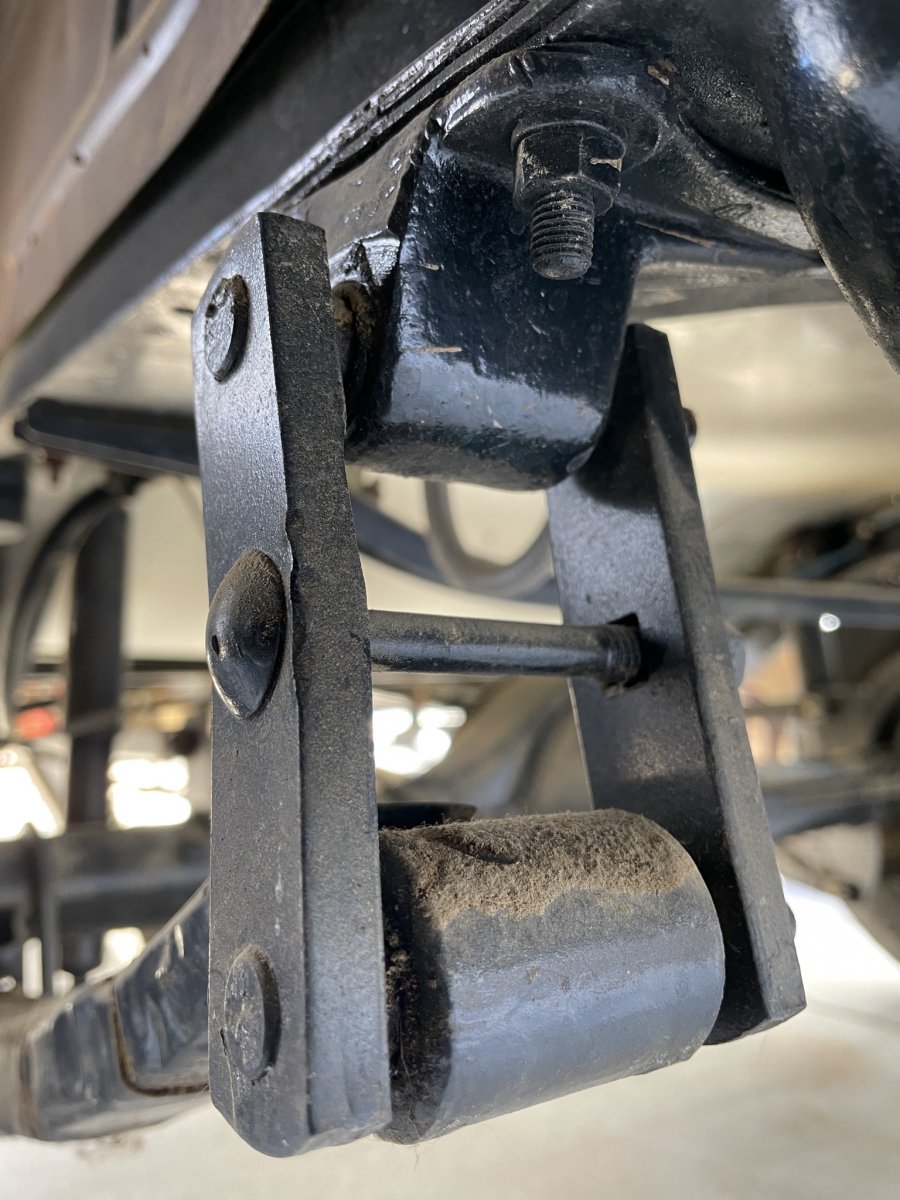

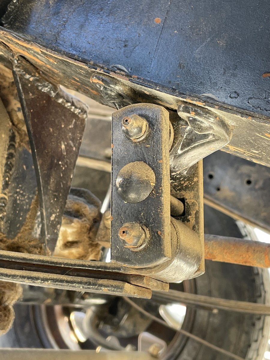

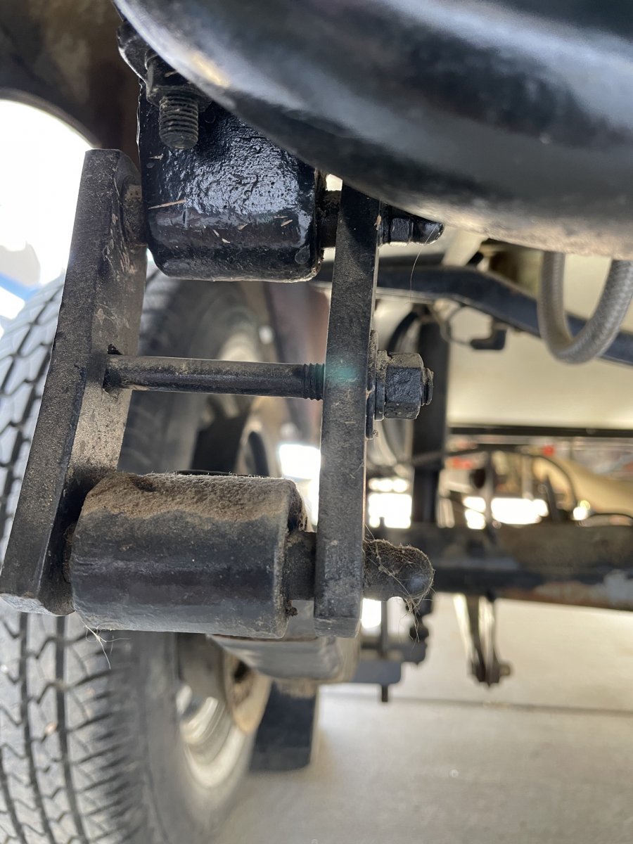

    Got a picture of the rear spring shackles? Would be interesting to determine if they're originals too?

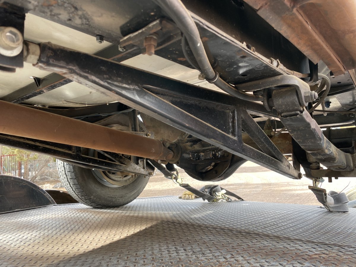

    It doesn't look like the ladder bars pivot around the same axis as the front spring eyes of the rear springs. Mine was like that too ('36 Chevy PU, 327/muncie, '57 Pontiac rearend). This condition makes the rear suspension be bound up and travel is non-existent.

    Might be an issue for the street, but it was typical of drag cars in the day. They weren't worried about spring bind for 1/4 mile, and likely even liked that it didn't move too much.

  18. Yup! I thought they were wrapped in an old bicycle inner tube too, but it is Genuine GM stuff. Didn’t know they did that...
    Rear shackles as requested. Here’s the fronts too, they all look like they are OEM.
    Here’s another picture of the ladder bars showing how they are mounted.

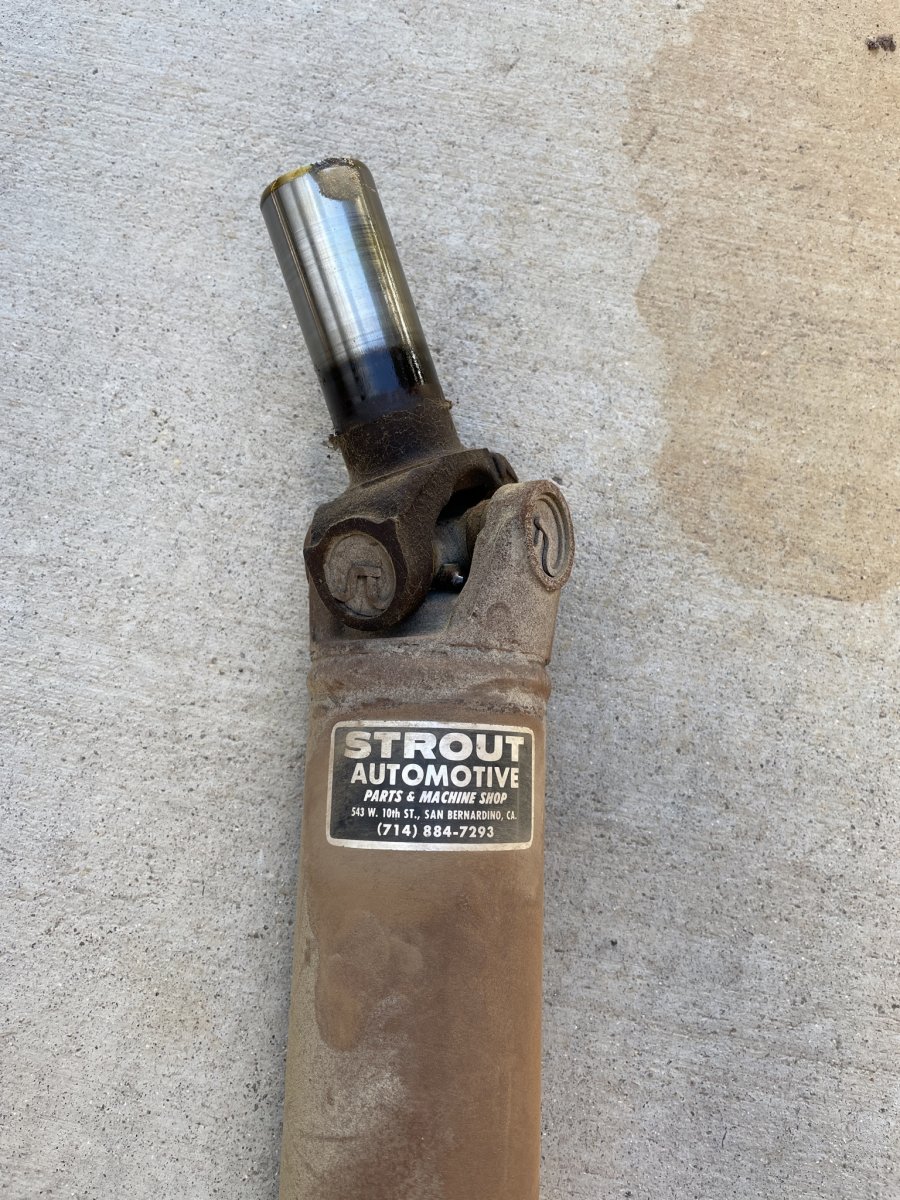

  19. Hey GuyW, you know this shop? They still around?
    Custom driveshaft, Muncie in the front, Pontiac/Olds in the rear!

    An old time place in Berdoo. Never dealt with them but they were around when I was in HS. The 714 area code on the label changed to 909 in November 1992 so the drive shaft is prior to then. I'm sure some other old timers from the Berdoo area will have more info.

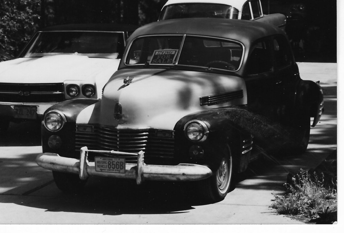

    Yes I was #2 the two guys that shared #1 were in there for lunch, I had to work and didn't get there till 4PM. By that time they where gone. I lived on Navaho drive off of 180 then built a house in University Heights on Gillenwater Drive. My cars in the driveway.

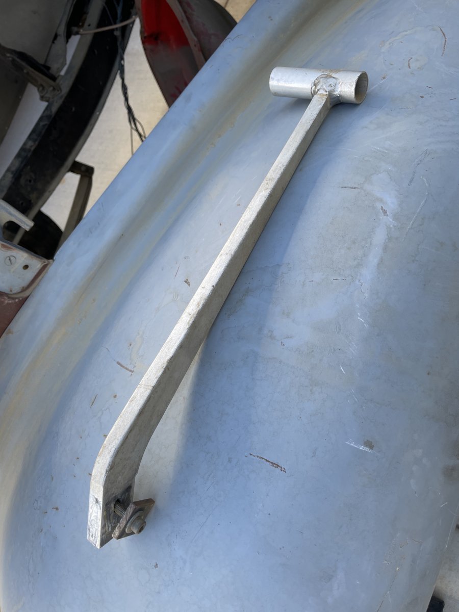

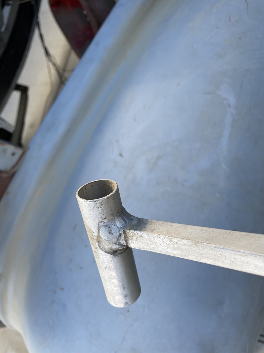

  25. Now back to our regularly scheduled programming.

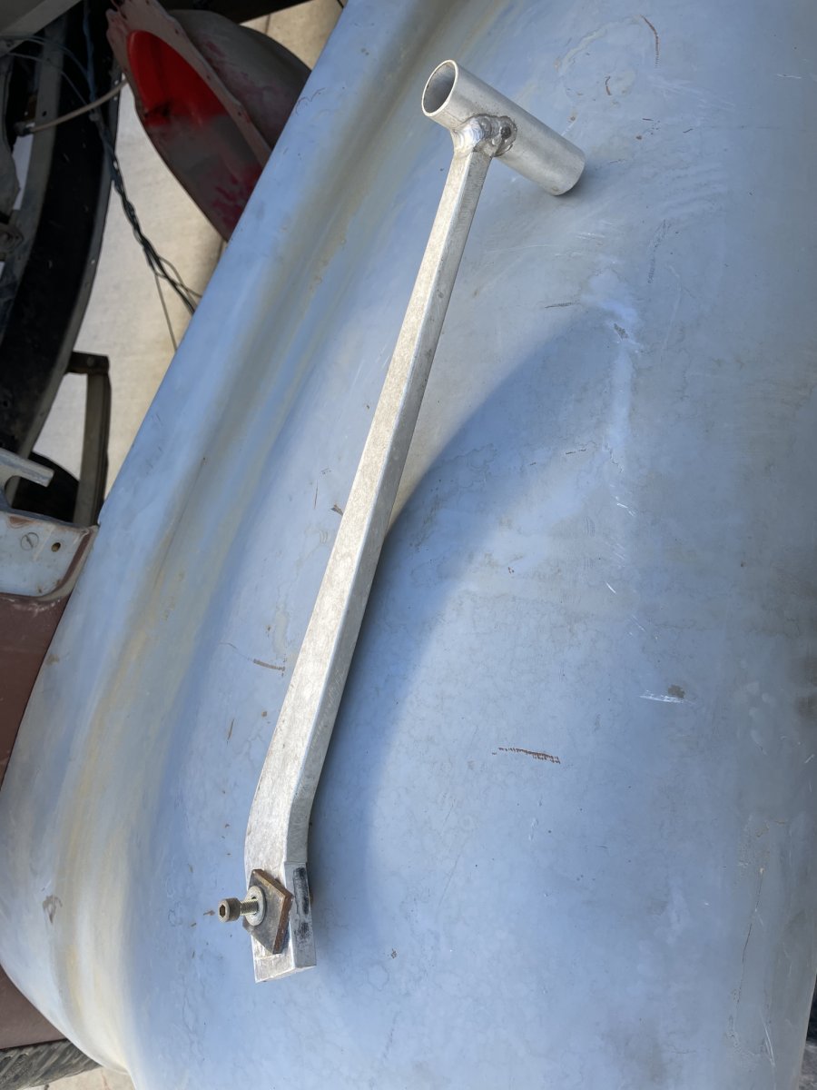

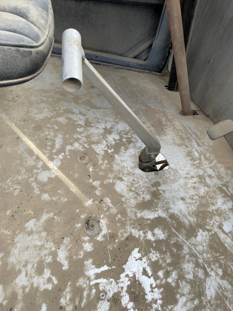

    Check out this cool hand made shifter handle...
    The T-handle looks like it’s gas welded, so cool!

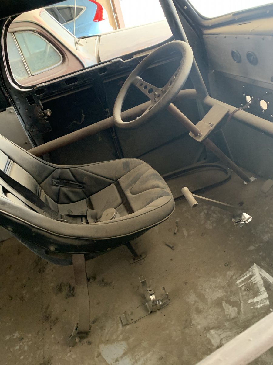

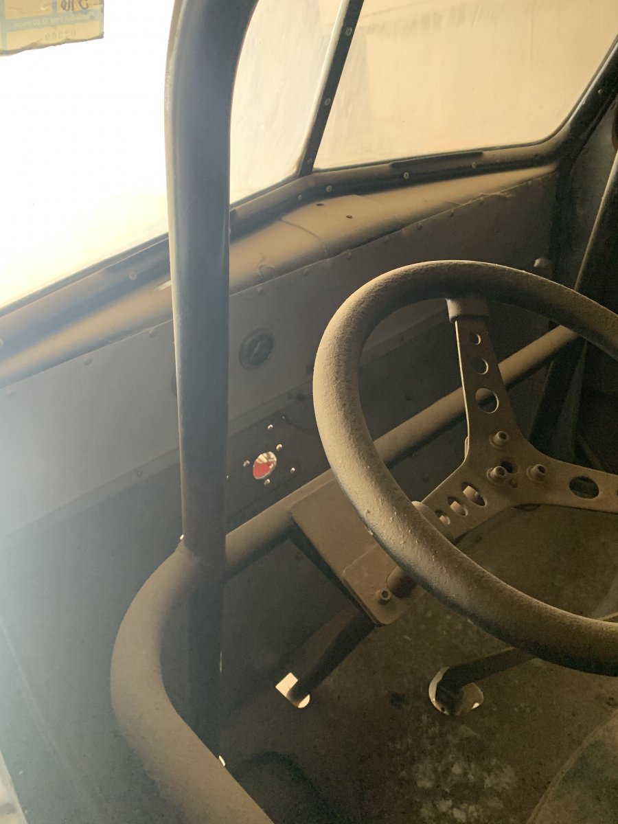

  28. Here’s the interior, or what is there of one. Dash is pretty basic, water temp and oil pressure and you can see where a tach once was. Everything is just sheet aluminum pop riveted onto the body for as light as possible.

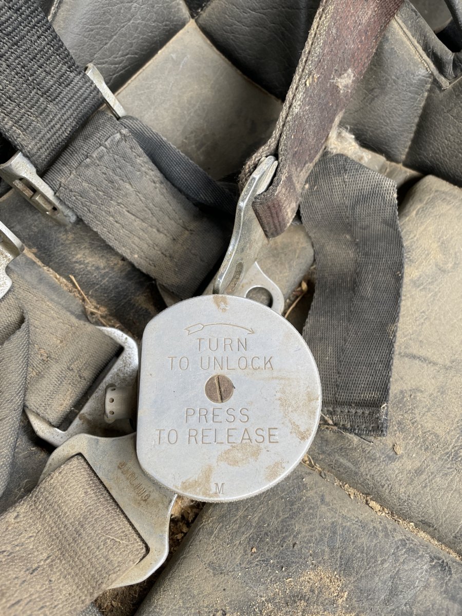

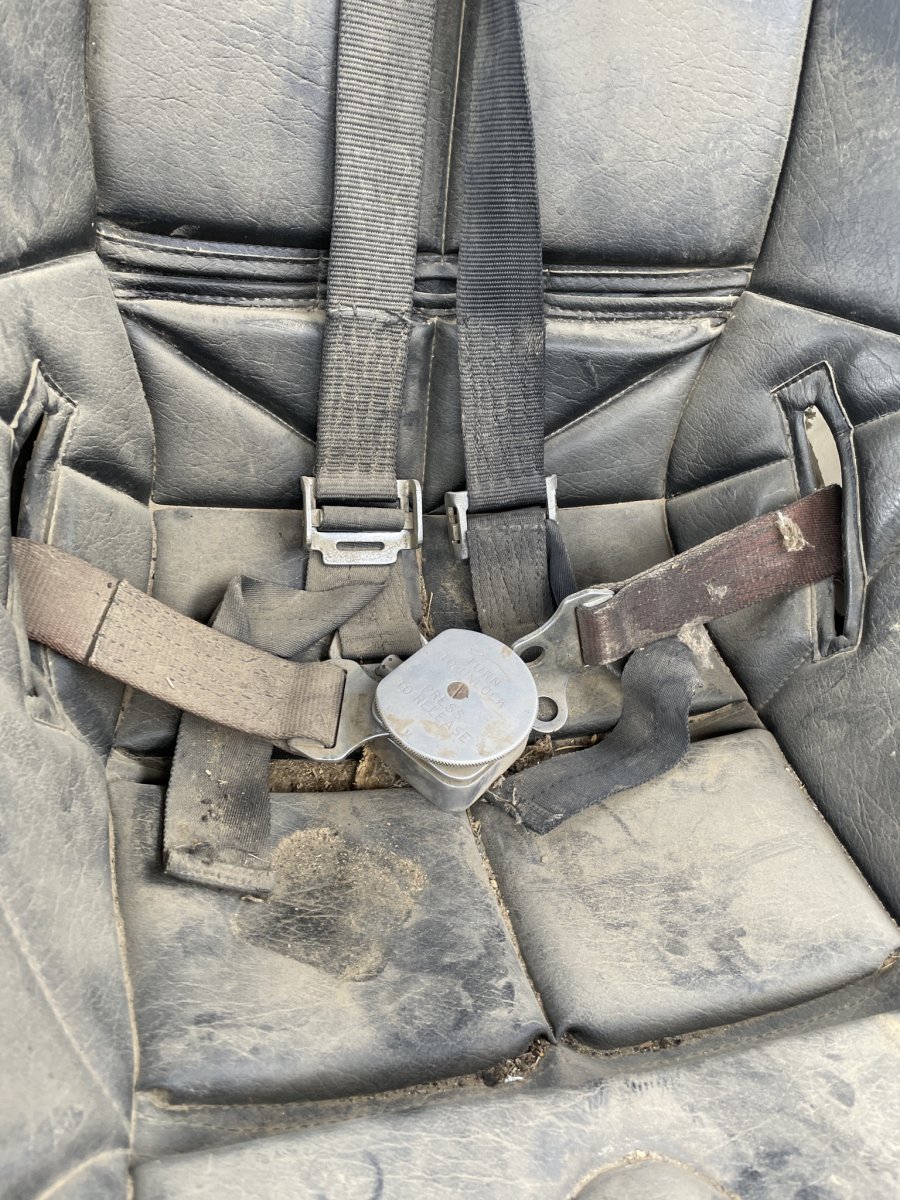

    Seat is an early foam filled rotamolded high back bucket with a vinyl cover and a real cool seatbelt setup.
    I really wish the stock dash was still all there, anybody know how hard replacing it would be, if it’s even doable? I see replacements for different cars, does anyone know if they are available for the 37/38? Or is it a cut it out of a parts car only option?

    The dash is welded in to the cowl. I’ve seen a ‘gl*** repro, probably on a street rod site. No steel repro that I know of. You’d have to cut one out from a wrecked body.
