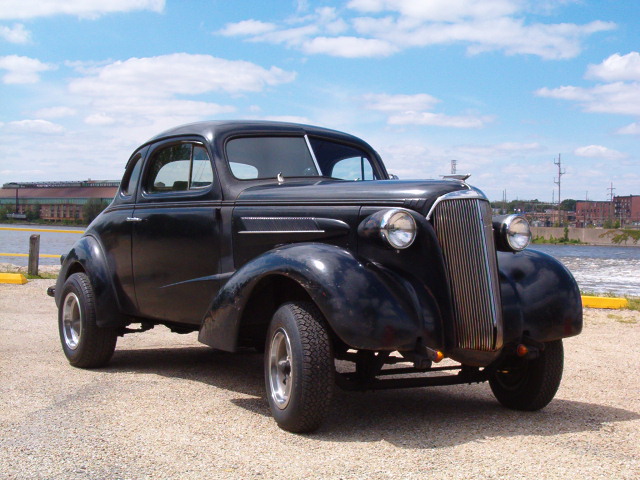

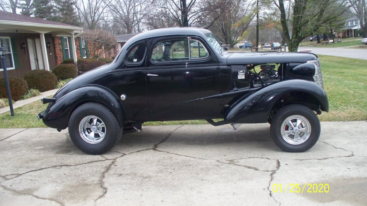

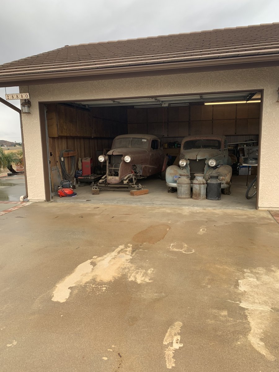

    ...what is the primered car beside your coupe in this photo?

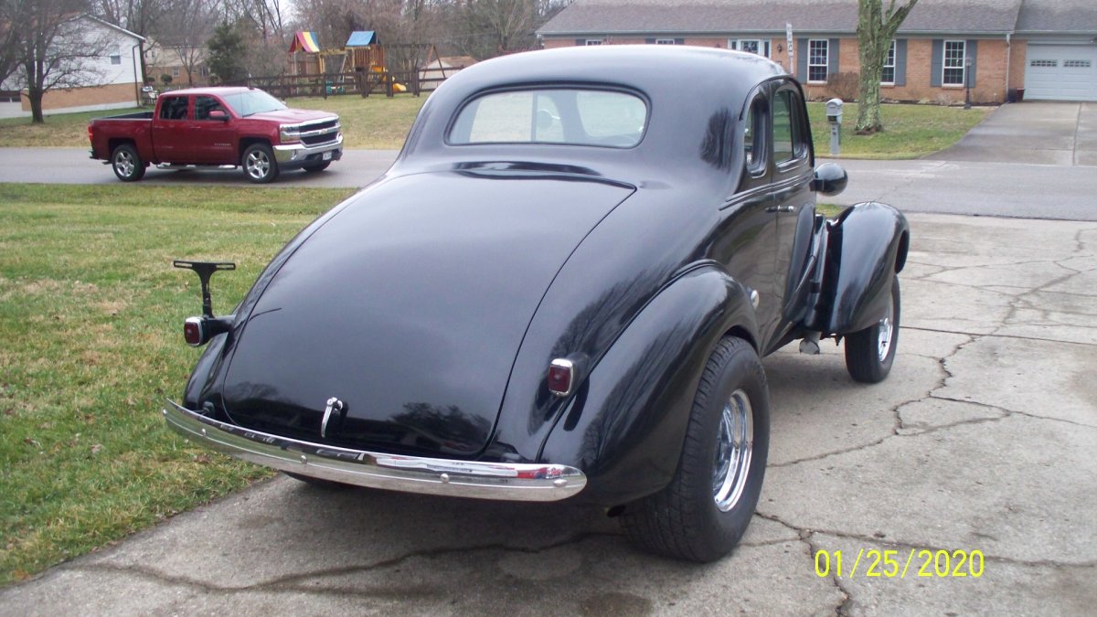

    ...here's a pic of my old 37 ...

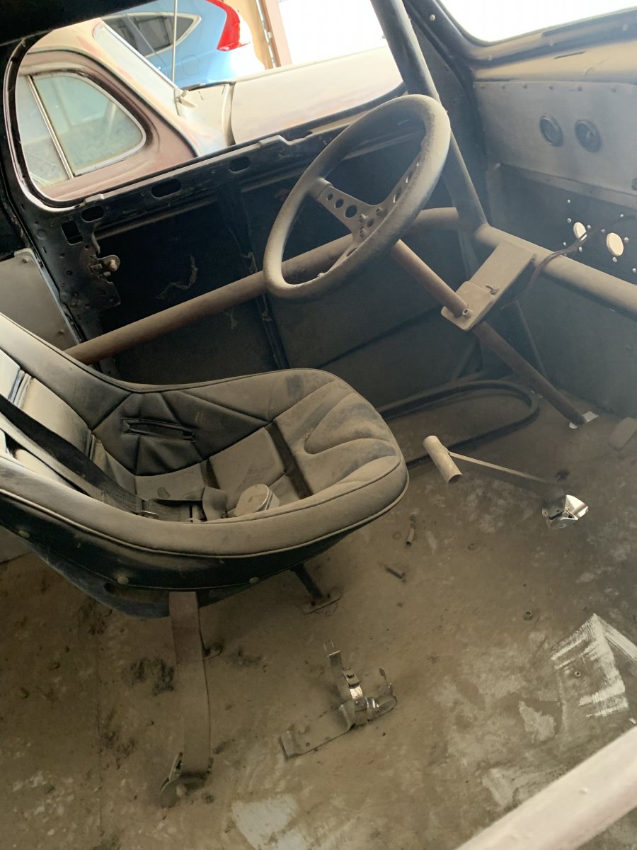

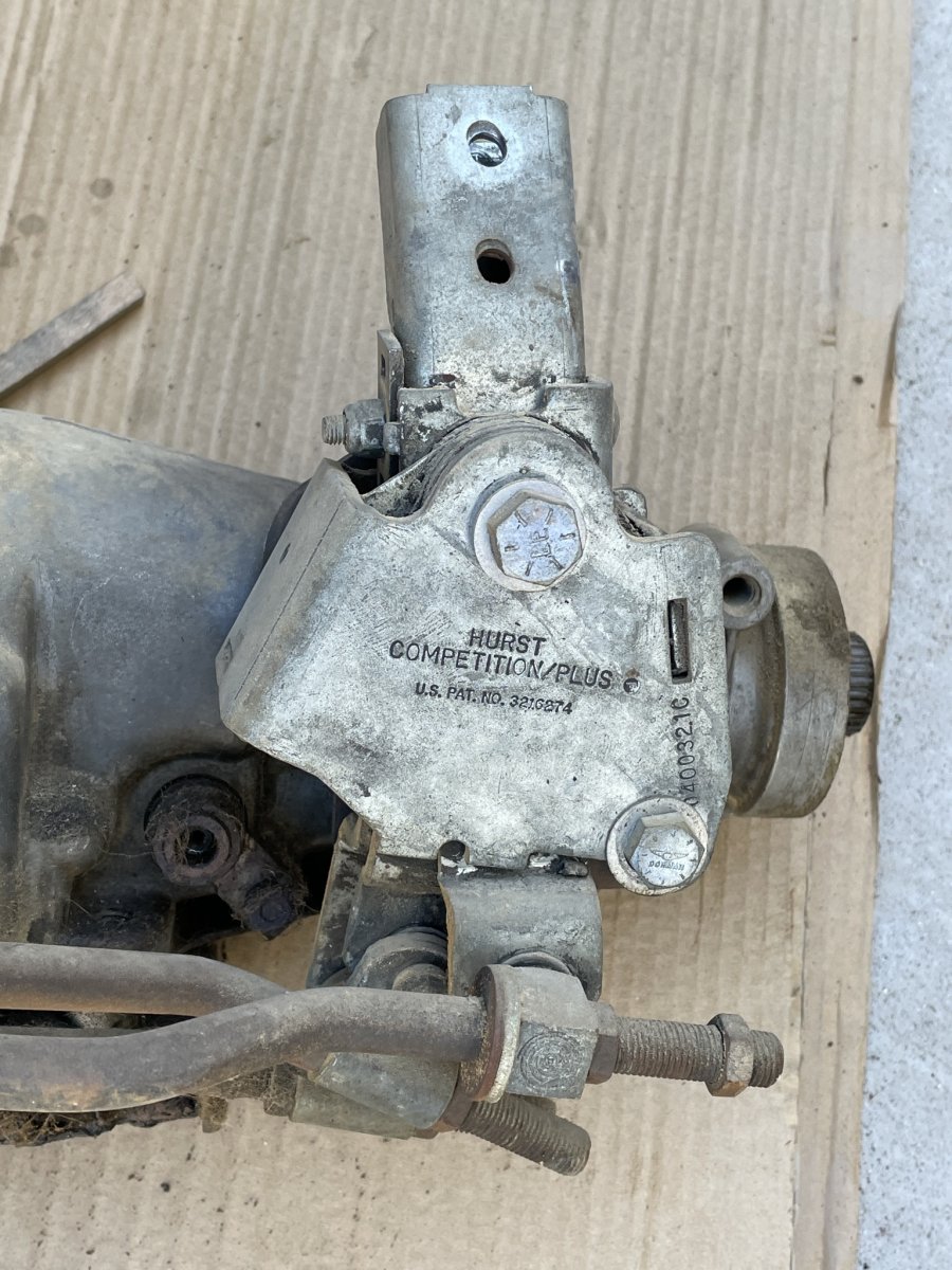

  9. I did get the car completely stripped of anything that will get damaged sitting outside because I need to make room in my shop for it. Don’t worry, up here in Flagstaff at 7000 ft it’s still Arid-Zona so nothing bad is going to happen to it. Rust?! No such thing here, we just get that wonderful, hard to fake, patina! Got the Muncie out, according to the numbers, it really is out of a 65 Corvette! Lol! While it was on jack stands I spun the differential, 4.56:1 gears with an open 3rd member.
    Nice Hurst shifter too!

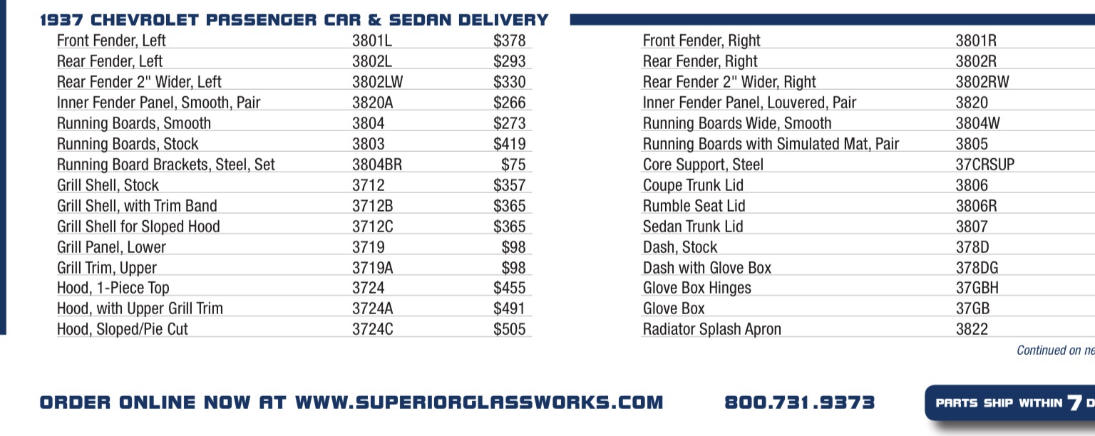

    I can’t find a place with a picture, though I remember seeing one somewhere. Looks like Superior Gl*** Works has them, at least in their catalog.
    “Smooth” had no gauge panel or glove box holes. Would make it easier to fit any selection of gauges you may want. The stock insert hole doesn’t leave a lot of room to work with.

    Superior Gl*** Works burned down a couple years ago. They lost all their molds for fibergl*** parts, and no longer produce or offer them. They are only a ch***is shop now. Sad as they were local, and one of the best resources for old Chevy fibergl*** parts.

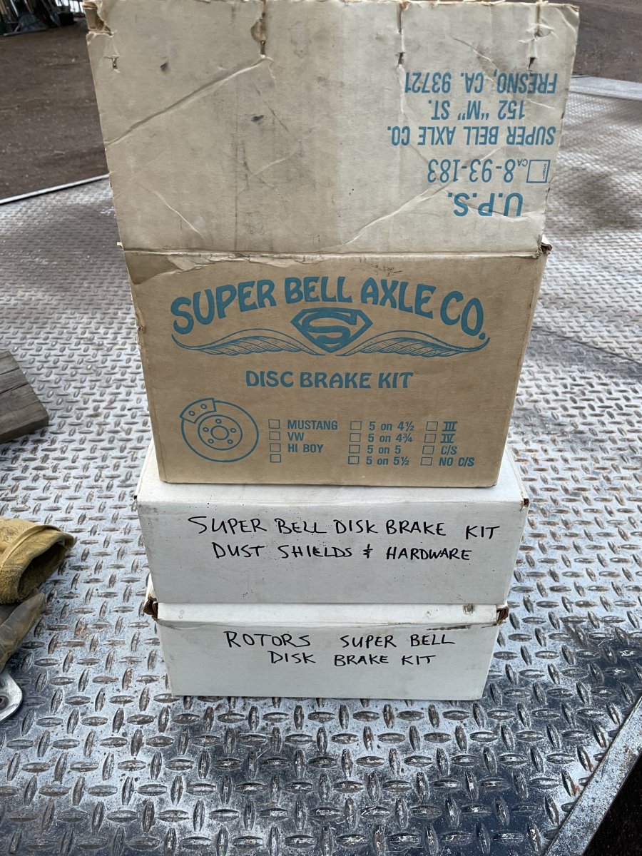

  14. The car didn’t have front brakes when it was raced so the PO bought a Super Bell disk brake kit for it, anybody have any experience with these kits?
    It has new hubs and rotors and uses GM calipers from early 70’s Chevelles I believe.

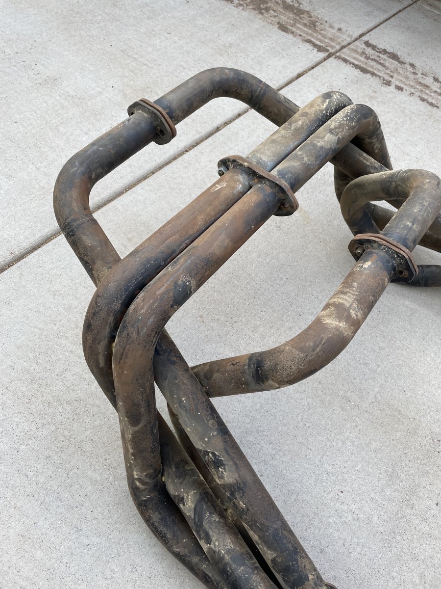

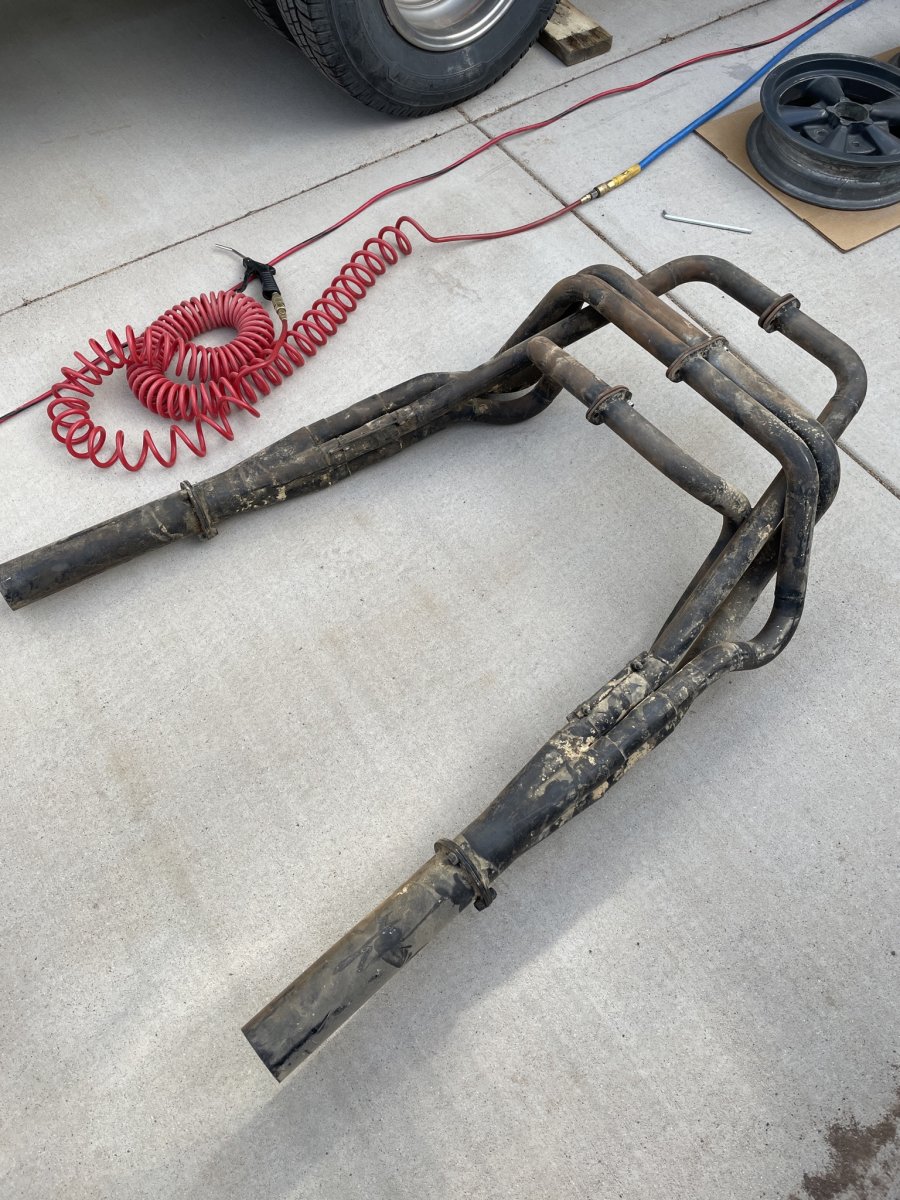

  15. Check out the really cool fender well exit headers...
    They have ****** collectors, so maybe they were a U-Build It header kit?

    I believe the Super Bell disc brake kits require the front wheels to be drilled and tapped for the rotors to be bolted to the wheels? Have had an Airheart kit years ago and that's what it needed. Haave you opened them up yet to see if there's instructions in the boxes?

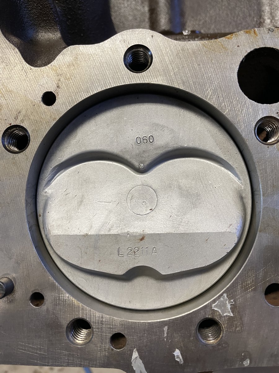

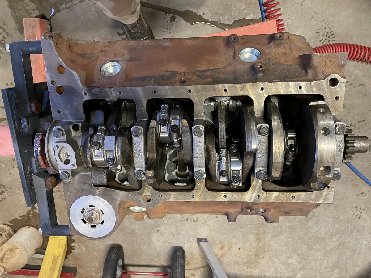

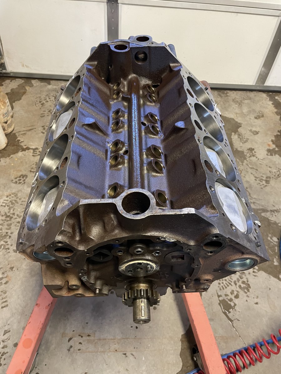

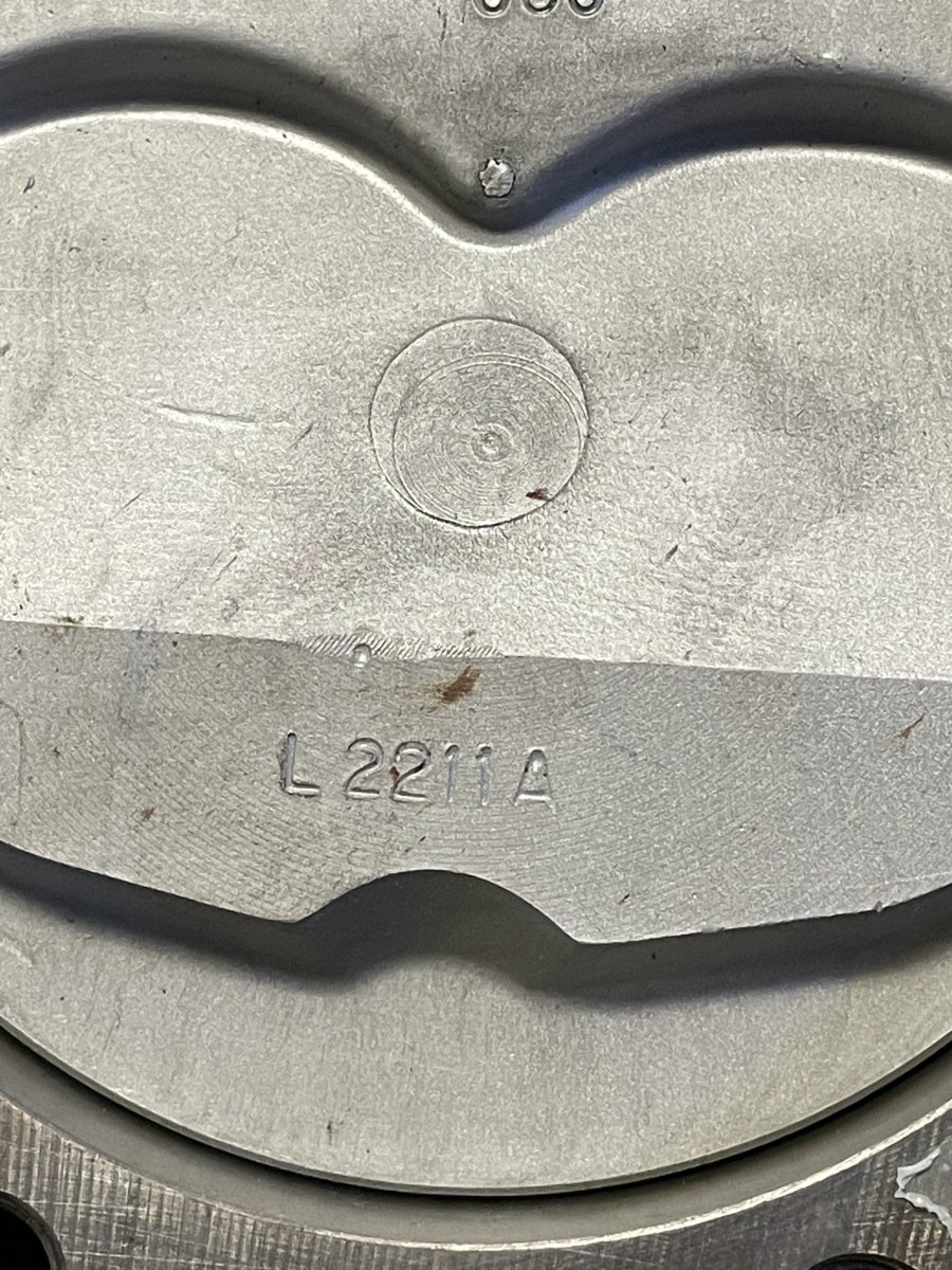

  18. Finally got the engine unloaded and on a stand, 327 that is .060 over with a balanced rotating ***embly. The pistons I think are 12.5:1, looks like the rods are worked and the crank is forged. The engine used to have a set of Mondello prepped heads but the PO remembered he had sold them about 20 years ago..... it would have been really cool to have those!
    The pistons look serious and the bores are bright and shiny. This short block was in a plastic bag since 1973!

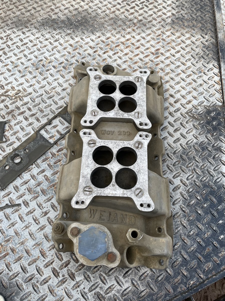

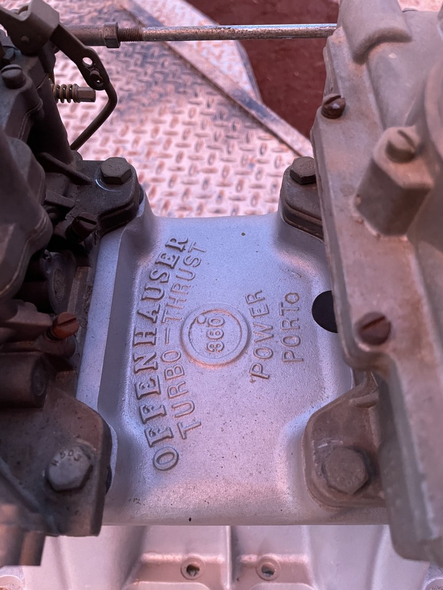

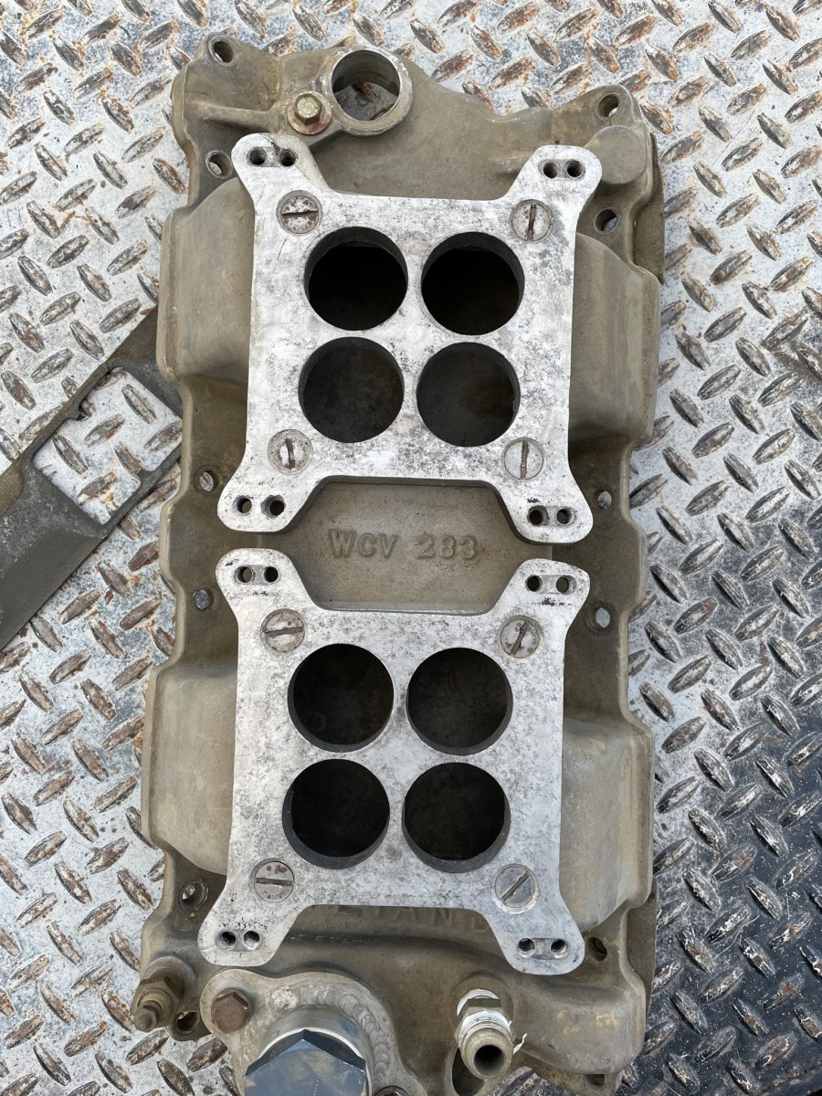

  19. The car originally ran this intake, a Weiand WCV283 with dual Carter AFB’s. It was ported old school, somebody cut the port dividers out of the intake. Must have been the “Hot Setup” back in the day! 6DE4C15C-38B9-4876-8393-A352E8923120.jpeg
    EDFC0078-0CCC-48BE-A5EC-807E2FB22596.jpeg E93EDE91-FEBB-4E25-808A-CB422CCC7064.jpeg
    I have a buddy who is a magician with a TIG Welder and I’m thinking I want to try to replace the port divider walls and use this intake like the car was run back then. Good idea, bad idea, don’t waste my time, or that would be cool?! What do you guys think?

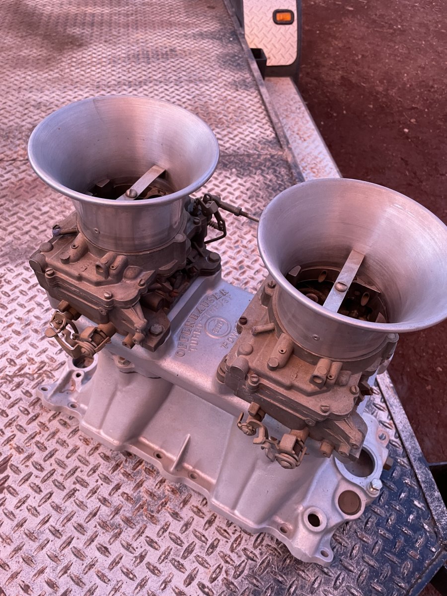

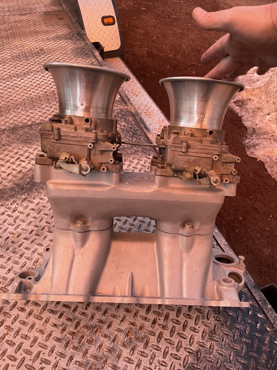

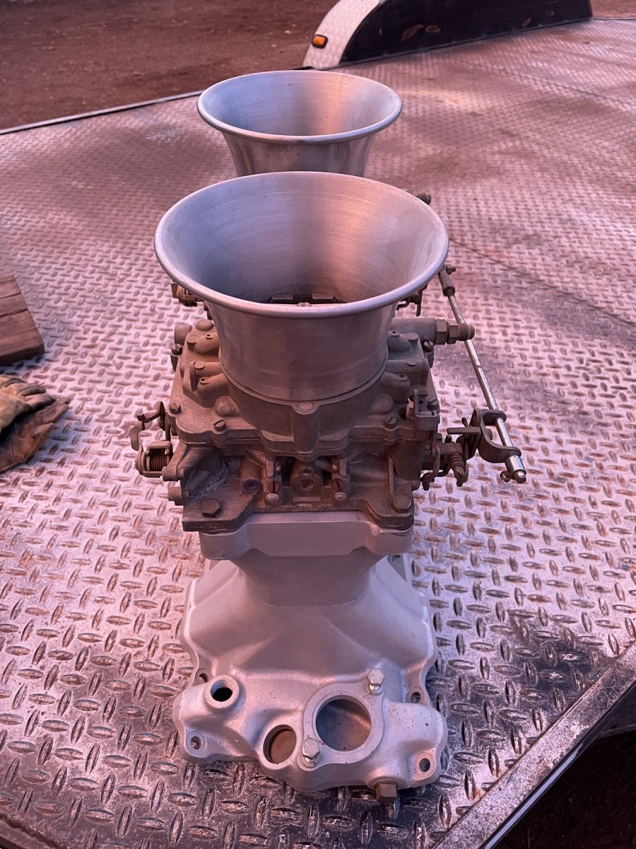

  20. Here is the new tunnel ram that the PO was going to run on the rebuilt engine....
    MORE POWER! 768364D3-F5B1-4F81-A78A-3A57C0E051EB.jpeg 42BAC97B-F624-4D2A-BD16-6DFCC99B06D9.jpeg 29581947-9879-40B9-A741-7CD3FB2EA349.jpeg
    These are the AFB’s from the original intake and the velocity stacks were also on the car then. Tunnel ram has never been run!
    OahuEli, bchctybob, AHotRod and 10 others like this.

    Daul quad tunnel ram with 12.5:1 compression SBC.
    That should get the job done.

  23. Edelbrock B10 sbc blower intakes were made without the runner dividers but not sure of benefits of not. By the way it's great that the carb adapters are still there. I find them usually missing on ebay or swap meet finds.

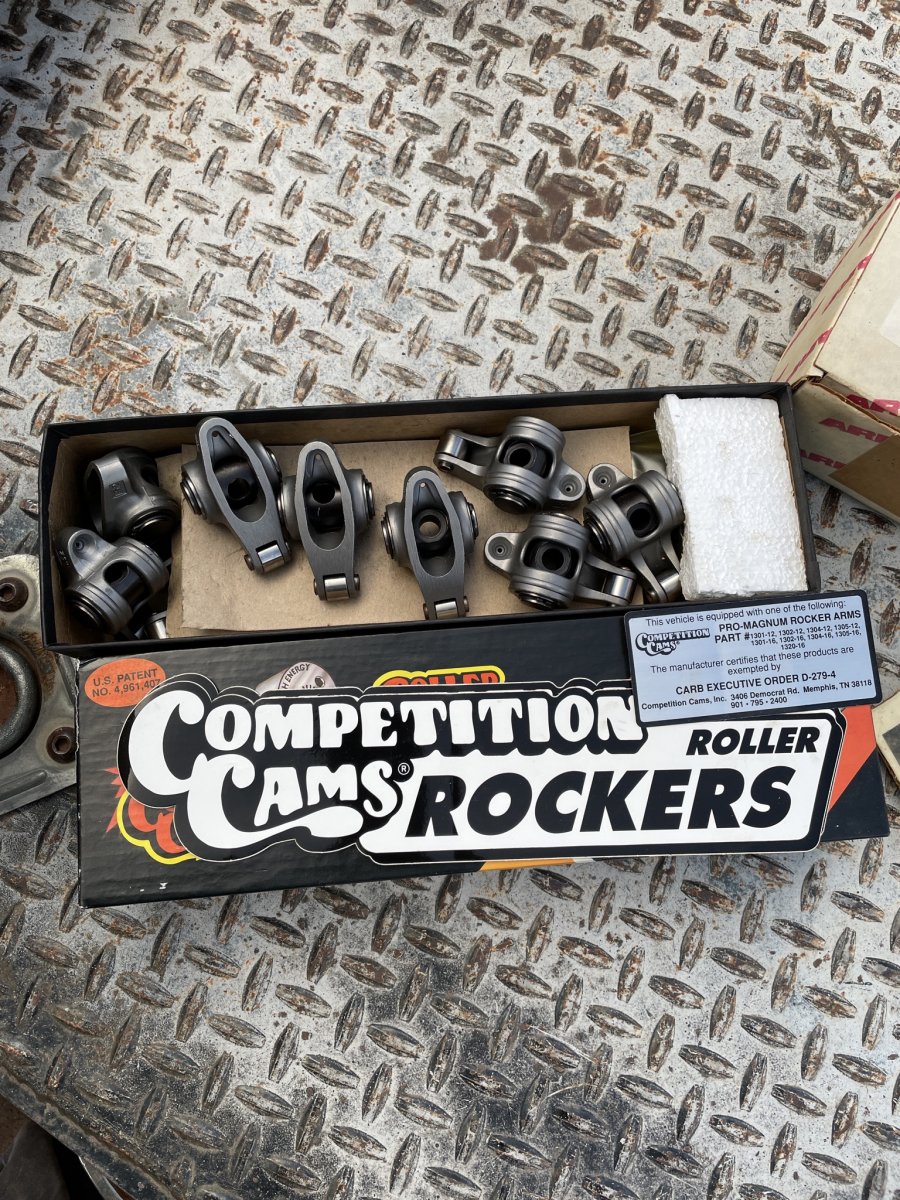

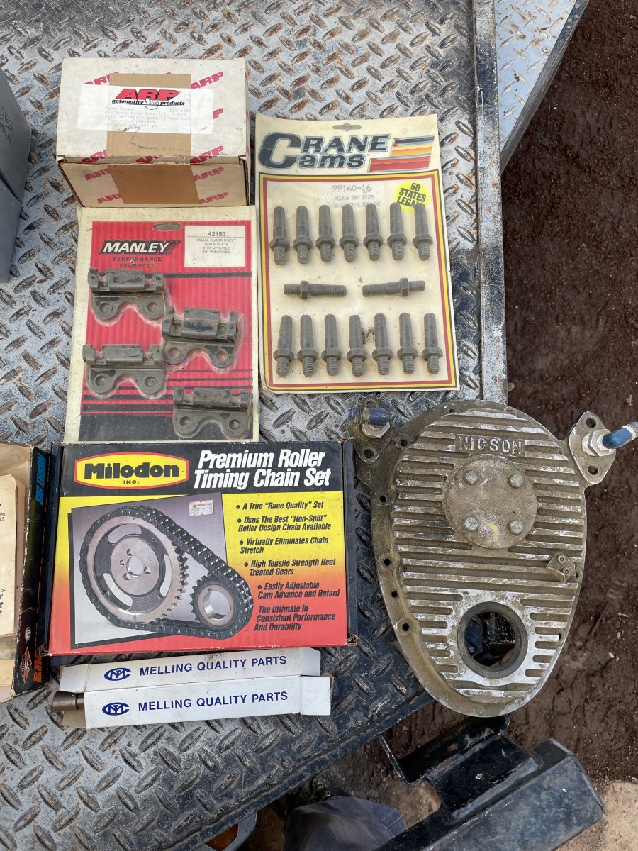

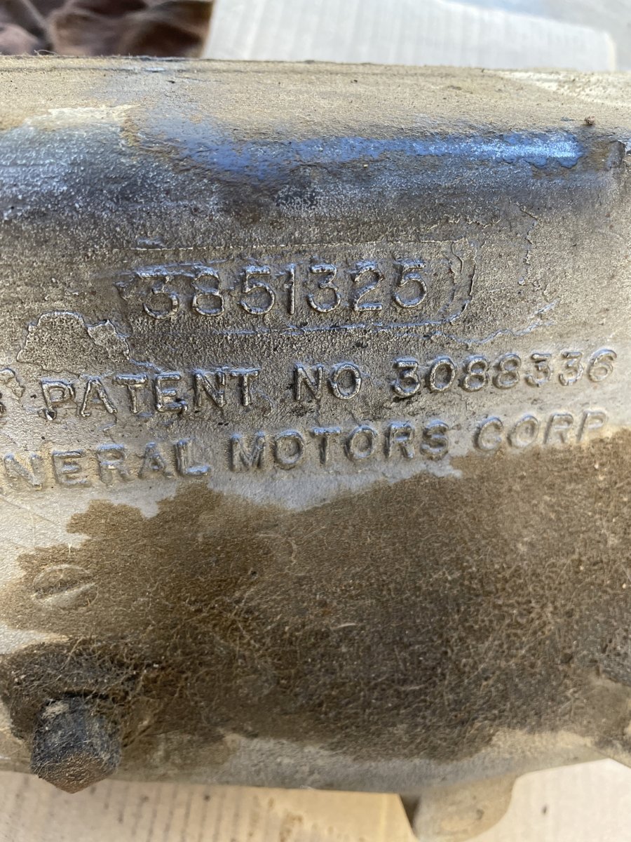

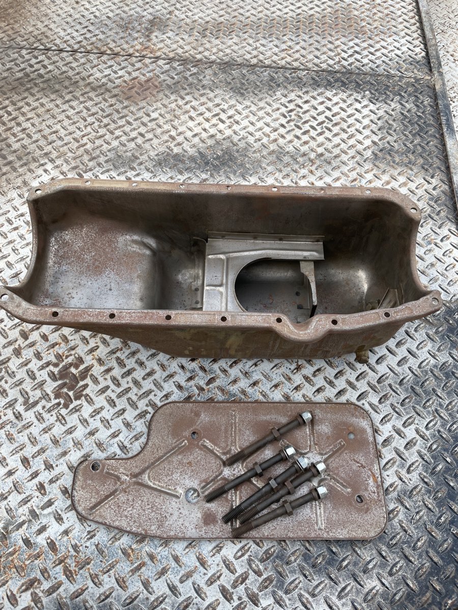

  24. Here’s the rest of the stuff I got.....
    Never used Corvette oil pan with a windage tray and bolts! Did I mention how much I love speed parts!!!

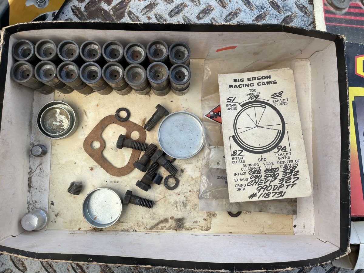

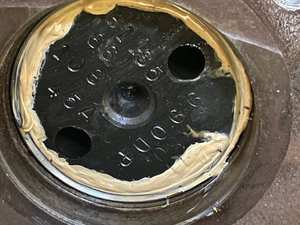

  25. Here is the cam in the 327... 15AA109E-1A91-441F-B062-256126B004A2.jpeg And here is the cam card and the solid lifters! 9599599F-88B6-4AFA-861E-D71C1656416F.jpeg

    They remove the divider to get an equal signal in the plenum from across all 8 cylinders, with divider you are limited to the cylinder that part of the intake feeds, I wouldn't put it back.
    Offenhauser 360's are known for it and benefit from an open carb spacer to get the carb up above the divider.

    Those are TRW pistons. Had a set in my '55 Chevy, but a smaller version since it was a well built 283 in mine.

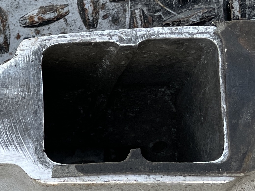

  29. I don’t think I was clear in my description of what was done. The divider I’m talking about isn’t in the plenum, I’m talking about the wall that divides the intake runners right before the ports in the heads. D68183E6-9888-4E29-9E05-B615C7AD8E0A.jpeg I hope this is easier to see.

    Never see the runners opened up like that before?
