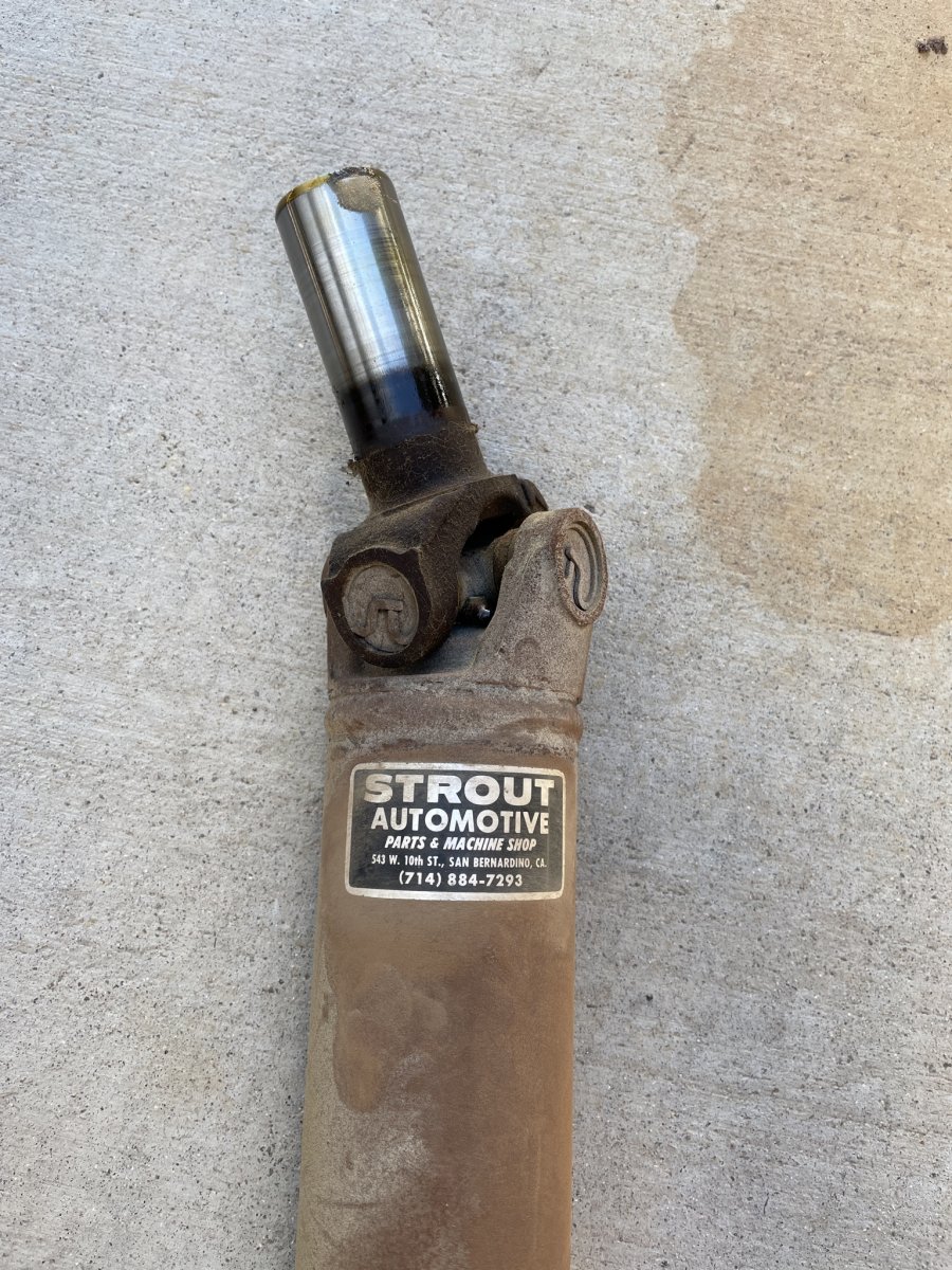

    Attached doc is what I found. And Google search of the address shows a commercial building that currently for sale. A further Google search may find Robert Strout.

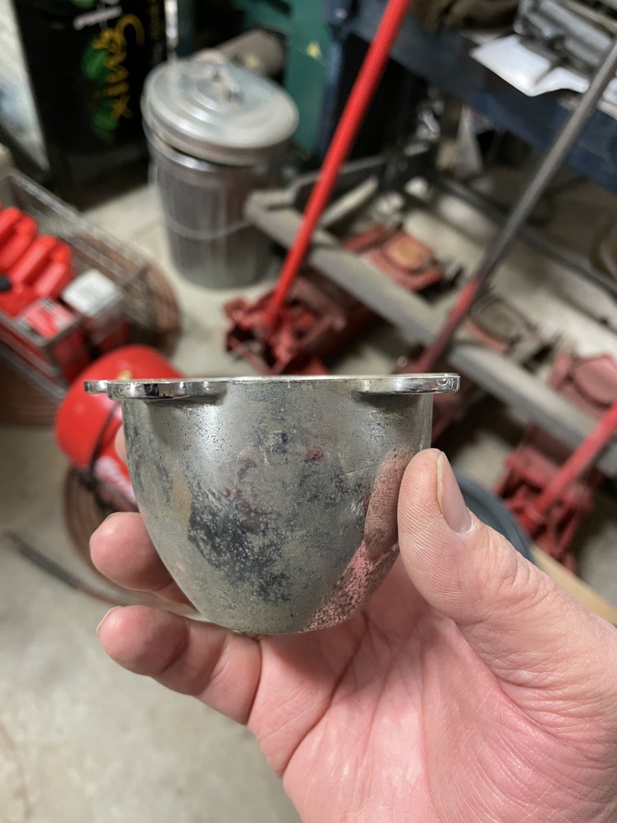

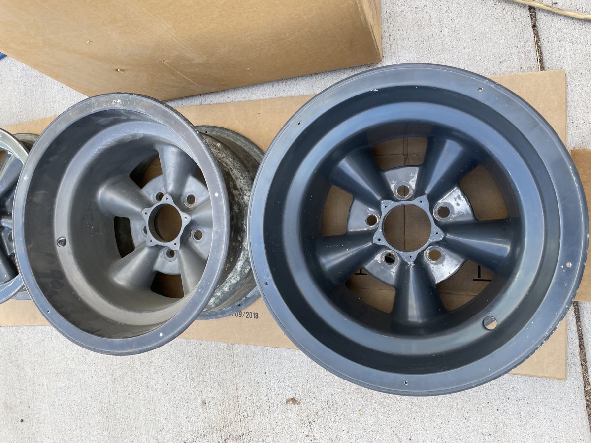

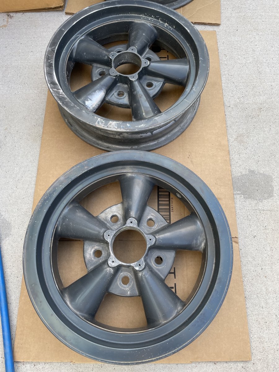

  4. Finally got some time to post the last of the stuff, the wheels! The fronts are 15x4 with a 5 on 5.5 bolt circle. CD99177B-5B72-4D9E-99EA-58F6D6587C5C.jpeg I also got three of these chrome plated center caps. The plating is pitted, they will need rechromed if I’m going to run them, or try to find polished aluminum ones. I’m thinking the polished ones would look better....
    The rears are 15x10 with 5 on 4.75 Chevy pattern. The PO had all the wheels polished about 20 years ago and then they sat in his garage and turned dark gray. F357CF27-FDAF-4B2B-BDFD-F7E545C84FB6.jpeg
    I don’t know yet if I want to leave them dark gray or polish them. Does anybody have any experience with polished magnesium here in the dry air of Arizona?

  5. Also can anyone verify what the wheels are? There is no ID info on the front or back side of any of the wheels. I’m thinking American Racing 5 Spoke magnesium, yea or nay?

  8. Yes, they are American Racing. They did not cast American Racing on their magnesium wheels except some special wheels that had it on the front side in the lower flats of the barrel area near the spokes. There may be a small date code on the back of one of the spokes. Also real American Racing center caps were chrome plated. I'd probably have those rechromed if possible. Other companies used polished aluminum. I have a pair of NOS in the shop but there's 22 inches of snow in front of the doors so I can't get to them for pics.
  9. That’s cool to know. I have some flat caps that I had made about 10 years ago. I’m thinking when I get to the wheels the fronts will look great with rechromed center caps and on the rears either the flat caps or maybe nothing with Summers Brothers Axles proudly displayed! Thanks guys for the verification!

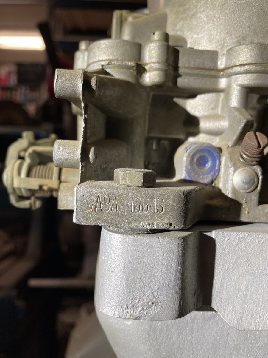

  10. Got the numbers off the AFB’s tonight, they are both A9A 4664S. All I have found on the InnerTube is that they were originally on a 1969 AMC 390 with a manual transmission. Anybody else have any more info? Maybe CFM rating? 8020EE6E-F3EC-4C5F-B197-4D64ADE5EF76.jpeg

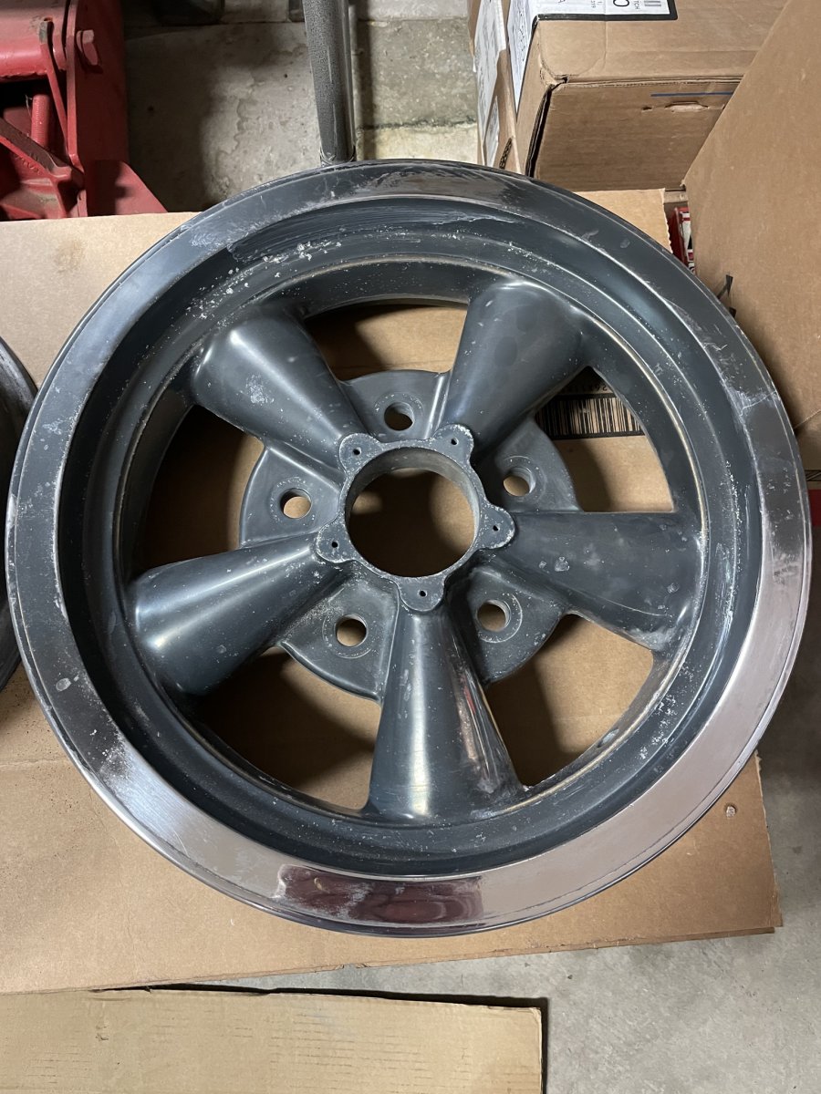

  11. Looked on the backside of the fronts tonight, you’re right, both wheels do have a date code. One was cast 06/01/64 and the other was cast 06/02/64. Must have been a matched set and together their whole lives! Couldn’t find anything on the rears though....

  12. I also stupidly got out the Mother’s and and nice soft rag......
    Man does that shine, I’m screwed! Does anybody have any tips and techniques for polishing genuine magnesium wheels?
    Thanks, I’m sure my fingers will thank you too!

  14. The PO had the wheels polished then let them sit in his garage for 30 years. Tarnish!

    Polishing real Mag wheels , look for Dave Mann @ www.roadsters.com then find magnesium wheels in his index.

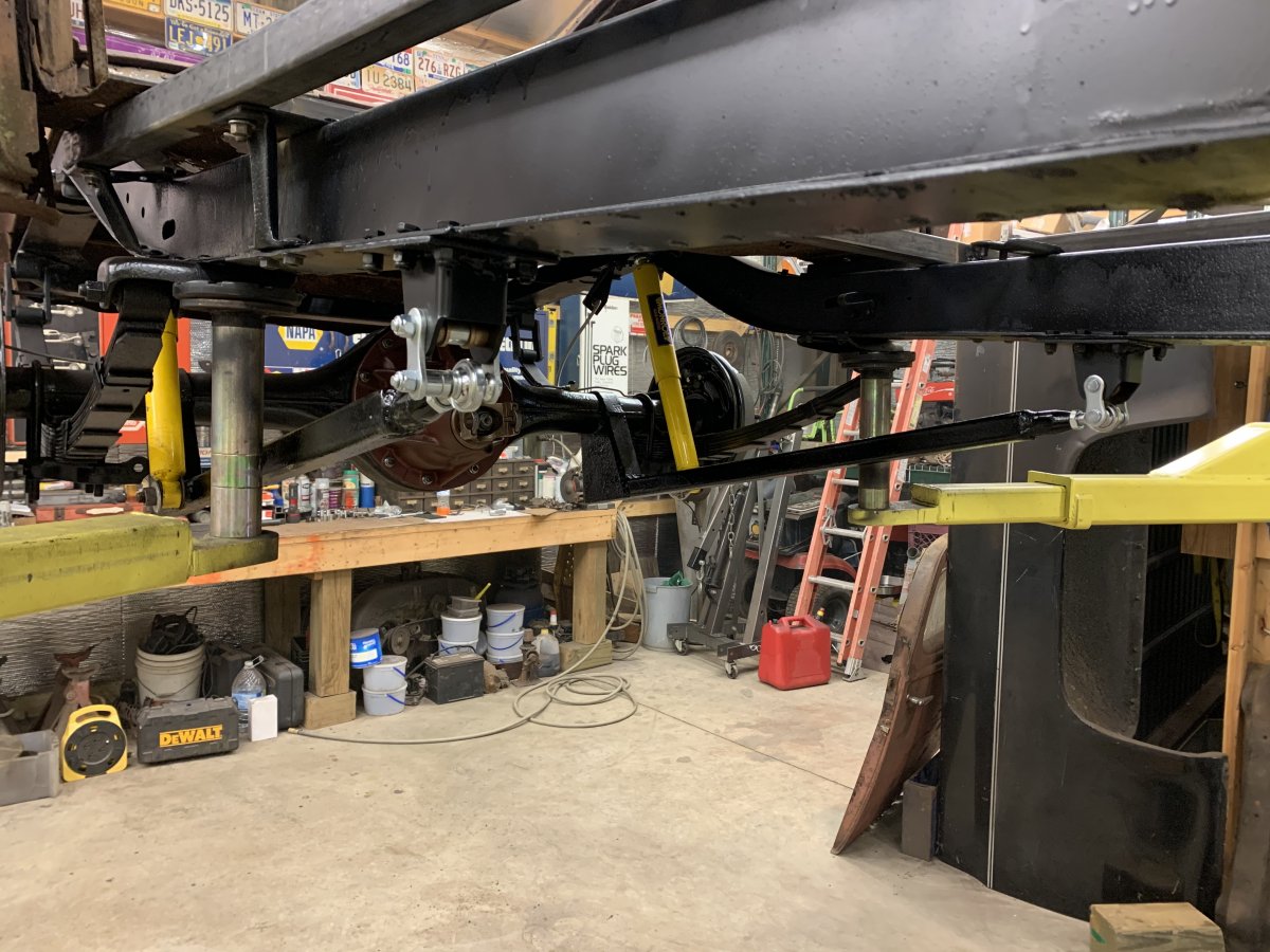

    Easy enough to correct. Here's my 36 Chevy coupe rear setup. Also a former 60s drag car. Also a 57 Olds rear. Had 5.38 gears and welded spiders when I got it.

  18. I like the way you think.. This is going in my 36 Chevy coupe, former 60s drag car.

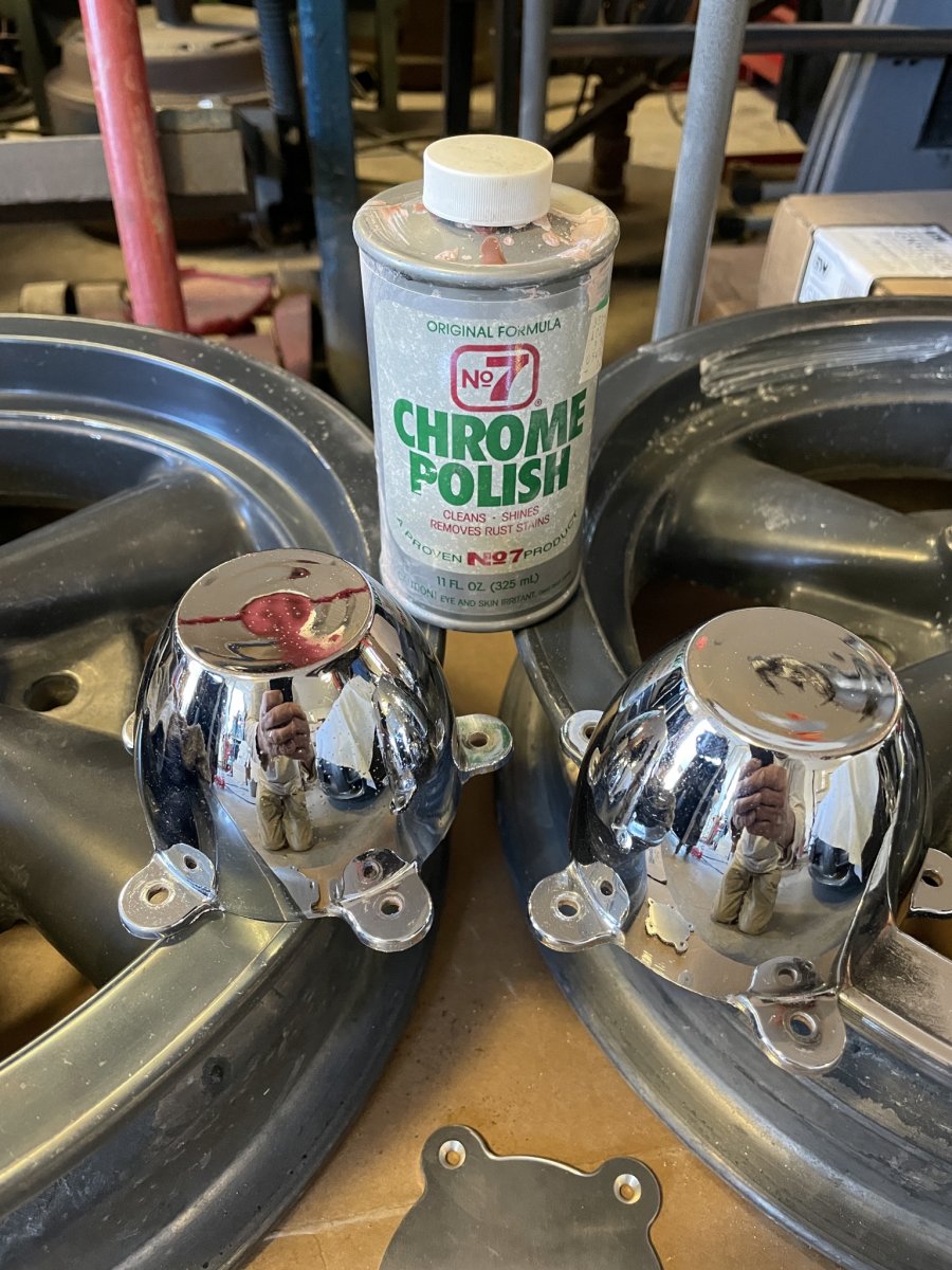

  19. Remember those crusty center caps? Well, about 30 minutes spare time and some #7 Chrome Polish and they look like this now!
    45EA1A4D-281D-4B10-9C77-9E71BEFA2790.jpeg One of them is really pitted and needs rechromed, but I’m thinking these two will be fine!
    catdad49, egads, AHotRod and 9 others like this.

    That's the same setup I built for my '39 Chev coupe, but I built ladder bars just because I love the looks and strength they have.
