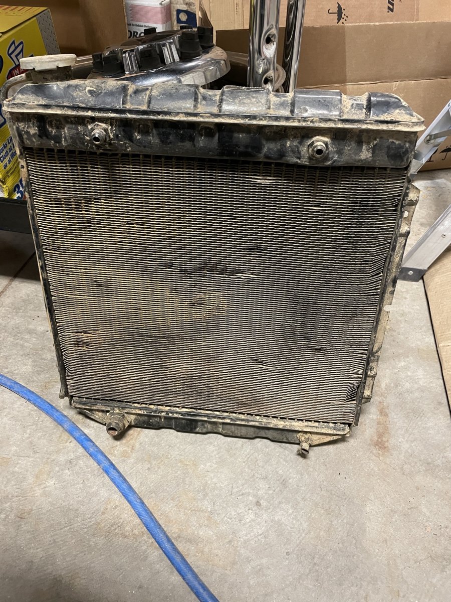

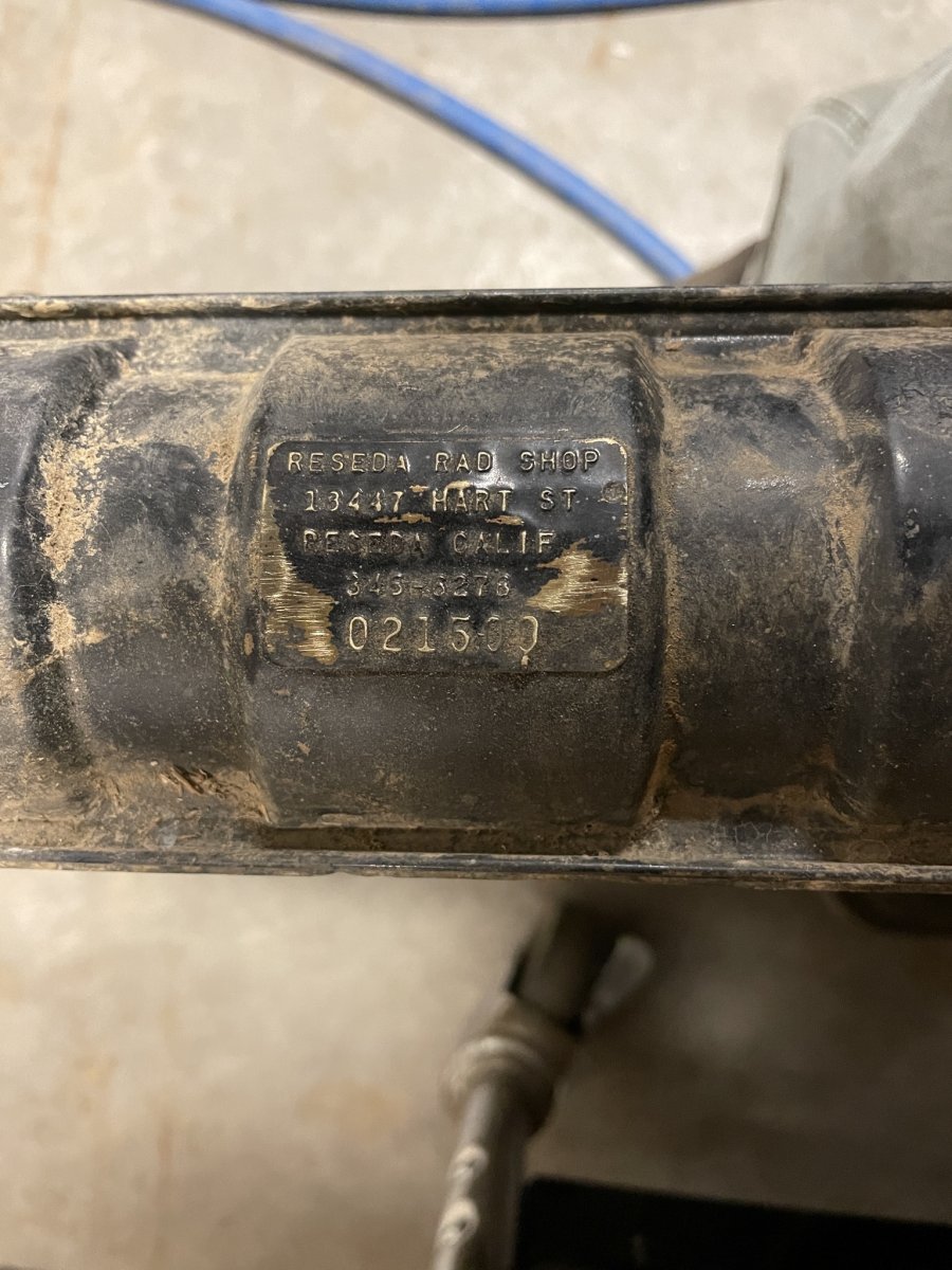

  10. Out working in the garage today and was looking at the radiator that was in my 37/38...
    The original builder had the radiator modified to use two AN lines from the block water pump outlets to the top tank. Then an electric pump was used to circulate coolant thru the lower tank back thru the intake manifold. Or maybe the other way around! But on the top of the radiator was a tag....
    and on the tag is a job number! The odds of this shop even being in business still are slim, and for them to know who had this radiator modified even slimmer, but then the original builder would be found!
  11. rusty1
    Joined: Nov 25, 2004
    Posts: 13,092
    rusty1
    ...wonder what that radiator was from?...doesn't look like a 37-8 Chevy...
    doesn't really matter I guess.

  12. 1971BB427
    Joined: Mar 6, 2010
    Posts: 9,838
    1971BB427
    from Oregon
    Reseda Automotive Air Conditioning and Radiators is still around in the exact same address.
    The radiator appears to be set up for racing use, and likely may not flow well enough with the line sizes to allow much street use on hot days. But I'd have it checked out and use it, and see how well it does.
    Bet the same shop could at least tell you what it originally fit, and how well it might work.
  13. I’m thinking it looks a lot like a early Ford Falcon radiator or some other early 60’s Ford car because of the tank design. I’m not even considering using it, it’s definitely a drag race only unit. I just think it would be cool to find out who built the car originally.

  14. stillrunners
    Joined: Aug 27, 2009
    Posts: 10,592
    stillrunners
    from dallas
    Maybe big Ford - Falcon's were really small....

  16. I measured the radiator tonight, 17” wide at the top tank and 20” tall. Definitely not a big Ford, I’m thinking a small 6 something, because I don’t think Ford had a 4 cylinder engine in anything until the Pinto and they came out in 1970?

  17. deathrowdave
    Joined: May 27, 2014
    Posts: 5,060
    deathrowdave
    from NKy
    Ford caps were mostly centered . I’m thinking a Jeep of some type . But that’s just me 2 cents worth . Early Bronco , possibility ? I had mine built many years ago , Camaro core stock tanks , worked like a champ

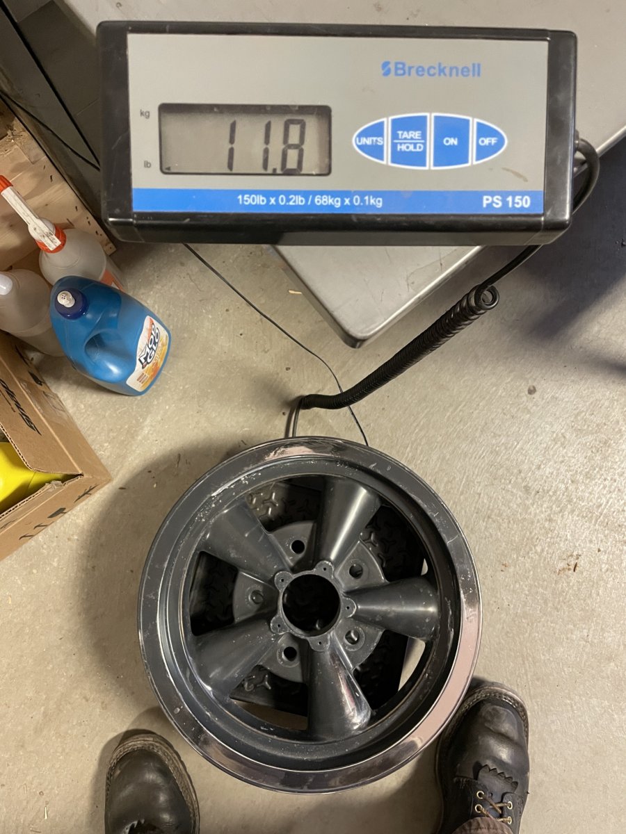

  18. Moving stuff around tonight and was putting the wheels up out of the way and saw my shipping scale, so, why not.....
    15x4, 5 on 5.5 B/C
    15x10, 5 on 4 3/4 B/C
    Now I just need to find the time to make them shine!

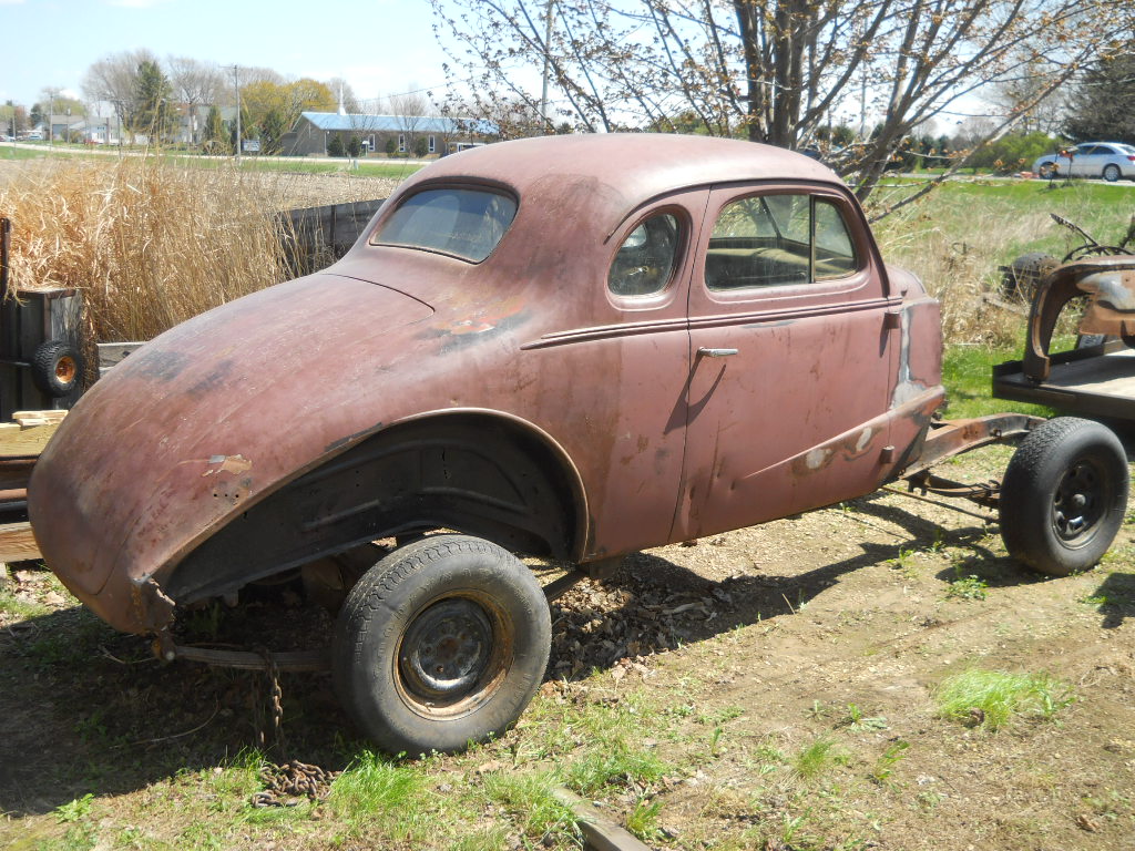

    ...here's an old g***er I bought that sit in a pole barn for 40+ years,...sold it to a friend who's getting it back together as a street car...
  20. Amazing! The same guy that cut my car up must have done this one too, and he still probably has some of that paint left over still!

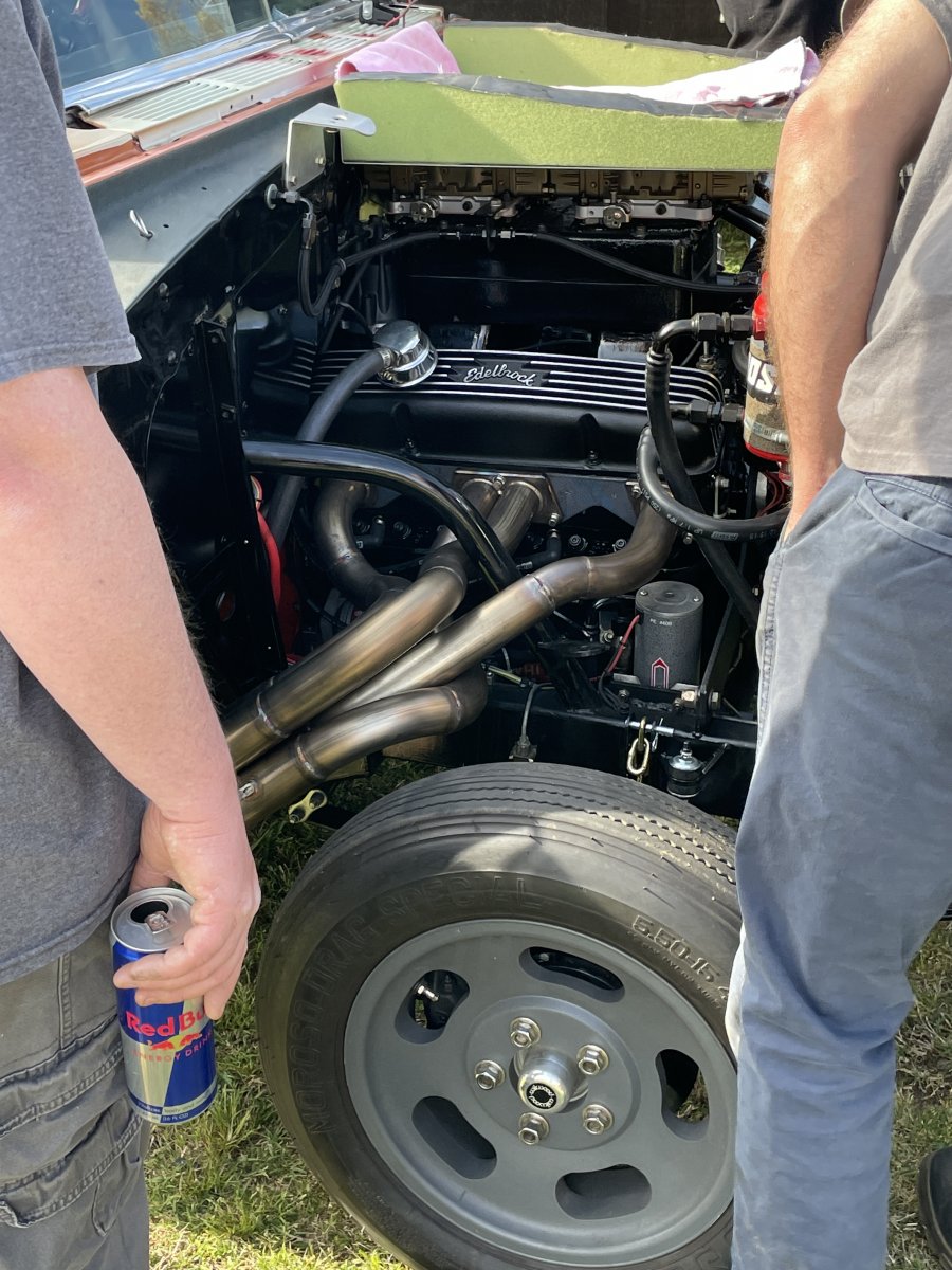

  25. Had an absolute blast at Shady Side, G***er Racing at it’s best! These Southern Boys are serious about their cars too, some look like they get some “MoonLighting” NASCAR guys to work on their cars, amazing workmanship on most of them.
    Check out the headers and plumbing on this car! Anybody know what wheels these are?
    AHotRod, catdad49, TFoch and 2 others like this.
  26. Black Panther
    Joined: Jan 6, 2010
    Posts: 2,376
    Black Panther
    from SoCal
    Aluminum slot mags painted grey. Could be 4" wide Ansen or US Indy..im betting Ansen
    Thor1 and loudbang like this.
  27. loudbang
    Posts: 40,347
    Lugs look too short (not enough threads showing) for most Drag Racing organizations.
  28. 1971BB427
    Joined: Mar 6, 2010
    Posts: 9,838
    1971BB427
    from Oregon
    Ansen or Fenton slots just painted to look like something else.

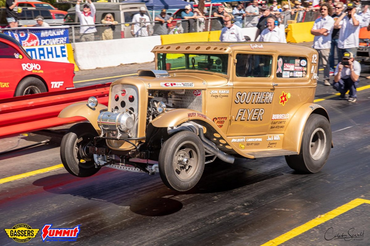

    Cool car! Pretty sure i spoke with you and your wife for a while at the race. I own the 31 model A, the southern flyer. Hope you enjoyed the race!
    Stogy, Thor1 and loudbang like this.
  30. We did have a great time, it was nice talking to you too. I think I’ve bored all my friends telling them how great SEGA racing is, they roll their eyes and shake their heads, but I’m a believer! They just haven’t been to a drag race where two cars that are so different yet on the same level as close as Quain can get them go head to head, first one to the finish line wins! 0806EFEE-EF71-4BE1-B7D4-247BDFA5FE76.jpeg
    You posted this picture on your build thread, my wife and I are just to the right of the VP banner trying to get as close to the action as we can get! Thanks for the great show!
