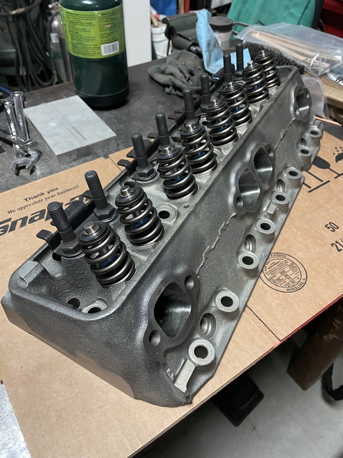

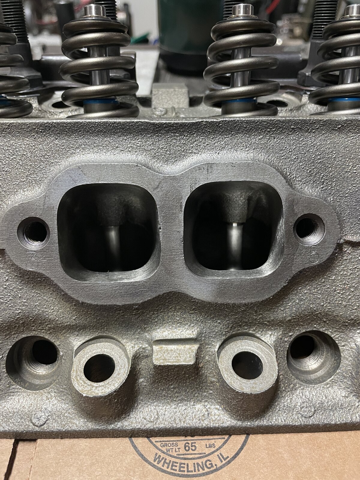

  9. Got my cylinder heads back from the machine shop today. Took them to Kadar Performance down in Phoenix a couple months ago, looks like Tibor (the owner and one man band member) did a great job. He does a lot of heads for the local drag racers and was highly recommended. He rebuilt them and added 2.02” intakes and 1.60” Stainless Steel valves. He also used Howard’s BeeHive Springs that are right for the mechanical camshaft I got with the short block. He machined them for 7/16” rocker studs and Moroso guide plates. He also relieved the combustion chambers for the larger valves. After he surfaced the decks he was able to verify the chambers were right at 62 CC’s just like stock. Was it cheap? Nope, but, in for a penny, in for a pound! What other heads would you run on a mid Sixties Gasser? 6C226575-EE15-4351-90C9-361AAF20C683.jpeg FFDF73E6-7419-4E35-A72B-635030A42D5F.jpeg 21D87EE1-EBAE-44D8-A554-75BD3EC400AF.jpeg

    Almost seems a shame to cover 'em with paint!

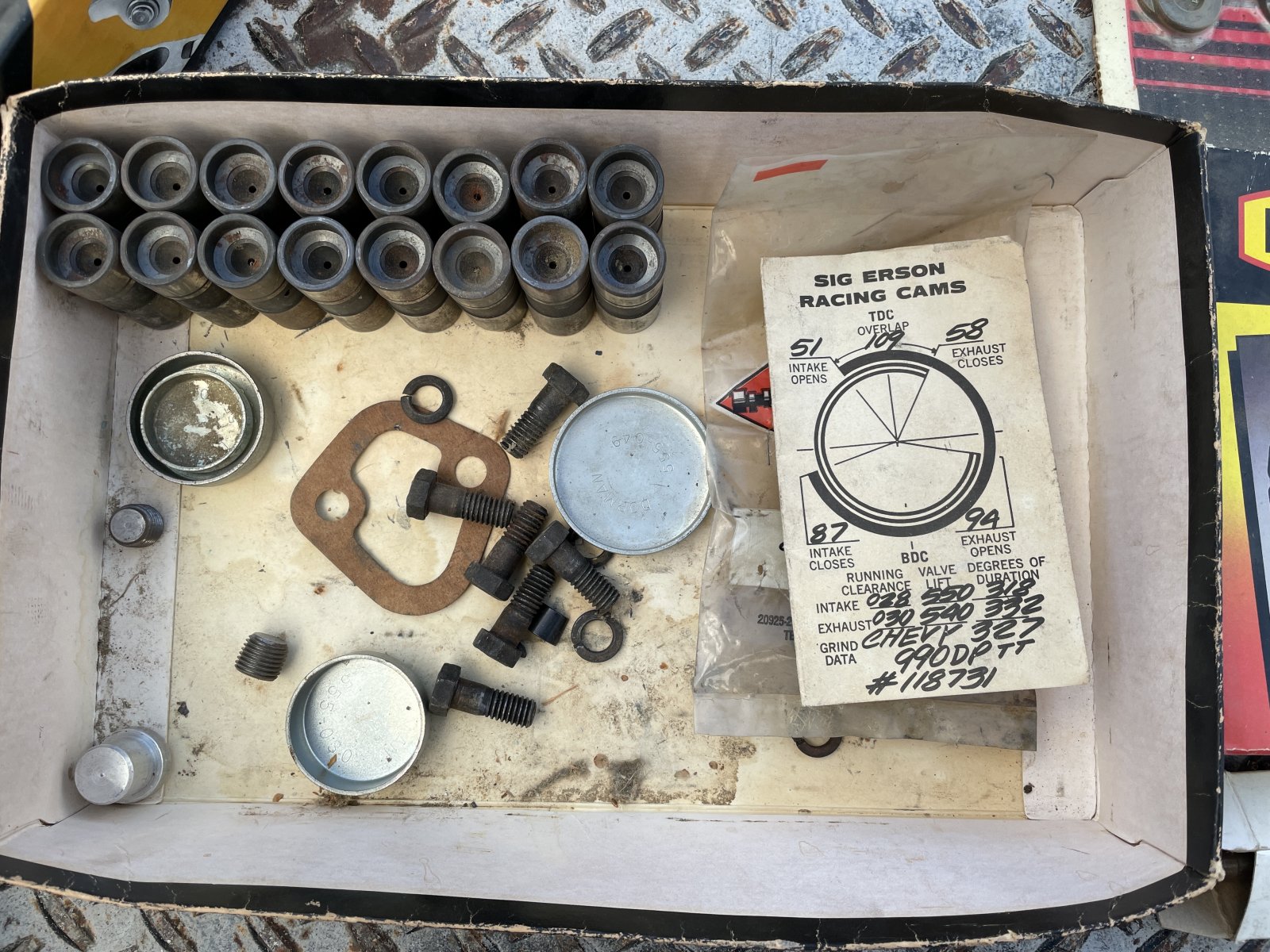

  13. I’m thinking the one I got with the car… 936C18EE-7D65-4589-B604-76AE49108896.jpeg
    I know, I know! There’s better cams available today but what fun is that?!

    Hey, I don't think that cam spec is boring at all. Did you give the cam card specs to Tibor when he selected the springs? I'm gun shy when breaking in a new cam these days, y'know?

  17. I did and he said he would setup the heads for that camshaft. I’m with you on breaking in cams these days, I’m going to be super careful and make sure I have all the secret potions and I might even have a Voodoo Witch Doctor come over and dance when I fire it up the first time. I am kinda a 50% owner on a engine run in stand with my friend Dan, I think I might be able to borrow it….
