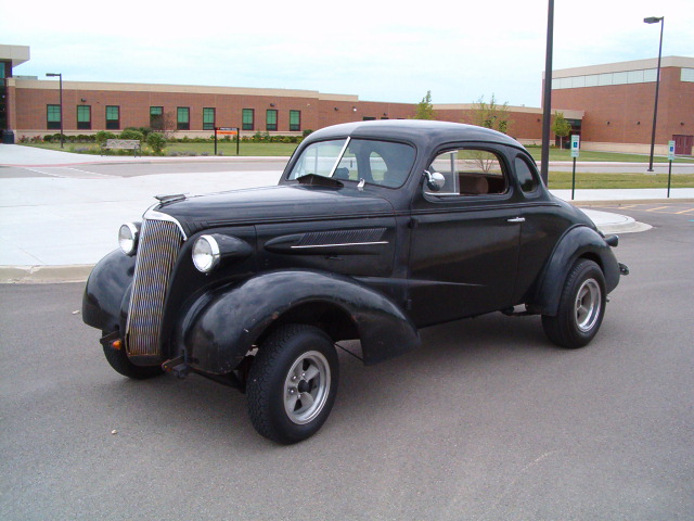

    38chevy.jpg 38chevy1.jpg 38chevy4.jpg 38chevy5.jpg 38chevy10.jpg 38chevy13.jpg Found this G***er project in an estate sale in Stone Mountain Georgia about 4 months ago. The daughter selling it said it was her dads but he put it in storage sometime in the 70's where it sat till I bought it. No engine or trans came with it just a roller. It appears to have been painted in lacquer but never buffed out. I started to sand and buff it and it is actually coming out pretty decent. Im going to build it kind of as a survivor car, but adding safety items like disc front brakes and new master cylinder. Not going to be a 100% restored G***er by any means, but will still be cool and fun to drive. Im going with a SBC 383 stroker motor and automatic trans. Here's a few pics from the day I got it to current condition.

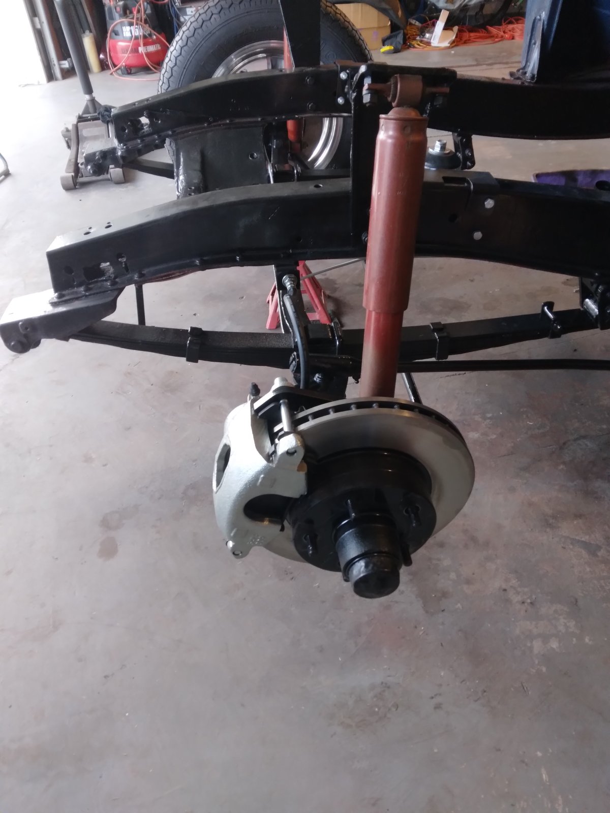

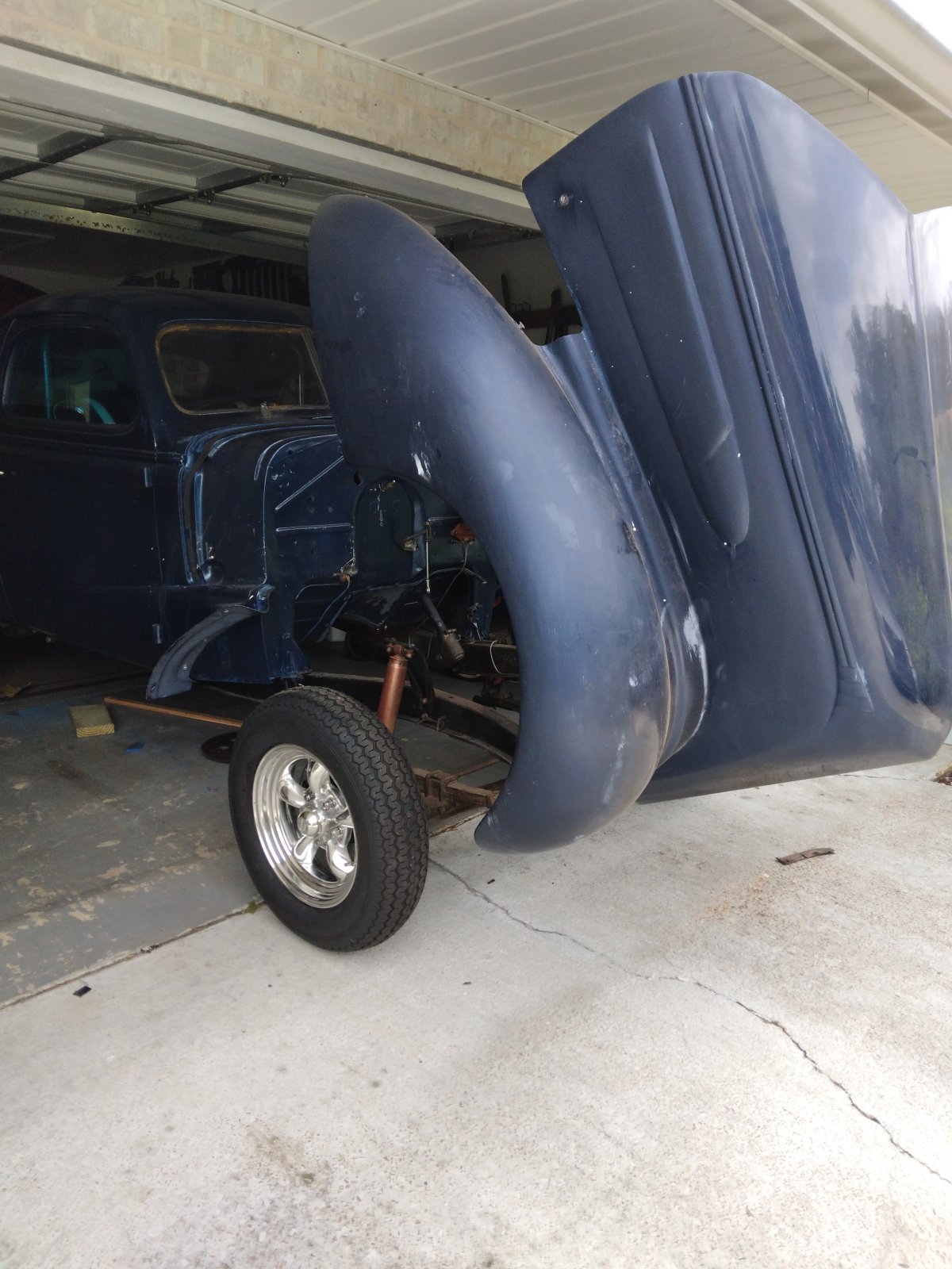

    20220818_144224.jpg 20220818_144154.jpg 20220926_154427.jpg 20221013_172029.jpg 20221102_124759.jpg 20221105_155743.jpg 20221020_163451.jpg 20220712_142705.jpg Few more pics..

    @T42 ... are going to make it street legal and drive it?

    Yes sir....that is the plan! I already have it registered with a clean ***le and antique plate.

    The fibergl*** nose is a 1937 Chevy.

    Yes it is...that is why my thread is ***led 37/38. The car is ***led as a 38 but the gl*** front is '37 obviously.
    I was at first trying to find an original grill to no avail. I then bit the bullet and spent $799 plus $140 shipping from Chevy's of the 40's for one of their "gangster grills". But I hated it so I ate the shipping both ways and sent it back. I have since decided NOT to do any kind of original grill and will create my own design in the front for air p***age. I have several ideas, but have not chosen a path yet.

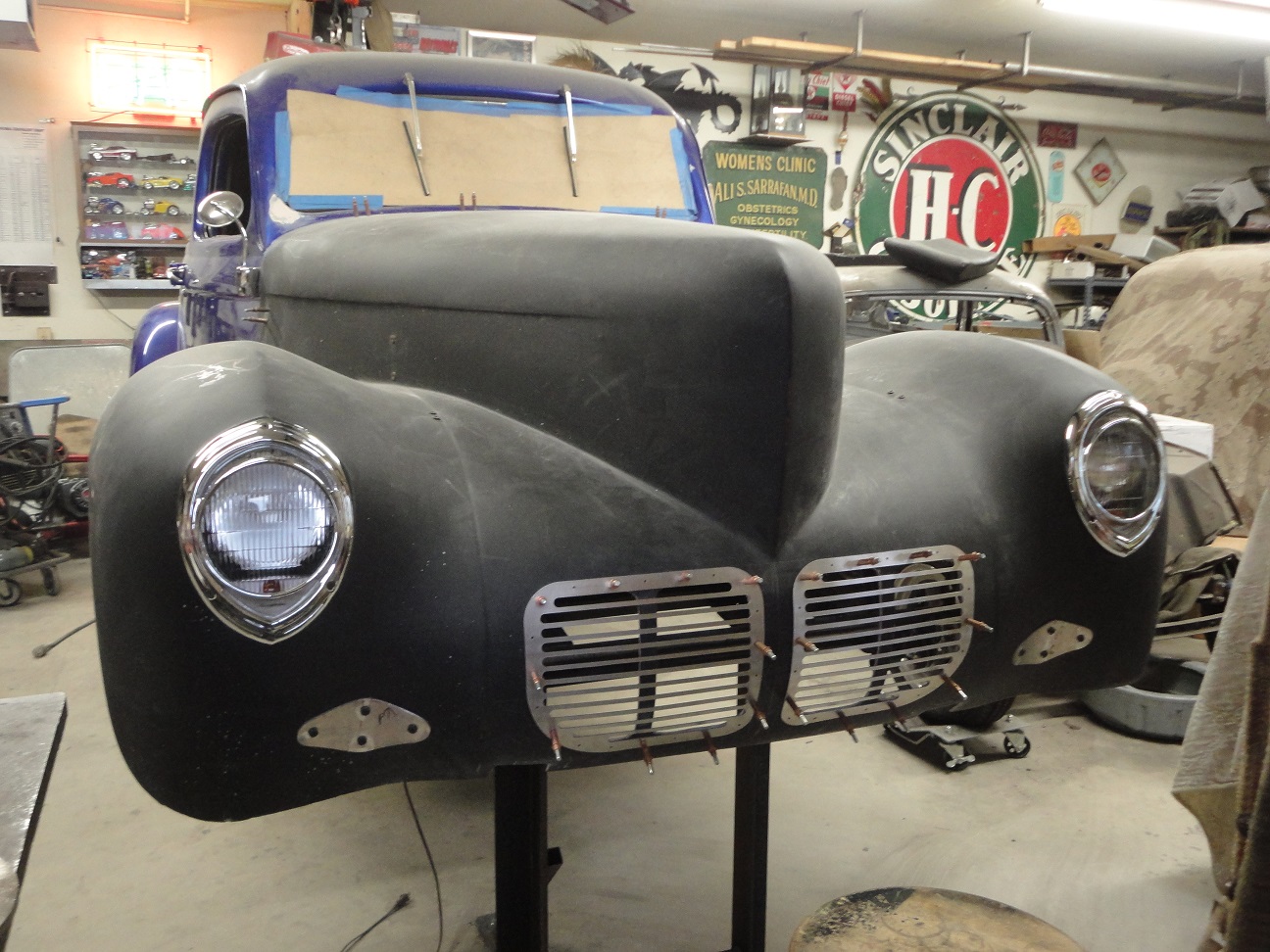

    37/38 Chevy coupe, one of my favorites for a g***er. Me I vote stock grill or reasonable facsimile. On my Willys I did .063 aluminum, 40 style grill [two pieces] because the compound curve of the nose did not lend itself well to a 41 [one piece] style grill. Saved a few $ by me drawing a pattern, friendly computer nerd doing a CNC program from my pattern and taking my own bit of material to a guy with a laser table, water jet would most likely work too. You can see in the photo a narrow strap of fibergl*** behind the grill for support. The late Don Nowell built one of the best-looking cars ever. He was a hell of a craftsman. Good luck on your car, looks to me you have a great start!
