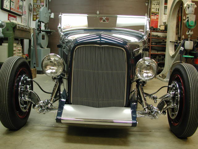

  5. There was a thread a while back with spring in front of axle rods pictured. They can look real smooth when done properly. I think it takes a little planning to get everything to lie correctly but they can be just as sweet as sugar pie.
    I keep a pair of '37 Yolks around just for that special rod when the time comes.
    Here is a link I found, some of the pics are red xs but there are a few examples here.
    http://www.jalopyjournal.com/forum/showthread.php?t=313994&highlight=spring+in+front+of+axle

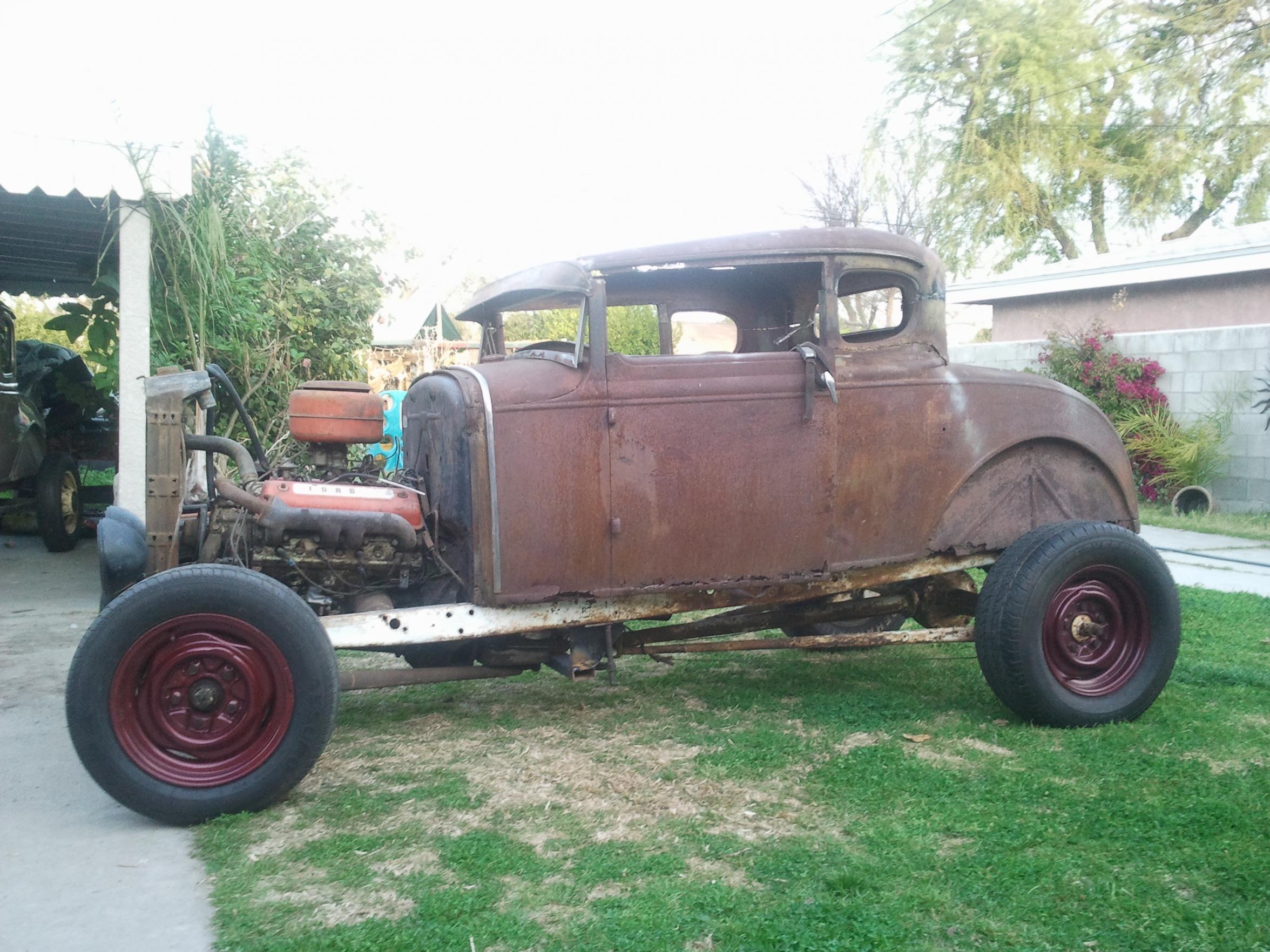

    I cut the front cross member at a 45 from the frame/firewall side inward on both sides & that gave me something to clamp to, so in other words I put the crossmember infront of itself & filled in the space & made new radiator mounts/drill holes. Fast & Easy & no firewall mods. need for Y-block.
