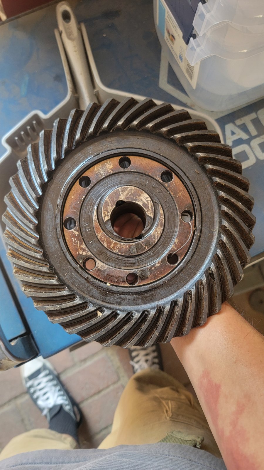

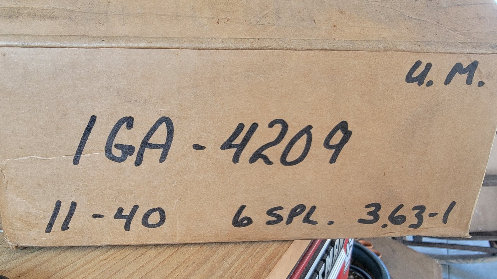

    I know it's been covered but I couldn't find a definite answer. I am about to rebuild my 37 Pickup Banjo but was confused about what gears to go with. I know the stock gears are 4:11, when I bought the rear end I got 3:63 gears with it, off of what I believe was a 41 Ford but I've heard 3:54 gears are better with the setup I'm going with, 350/350 with 16x750 firestones rears. I also have a '42 banjo open drive with 3:78 gears. I guess my question is would the 3:63 gears be fine or should I go with 3:54 gears? or rebuild the 42 Banjo? thx in advance. 20240907_142806.jpg 20240907_143024.jpg 20240907_143130.jpg

    Never heard of 363 gears for a Ford. 378, and 411 are the common ones, with 354 bing the other option. Irrelevant, but if you like the banjo I would go with 354's with the modern motor. Otherwise, modern rear end makes sense too

    yea, I did a search because it seemed like an odd gear but turns out it was used on 1941 Ford's. thanks for the reply.
