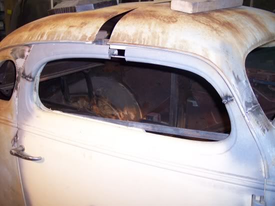

    I'll put some detail pics up to get caught up.
    After dropping the 37 down where it's going to ridewhen it's done, this is where it started last week at Dave's (Glassguy) Shop.
    After a bunch of hours walking around the car and draining diet bud's the saw comes out. Somewhere around 3" is coming off. We had originally talked about leaning the windshield post back and working the cuts so the top wouldn't have to be cut, but to keep the quarter windows reasonable, the top got cut in half.
    3" got taken out of the windshield post and then the front section was welded in place with the usual adjusting.
  2. Looking good, the end result with leaving the posts at stock angle will be worth it. I never have seen a chop with leaned pillars that looked as good as one with stock angle pillars.

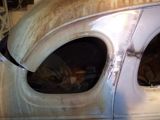

    Th B-pillar got worked next with the blending it needed. [​IMG]
    I had to share this new welding helmet with you guys. I don't think Dave invented it, but he calls it the invisi-shield. You get a tan while you work and don't have to bother with those pesky strap lines around your forhead!
    Door is tacked and only needs the filler strip.
    You'll get the idea of where this is going from the next couple of pictures. I don't think it's to bad for a half days work for Dave!
    Oh yea, he just had to tie wrap the spot light on.
    It's a pain in the ass bein a couple of hours away from Dave's shop, especially the way he works when he gets on a roll, but I'll get as many pics of the chop up as I can.
    The easy part is done. Now it's on to the rear roof quarters
    Later, LSM
