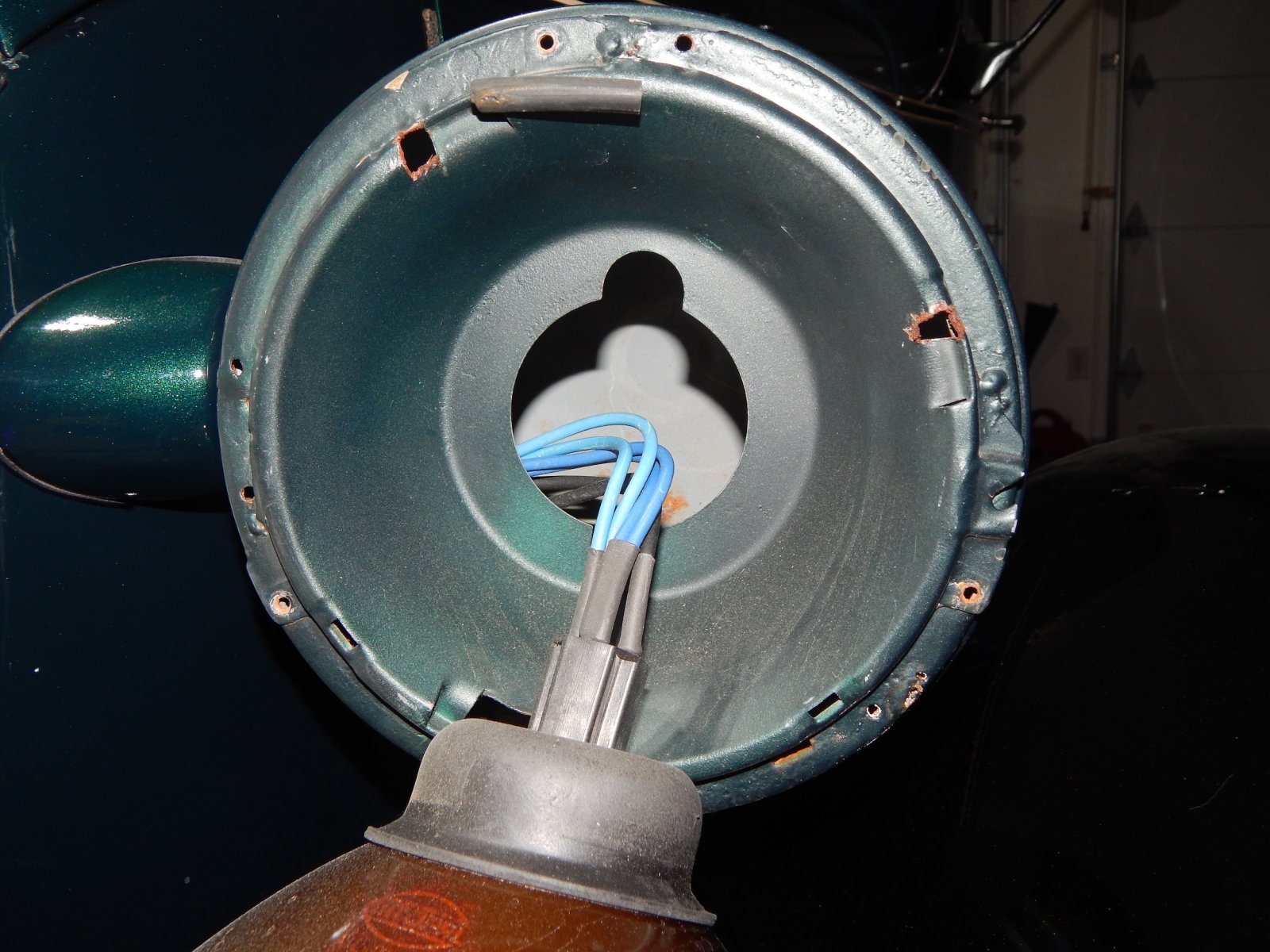

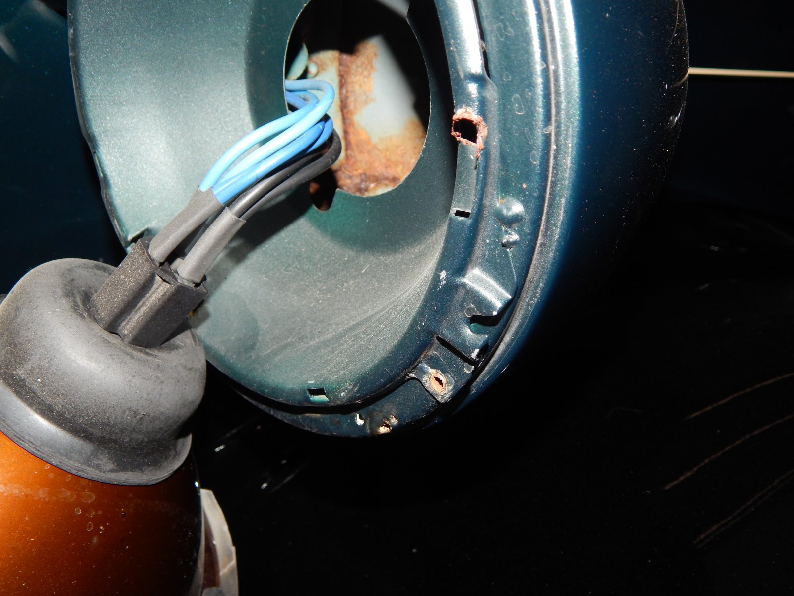

    My '37 truck lights, I went to the salvage yard and found some 7" light buckets from a pickup that used sealed beams. I trimmed the pieces to fit the '37 shell and welded them in. The trim rings are from a Harley Davidson motor cycle. The lights are Halogen, 7" replacements. I can pull the trim off for a better picture if you need to see inside. truck pictures 026.jpg 37 pictures 077.jpg

    @ Joe H. mine is a 37 sedan. Could you please pull the trim rings off and show me the inside? Also, do you have the part number from Harley Davidson? Thank you in advance for your help!

    I will get you some pictures later this morning, trim rings were for a '48 HD or some where around that age.

    Here is how I did it using salvage yard buckets and trim rings. The lights are thinner at the mounting flange then standard headlamps, thats why there are rubber pieces around them. Gl*** bulbs fit right. DSCN0451.jpg DSCN0452.jpg DSCN0453.jpg DSCN0457.jpg DSCN0458.jpg

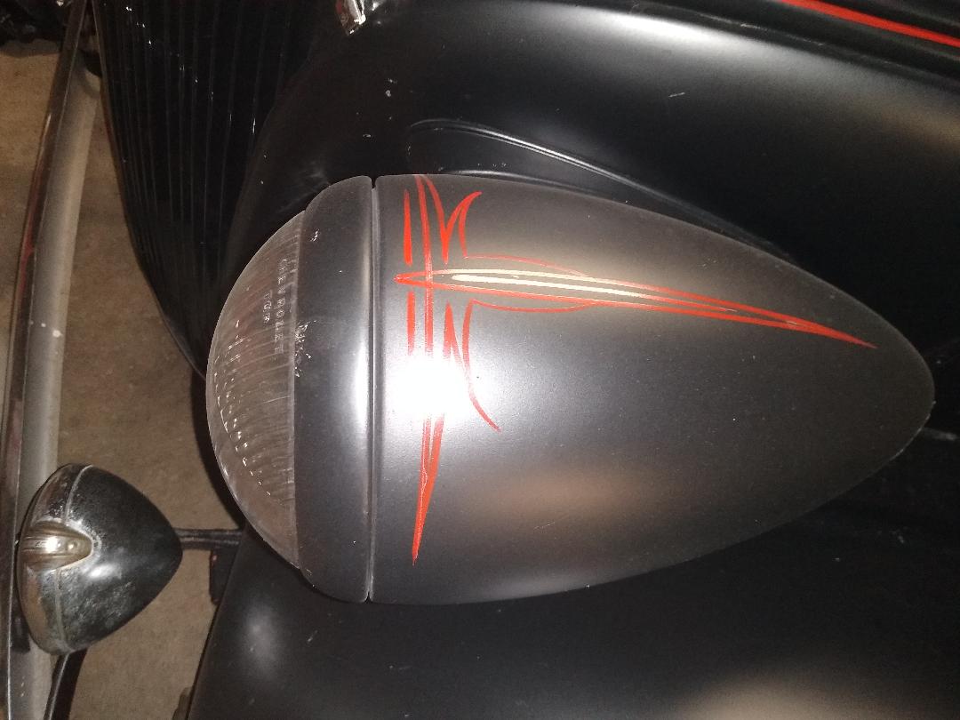

    If you are preserving the original look, which I prefer, it's worth the effort to put original lenses over the adjustable bucket/sealed beam. '38 headlight.jpg
