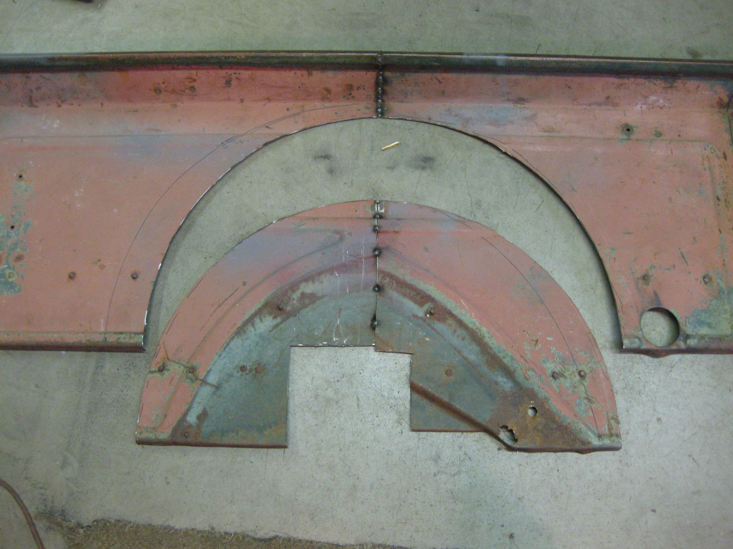

  3. LeadSledMerc
    Joined: Nov 29, 2003
    Posts: 4,106
    LeadSledMerc

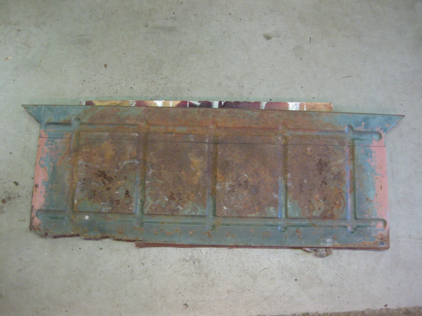

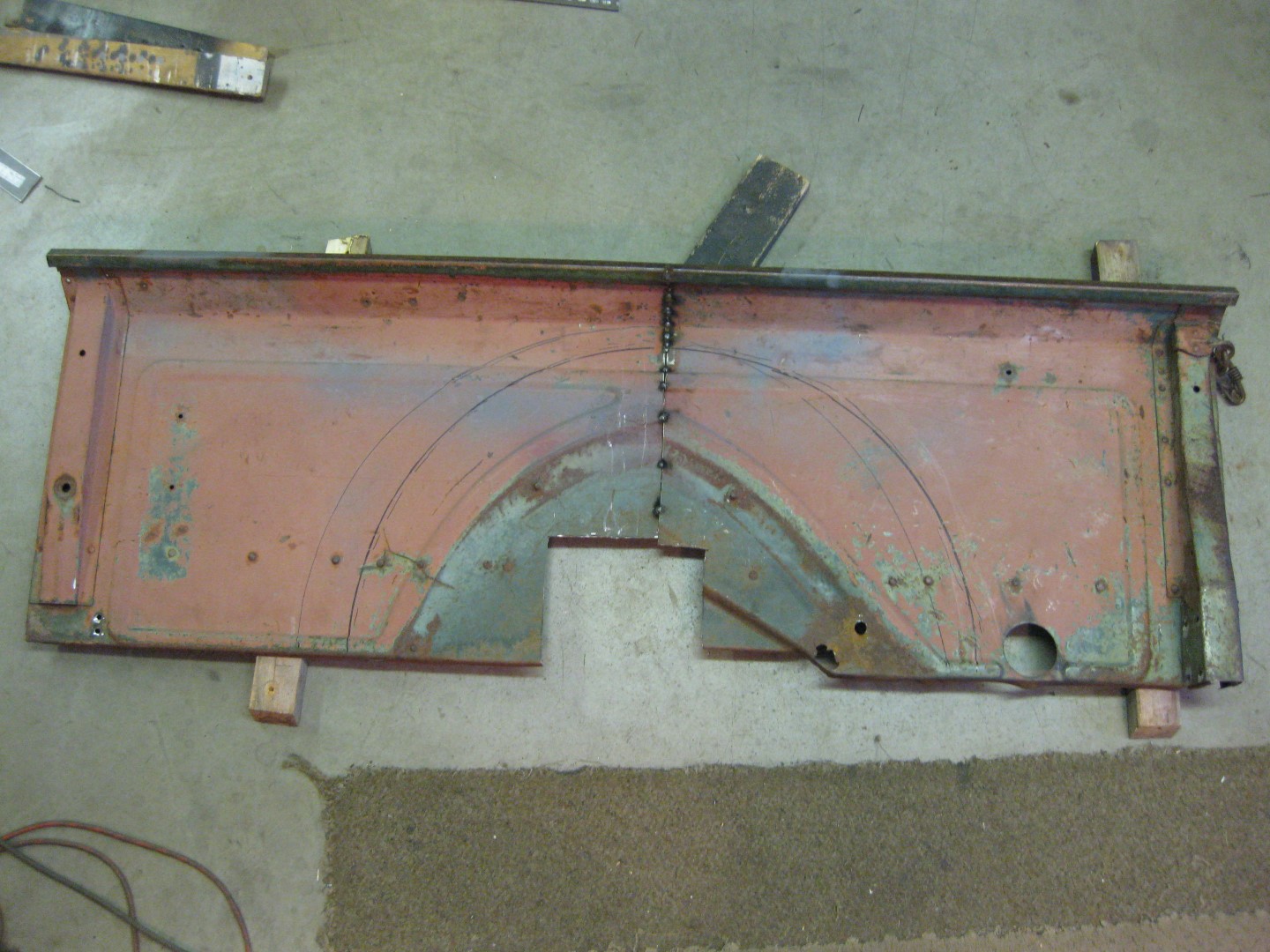

    On to the bed sides...

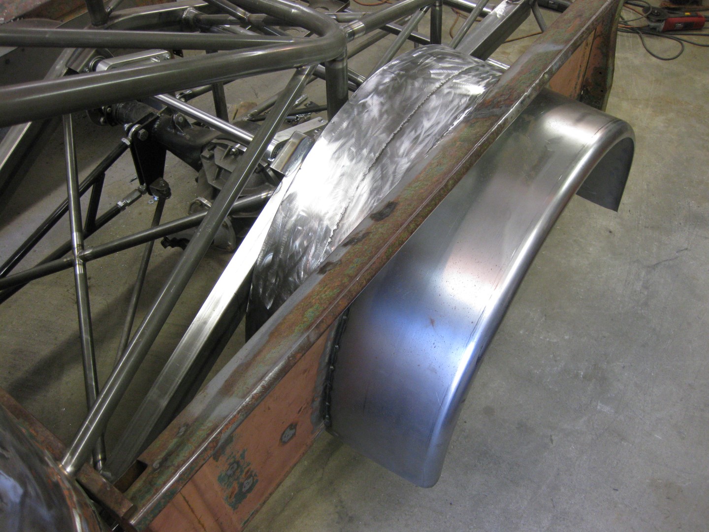

  4. LeadSledMerc
    Posts: 4,106
    LeadSledMerc

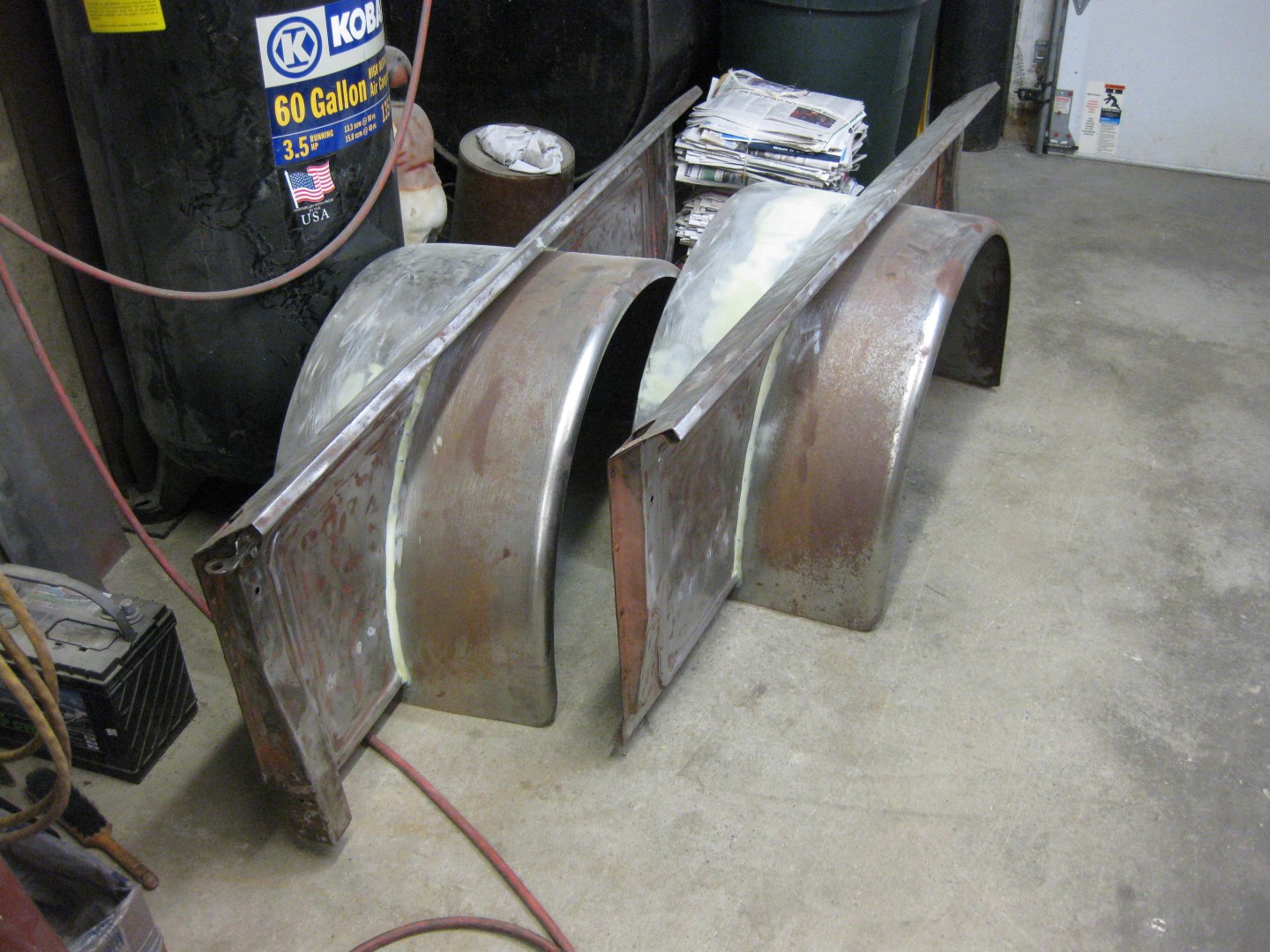

    Fenders...

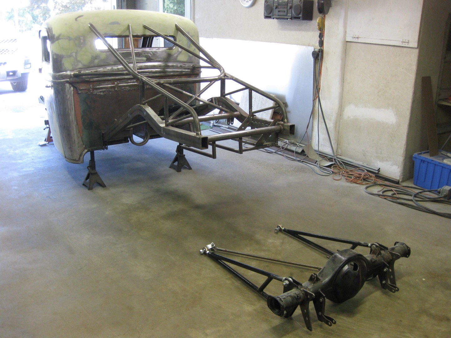

    Bed front, tailgate, and all mounts to the frame...
  6. LeadSledMerc
    Posts: 4,106
    LeadSledMerc

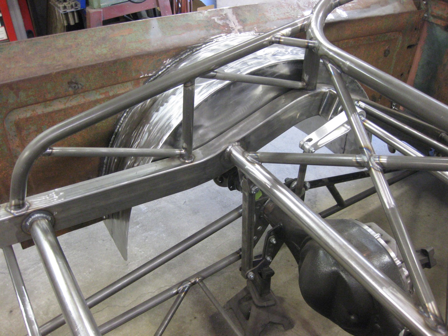

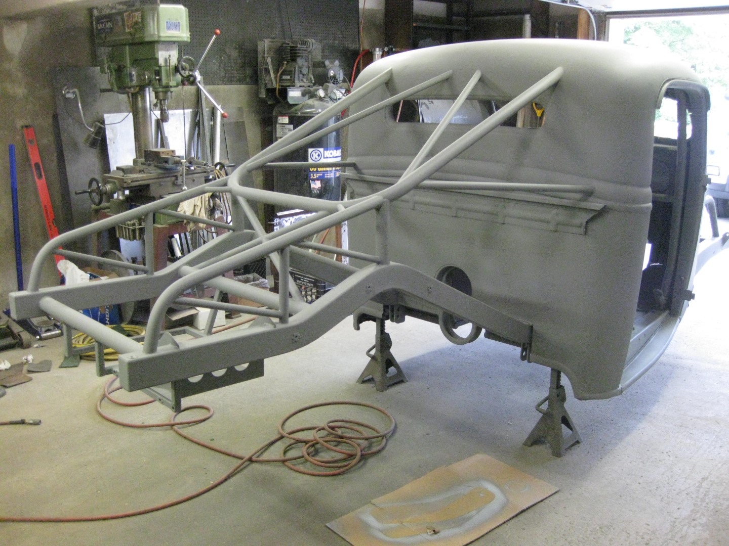

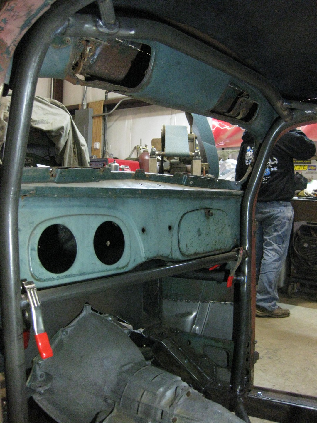

    Then it was off to my buddy's fabrication shop for the cage. Thanks for the haul, Ted!

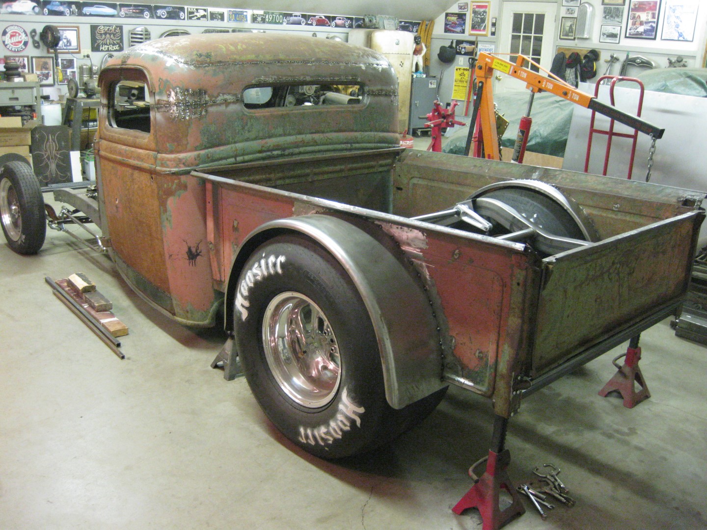

  8. LeadSledMerc
    Posts: 4,106
    LeadSledMerc

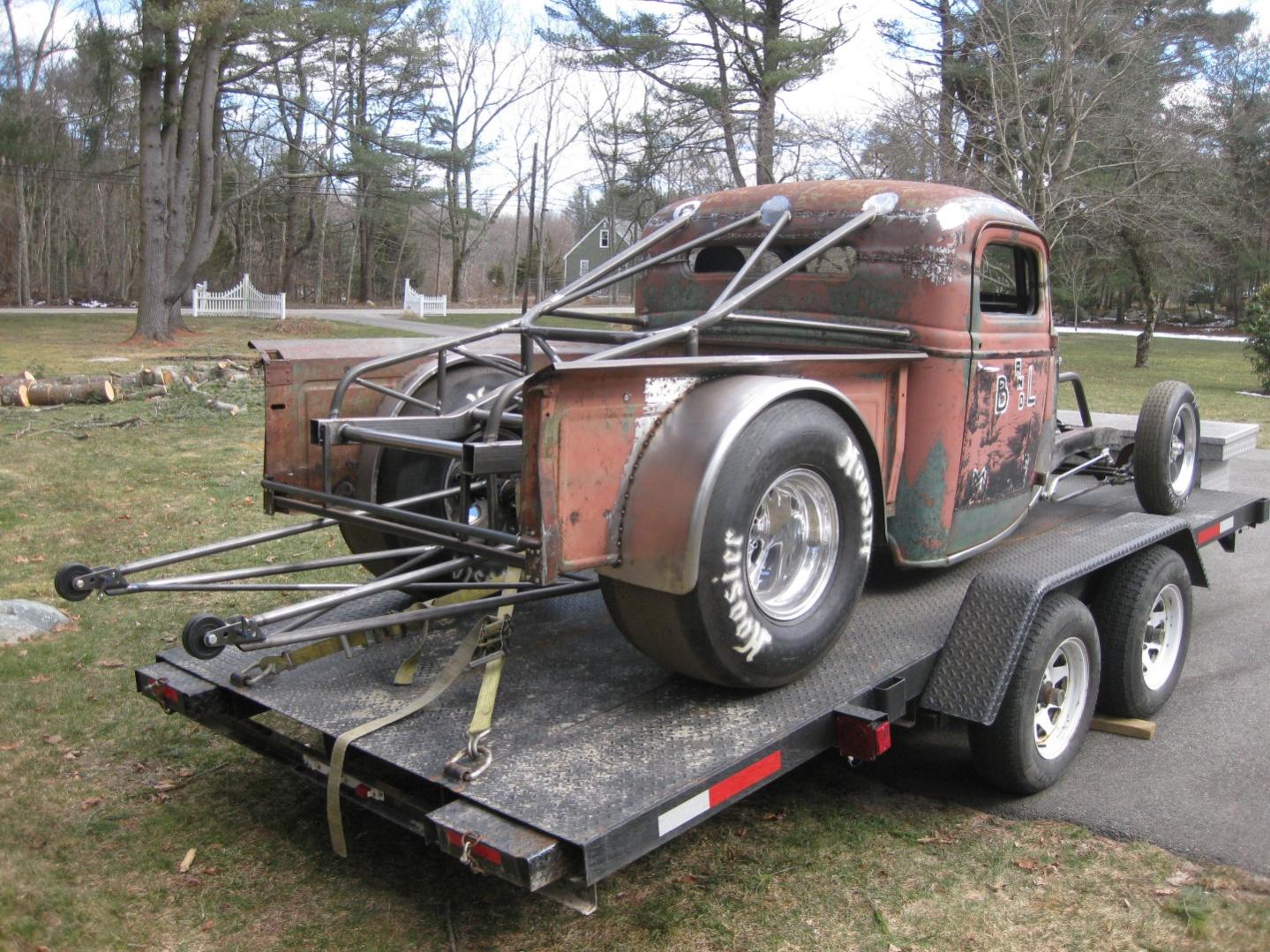

    Gerry Jr. at East Coast Fabrication in Rochester, MA did the cage for me.
    Not necessarily HAMB friendly, but he did an awesome job, and perfect for what I'm looking to do with this P/U!
    Wish I had taken more pics of the sheet metal, but you'll see it later. :D
  9. LeadSledMerc
    Posts: 4,106
    LeadSledMerc
    Then it was off to New England Dragway in Epping, NH to get the cage NHRA certified. They told me it was way overkill for the 8.50 cert I was looking for...that's good, right? :D

    Very nice. I'm a firm believer that old trucks make the best looking drag vehicles.

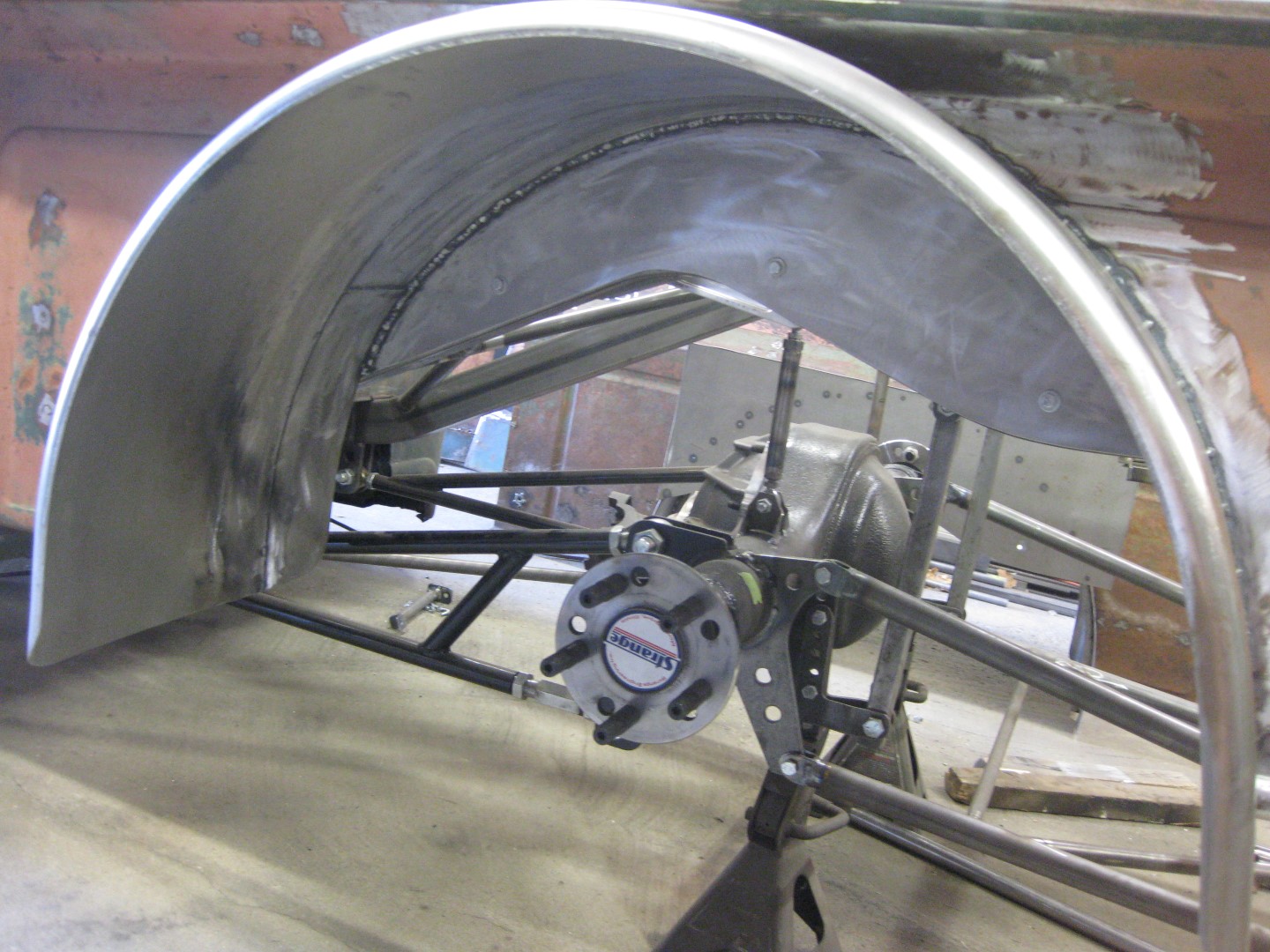

  13. strike a poser
    Joined: May 23, 2007
    Posts: 399
    strike a poser
    from Salinas,CA

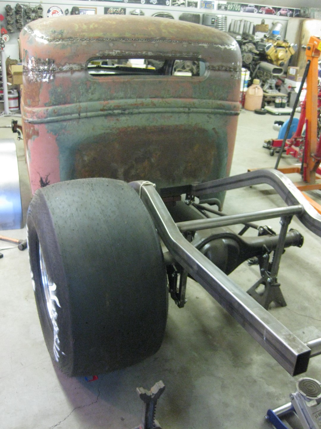

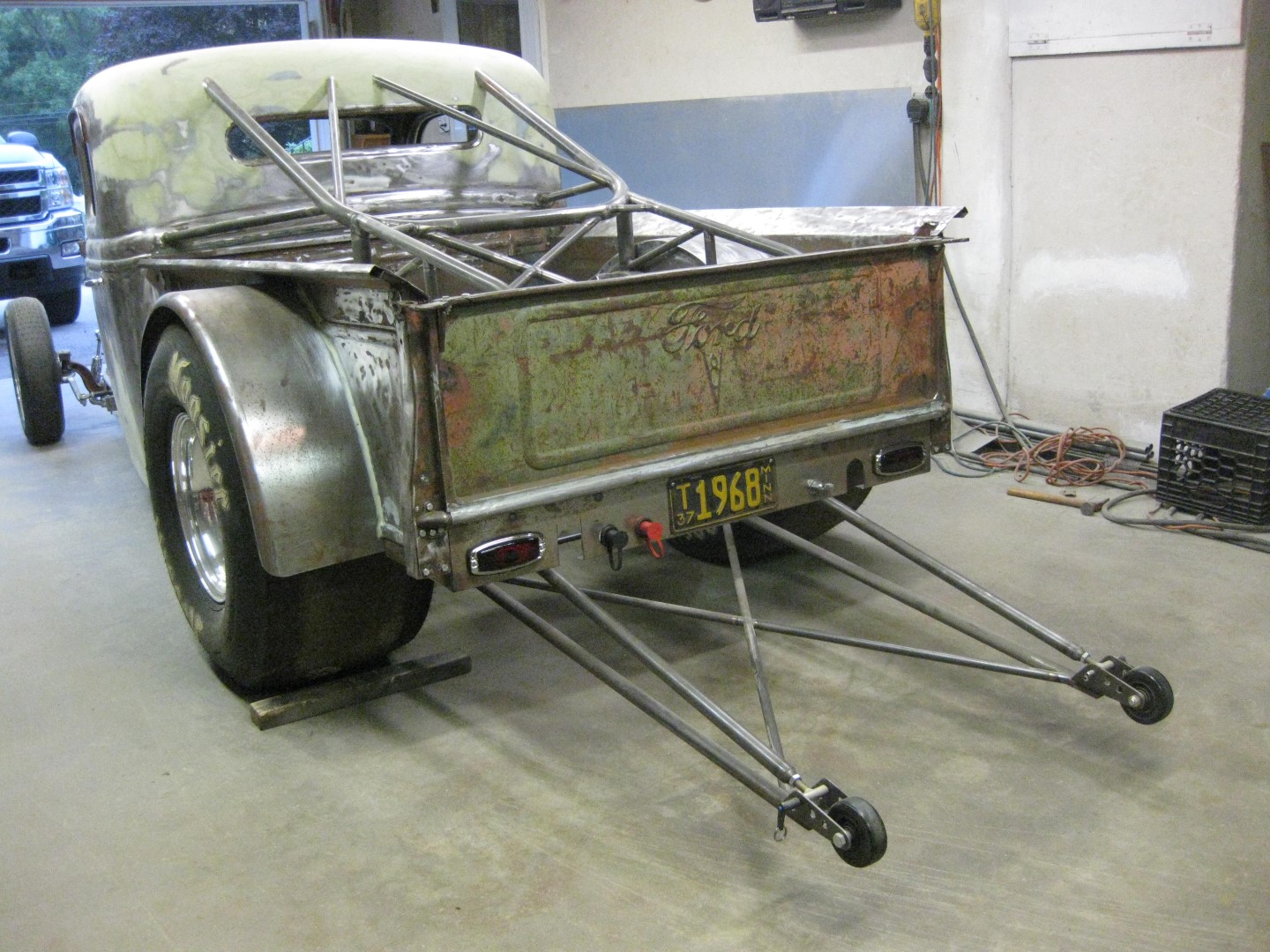

    Aren't you worried about the slicks growing in dia. and rubbing the inside of the fenders? From here they look awful close.
  14. LeadSledMerc
    Posts: 4,106
    LeadSledMerc
    I've got to agree!! :D
    Not worried...I've planned 1-1/2" growth without rubbing...and I've still got the final adjustments to make when I do the shake down. Should be good.

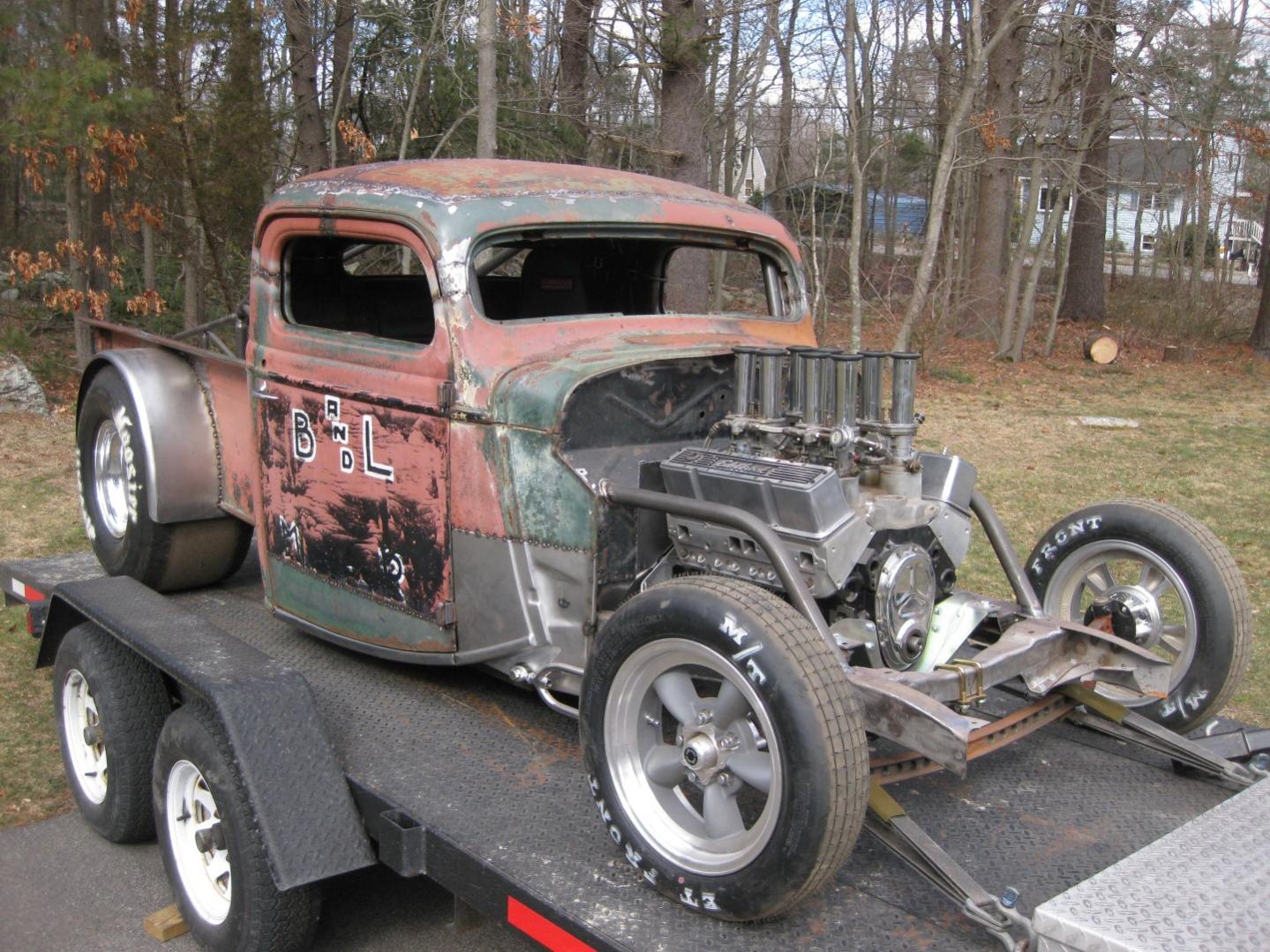

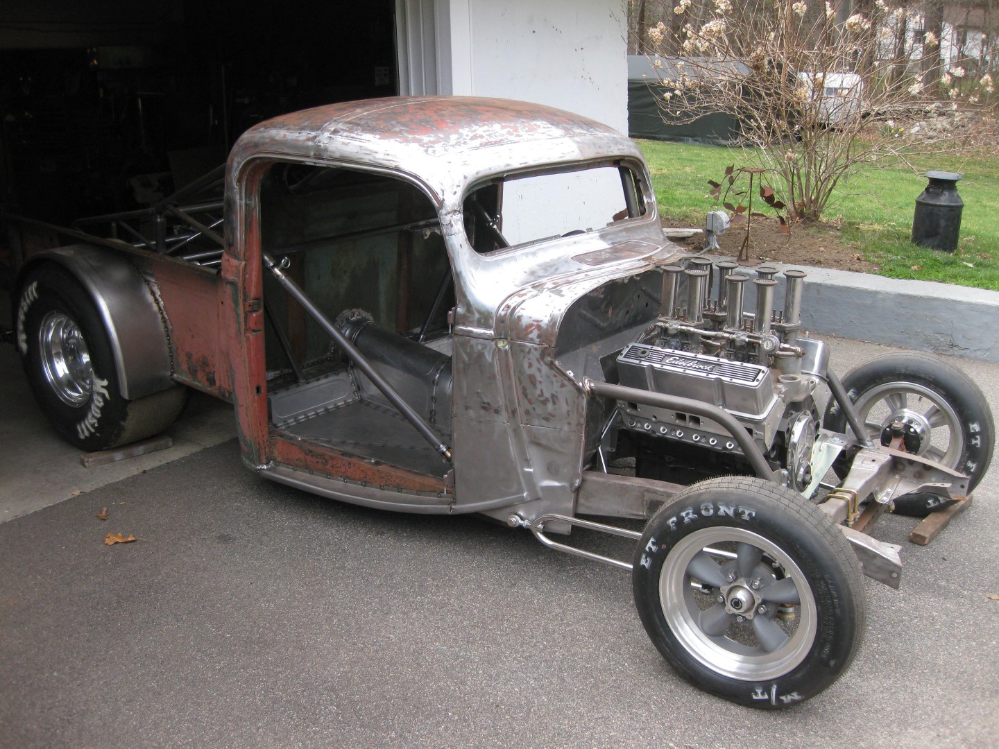

    Totally Wicked Keith .... how much H.P. are you plugging into those frame rails?
  16. LeadSledMerc
    Posts: 4,106
    LeadSledMerc
    Looking for 725-750 HP out of the 418 SBC going in...for now! :D
    It'll be going on the dyno soon.

    Started prepping for body work, and tubbed the fenders...

    Are you running a 4.30 gear in it?

    4.56 and a Powerglide.

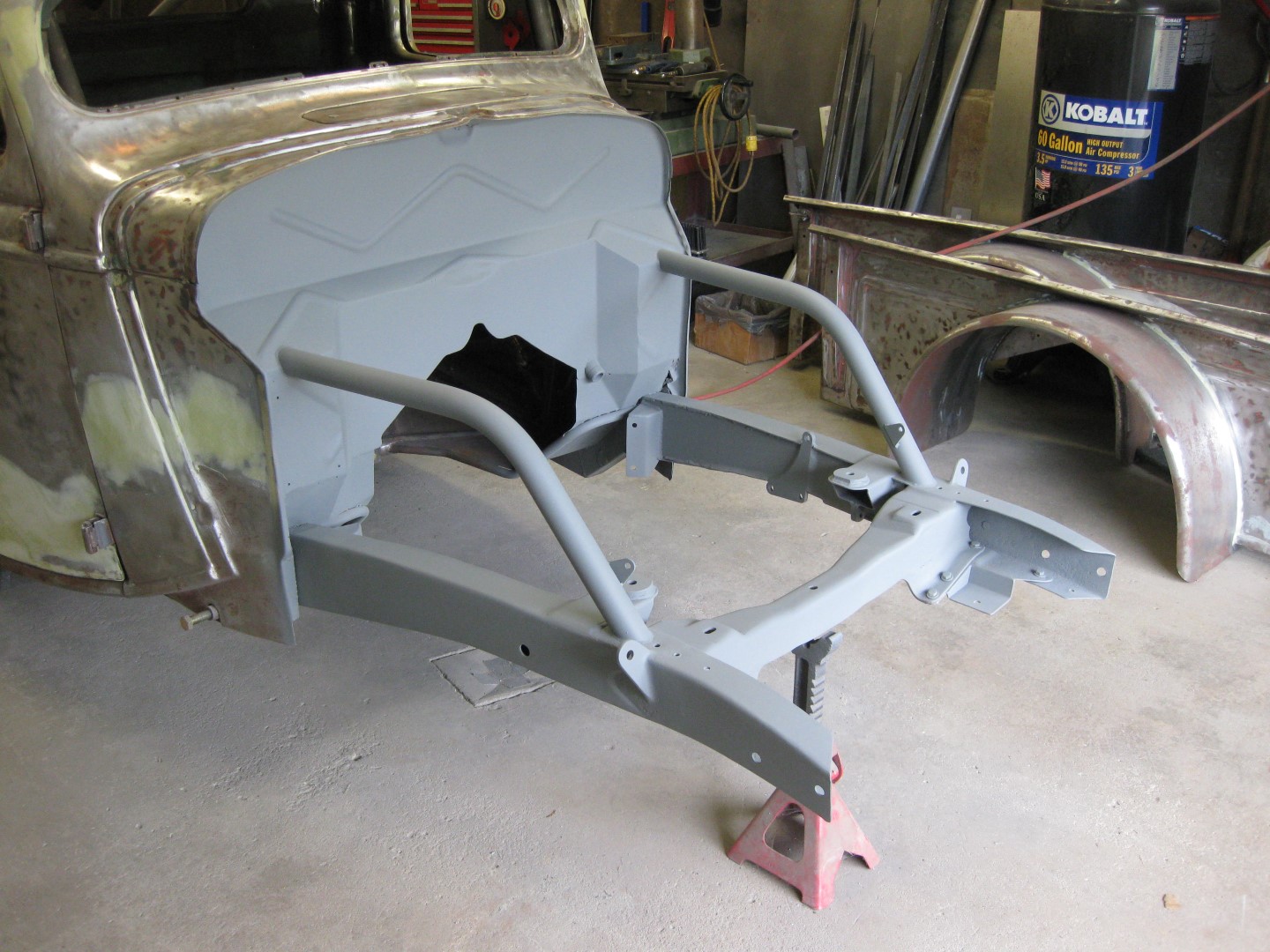

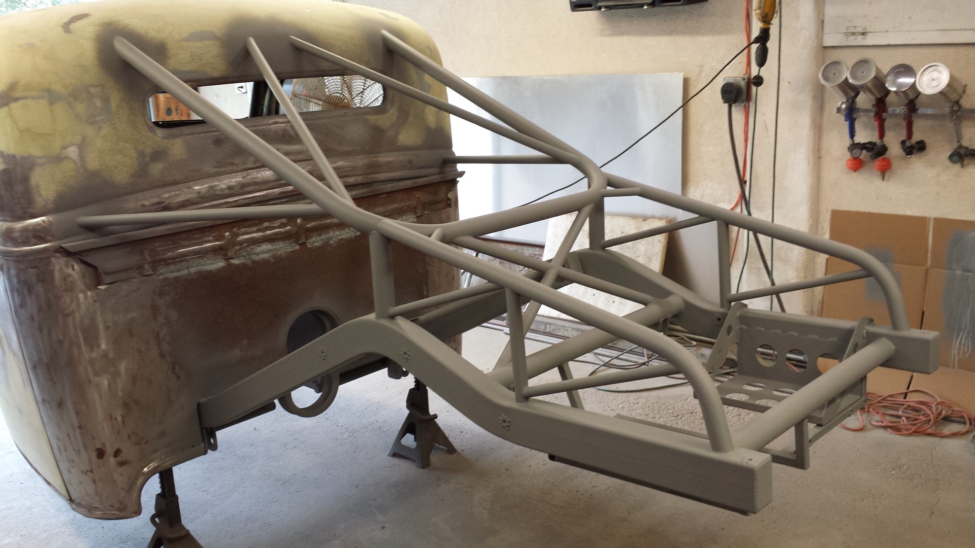

  22. That truck is going to be incredibly hard to paint with the body, frame and rollcage integrated. But I know it will come out fantastic. I will definitely be going to New England Dragway to see you run .

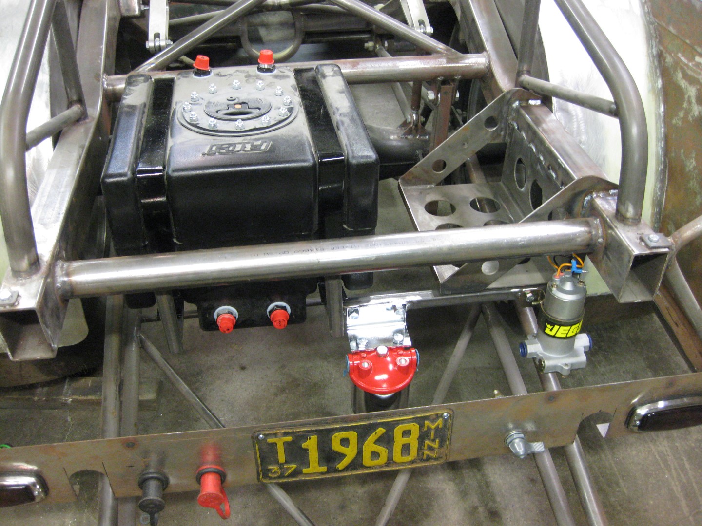

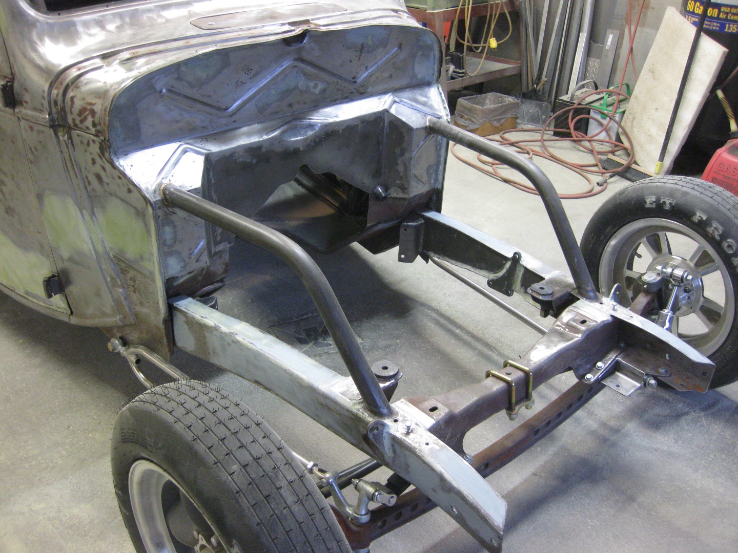

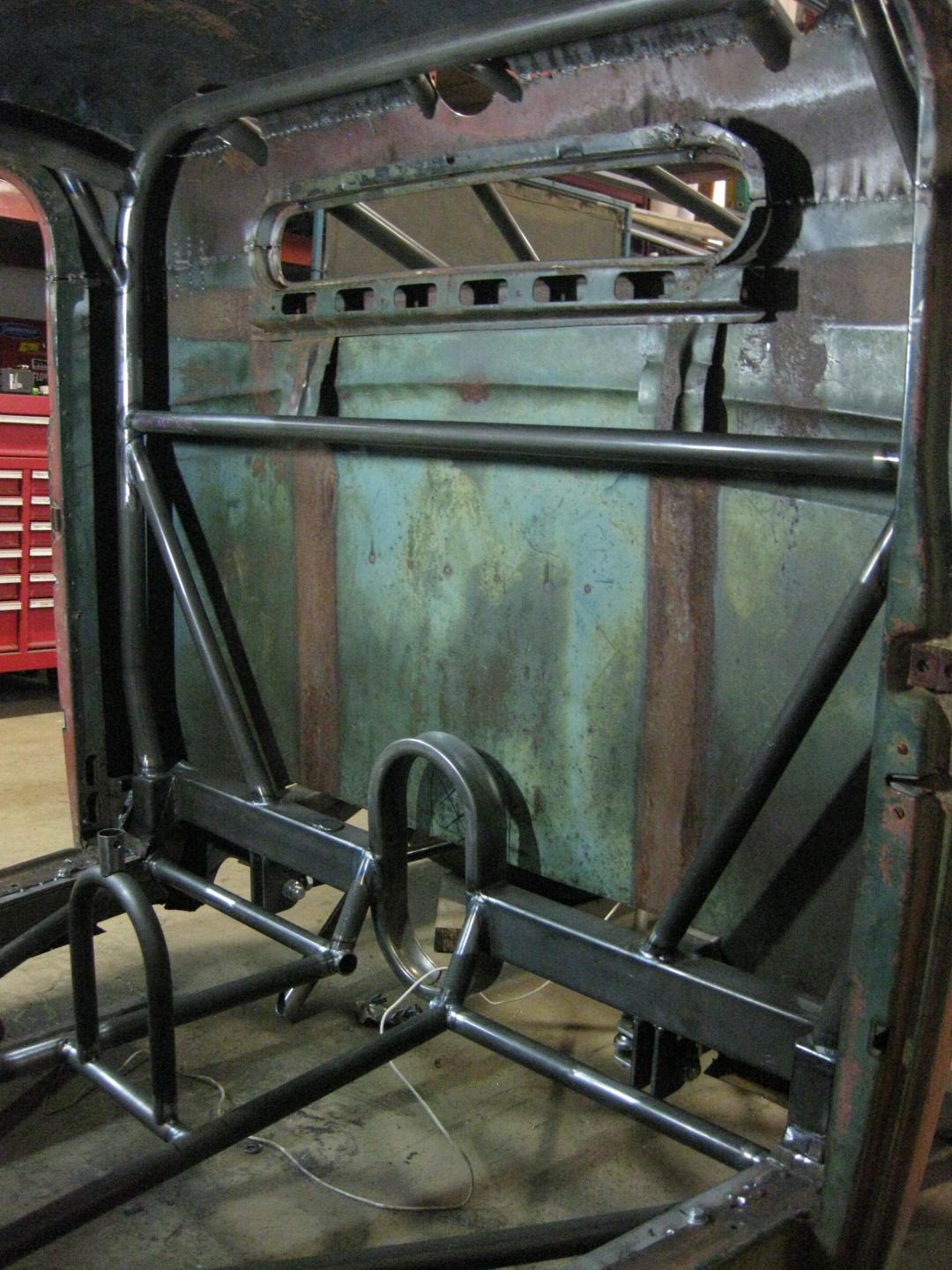

  23. Hey LEDSLEDMERC, do you have any pics of the fuel cell cradle without the tank in it? I'm looking for some ideas for mine. Thanks!

    That was the original plan, even had it registered and a plate...but it's gone too far for the street now.
    Painting is all done, Rob, it actually wasn't too bad. Like I had posted, I busted my arm up pretty good, and I had just finished the last of the painting the morning I busted it. The paints had 3 months to dry, and I started the final ***embly last week...pics to come.
    Yep, they'll be coming...dis-***embly and painting pics next.
    Thanks!

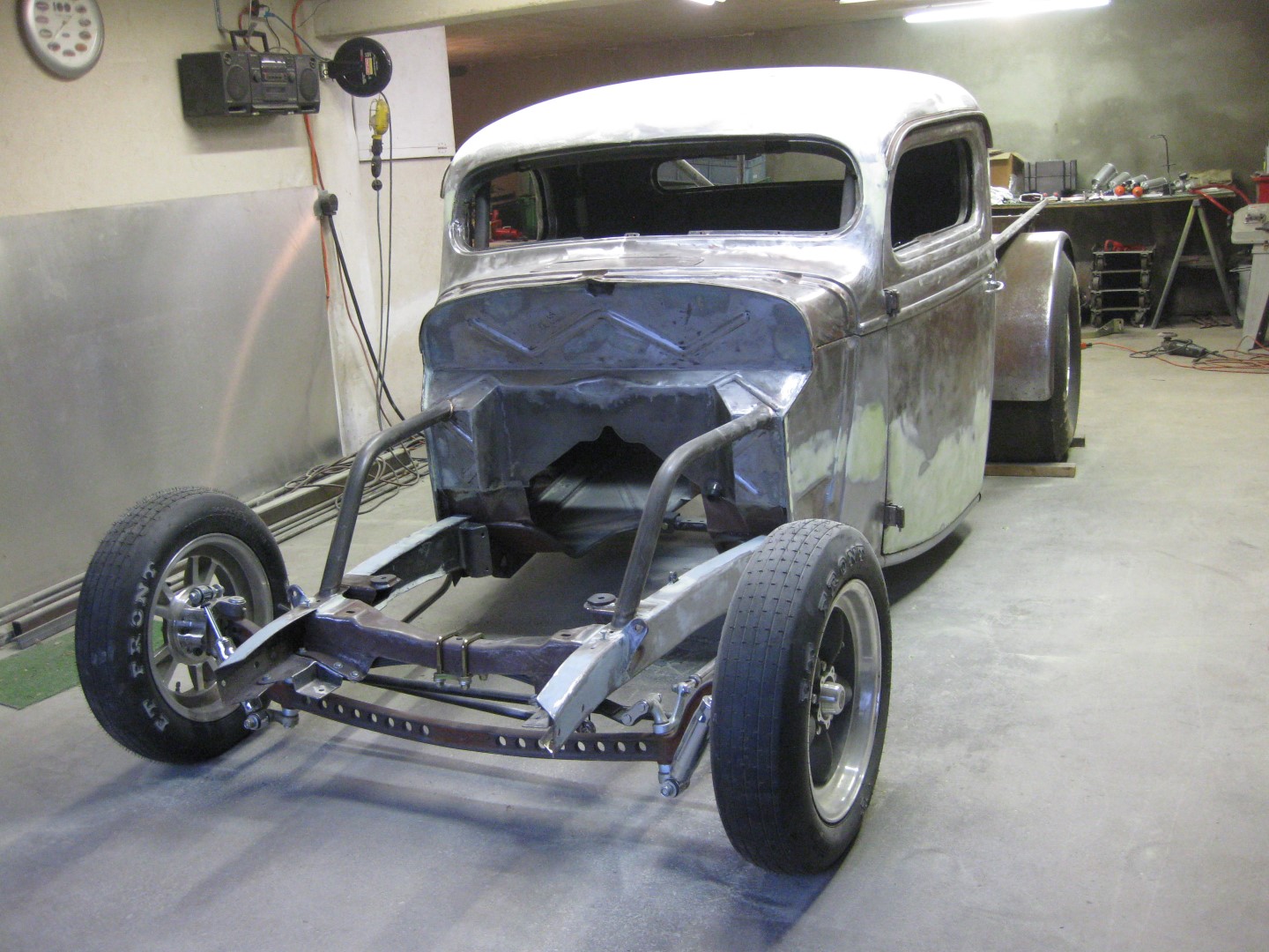

  26. LeadSledMerc
    Posts: 4,106
    LeadSledMerc
    See if these give you what you need, SPDJNKY...if not, I'll take a couple of other pics for you.

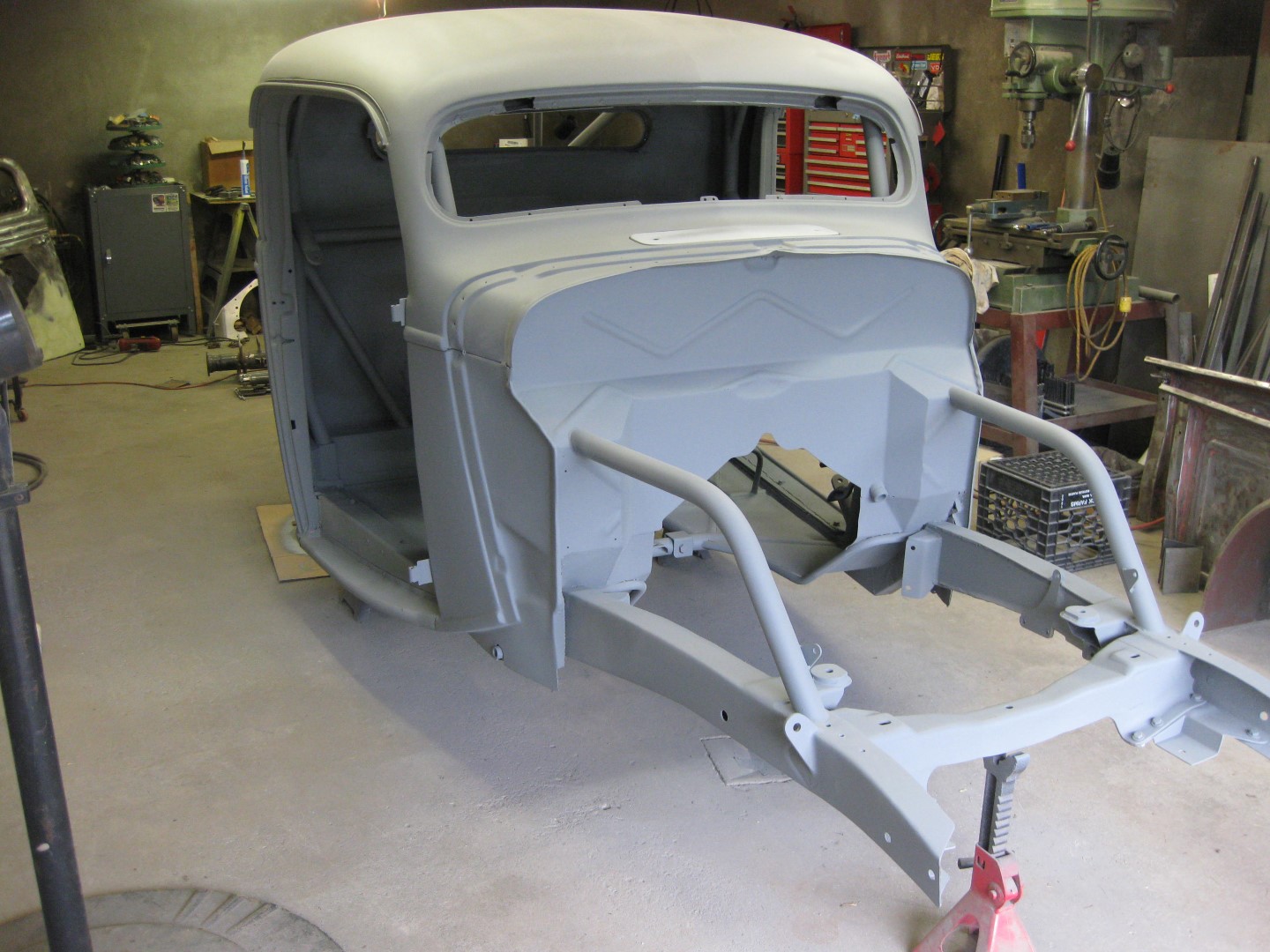

    Ready for paint prep...
  27. Right on man. Pretty much what I had in mind with the cradle.
    Thanks for your time!
    Brian

    The ba*****t garage I was working in was soo damp, everything bare would rust up fast. I'd only prep what I could get painted real fast.
    Priming begins...
