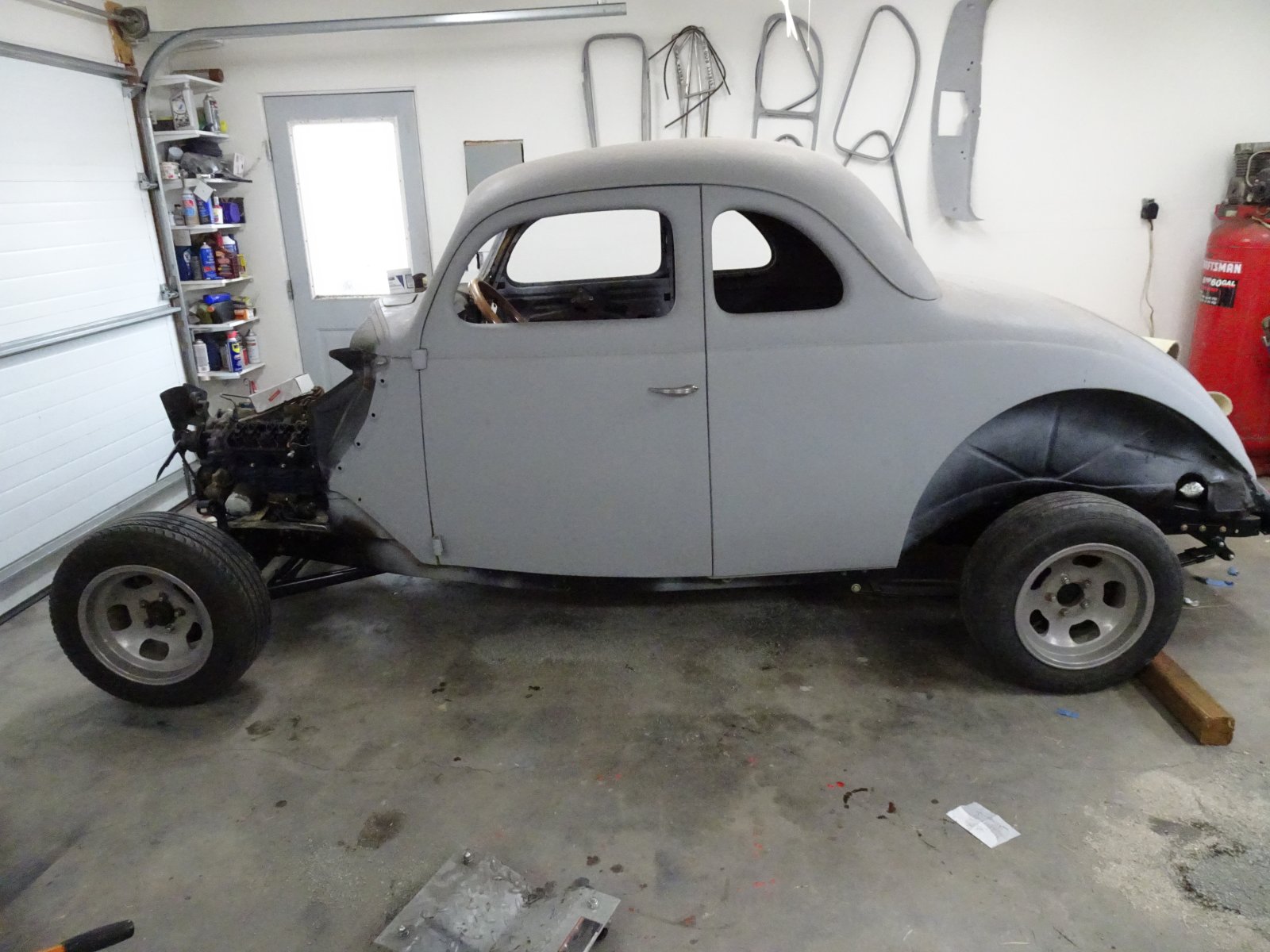

    I just measured my 40, At the rear I measured from the bottom of the frame to the floor right at the part where the bumper bracket goes. 17 inches. I also measured from the front bottom of the frame rail same deal right where the bumper bracket bolts on and 10 1/2 inches. My car sits on a nose down rake october2.JPG
  5. That's the thing. There is no actual measurement. What looks right IS RIGHT!
    But, by looking at the door, it looks like it is nose down a bit. A good start until you can mock the rest up
    cretin and studebakerhawk like this.

    To try and help the OP, try this: the levelest place on a whole lot of curved sheetmetal and frame would be the door window sill. Put a spirit level on that.
    Now, along with what others have said and knowing what actual stance you want (i.e.rake or tail drag etc.) will affect things, as will the weight of everything bolted on. Even a radiator full of water hanging out the front is quite weighty. It all makes a difference.

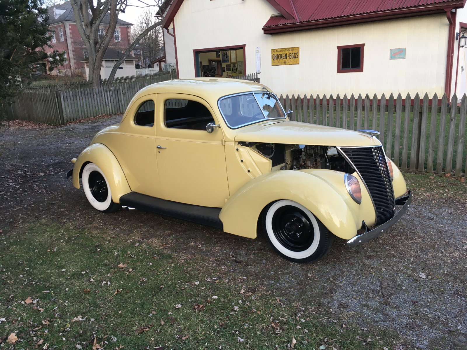

    If interested we can compare my 37 stance to yours.
    If this is what your after? I can measure whatever you’d like to go by and we’ll make a comparison. That way you may not need to add your parts. you’ll still have to contend with weight distribution when adding the engine etc.
