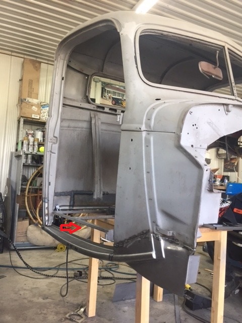

  28. Zippi
    Joined: Nov 27, 2016
    Posts: 156
    Zippi
    Looks great. I going to have to replace my rockers when I get the money for the paint job. Is there a replacement part I can buy that goes in the area with the red arrow is in the pic 1937 Rocker Panels 2.jpg ? Thanks.

  29. '37-4D
    Joined: Dec 12, 2016
    Posts: 221
    '37-4D
    Zippi, I'm no expert, but that will most probably be cheaper for you to fab rather than buy. These parts aren't cheap.
    If it's for a channeled cab than no for sure.
    This is who makes them:
    http://www.fordor.com/
    My whole floor will be fab'ed
  30. Zippi
    Posts: 156
    Zippi
    It's a stock cab. Really wish I had the tools and ability to do the work myself but I don't. Your 37 is coming along nice. Thanks for the link but couldn't seem to find what the part might be that I need.
