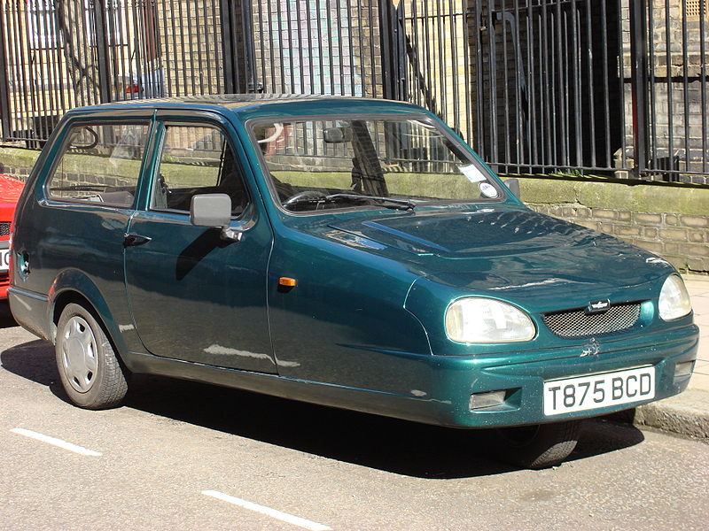

    A reverse Reliant Robin from the UK, it had a single front wheel and was EASY to flip over if you went into a corner too quickly. 800px-Reliant_Robin_Green.jpg

    LOL, yeah, there's some fun circle track videos of these racing on youtube.
    If they roll over, just roll them back & keep racing. ;D
