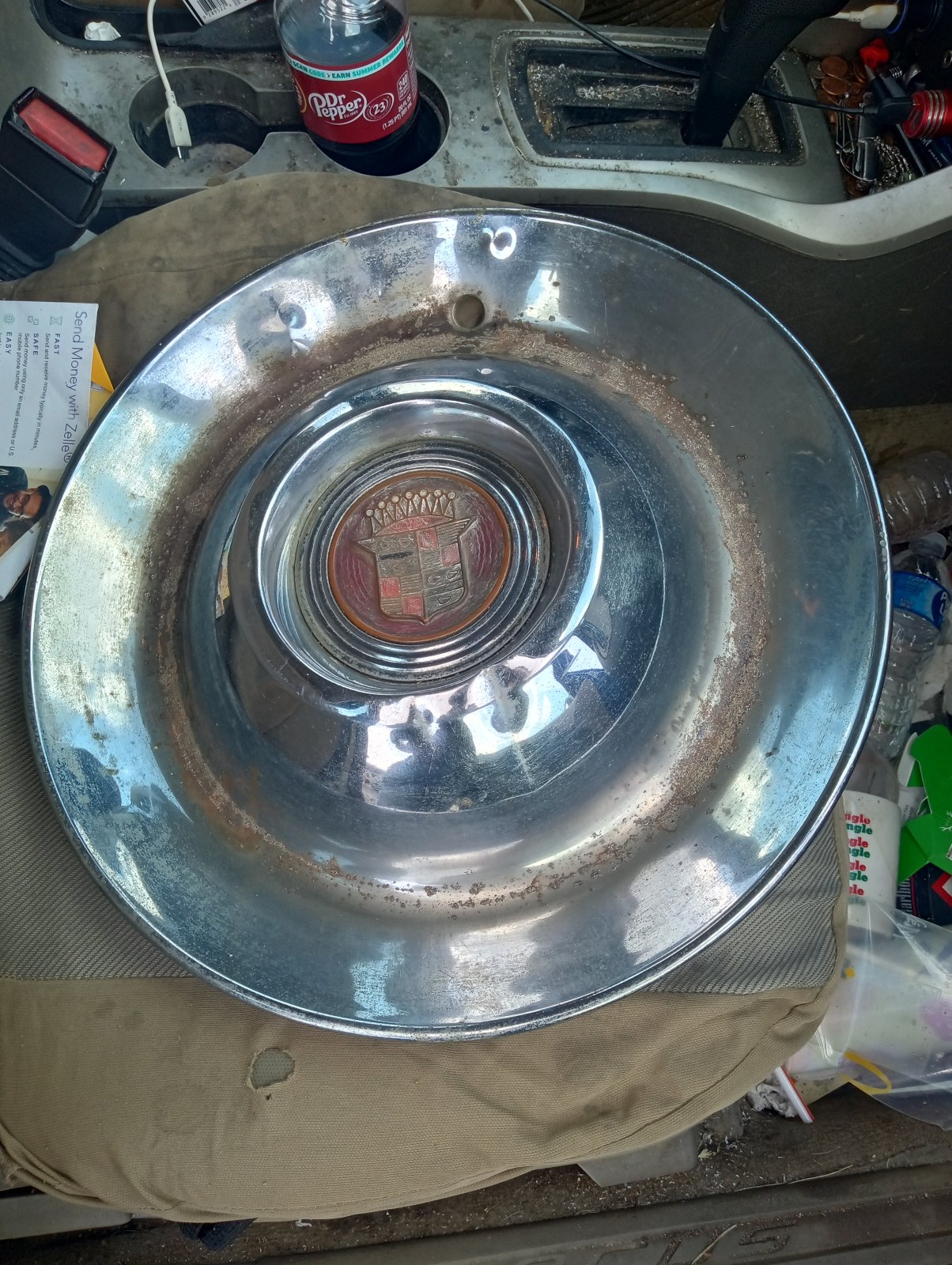

  6. I actually just bought one of those same caddy caps lol

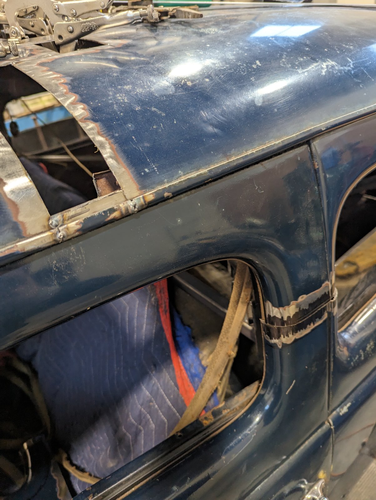

    Old rear window size for reference and the frame tacked to the lower belt line after dollying it down to match the new angle. The rear window was cut around 2" each direction.The rear side window opening is shrinking and the c piller is growing, one because the fact the front and back window is the exact same size is ugly and it makes life easier. Win win. Now the drip rails that's a different story all together... PXL_20240627_212724267.MP.jpg PXL_20240607_033042232.MP.jpg

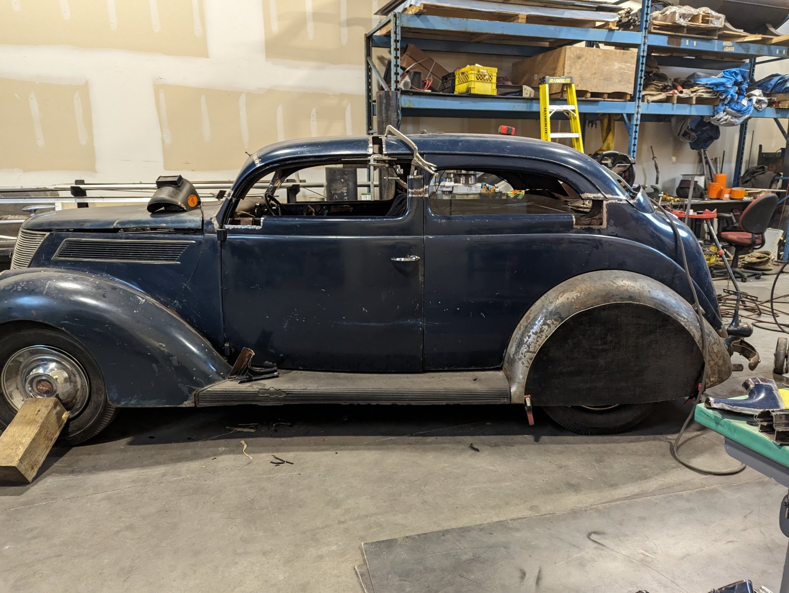

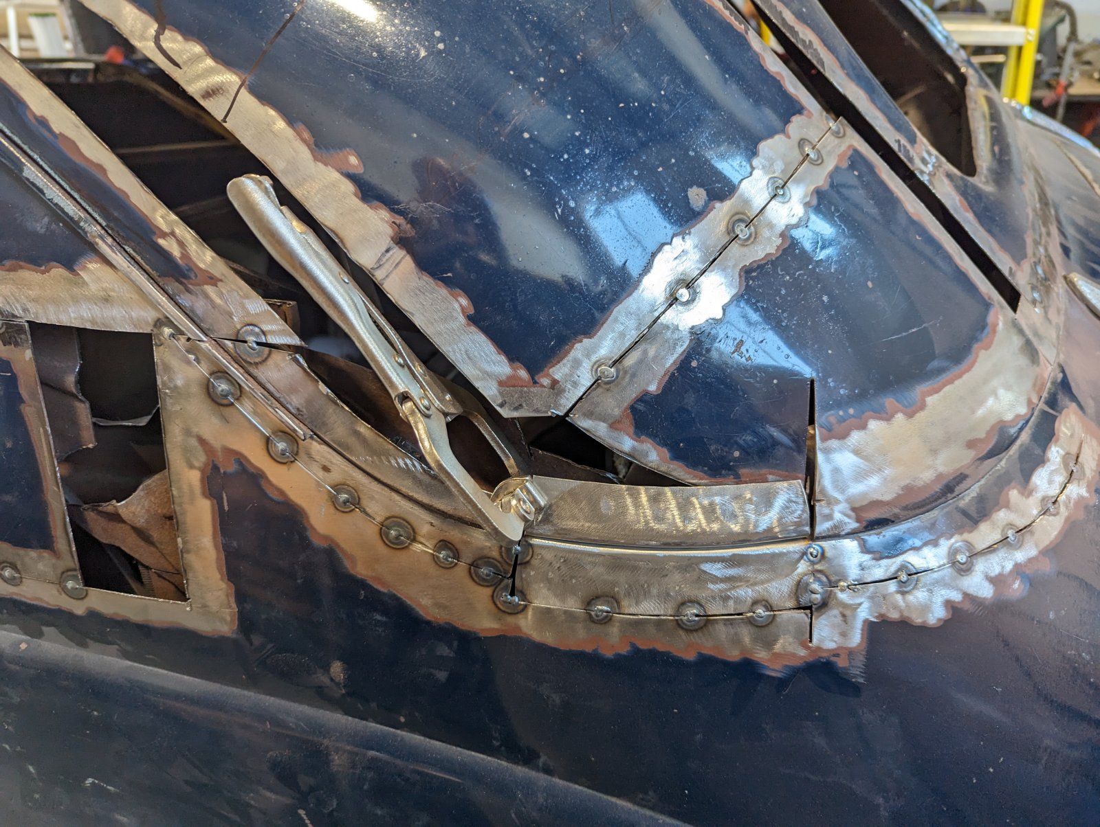

    Next up I cut down the sides of the back section of the roof then slid it back until the angle of the back window lined up much better. This also helped getting rid of the forward rake hump in the back of the roof line. After the roof shenanigans I will be attacking the chassis to get the rear down a bit more I also have a 59a block at the machine shop that we will be putting together as well as a 39 trans
    Thanks for following along ! PXL_20240702_023143170.MP.jpg b8f823e4-64d4-49bc-8871-1506863815e0.jpg 347447d9-4ac9-4472-8485-de2a0dd77f35.jpg

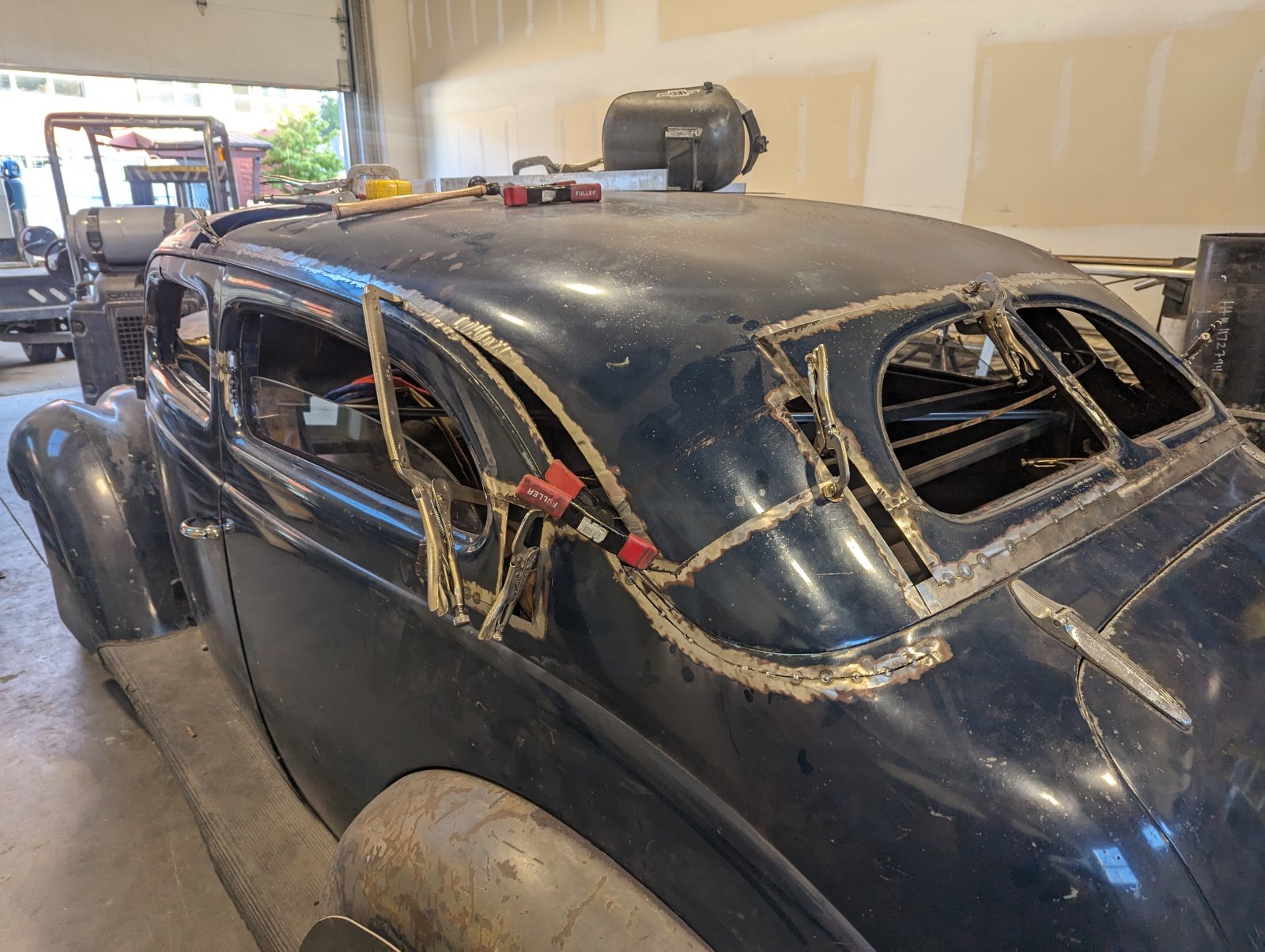

    PXL_20240715_205941561.MP.jpg PXL_20240715_205953944.MP.jpg A bit more slow progress wedge to add back to keep the roof the proper shape if I did it again I would maybe have done it differently but what the heck I'm here now it should all work out. Next is the drip rail transition.. Everyone says I hope your keeping the drip rails or rips on people about them but man I can totally see why the old timers just cut them off and leaded the seem... Lol

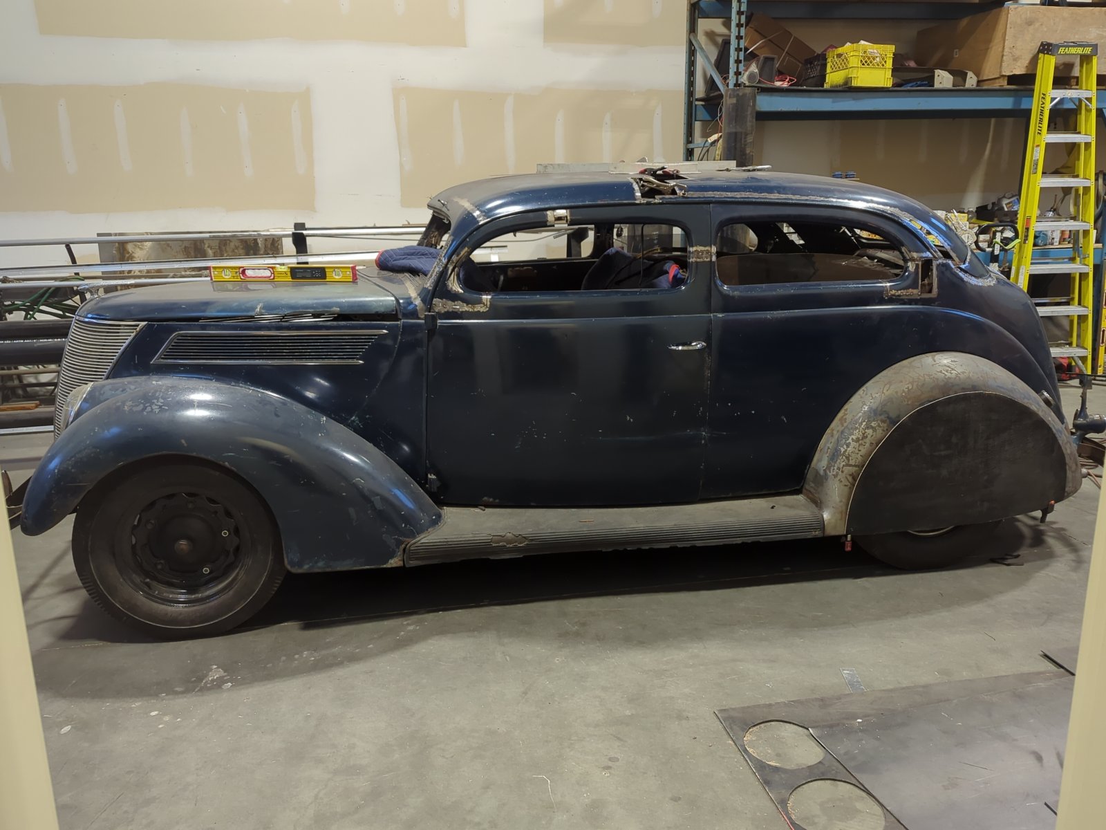

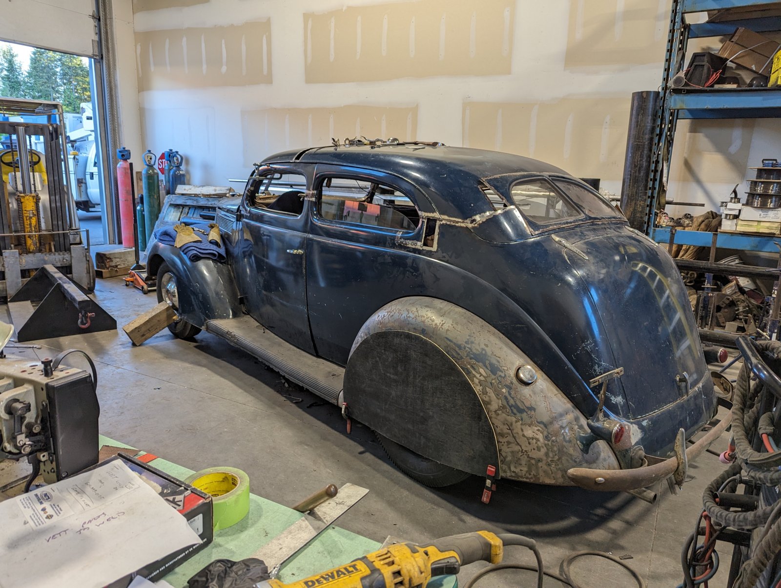

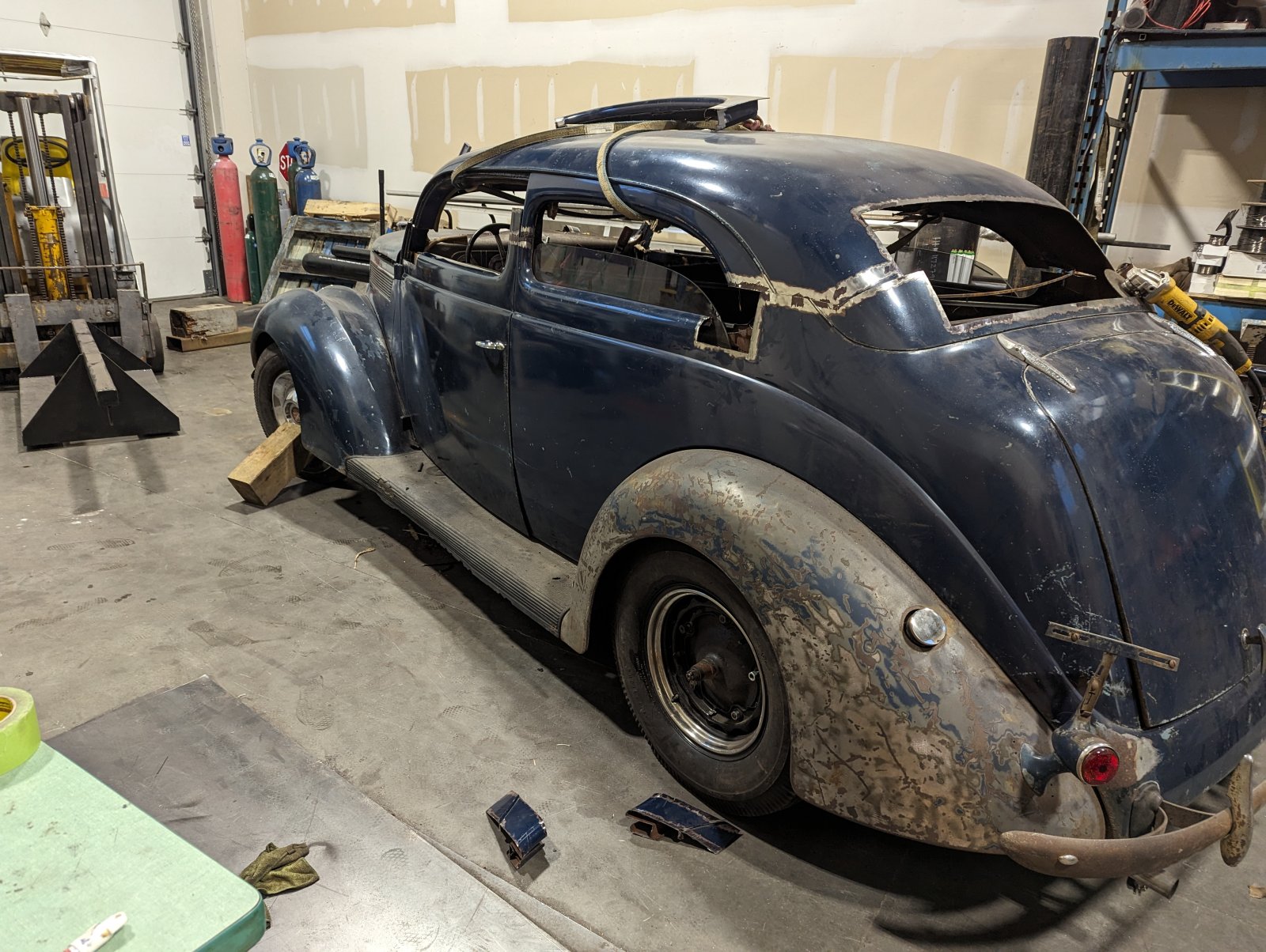

    PXL_20240808_223605249.MP.jpg PXL_20240808_223659726.MP.jpg PXL_20240808_223716456.MP.jpg Today I fit the wedge pieces back to where the new sail panels will start and fit the second side of the drip rail transitions. I also got all the broken screws out of the swap meet windshield frame and laid it on for visual purposes, I think the car will have a much better visual flow once the rear is lowered I bit more (to hide the wedge of the body)
    Thanks for following along.
