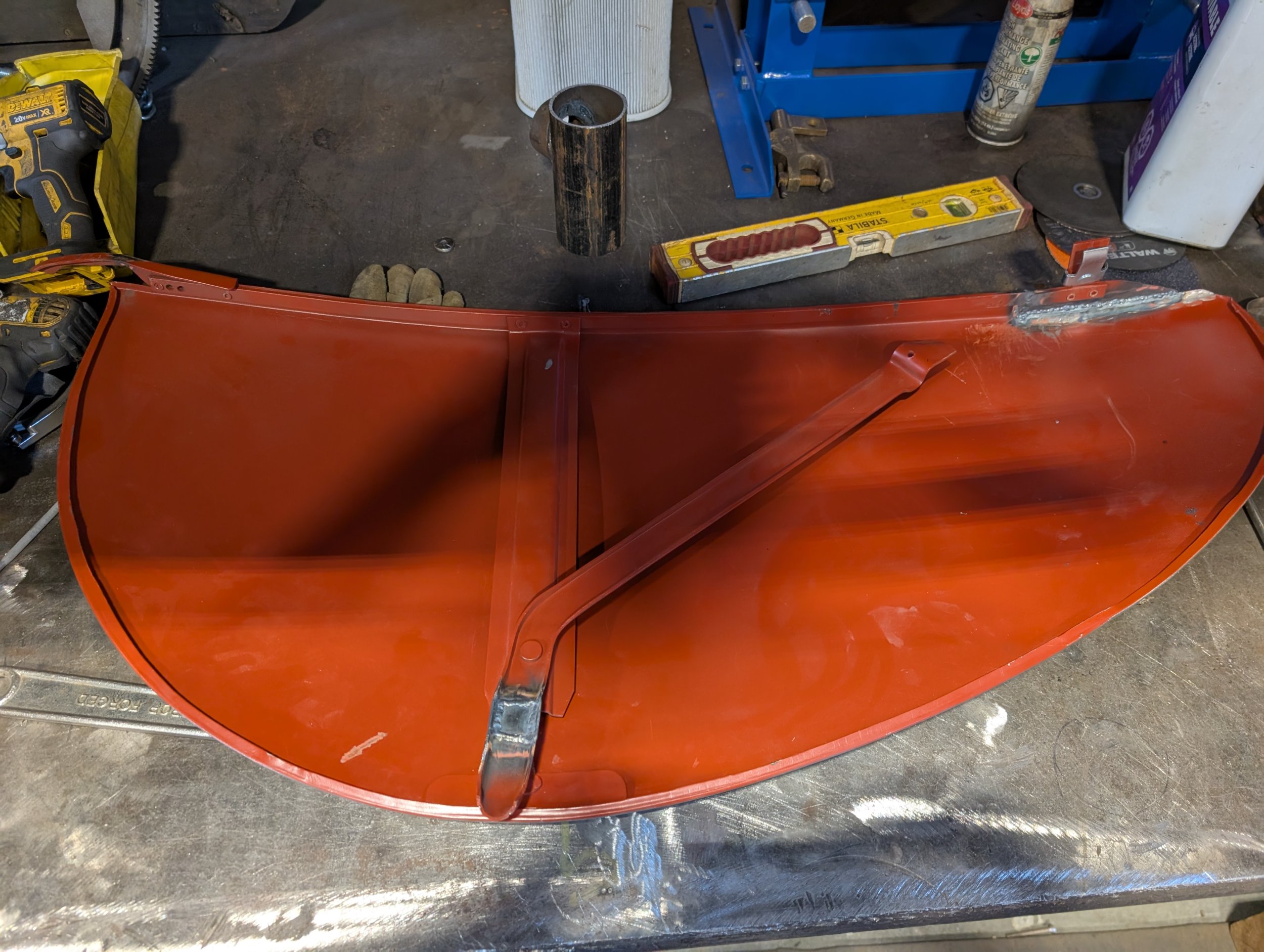

    Today I filled the last holes behind the window and sorted out one of the skirts. They are definitely not for a 1937 sedan the latch was the wrong angle and needed to be extended. It also needed more contour on the rear so I cut the flange off gave it a few shrinks re shaped the flange and welded it back in. PXL_20241027_225200036.MP.jpg

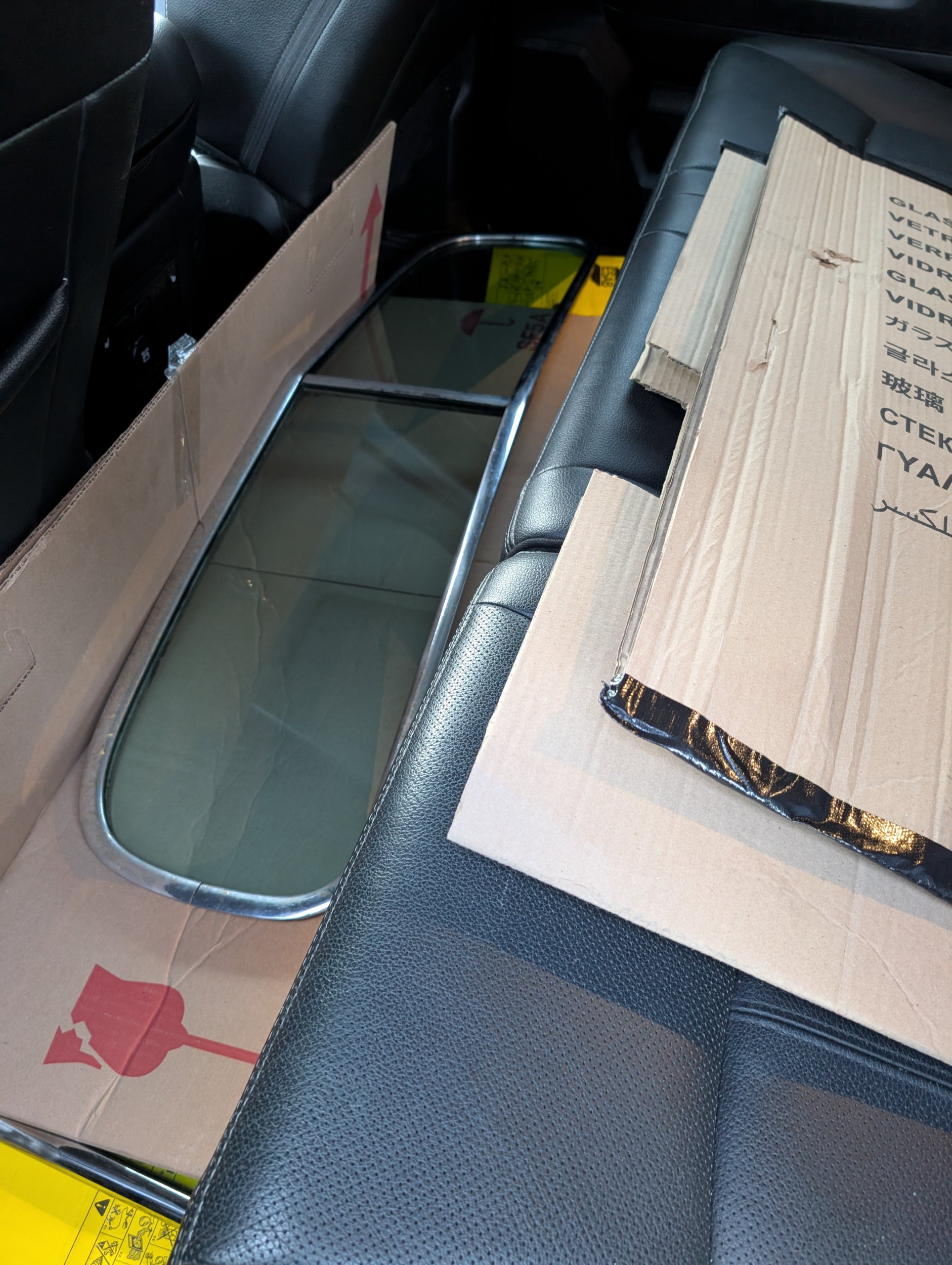

    New windows in case things go squirrely. (Jokes just templates) Side windows will have to wait tell winter. PXL_20250628_210942158.MP.jpg PXL_20250628_215245464.MP.jpg

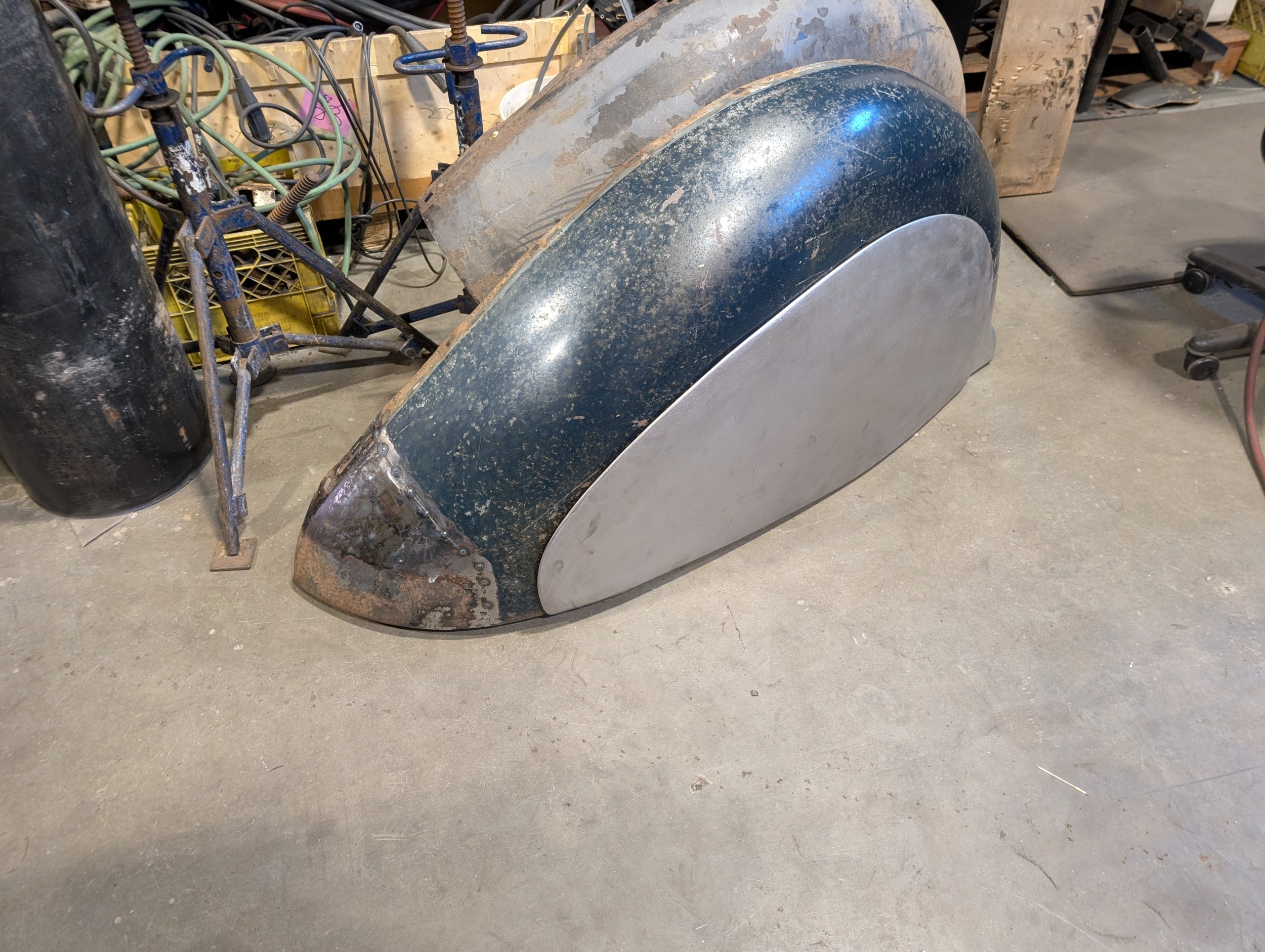

    PXL_20250720_004637549.MP.jpg PXL_20250720_004715578.MP.jpg PXL_20250711_033537305.MP.jpg Glass to replaced the armor windows lol, working on grafting a fender section and modifying the skirts to fit sedan fenders. Nothing earth shattering but it's progress
