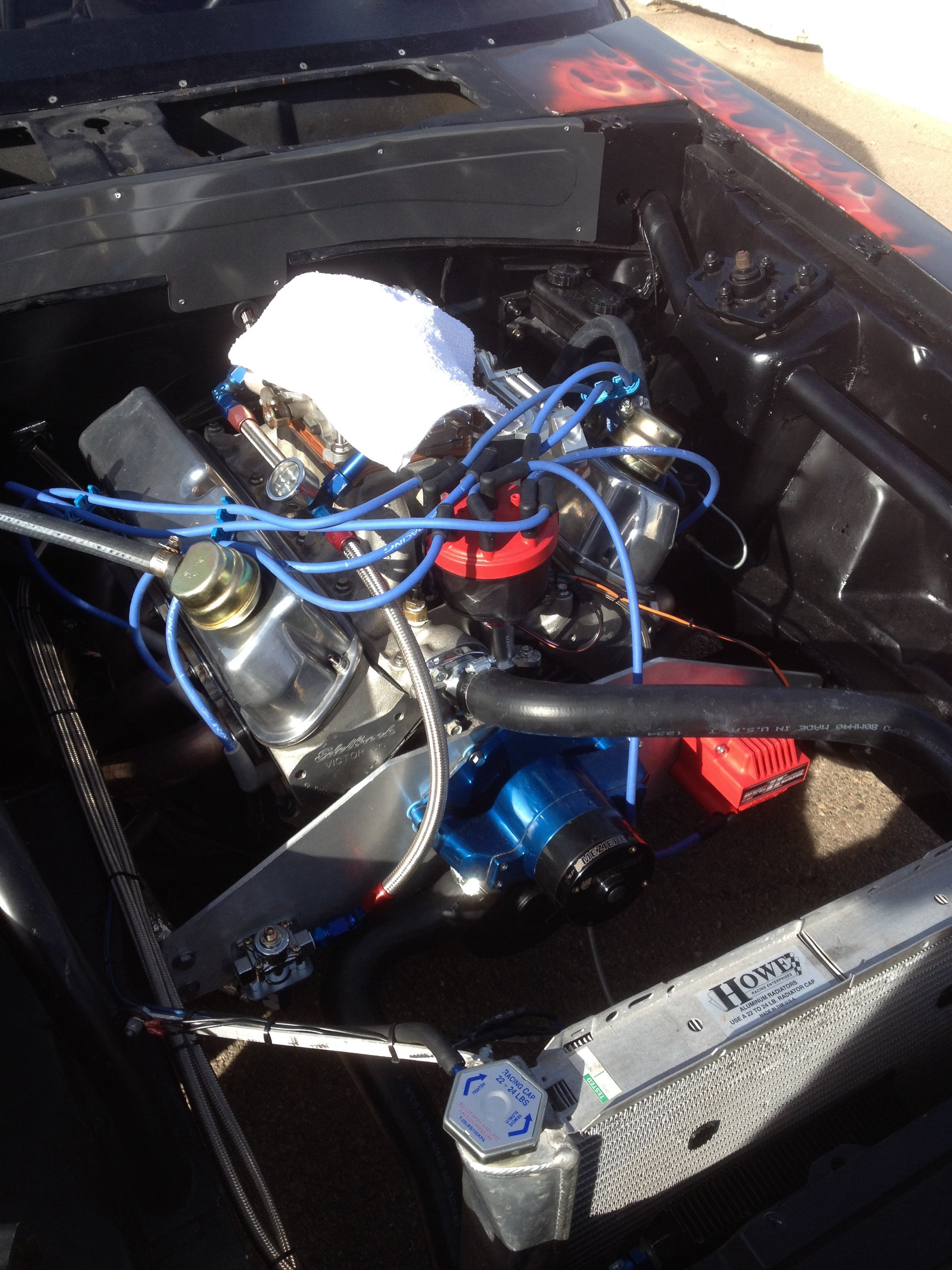

    The nova is a 14:1 496 with a 500 shot of juice. Runs low 9.s - had traction issues
    The ford small block is a 347 stroker with 14:1 and runs 5.90 in the 1/8th
    Both are on 112 because it's the same blend every time. Even a budget build is expensive and damage ****s. I would stick with av gas or better. Ping and lean kills top ends. Make sure your fuel pressure maintains about 7 psi through all rpm ranges. Best of luck to you
