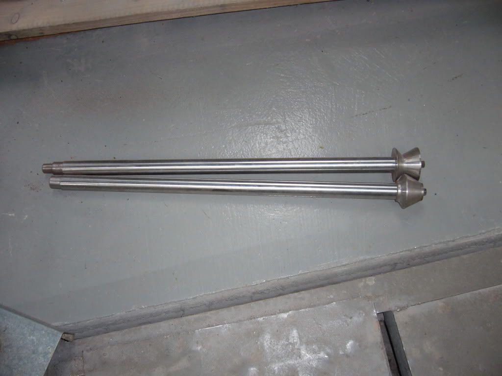

    and some shafts turned up,i machine up my own formers on my $200 lath

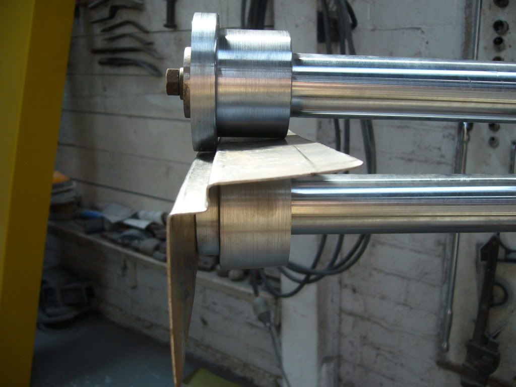

    the cogs i used are timing belt cogs from a gtr skyline[​IMG]

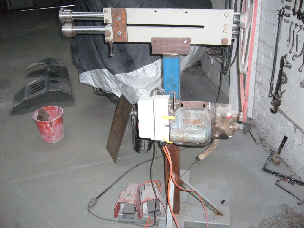

    and all together, just need a motor[​IMG]

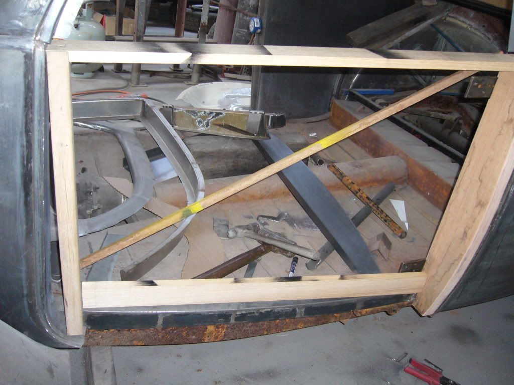

    Now how to make a door,i started by making a wooden frame and screwing it to the hinges to make sure it worked.It didnt the door lower edge hit on the front mudguard[​IMG]
