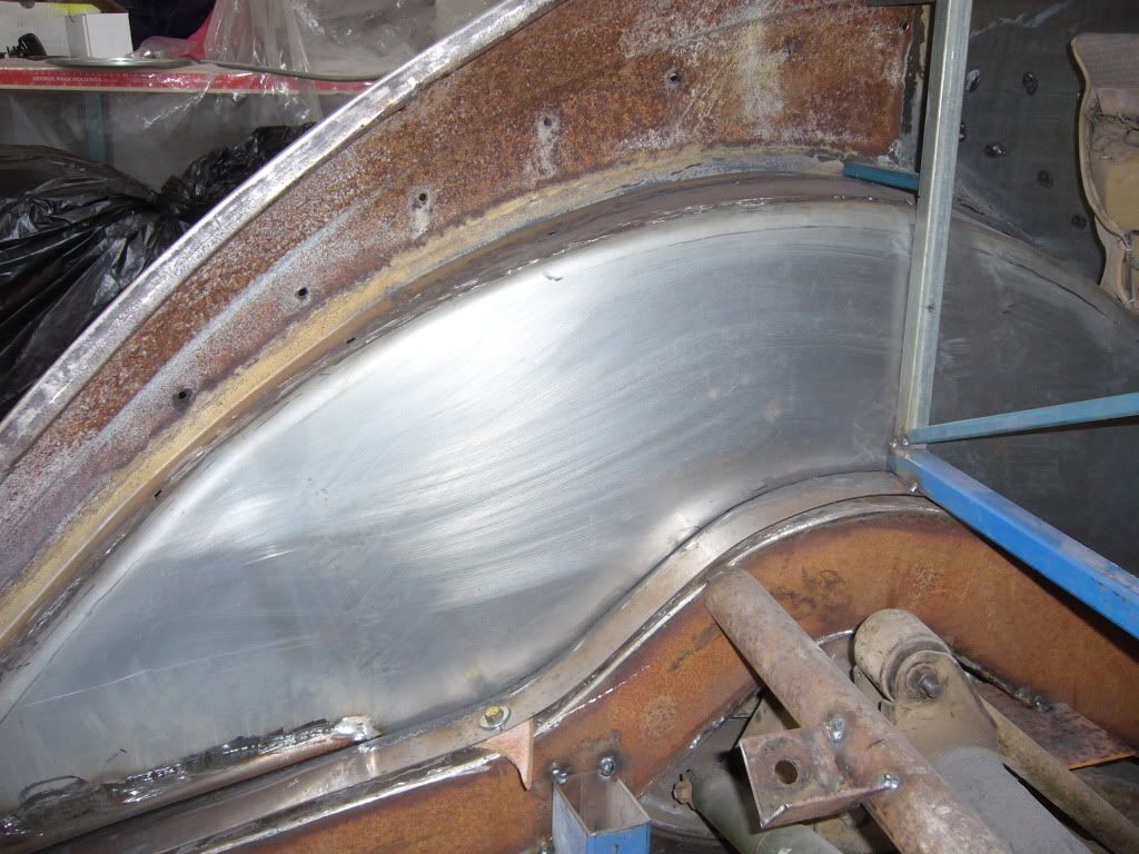

  20. mercurymitch
    Joined: May 14, 2011
    Posts: 194
    mercurymitch
    from Australia
    I ordered a set of wheels for the car and new they were going to be a tight fit so i removed the inner guards and made new ones,along with new floor rails

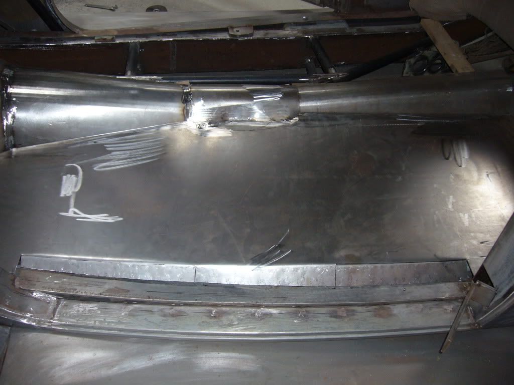

  30. mercurymitch
    Posts: 194
    mercurymitch
    from Australia
    Things have been stationary for a while ,ive been building my house.Got the floor pans done,because they are not parrallel on either side i used a straight edge down the centre and measured off either side.
