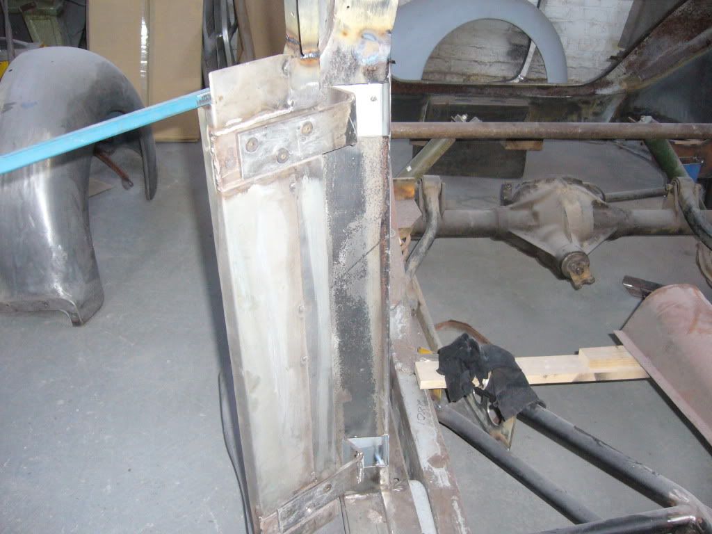

    finally getting a bit more done,welded in door pillars and fitted door locks

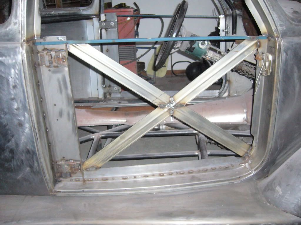

    Next was to make the bracing for the doors,i needed to stiffen the metal so had to make a set of wheels for my beadroller.Every job leads to another job.
  15. mercurymitch
    Joined: May 14, 2011
    Posts: 194
    mercurymitch
    from Australia
    [​IMG]Had a good day yesterday and got the left door frame welded up and swinging ,keep the misses happy
